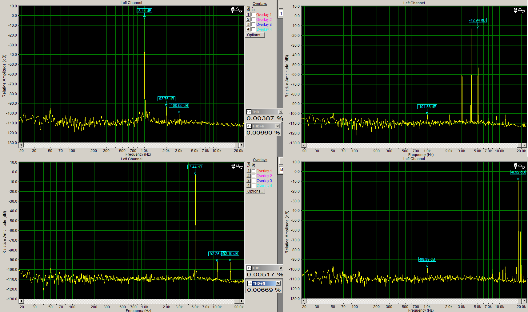

Thanks for kind words. Today I took some measurements and discover a nice small mod that can make the THD spectrum more audiophile kind of way. Bellow oryginal version and modyfied one.
So the plan is that we are making a good amplifier and than we can make it ''worse'' to ''sound'' better 😀
I must say that I am suprised how good simple quasi complementary mosfet output stage can be, and not only on the paper but I really like how it souds.

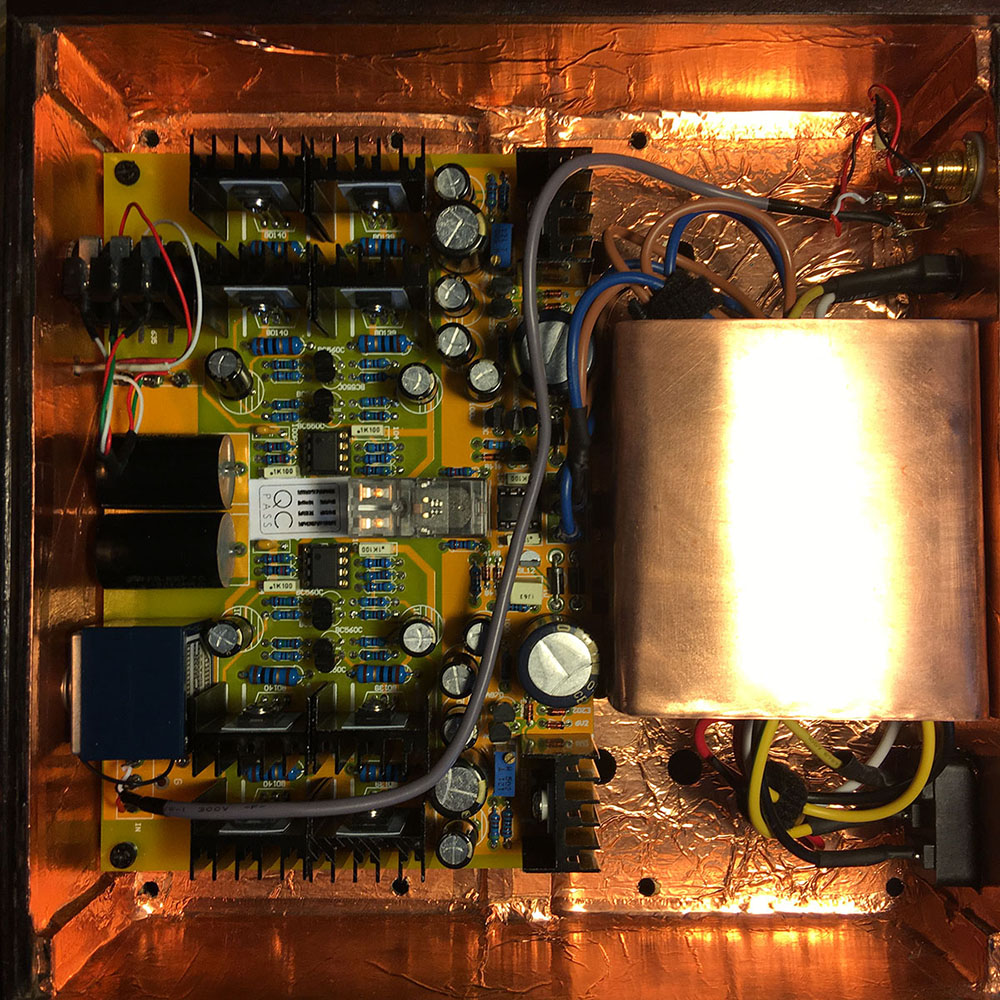

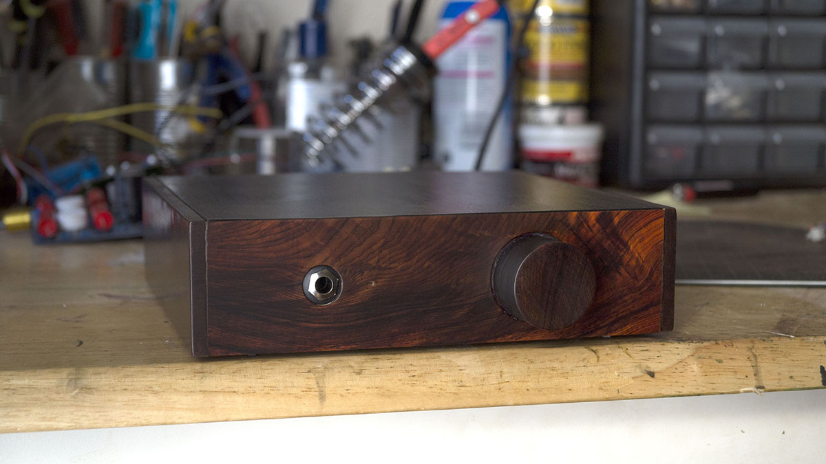

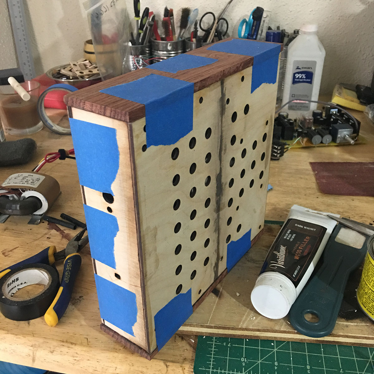

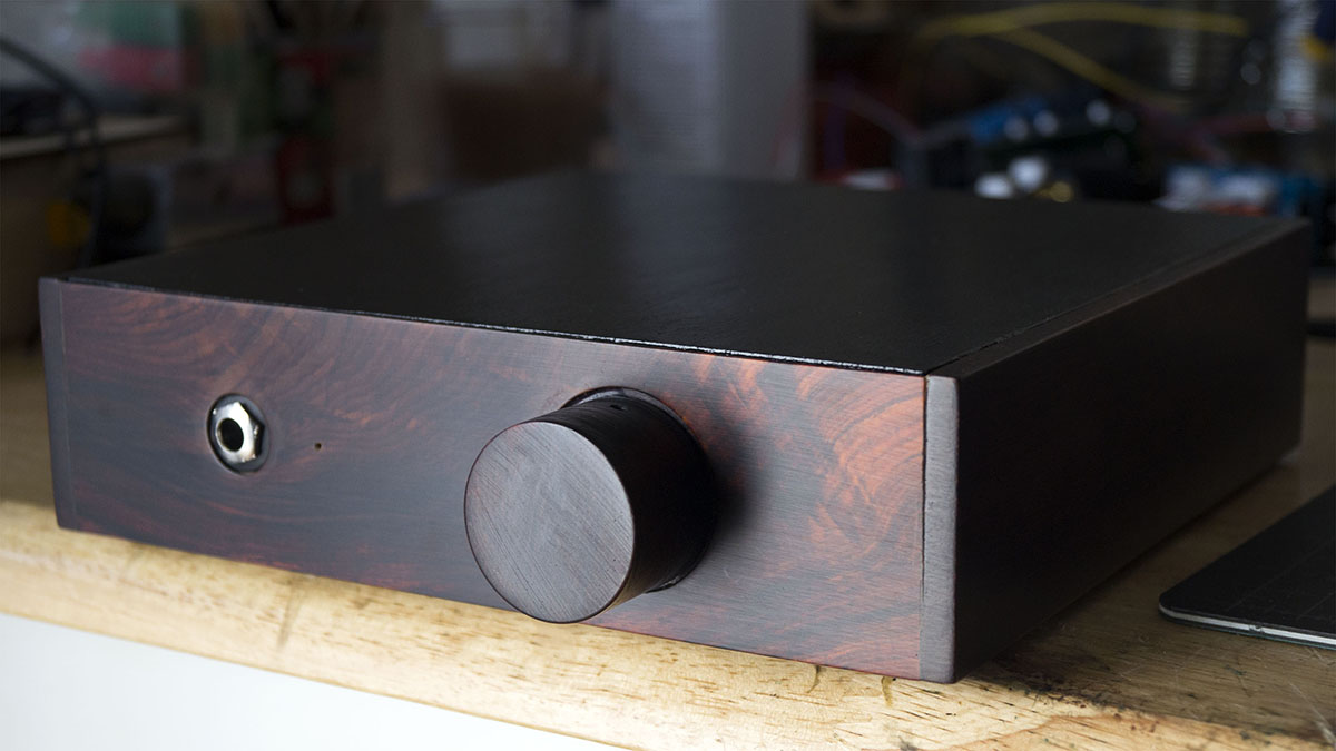

Hi everybody, here is my headphone amp.
It is a Chinese made pcb that seller claimed it is based on Lehman Headphone amp. I do not know anything else about the circuit, all I did was upgrading the coupling caps to Solen, and it sounds amazing.

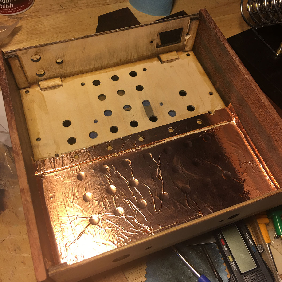

Box was laser cut out of plywood, with Bubinga for side panels and Cocobolo veneer for front.
inside, shielded with copper tape, and shielded R-Core Transformer :

I like the case of your head amp. Does the heat sink run hot?
Its a ocl head amp? looks like you have a +- regulator and 2 pairs of bd139 as outputs. I like it.
The wiering for inputs on near the transformer seems a little bit off though, could have prboally trimed down the excess wire.

thank you, it gets warm after normal use, it got abit hot after 30hrs burn in tho.
you r right about OCL, regulator and 4 pair of bd139/140 (2 pairs for each channel).
yeah i could do a much better job for input wires, i m not a patient man 🙂 it does not have any audible noise tho.
Thanks for your interest. 🙂

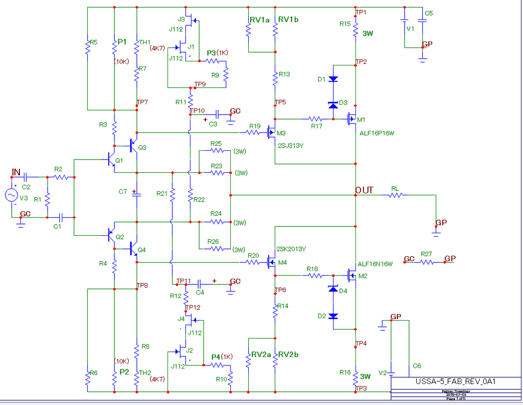

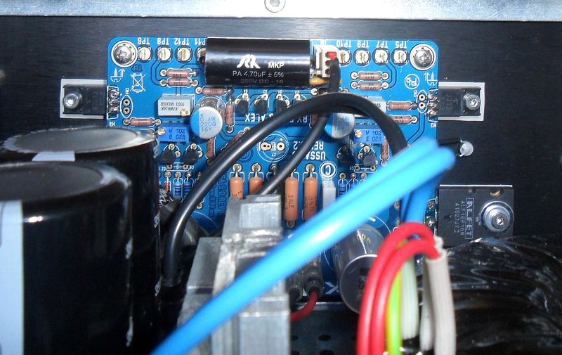

I have been building several First Watt amplifiers (F5, F6, M2) for a couple of years, eventually settling on the M2, because of its relaxed character. But the F5 is - in my humble opinion – still the best of the bunch, when it comes to soundstage, layered depth and details. Ultimately, I have found that music played through the F5 and the other First Watt designs can sometimes be a little lacking when it comes to tonal colors and "flesh". They do details and dynamics very well, but the general sound quality is a bit on the slender side. I came to suspect that the industrial mosfets used the First Watt designs were partly to blame, and began searching for a class A design using lateral mosfets or bipolar transistors.
During my search for a new project, I fell over the USSA5 amplifier designed by Fab. Fab is active on this forum, but also on the Quebec DIY forum (quebecdiy.net), where there has been several group buys for PCB’s for the USSA5. You can find a lot more information about the USSA5 design on the Quebec DIY forum.
The USSA5 is a design that has been through several iterations over the years – hence the number 5 suffix. The USSA5 has a CFP input stage with CSS. It uses a set of 2SK2013Y/2SJ313Y as driver transistors. The output transistors are lateral audio mosfets ECF20N20/ ECF20P20.
I managed to buy a set of very well made PCB’s from the last group buy on quebecdiy.net. The PCB’s came with detailed building instructions written by Fab. The amplifier was a pleasure to build, and Fab answered my questions patiently during the process.
So, how does it sound?
The USSA5 has all the best traits of the First Watt F5, combined with a much more natural and organic sound. Good recordings of string quartets come alive in a wonderful and truly holographic manner. The musicians are placed in front of you, and you can sense the resonances of the wooden bodies of the instruments. It is almost magical. Acoustic instruments are portrayed with scale and depth. When listening to more modern pop or rock recordings the USSA5 shows that it is a highly dynamic amplifier with pace, rhythm and a deep and firm bass. Tons of details combined with an addictive natural tonal balance.

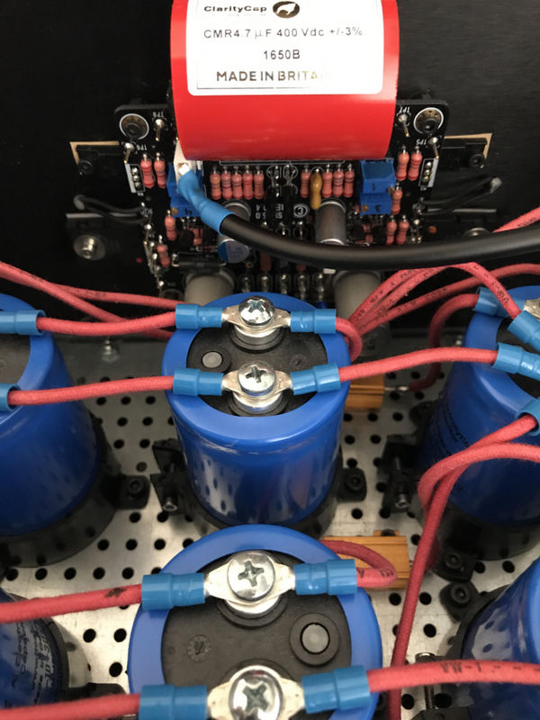

In this project I am re-using the power supply from my First Watt M2. It is a dual mono CLCRC power supply with the power transformers and the first CL stage placed in a separate enclosure.
The photos below show the building process. I still need to tidy up some of the wiring, but all is working fine, and there is no noise or hum whatsoever.

HH, I like that MASSIVE 4.7uF. 🙂

I have been building several First Watt amplifiers (F5, F6, M2) for a couple of years, eventually settling on the M2, because of its relaxed character. <snip>
This amplifier deserves to be more plebic because it is a jewel of sonority, It is that the mosfets are difficult to find but the game is the candle.
A little UP on my USSA-5
Project16,

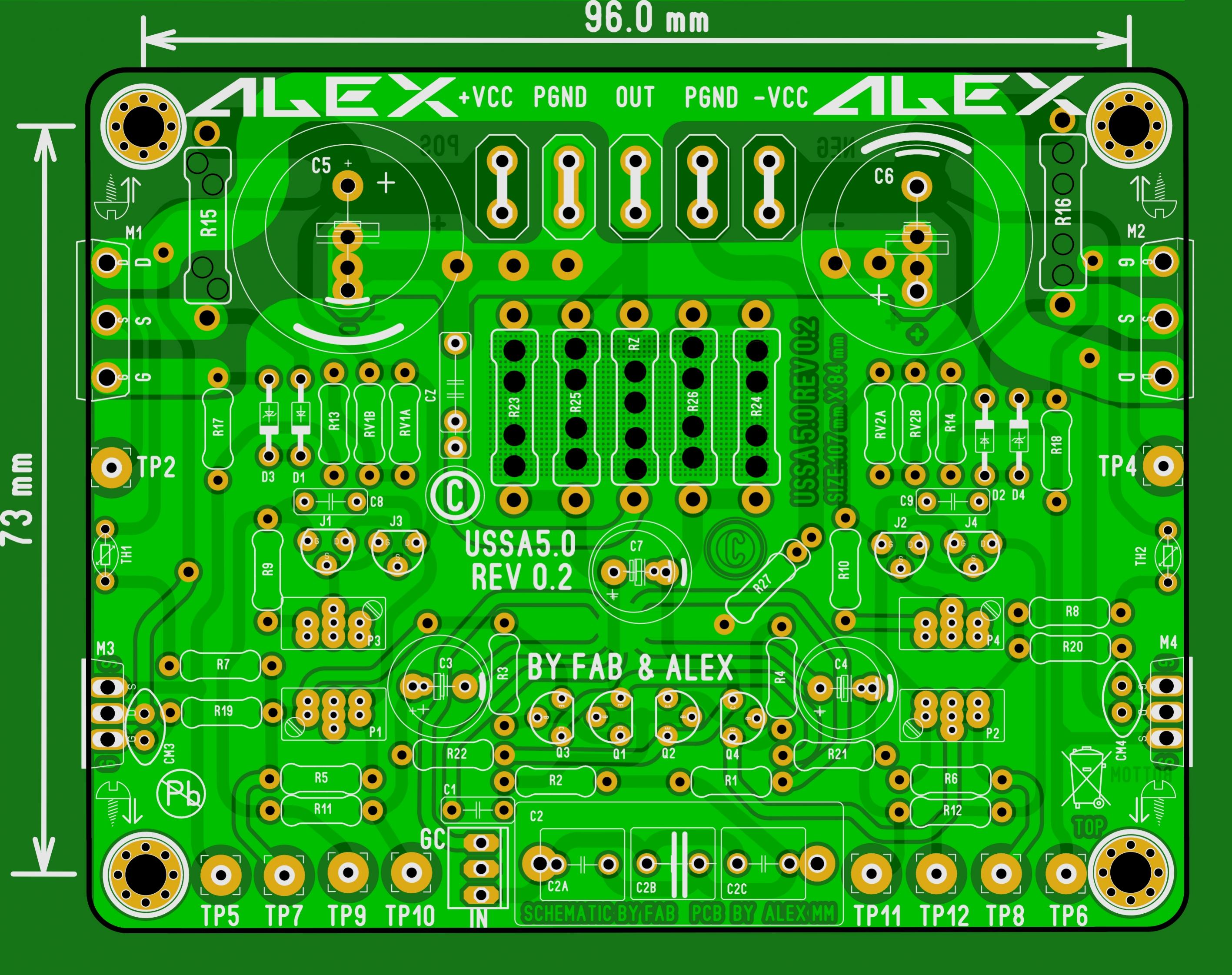

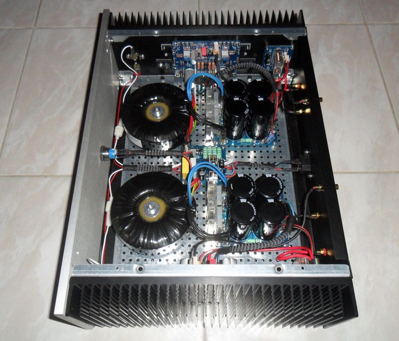

Congratulations on your build, nicely done! And I bet you are using the power boards that you designed yourself. 🙂 What are the dimensions of the case you have there?

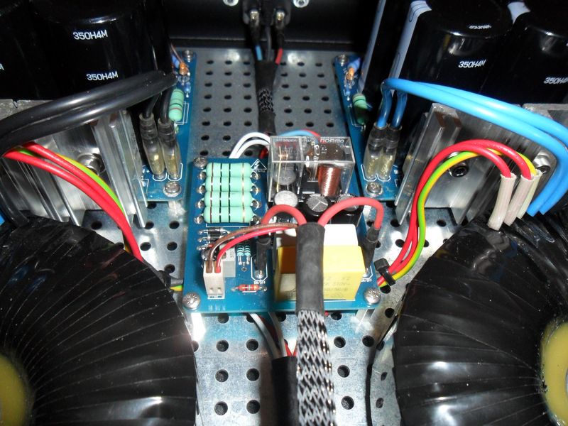

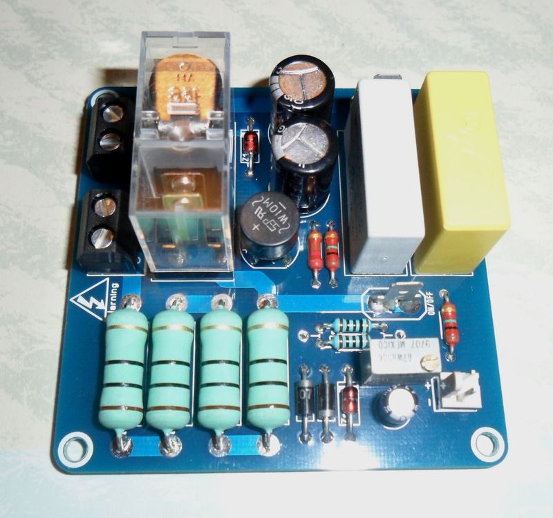

The other smaller boards with relays - I am guessing those are soft start and speaker protection circuits? Which ones are you using? What speakers are you driving with the USSA 5?

Of course,YOU are the pcb expert!🙂Sorry ,it's my design .....🙄
Is it for sharing?
Hello AlexSorry ,it's my design .....🙄
Look on the PCB I redesigned, your name is present and on the HS USSA-5 black pcb.
The initial idea to make a PCB with maximum dimensions of 10cm x 10cm for eventually manufacturing at lower cost and it is successful.
However I have made some improvements that are on dimensions, the possibility of putting a larger capacitor and close the resistor (R18) gate M2 which was too far away.
I had a good starting base to work but that is not the version you are presenting. 😉

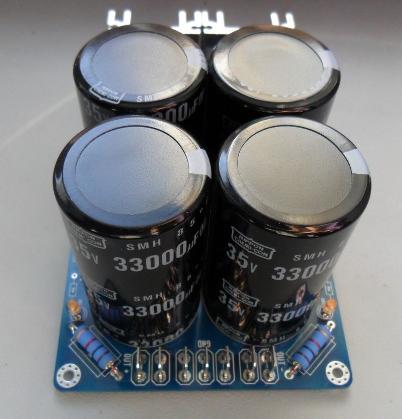

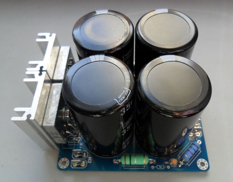

I actually designed the PSUs to fit the case and it was they who later gave the one I proposed on the buying group.
CRC Power Supply (Class A amplifier)
The small cards are loudspeaker protections with timing but I designed new to SSR with adjustable DC detection, adjustable delay and can receive receive from 15V to 50V.
The third card is also drawn by my care, it is a soft - start with power supply of the led of the switch directly on the sector.
All these assemblies equip my two USSAs, the first to more than two years and I have not encountered any problems.
