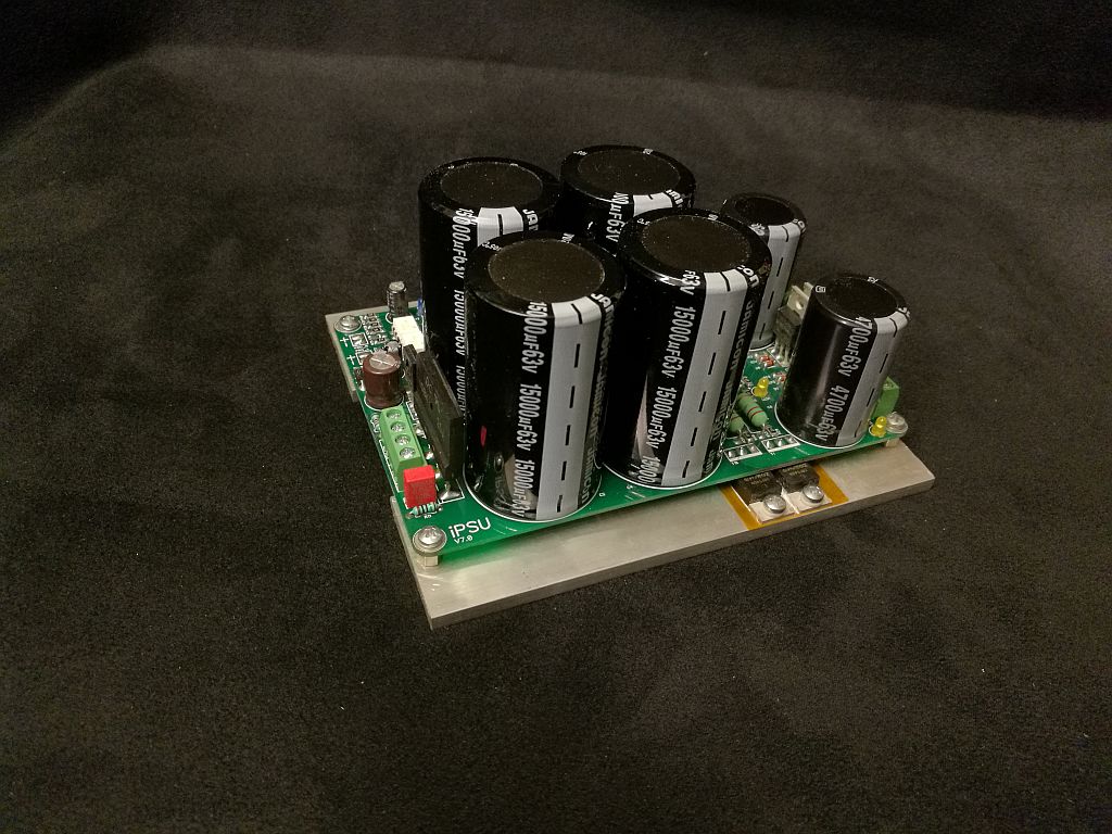

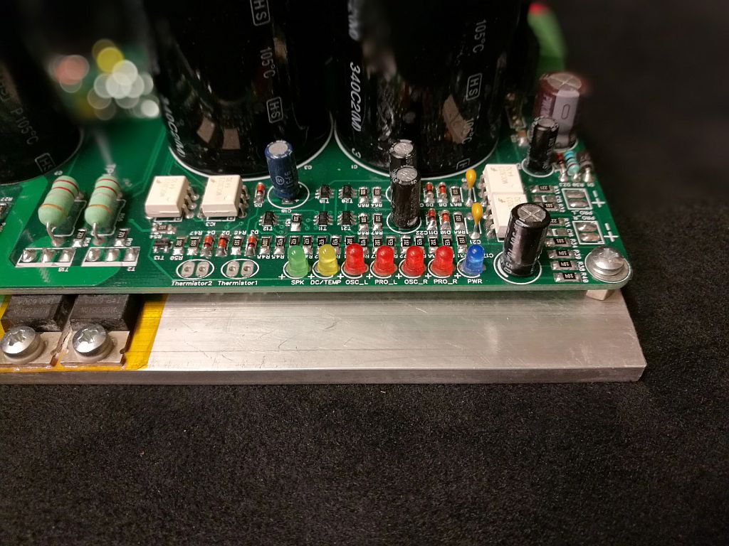

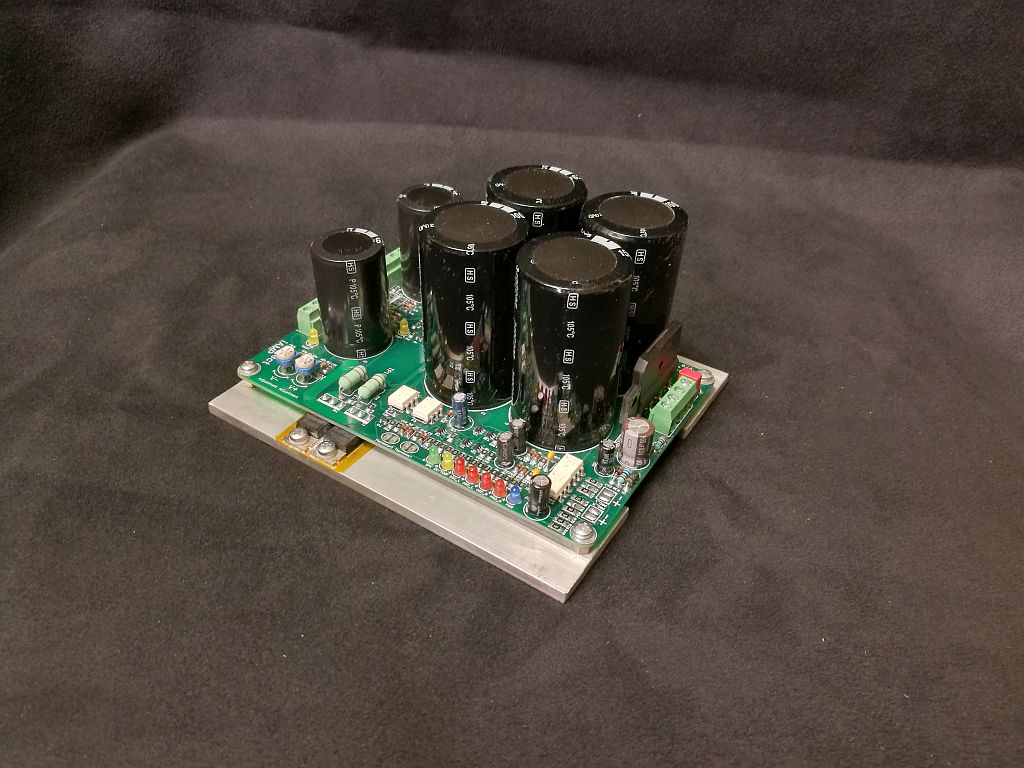

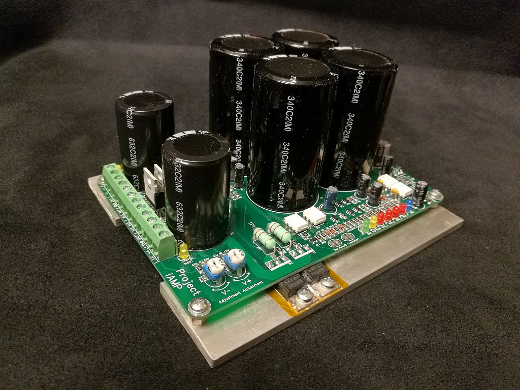

7th version of integrated amplifier PSU is on the way. Some new features are on the way too. PSU contains:
-capacitance multiplier / stabilisation if required
-delayed SPK ON
-fast SPK OFF
-DC protect
-stereo thermal protect
-stereo short circuit/over load protect
-stereo oscillation protection (above 30kHz @ 10V p-p)
-LED diagnostics for left and right channel
-protected BUS rails - in case of failure V+ and V- buses are switched off
-BUS rail soft - start --> (on power on bus rails are slowly switched on - 1-1,5s)
-stereo solid state Mosfet relays for SPK ground return
-delayed SPK ON
-fast SPK OFF
-DC protect

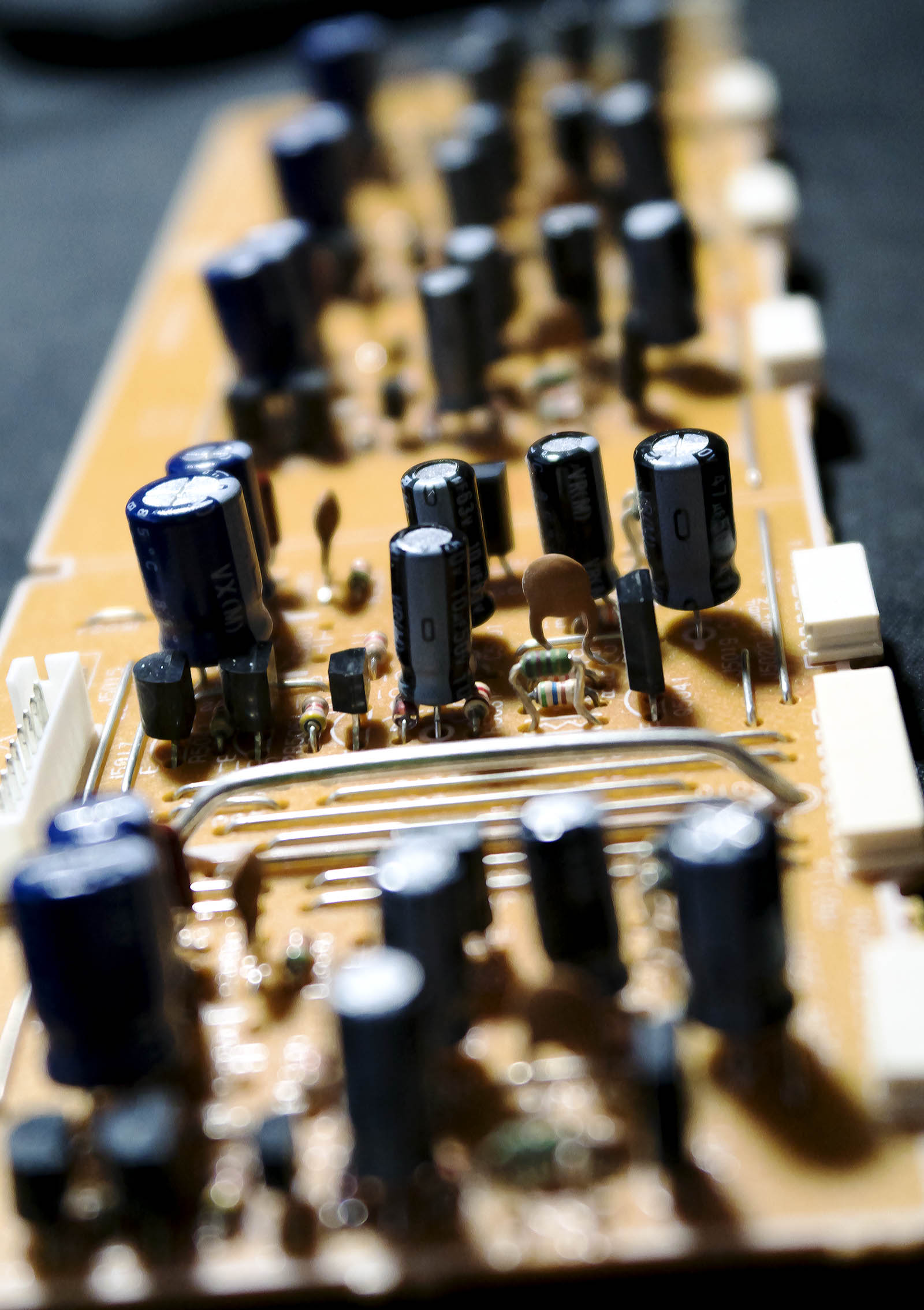

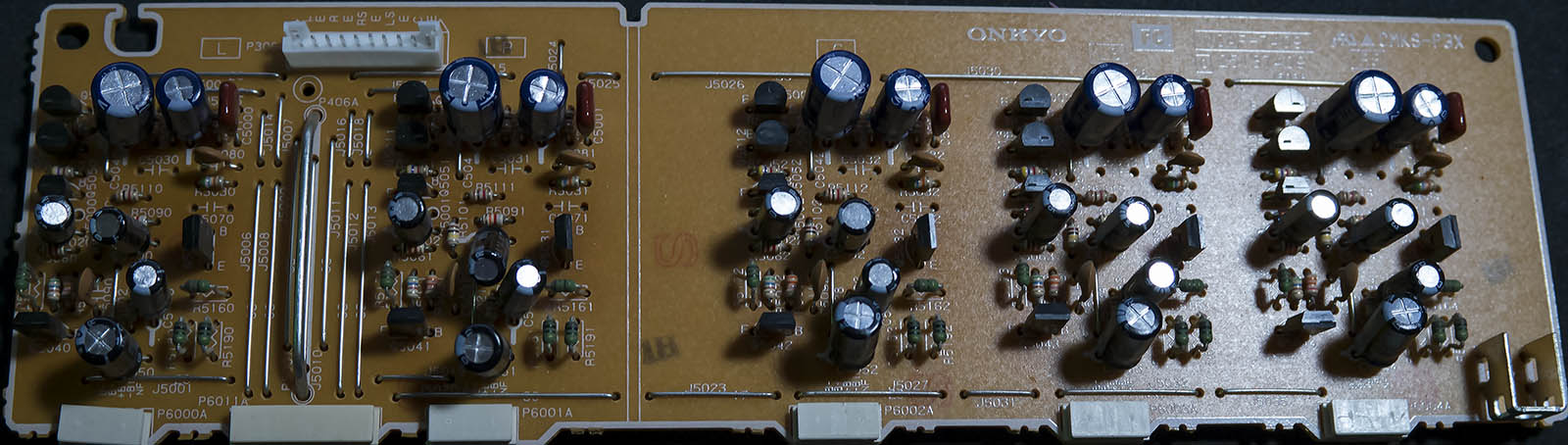

I am hoping to do something very similar to what you have described, except mine is only using a pre-amp from an AVR. I believe I will need to cut each pre-amp apart so that I can tap each one individually.

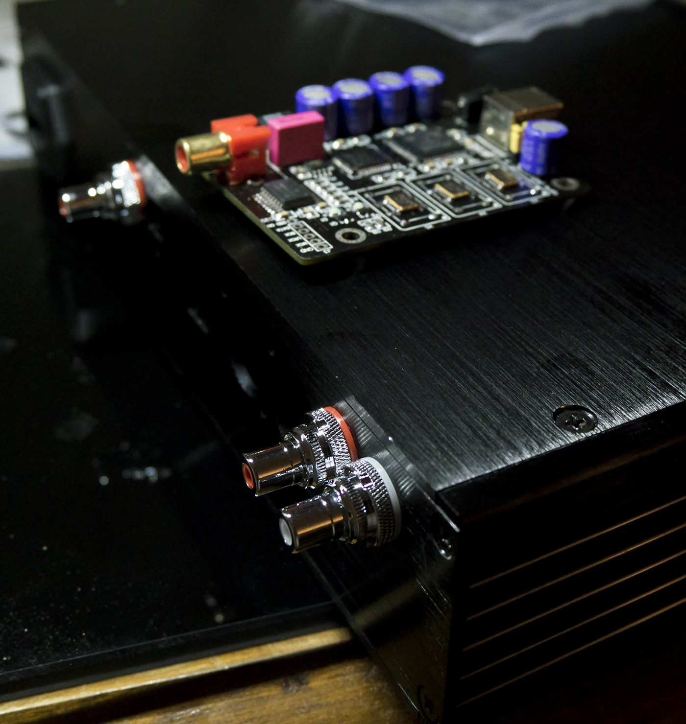

Anyone have any advice for mixing in late 90's Onkyo pre-amp with a MX50 SE x4 for power amp with ES9028Pro + Amanero (DSD512)? I just got most of the parts in the mail from China (FINALLY). I can't believe I found a DIY ES9028 kit that was literally $59 total. However you need to assemble the entire board/s yourself except for the main IC, I think they do include that on the PCB.
ES9028Pro DIY kit ($60) just arrived! You can see I have the other pieces of the puzzle (for the DAC anyway) pictured below.
Has anyone ever taken a simple pre-amp that was for 5.1 (5 individual preamps on one PCB) and cut it up into 5 that you can tap separately from the other 4? I will include an image of that below too.

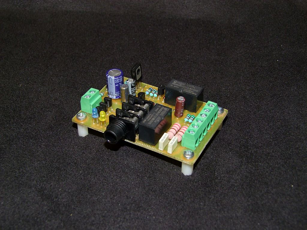

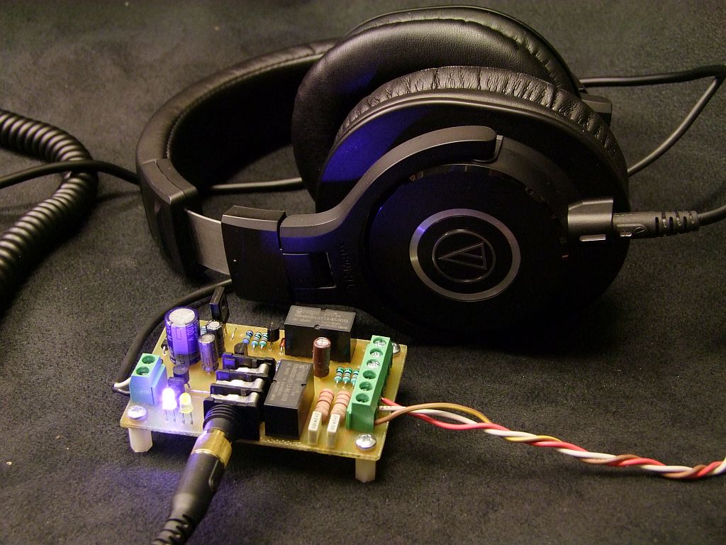

As my wife must learn a bit for the exams I had to find the way to plug in my headphones to the amplifier so I have made a smallish project - universal Jack-module with DC protection. Works as a treat. (documentation on my page in ''other projects'').

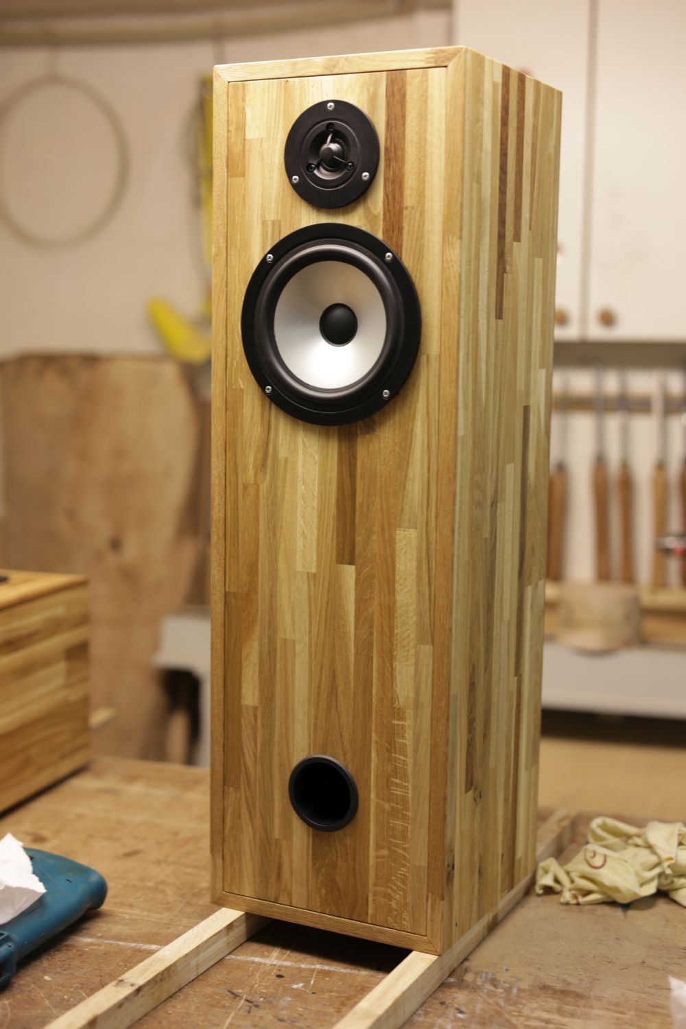

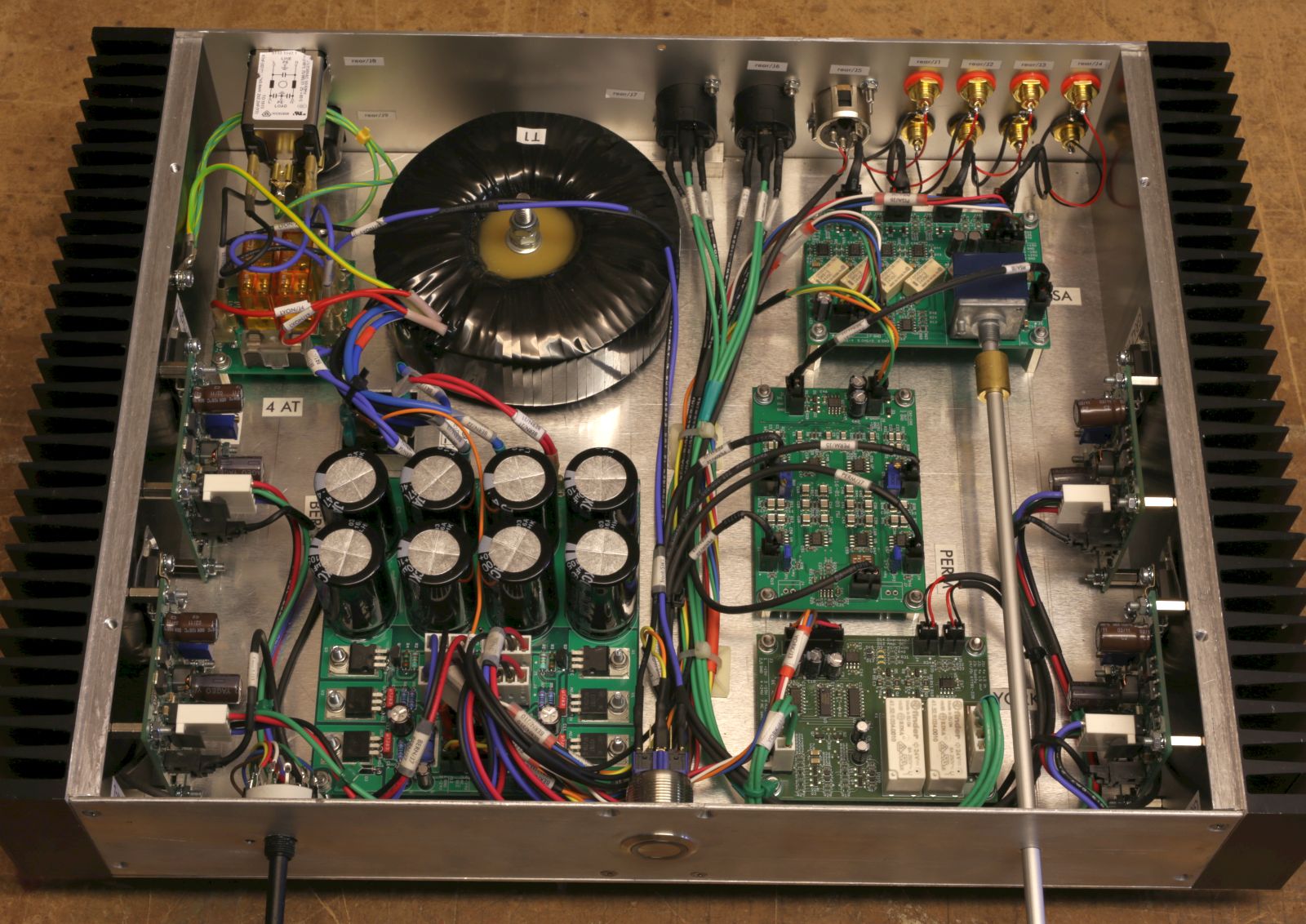

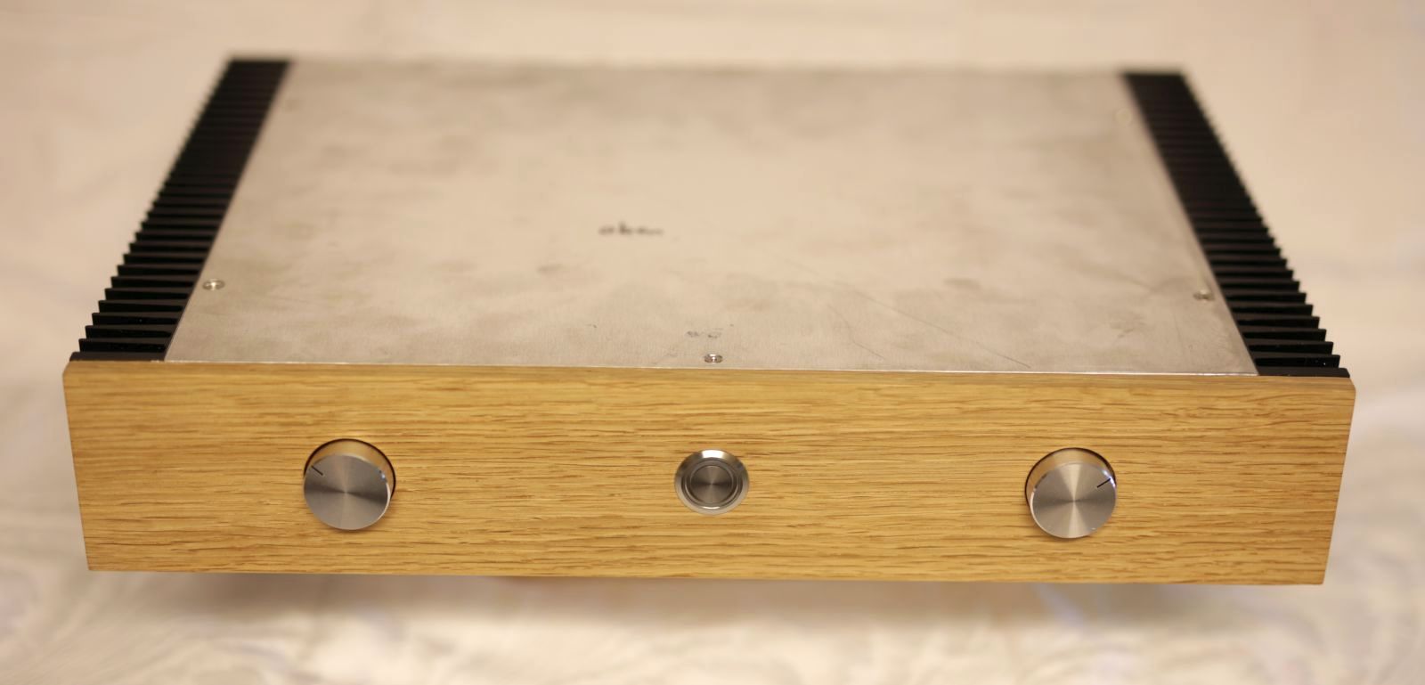

Here are some photographs of my current bi-amped system. All schematic/assembly diagrams and BOMs can be downloaded from my website: michael weilgunis website – brahms amp.

Hi Thimios!
Thank you! All PCBs were hand-assembled. I have some unpopulated PCBs I could provide (for 3 further amps). Until now I just made two of these amplifiers so I'm currently not in the situation of thinking about kits or assembled boards. If there is more interest situations may change.
Sorry, I just finished translating the page. If you go to the bottom of the page you will find a table with schematics and assembly diagrams.

Very good. I like your speakers too.
Looks great! Does that DT 94 perform well for you? Any reason why you didn't go for fabric (G 20 SC) or titanium (DSM 25 FFL)? Two reasons I ask: I'm not quite happy with the SC 10 N - I'm going to replace mine with one of those I mention, and I wouldn't think that the DT 94 is any better than the SC 10 N, but if it's good, I might consider it as well. Then, you're using an AL 170, so why skimp on the tweeter?
And does the enclosure hold up well? It's beautiful, and I'm keen on using solid wood in enclosures, but I've heard that solid wood isn't great for tight enclosures because of expansion.
Hi Mrcloc!
I already used the DT 94 in projects before and for me it performs well enough. I have never tried the fabric tweeters you mention so I can't tell you which one fits better to your application. The AL 170 is overpriced on the Visaton website, you can get it way cheaper via distributors so I think the prices are well-balanced.
Concerning solid wood: there may be problems with closed boxes but I have less doubts with vented boxes.
