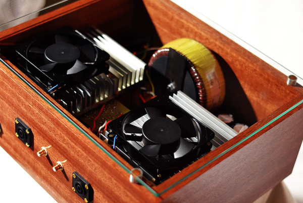

This has also bothered me a bit, but only now in the photo.
The housing however is now closed again. So I don't see the wire and i don't look at the pic and all is fine. 😎 😀
You could straighten the wire on the blue cap.😀
yep, thats the only flaw with the build😀😀. and as catd says, the cabinet is closed, so we will never never see that bent wire again!😉

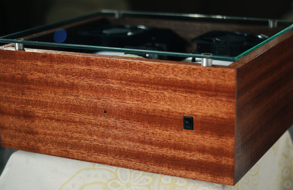

I wanted to post some proper pics of my finished amp.
At the local audio shop, we connected this up to some Monitor Audio Bronze 6's and then the beautiful B&W CM10's. We were all well impressed with the amplifier's sound and control over the speakers. I'm on a path to building some decent speakers, and then I'm definitely going to buy a pair of the MA Bronze 6's because they sounded truly amazing on this amp.
Mrcloc, woodwork looks excellent. Not a big fan of the glass top but the electronics looks fab.

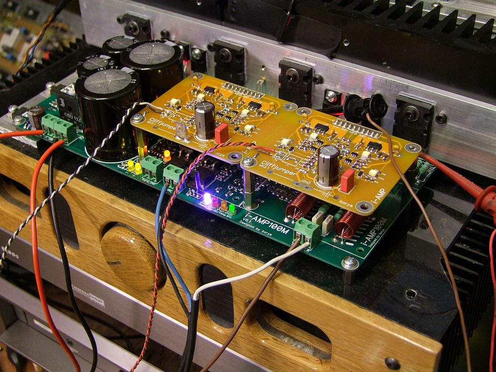

I was waiting around 4 yeares to solder my dream mosfet amp together, it really was worth it, really suits to my preferences (BJT version with MT200 SanKens is good too but mosfets are more fancy 😀 ).

Peter, very cool one! I like MOSFET drivers 😎

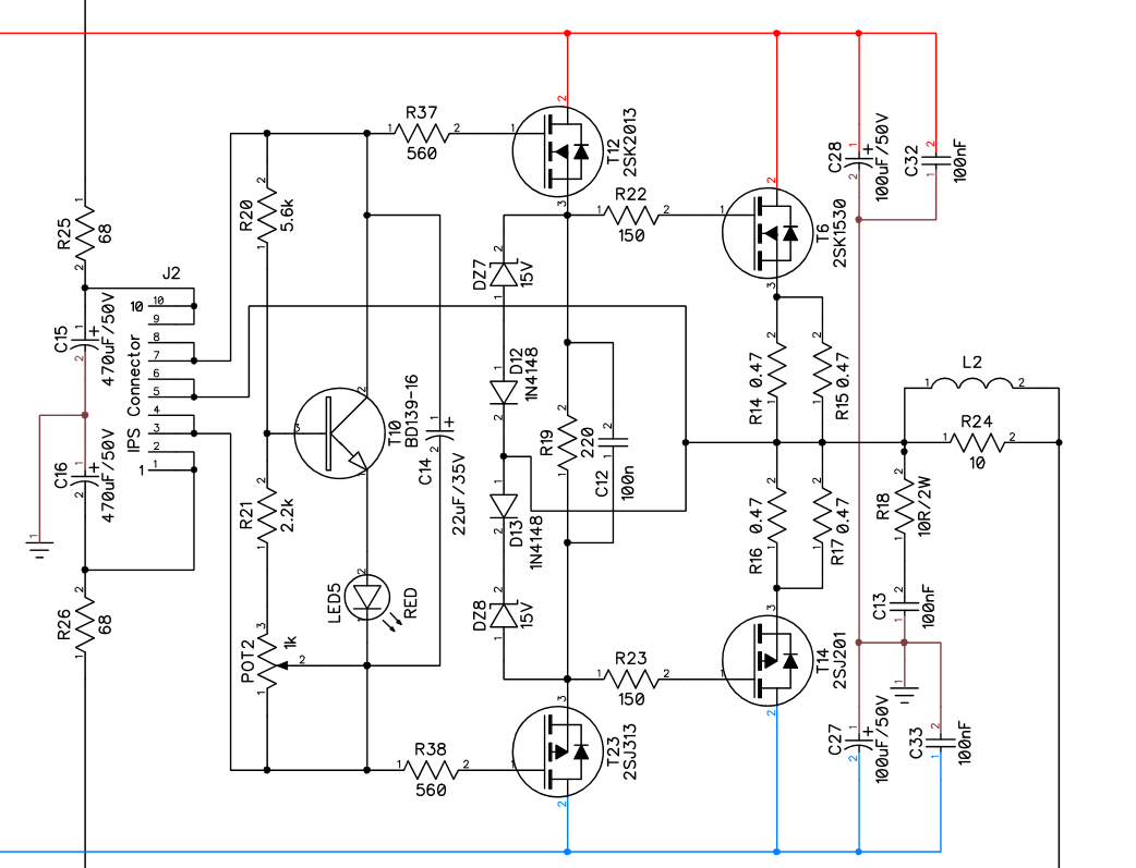

The only problem is to get genuine sj313 2sk2013 but the plan B is to use IRF610 and IRF9610 the another drawback is huge Vgs compared to the Toshiba mosfets but winding another 20 turns to the toroidal transformer is not a problem so it is worth of trying.
Regards

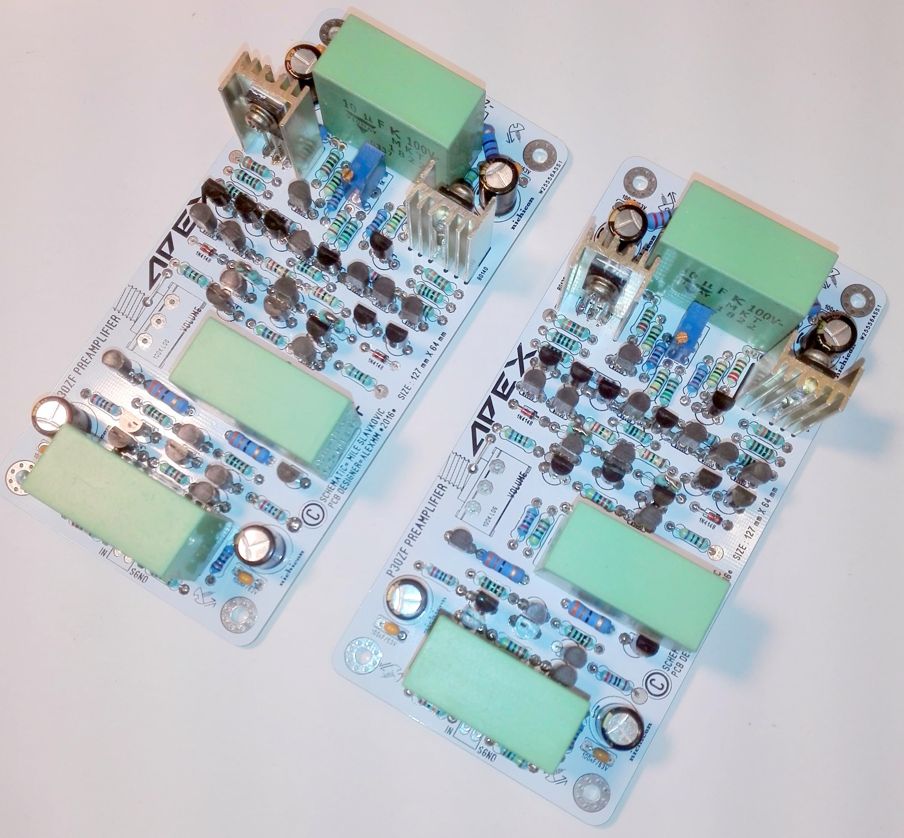

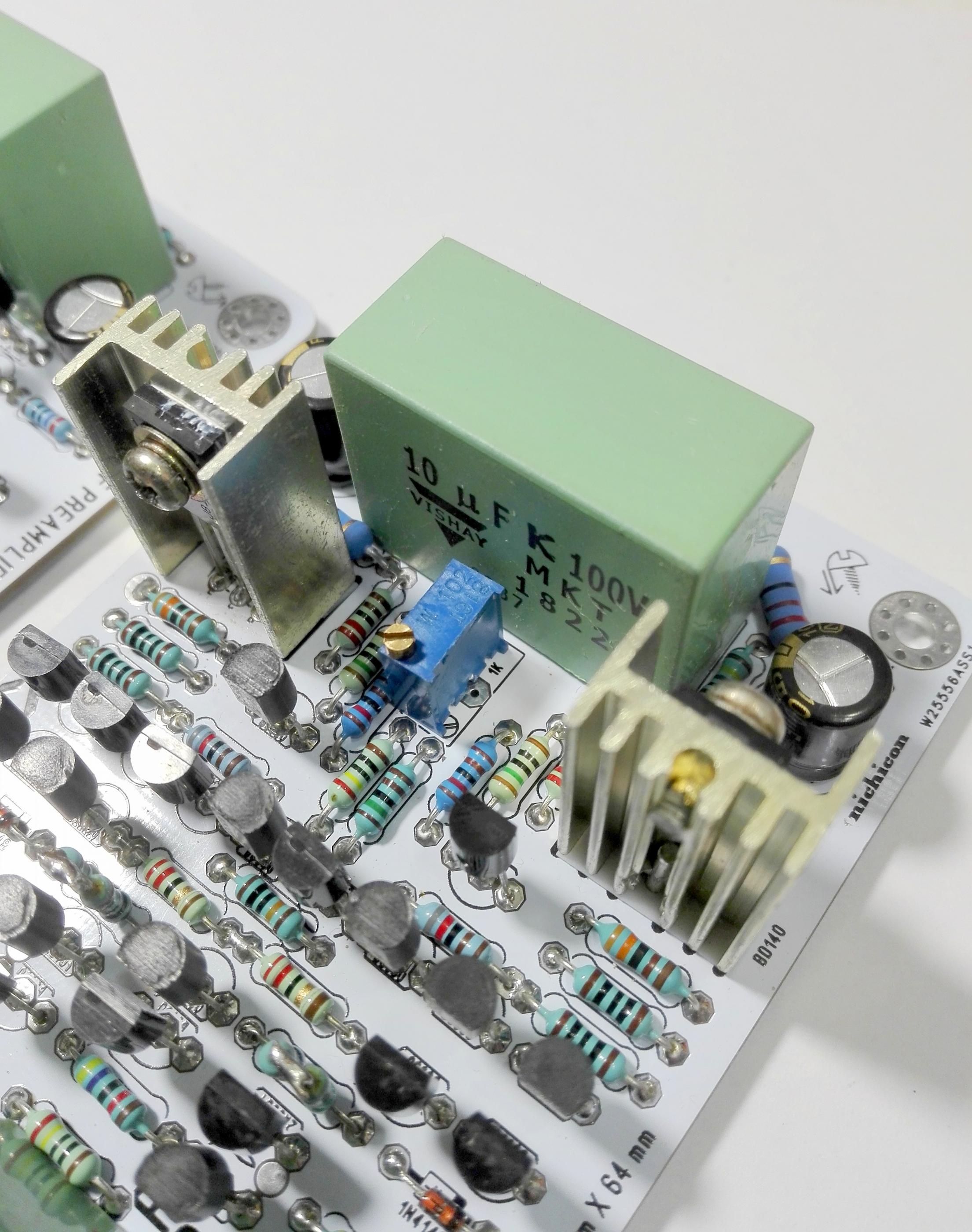

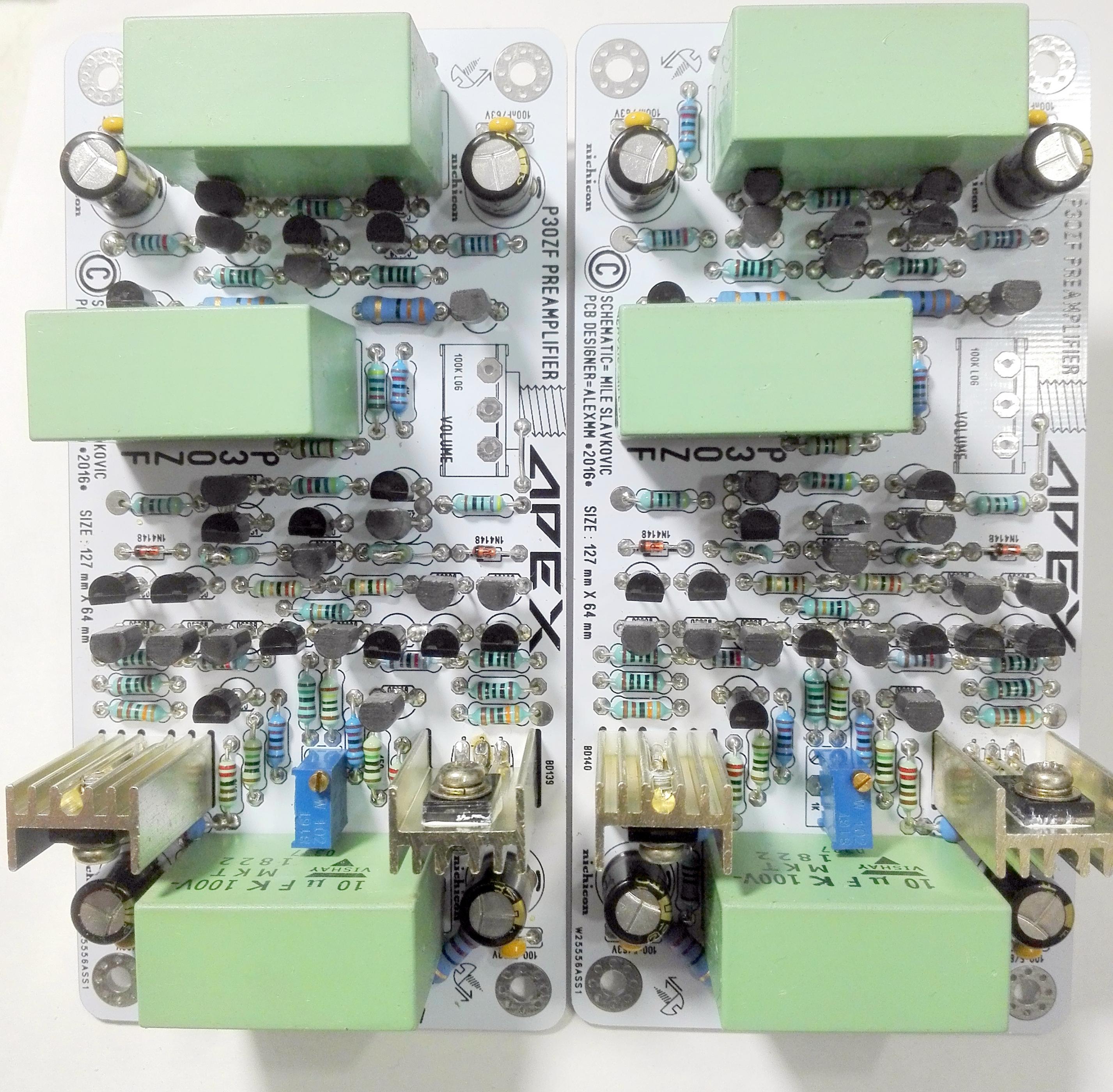

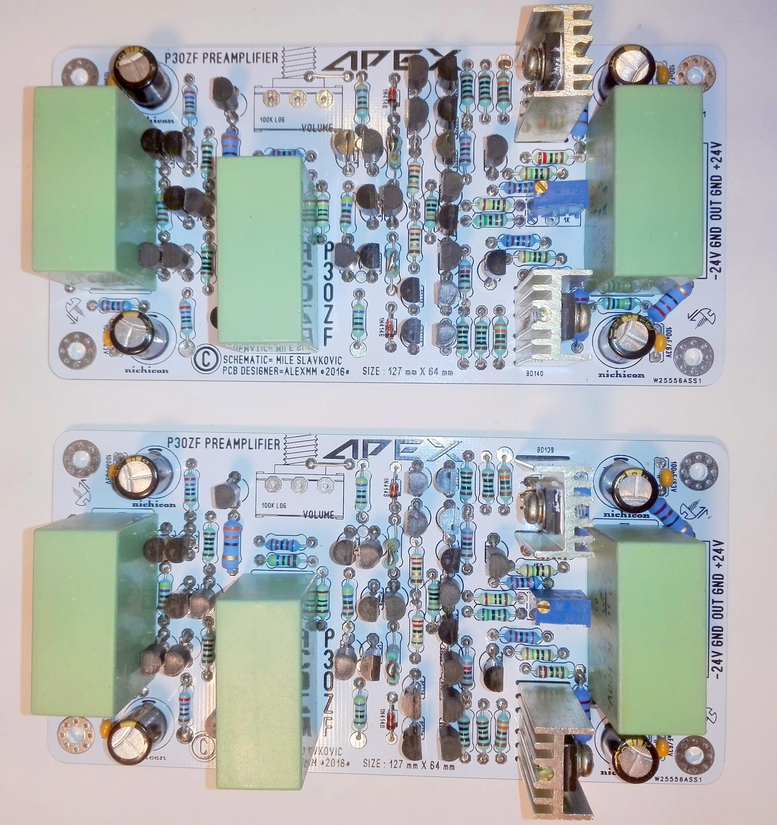

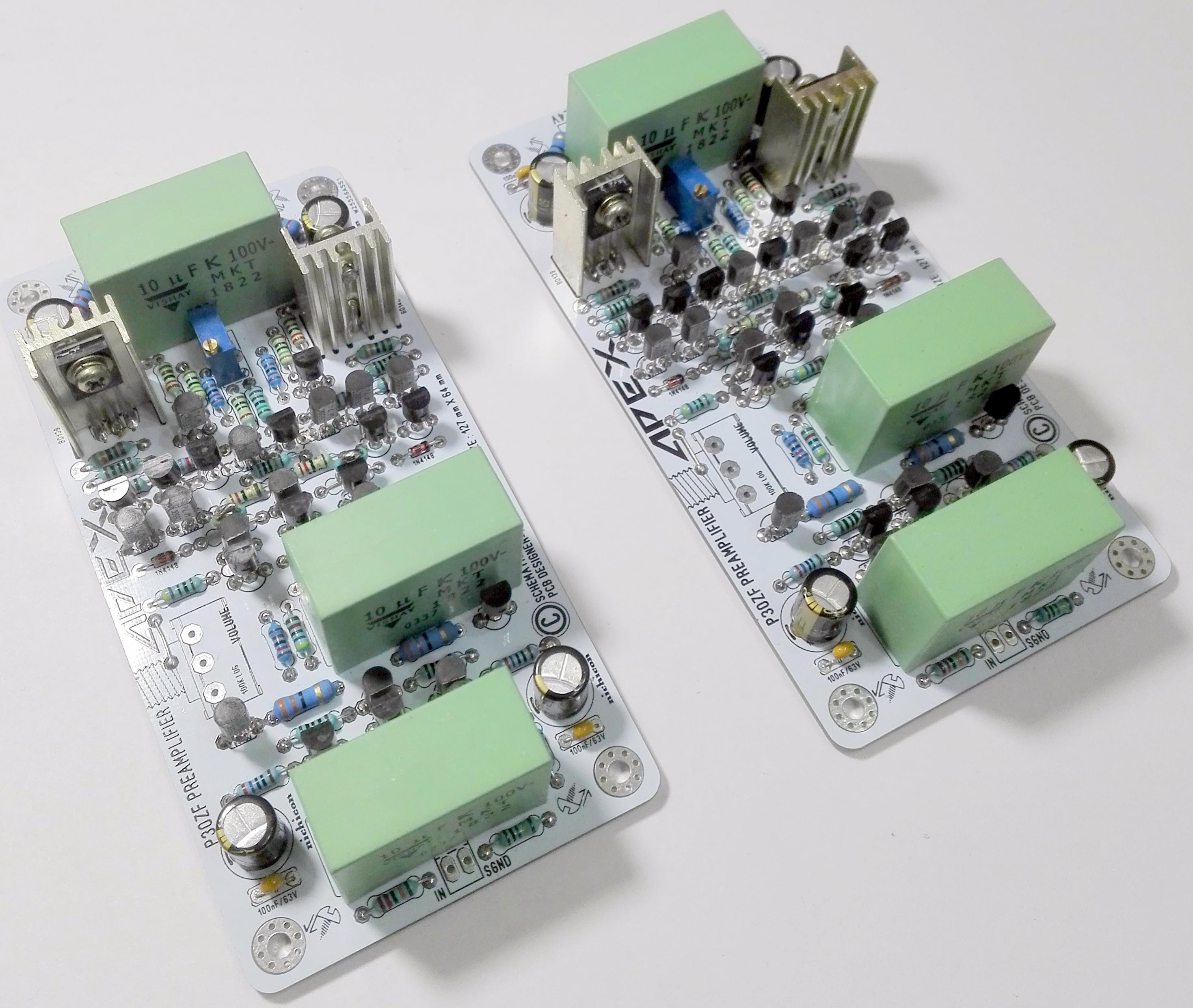

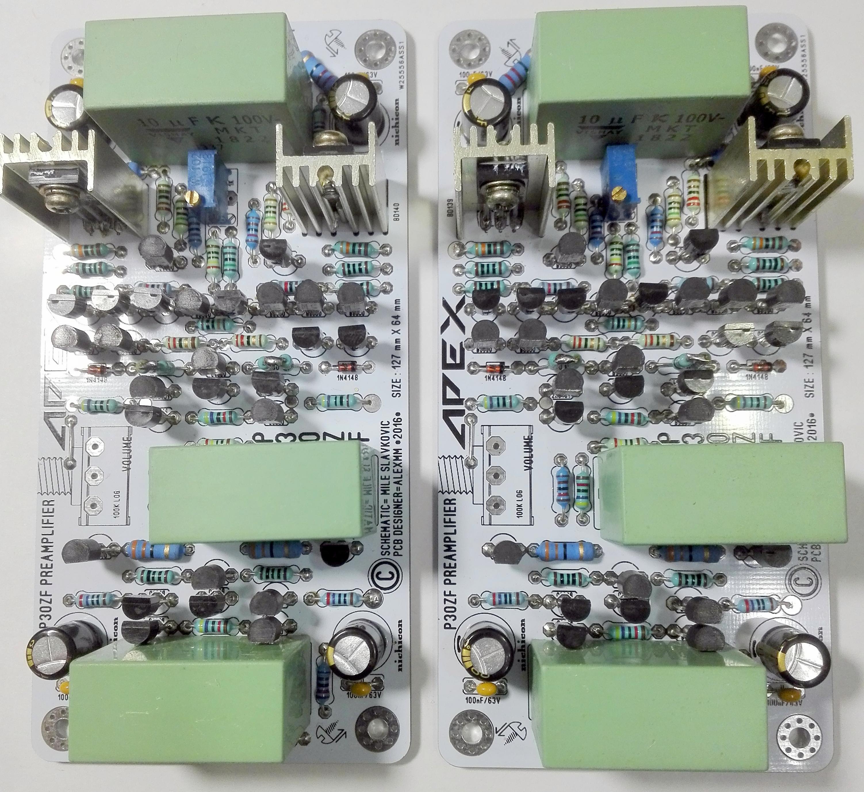

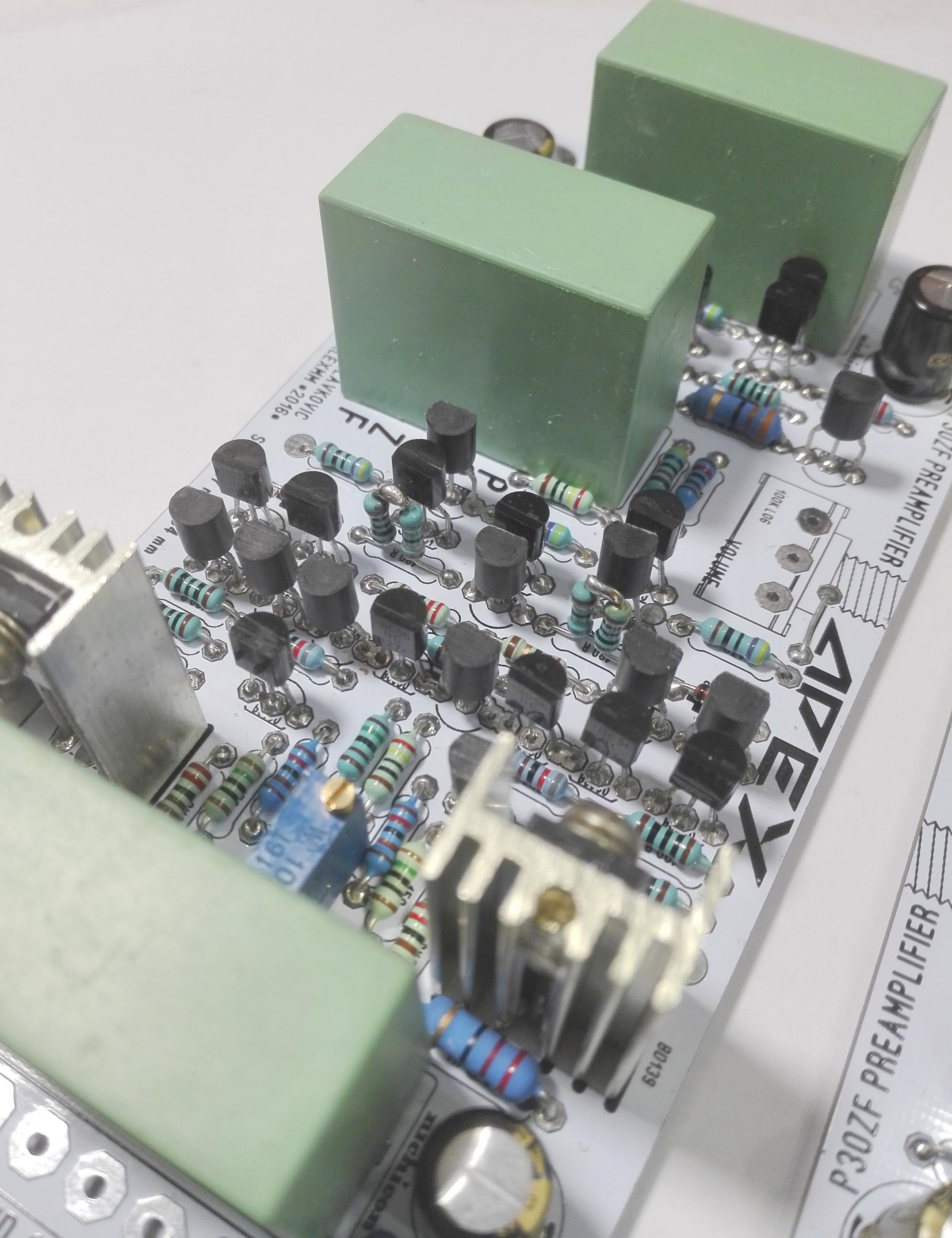

APEX P30ZF preamplifier..... ready for testing. 😉
Alex
Alex

Dear Borys,
I've tried several drivers on my 3pair precission matched 1530/201 amplifier.
I highly recommend the, unfortunately, hard to find 2sk216 / 2sj79 lateral mosfet drivers. They give me much more detail compared to the 2013\313 combo.
Alex
Love the soft pastel colours! Makes a contrast to all the blacks and dark blues that usually appear in this forum. Nice work
alex mm

Thank you Peter , and your work, also beautiful 🙂
sthcoaster , thank you 😉
Regards,Alex
Alex
Very nice photos and nice component colors. 🙂
