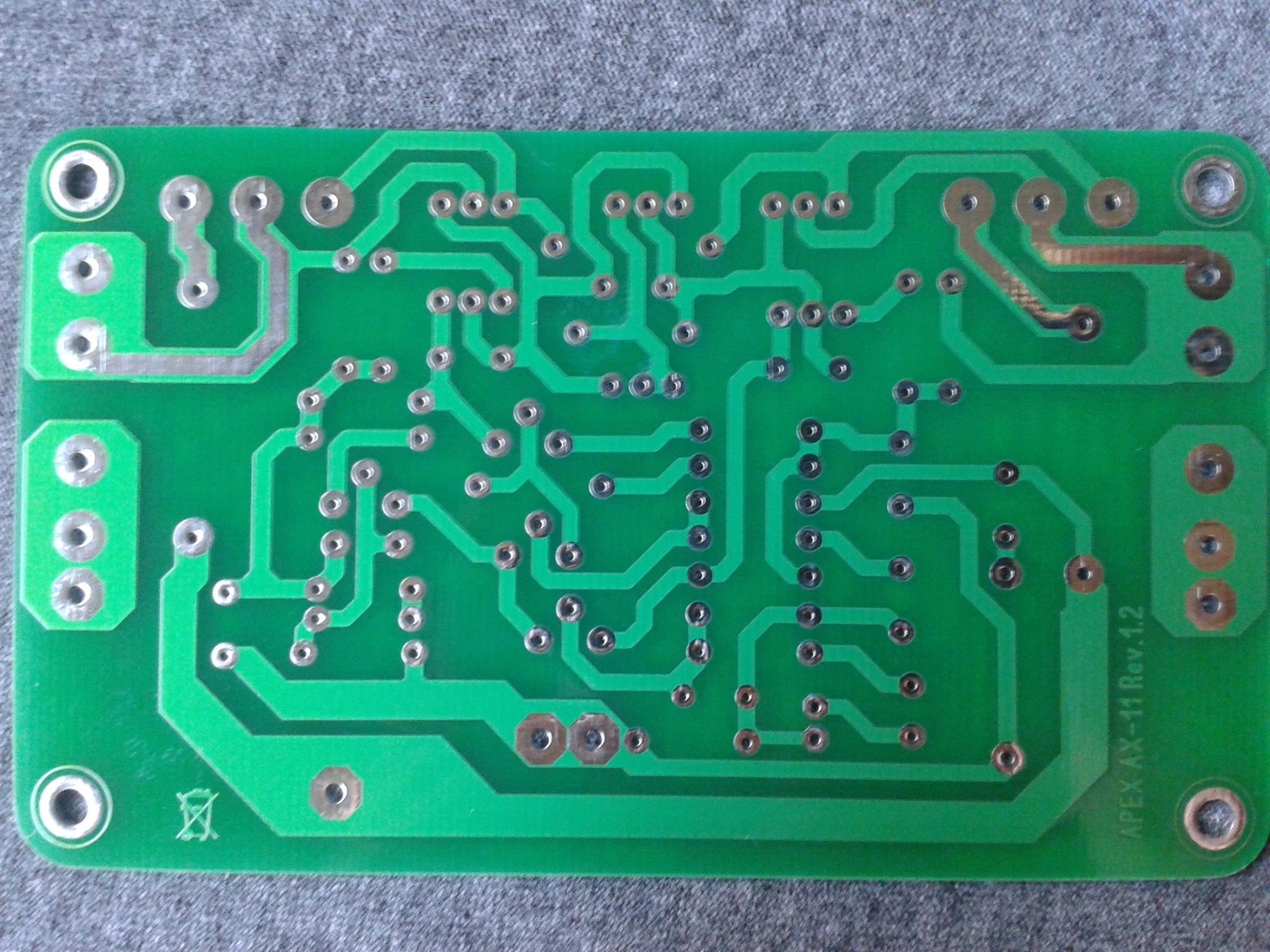

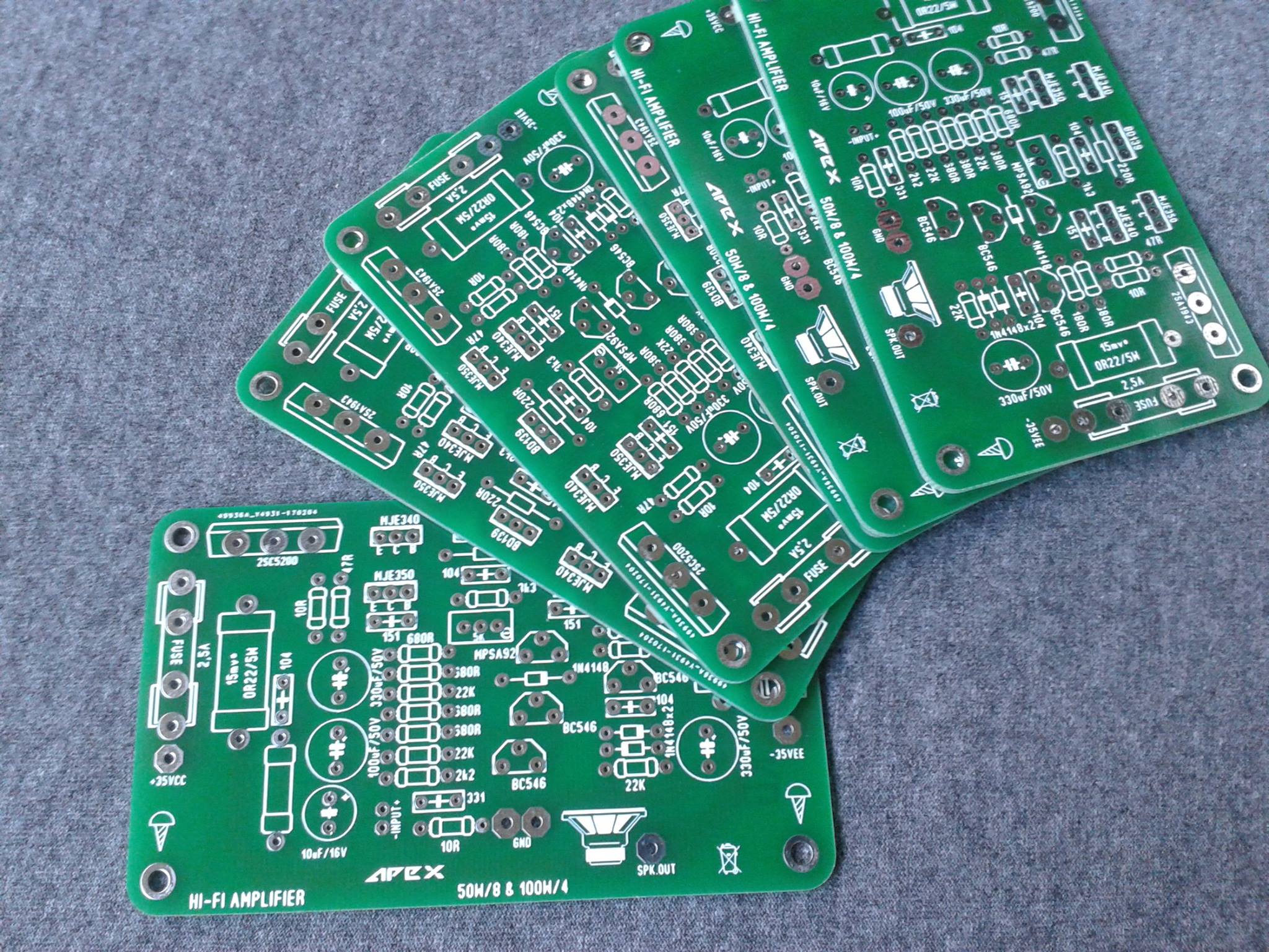

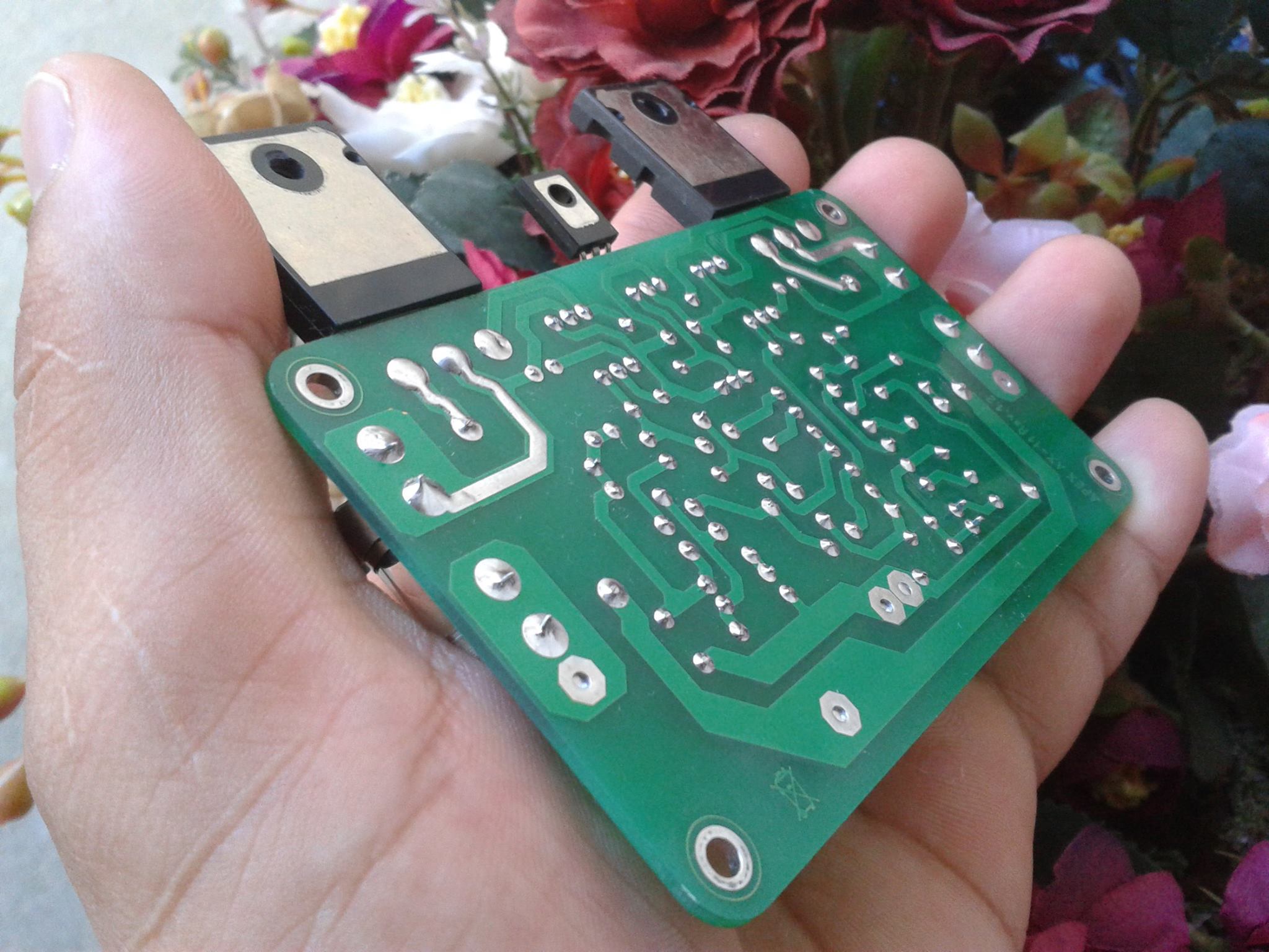

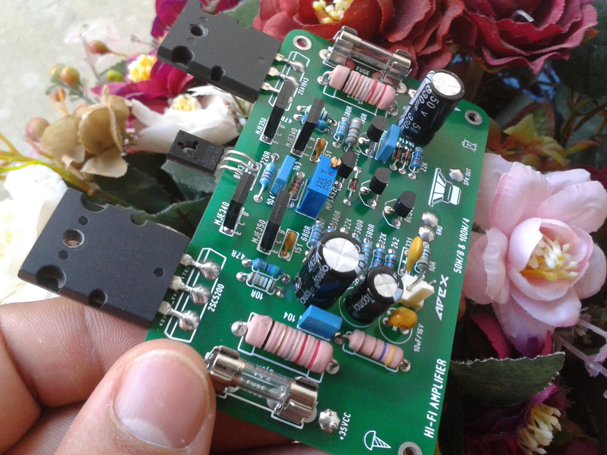

APEX AX11
Very nice looking boards.APEX AX11
Are they available as a complete kit or just the PCB?
Aubrey
Aubrey
In this specific case, these boards were made by a brazilian pal, and there are none available.
