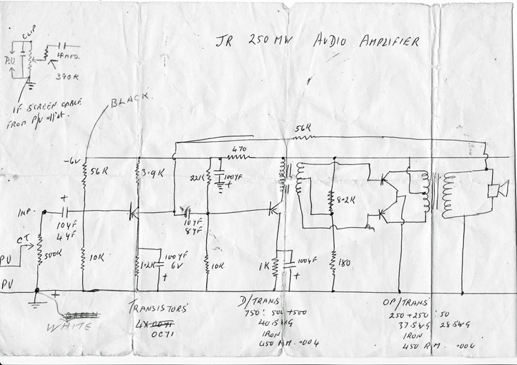

I also found the circuit diagramView attachment 607173 that my Dad drew.
this is super cool !!! - a wonderful memory item from your dad - something to treasure for sure.

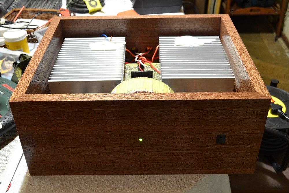

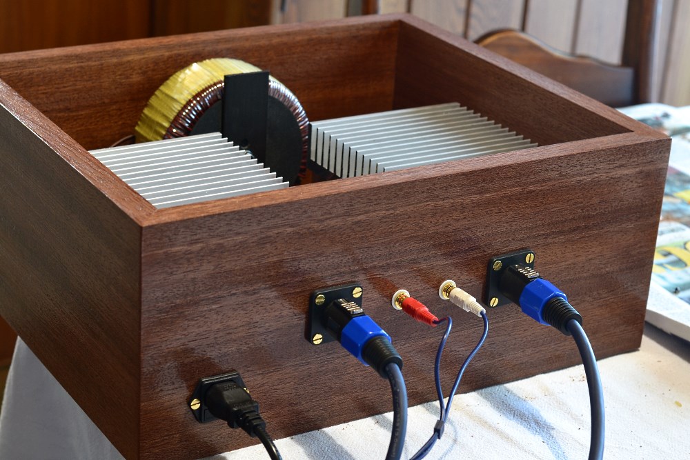

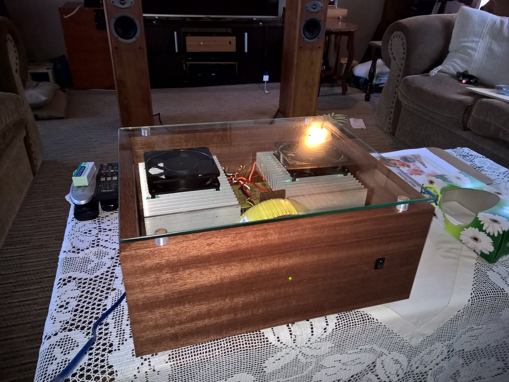

This one sounds better than it looks. I'm almost done with it - need the top and to install the fans.
Beautiful wood work. Is that Mahogany by chance ? Looks very nice.🙂
Thank you! Yes, it's mahogany sapele.
Very, very nice ! Simply beautiful !
Thanks! I'm really happy with it.
I've finished it now, with glass on top and fans installed.

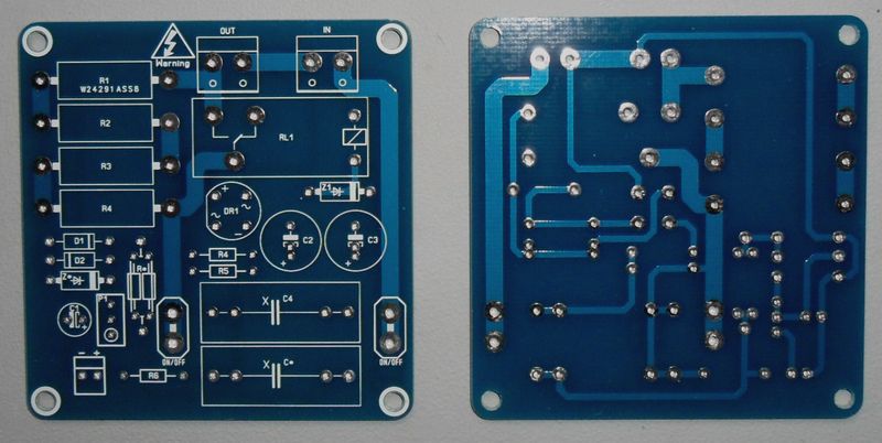

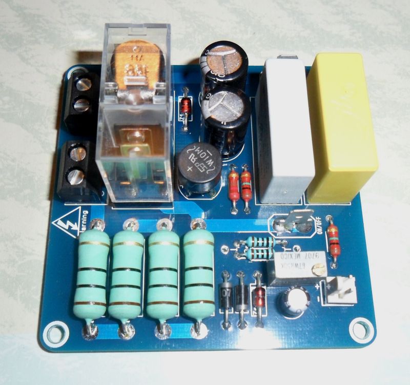

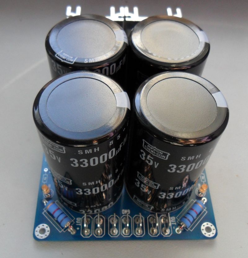

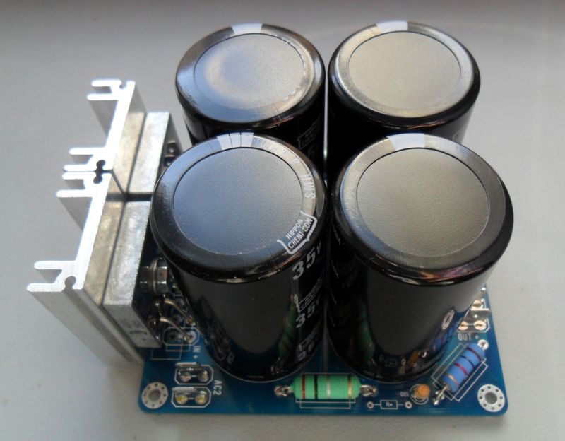

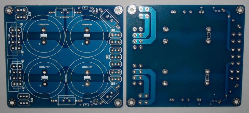

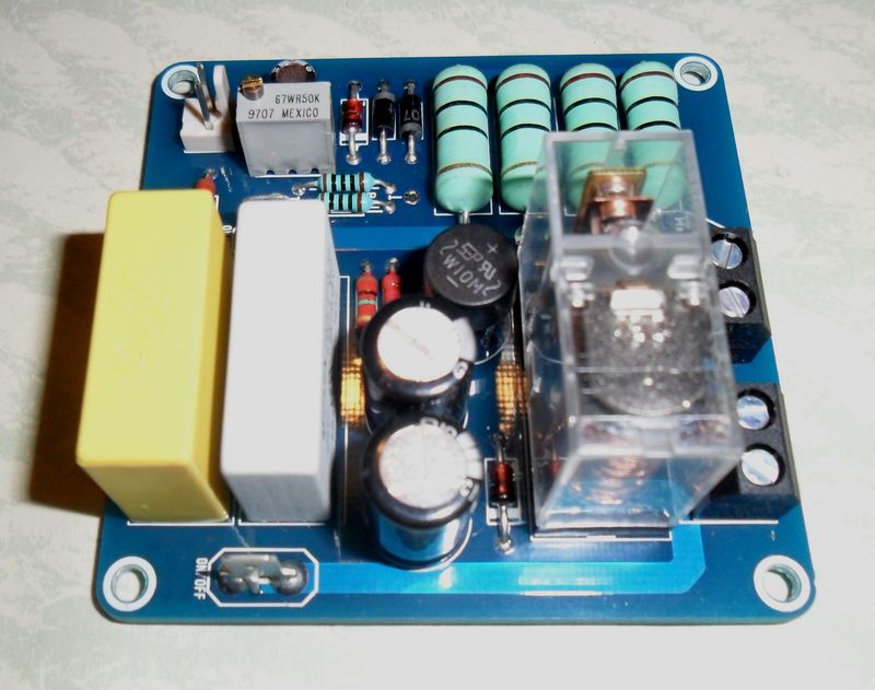

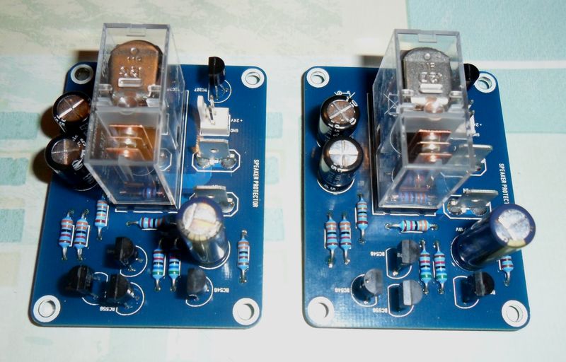

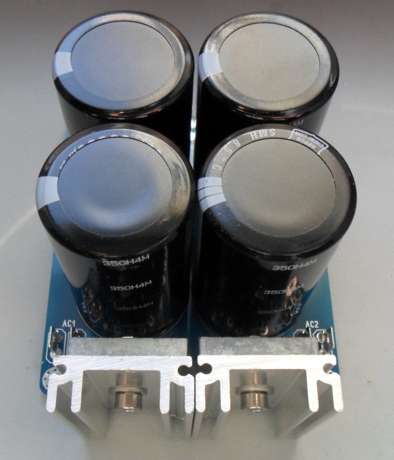

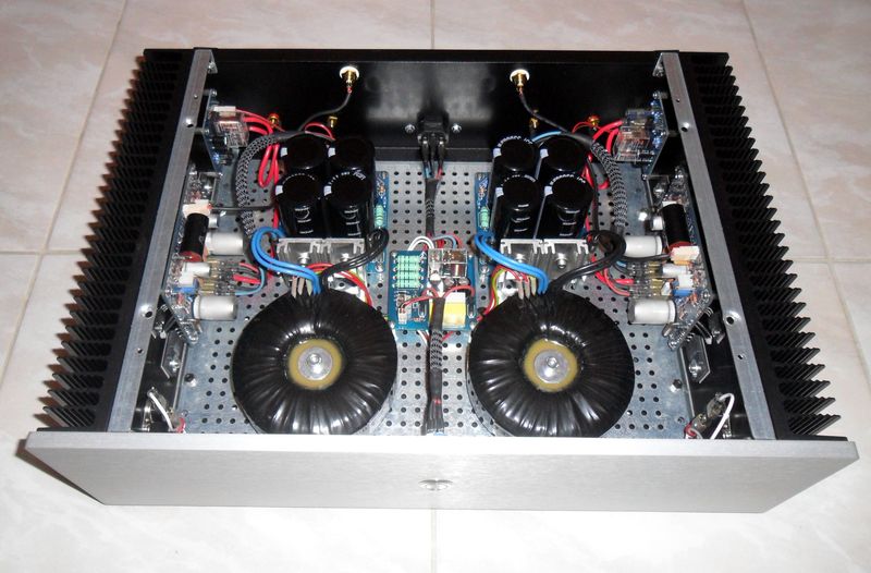

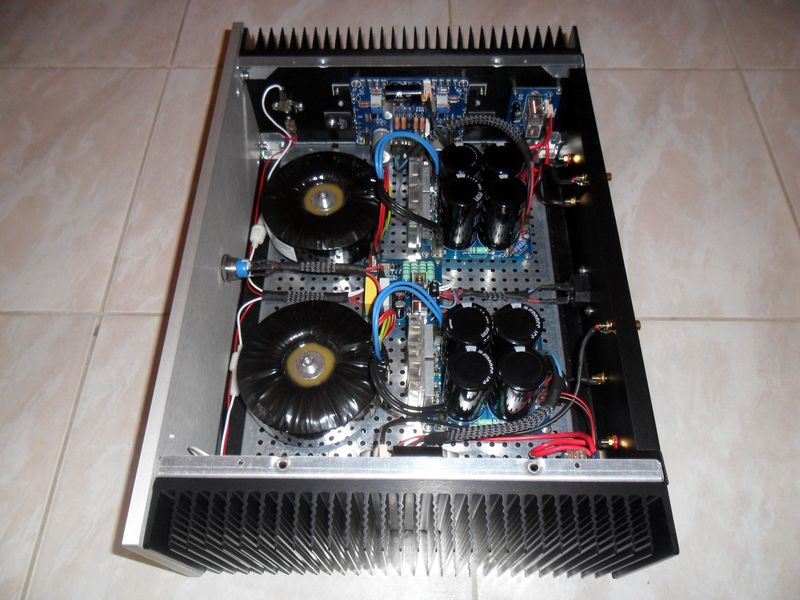

Hello everyone
After being enchanted by the sound of Fab's USSA-1, I decided to create version 5 of this superb amplifier.
This new version of a class A amplifier is characterized by more dynamic, higher damping factor and more definite sound, and even if these amplifiers are very close, undeniably the USSA-5 makes its place in the high sound reproduction.
It is therefore with pleasure that I present to you some photos of my last baby with all the PCB that I have to draw, the PCB of the amplifier was designed by Alex MM.

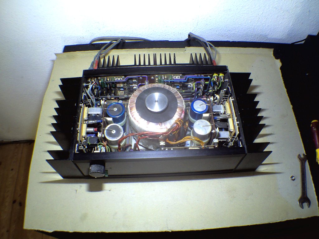

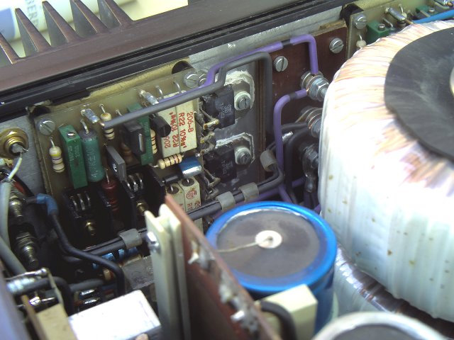

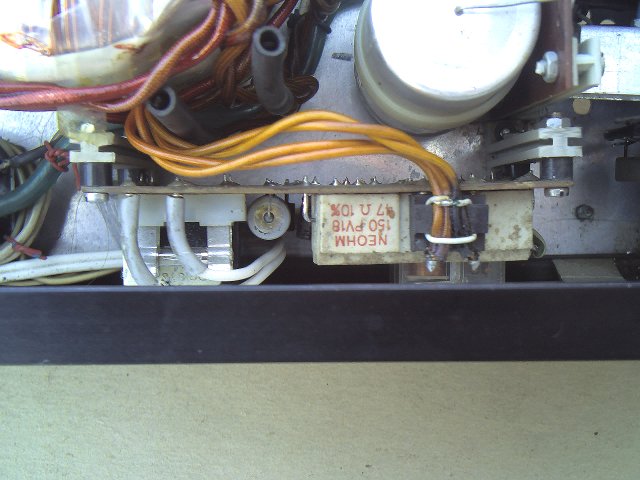

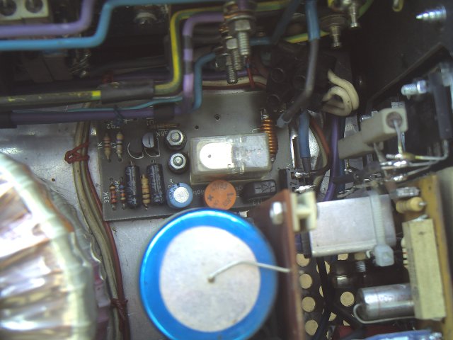

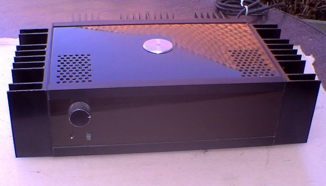

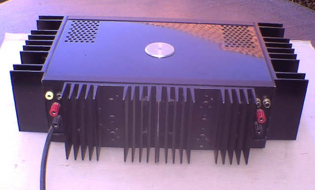

Stereo PowerAmp, build 1979, with fully regulated power supply

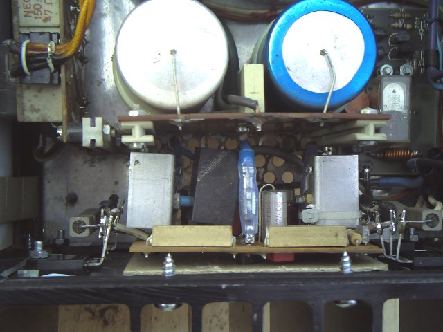

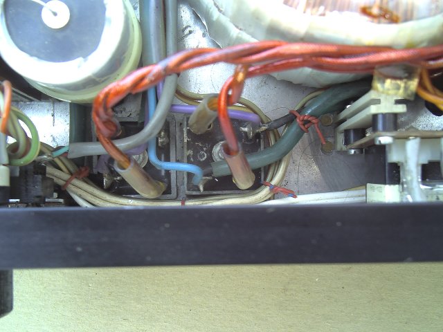

Hello all!
I made these Amp in the last 1970s. Since then it is in use every day until now.
It makes about 150watt per channel at 4Ohm
When looking inside it seems i hated wasting space 🙄
On the whole rear heatsink is the Power supply regulation and over-current protection.
It is set to +-42 V. The protection switches off permanently at 15A spikes, until the main is switched off for about 3 minutes.
Hello all!
It is a very beautiful realization entirely DIY. The wiring was done with great care.
Bravo catd!

wow! amazing skills and lot of effort must have gone creating such diy master piece... congratulations sir!
Hello!
Thank you both for the praise words, but do not exaggerate. 🙂
I am better in mechanical constructions than in the development of electronic circuits. Everything is based on very simple circuits.
The mentioned "effort" at that time was mainly that I as a hobbyist could not as easy access to components and their data as today on the Internet. Therefore the circuit development was partly based on trial and error until the right parts were found, especially at the power supply.
