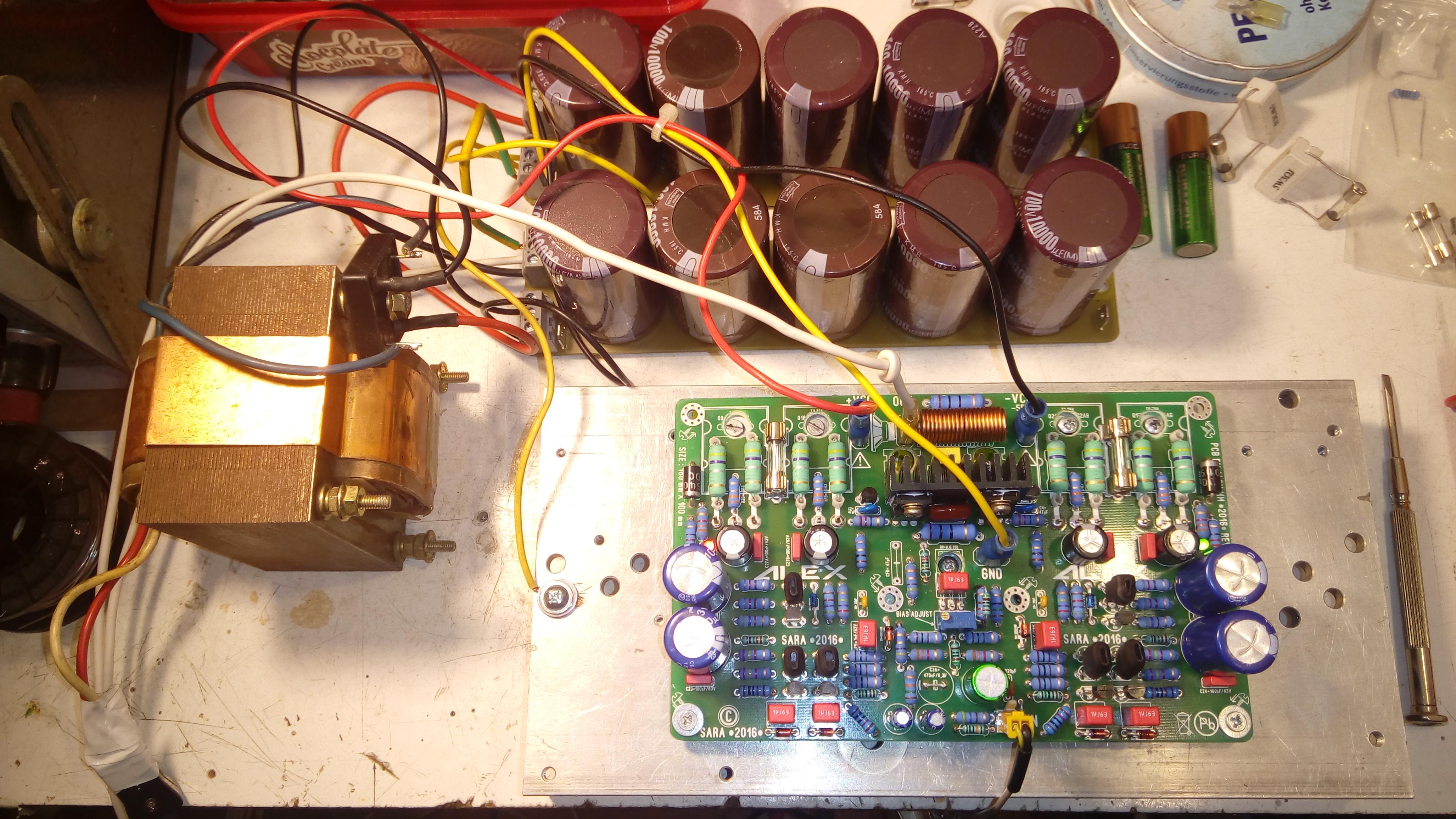

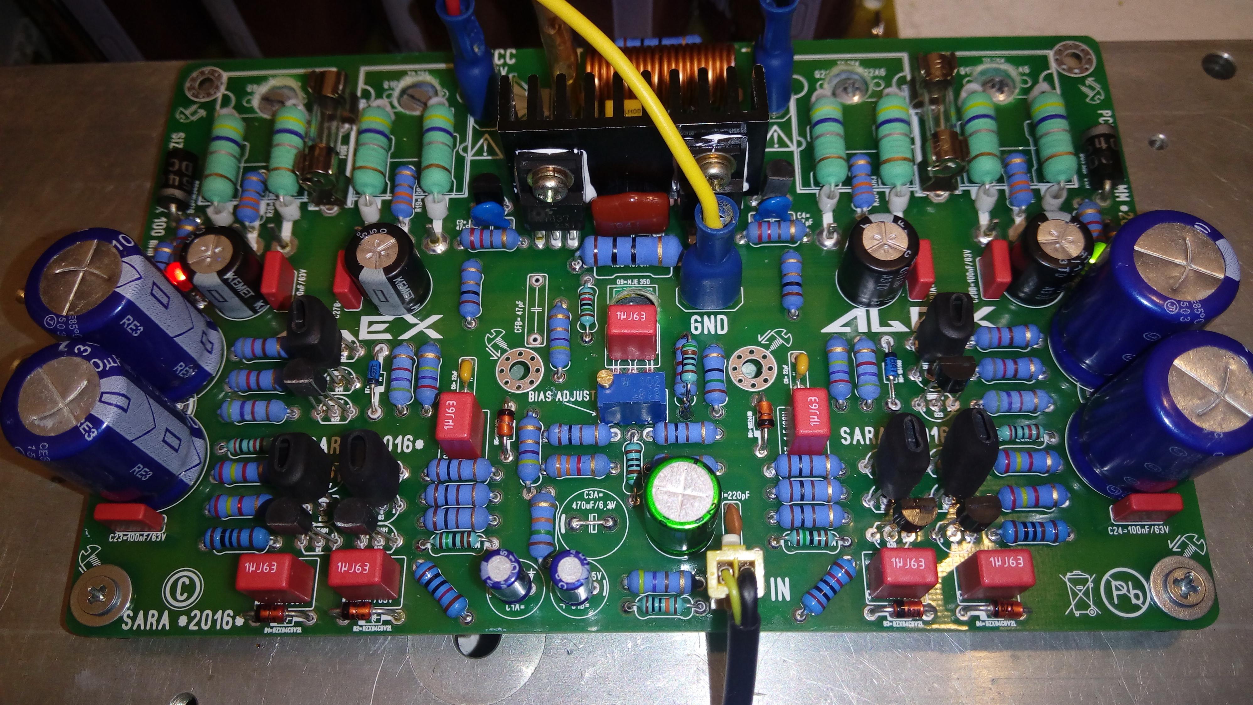

SARA 2016 V.1 tested ,and work very well
Beautiful board! Requires a proper compartment 😉

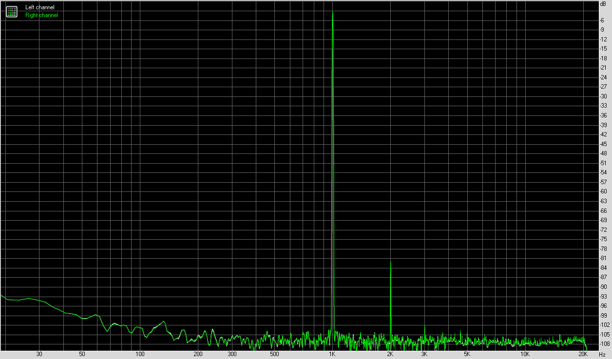

Thanks for the tip. Do you have a link? I remain skeptical that an IC opamp can measure and sound like this simple 2H and very small H3 harmonic profile. I think this will just sound better and more direct than having a forest of harmonic content (even though low in absolute value). The amp needs to be single ended to have this profile I think. Most opamps have differential long tail pair inputs which cannot look like this.
Can an opamp do this? I don't mind the heat - what's a few watts of dissipation between friends 🙂

That's a measurement I have never done.
Looks like the tiny blip after equallising the voltage of the in/out is the phase delay of the out vs the in.
Does anyone agree?
What happens if you use the horizontal expand by 10?
Can you see where the blip coincides, near the beginning of the rise, or near the end?

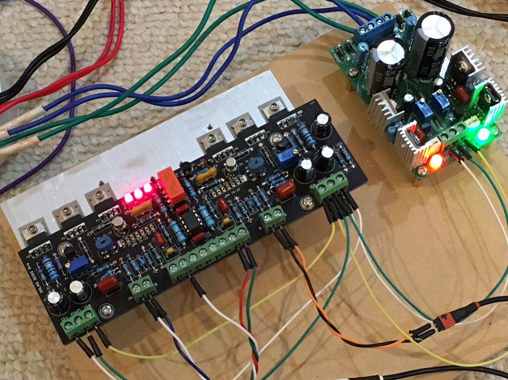

Here is another quick update with the ongoing progress. Now equipped with balanced input board.

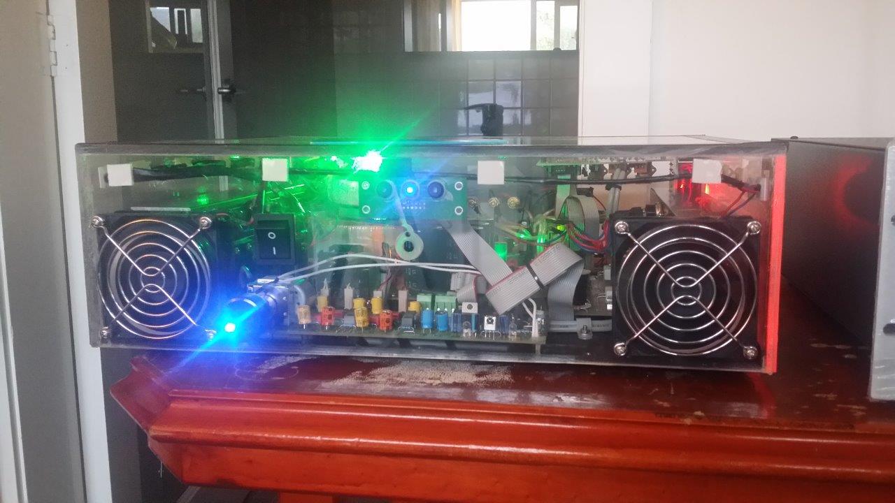

Silicon chip Ultra Ld Mk3 in an acrylic (Perspex) enclosure, yes it does work, but keep source device and speakers a distance away. Looks cool and sounds great![]()
That does look cool. 🙂 I like it. It gives the techno look alright when one can see some of the guts inside.
But my curiosity, what is the bright green light ? General illumination of the circuitry inside ? It seems very bright.
Cheers
