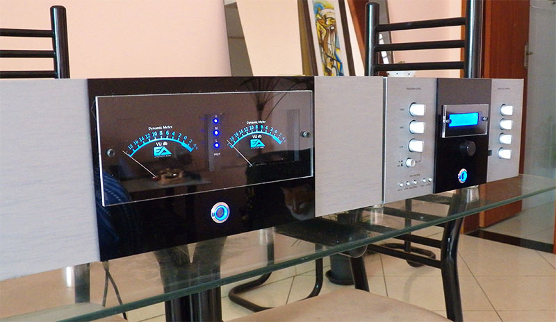

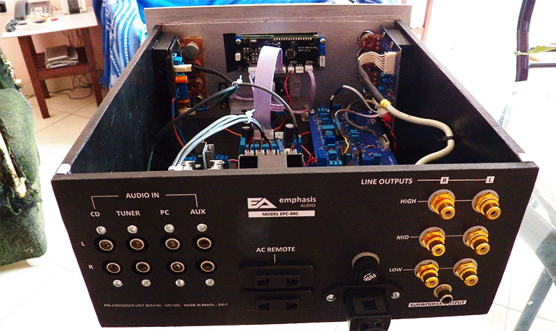

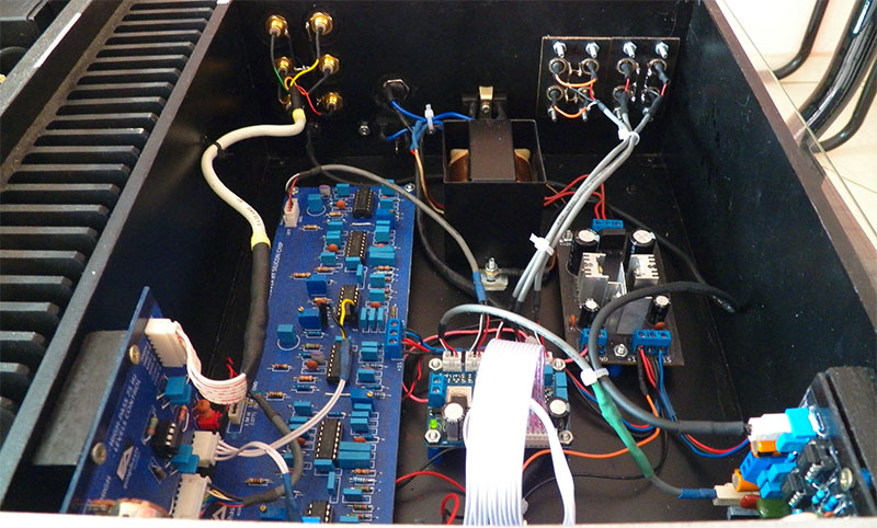

That does look cool. 🙂 I like it. It gives the techno look alright when one can see some of the guts inside.
But my curiosity, what is the bright green light ? General illumination of the circuitry inside ? It seems very bright.
Cheers
Thanks, it's from the power supply at the rear of the enclosure, the pcb has three led's so I swopped then with Cree high bright types.

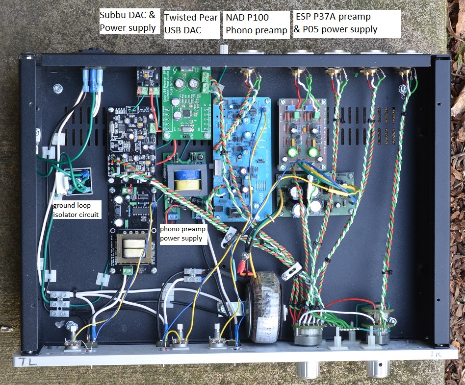

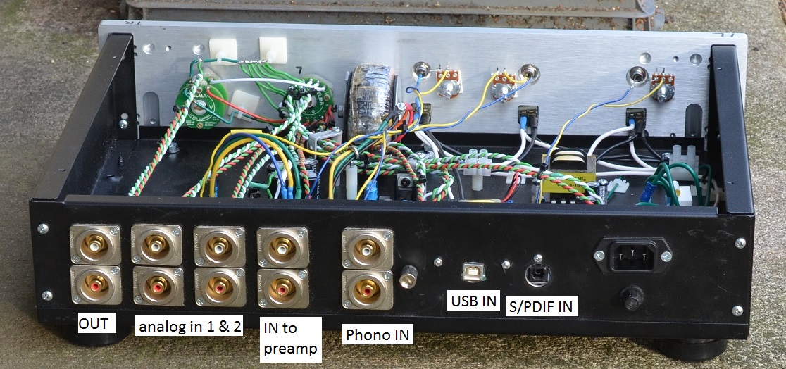

My latest build: preamp/control center
Here is my latest creation. It’s an all-in-one control center, so to speak – what used to be called a preamplifier. It consists of:
· A Twisted Pear USB DAC Receiver The USB DAC/Receiver
· The Subbu DAC V3.0 and power supply with a TORX S/PDIF input module. http://www.diyaudio.com/forums/grou...-wm8804-spdif-power-supply-pcb-group-buy.html
· The board from an NAD P100 Phono Preamp. The NAD P100 came with a wall wart power supply, so I bought another power supply with the same DC voltage, which I could put inside the chassis.
· An Elliott Sound Products P37A “Death of Zen” preamplifier and P05 power supply. Minimalist Discrete Hi-Fi Preamp Because most sources don’t require a preamplifier, I connected only one pair of inputs to the “signal in” of the preamplifier board. The “signal out” from the board then goes to the selector switch.
· Two passive analog inputs.
· A ground loop isolation (loop breaker) circuit Earthing (Grounding) Your Hi-Fi - Tricks and Techniques
· ON/OFF switches for the three power supplies (the Subbu DAC, NAD phono preamp, and ESP preamplifier) and indicator LEDs. Because each power supply had different voltages for the LED indicators, I used variable resistors to make all three LEDs the same brightness.
· It’s all inside a Pesante 2U chassis with from the diyAudio store Pesante 2U – diyAudio Store I had the graphics on the front done by Front Panel Express https://www.frontpanelexpress.com/

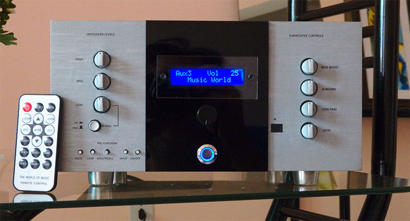

Hi! I finished today the pre + 3-way crossover + subwoofer filter + remote control. It will pair with my tri-amp previously posted.
Looks really good. 🙂
small loop areas are more tolerant of emi.Hi Byron. Don't you get some hum from having a transformer so near to the selector switch?

I tried searching for the circuit diagram of the NAD P100 phono stage but couldn't find it. Do you have it ? Thanks.
