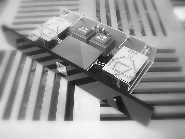

Little Brother
2 X 1.2 watt
ACEA Ultimate quality Output transformer
AD161 power device
Only two kiwame resistor in the signal path
100000 µf Rubycon MCZ capacitors
Power Bridge silver wiring
No feedback configuration
PFM petite fabrication musicale
2 X 1.2 watt
AD161 power device

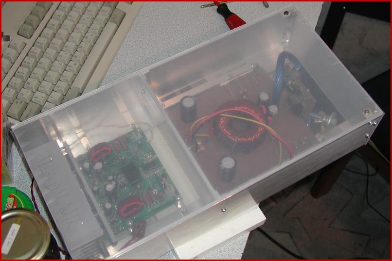

10" is to vibrate when you cell phone rings 😀 15" is something that I can listen to 😀 Hey if you ever will come to Slovenia, let me know, will see what we can do about listening 🙂lineup said:this is a nice
advanced car amplifier built by luka
i like your transparent casing
where we can get a hint of what is inside
Hint, well you can get it here, but of course 🙂, ok so plastic cover, plexi glass, is now still semi transparent, cot both sides are still protected. Inside lives the beast with name AMP2 from 41Hz.com. It gets suppy voltage of +/-60v from 12v push-pull smps that I've build, and all this is placed inside of "case" that I've build. It is 2 channel amp, each channel can drive 4R as set by overcurrent, but I had 2R on it too...with this suppy voltage it is 2x400w rms, which will be bridgable...I think You can find more on my site, if not I will make one...Works great, amp is just SOOOOOO good, one should get one, almost no heat when driving 2R hard, smps is dead cold, probably will need heating during winter LOL...O and yes it IS full range!

I thought i would tell diyaudio builders
that using transparant plastic case is not always to recommend
not for normal amplifiers that needs much cooling/heatsinks and good ventilation of air
but when using the cold new technique, with little power losses only,
that runs very cold, we can no problem use non-metallic cases
and also use plexi-glass coverings

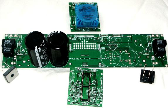

image below shows the soon coming AMP7 prototype, for > 2x500watt output:
http://www.41hz.com/main.aspx?pageID=122
AMP7 - Heavy duty modular amp
This heavy duty amp is the first modular amp from 41Hz Audio. It is built on three boards, which fit piggyback:
* One main board for the power supply and power FETS and output sections
* One sub-board with the Tripath processor and the analogue input section
* One small auxillary power supply board

very nice
looks like some professional Krell amp (not like diy audio)
very beautiful 2 x 1.2 Watt RMS amplifier
