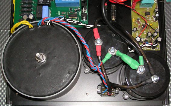

smithy666 said:And the last one showing the transformer/caps again and the Borbely speaker protection (DC detect/delay on)
So your not using Aussie Amps PSU? How do you have it wired up then? Do you have a diagram?
What kind of fuses are you using between the caps and amp module?
And what is the black connector the blue and red cables are connecting into and then leading to the caps? (http://www.diyaudio.com/forums/attachment.php?s=&postid=1578960&stamp=1218018572)
No I'm not using their PSU. The wiring is a pretty standard amp PS configuration - the transformer has 2 x 45V/200VA per winding taps (+ 2x12V for the speaker protector). The two 45V taps are wired in series, forming a 45-0-45 configuration with the centre (joined) wire connecting to the 0V of the Mundorf caps (the mundorf caps are wired in series +:- joined +:-, with the join being 0V). The 45/45 leads connect to the bridge and the +/- of the bridge connects to the +/- of the caps. The +/- from the caps (which are now about +/-67V without load) are connected to the amp modules +ve, -ve via 5A fuses mounted on the sub panel. The 0V from the caps is connected to the amp module's 0V (PS GND). Mains earth is also connected to the gnd on the amp module.
The "black connector" is the IXYS bridge rectifier mounted on the sub panel.
That's it! Sorry if it is not clear - following the wiring on the photos should help. I can quickly whip up a schematic if it helps

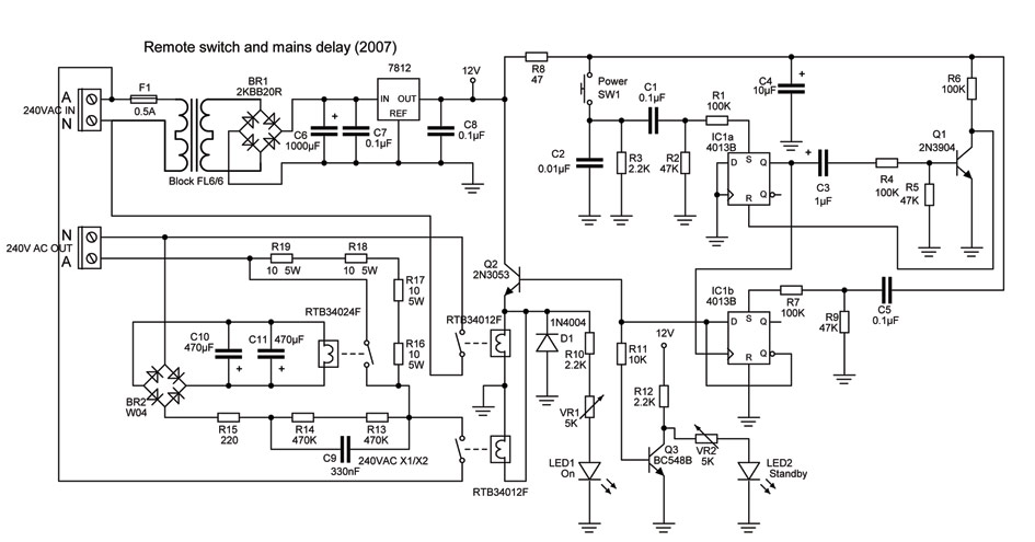

smithy666 said:This is my softstart board (see another thread if anyone wants PCBs)
Nice job - pretty neat!
Could you please point me to the thread about your softstart?
Thanks!

Re: Hi!
Here is the softstart/remote switch schematic
zeonrider said:
Where is the schematic of Soft-Start circuit & the rest?
Regards zeoN_Rider
Re: Re: Hi!
smithy666 said:
Here is the softstart/remote switch schematic [/\
QUOTE]
Thanks!
Regards zeoN_Rider

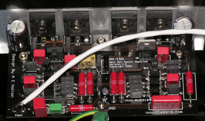

nxv500
Hi Guys
Here is my latest creation for those that are interested.
310 Watts RMS continuous sine wave into 8 Ohms
550 Watts RMS continuous sine wave into 4 Ohms
860 Watts RMS continuous sine wave into 2 Ohms
Hi Guys
