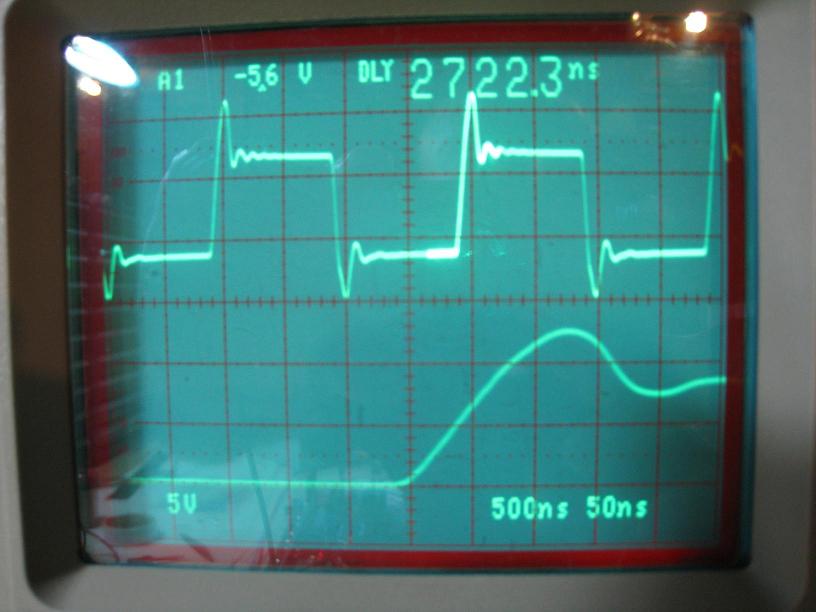

Also if it is easy, an indicating photo from your scope screen?

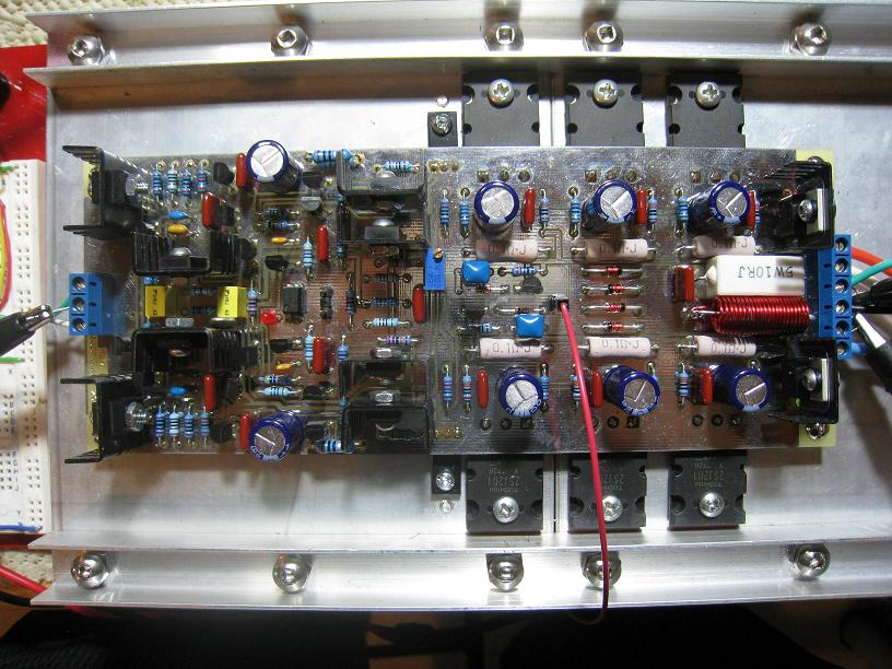

I've been lately extremely busy with my dayjob - I'm afraid I have to delay publishing the new amp on my web site.
Here's a quick snapshot of the YAP amp pulse response in a capacitive load.
- 10Vpp 500KHz pulse.
- 4ohm || 100nF load.
- Zoebel network is in place: 10ohm+100nF
- 0.6uH (damped by 4.7ohm) output coil.
Upper trace is real time, lower trace is delayed sweep (magnified trailing edge).
Nice amp (yours) BTW. If I would have the same talent, pacience and time to lay out PCBs as yourself I could probably save a little fortune in PCB costs.
A better photo of the finished OPS:

Your YAP is a very good amplifier .. and you know it ;)

Syn 08-well done, very nice PCB. Amp looks to be stable. 2 Months ago, i tried the Alexander amp construction. Now i´m working on PCB, because original PCB looks awful, separated output stage etc..my prototype board worked very good, afer some little changes(-3dB at approx 700kHz in 6.6Ohm). I want to use it for driving the tweeters on my 2way system(nowdays completing).

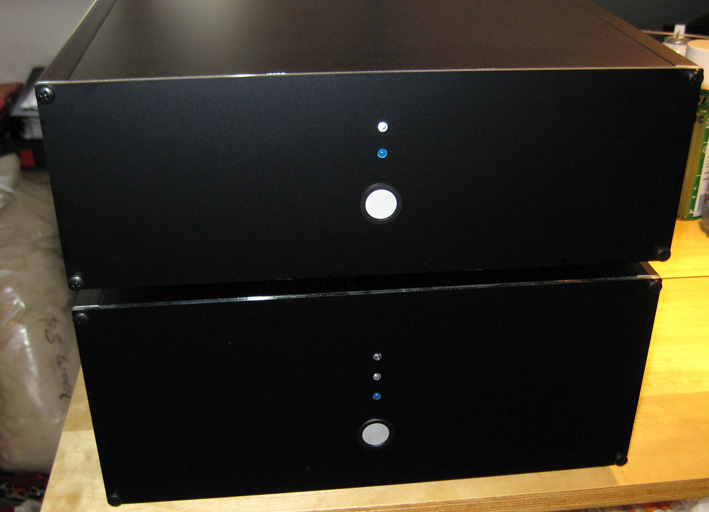

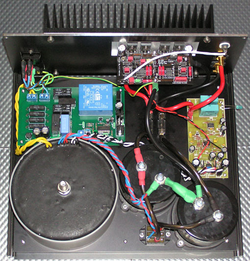

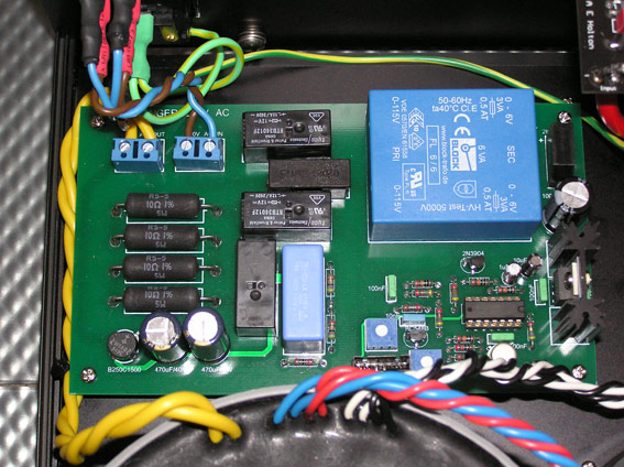

337alant said:
My compliments sir!
First class hardwork. Nice cases. From where they have find you?
Thank you, the cases are from Modu in italy
Amplifer boards from Avondale Audio
Your work is also excellent
Alan
Many thanks Alan for the link!
Nice cases in very logical price! And first of all from a country near all of us the Europeans.

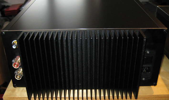

And the rear of the NX150. Conrad heatsink, WBT RCA and binding posts. The cases had to fit a particular size (non standard), so I was limited as to what cases were available. In the end I designed them using Front Panel Express' software.
Inside the amp case (as per photo on previous page) is 1 x Aussie Amplifiers NX150 module, custom 400VA potted toroid, 2 x Mundorf 47000uF/80V caps, Borbely speaker protector and my own soft start/switch on board. Now to finish the 23W subwoofer...

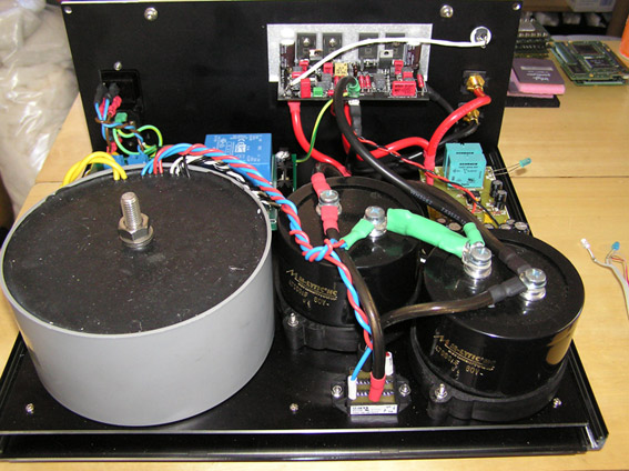

Do you have a picture of the inside? How did you fit the Mundorf 47000uF/80V caps? to the PSU? or to the amplifier module?
Here is a pic of the inside (top view) showing the transformer, caps etc. I designed the case to have a sub-panel. All the electronics mounted on this and this subpanel was then bolted to the bottom panel with 9 standoffs.
