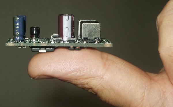

Re: Re: nxv500
Thanks for the praise dudaindc
Here are some more specs for the nxv500 module.
310 Watts RMS continuous sine wave into 8 ohms
550 Watts RMS continuous sine wave into 4 ohms
860 Watts RMS continuous sine wave into 2 ohms
Frequency Response 5hz to 300khz
Power Bandwidth 5hz to 100khz
Dampening Factor At 100hz 8 ohms =1300.00 - Output Impedance = 5 milliohms
Dampening Factor At 1khz 8 ohms = 915.00 - Output Impedance = 8 milliohms
Dampening Factor At 10khz 8 ohms = 248.00 - Output Impedance = 32 milliohms
RCA Single ended Input impedance 20k
XLR Balanced Input Impedance 40k
Closed Loop Gain 31dB
Signal to Noise Ratio -120dB
THD+N - TBA
Power Supply Rejection Ratio 105dB
Recommended Linear Voltage Supply +-80 volts DC
Recommended SMPS Voltage Supply +-75 volts DC
Operational Supply Voltage Range +-10v dc to +-95 volts dc
PSU Power Transformer secondary windings 55vac to 60vac (800VA Core)
Printed Circuit Board Dimensions 220mm x 50mm
Recommended Conrad heat sink MF30-10

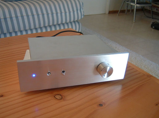

FastEddy said:As a great admirer of 41Hz products, I sure would like to see some pics completed amps or "step by step assembly", either of this newer amp module(s) or others.![]()

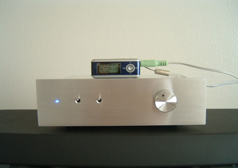

I made a little amp with the 41Hz Amp3. I still have it and use it to compare my own class D amp design to. This is far from fancy, the entire bottom plate became the heat sink.
Terry

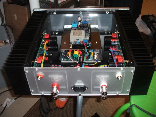

DHR-DX TURBO amplifier
.... Hi all ,
Schematic from uncle Carlos M. and PCB by me 😀 http://i36.tinypic.com/fp43t0.jpg .Regards alex mm
.... Hi all ,
