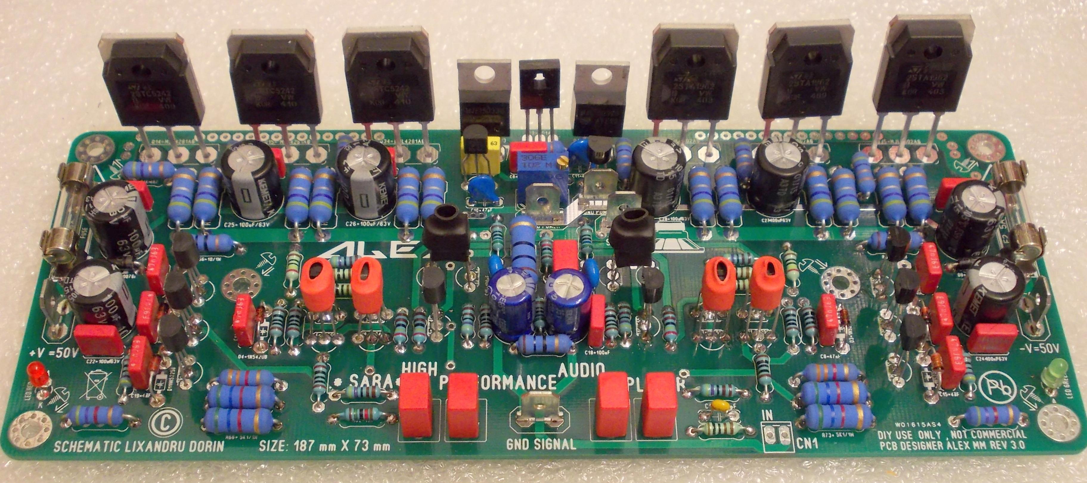

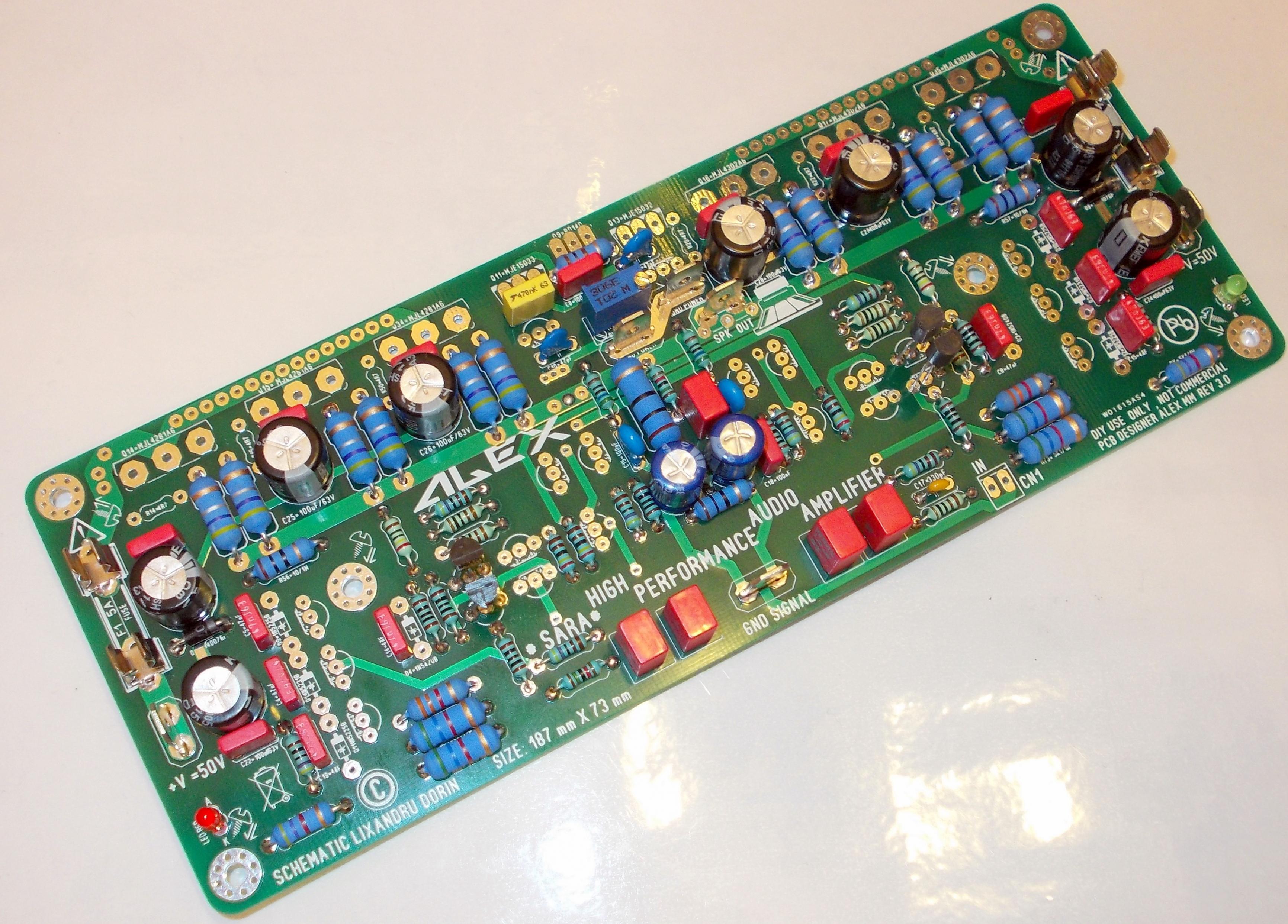

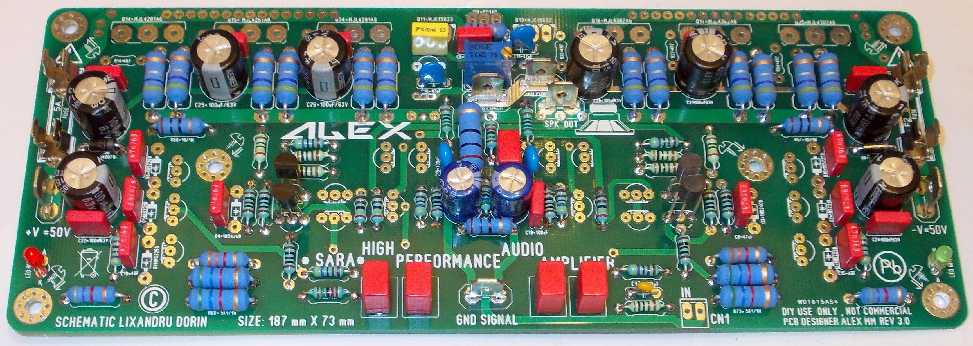

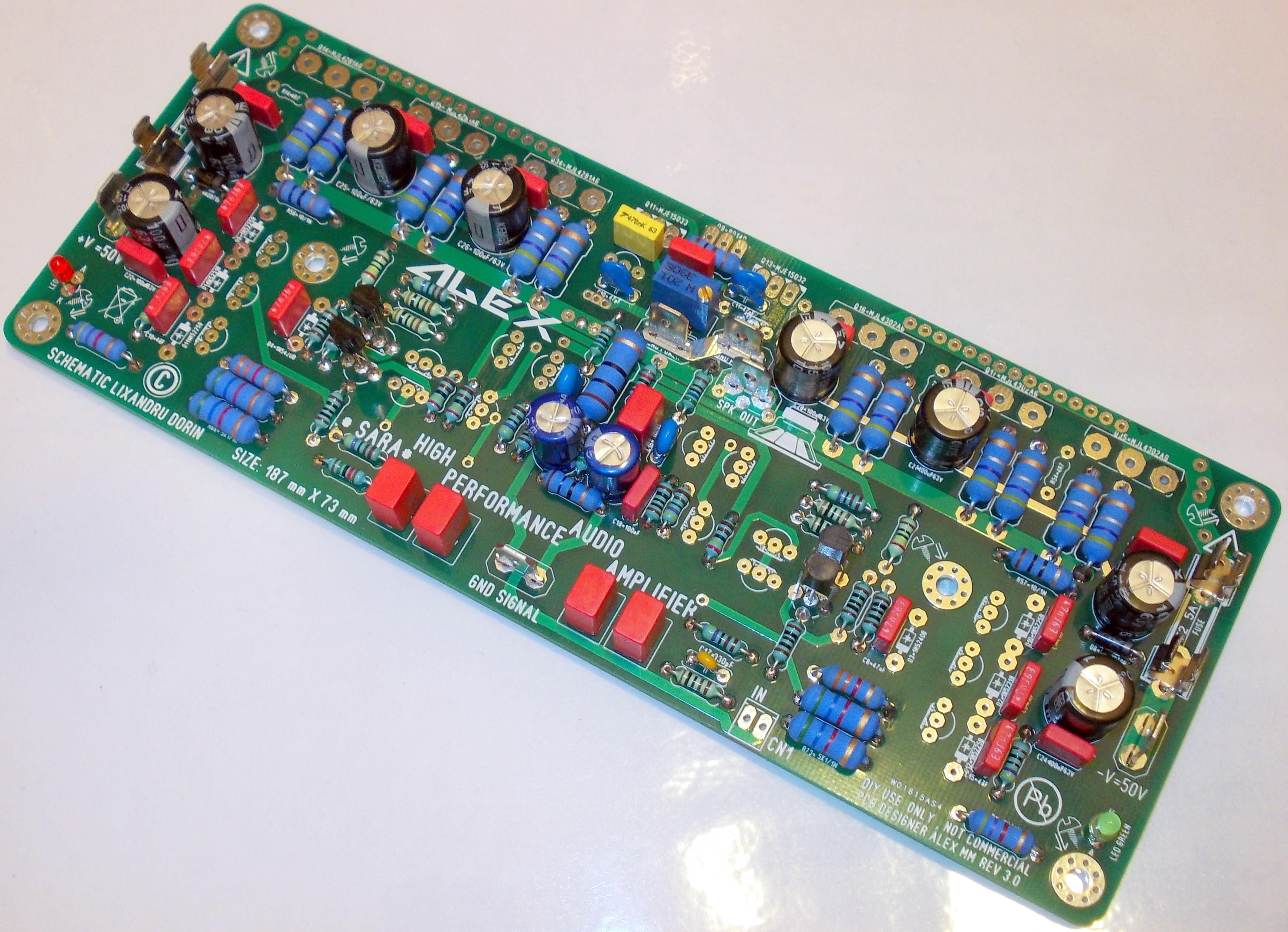

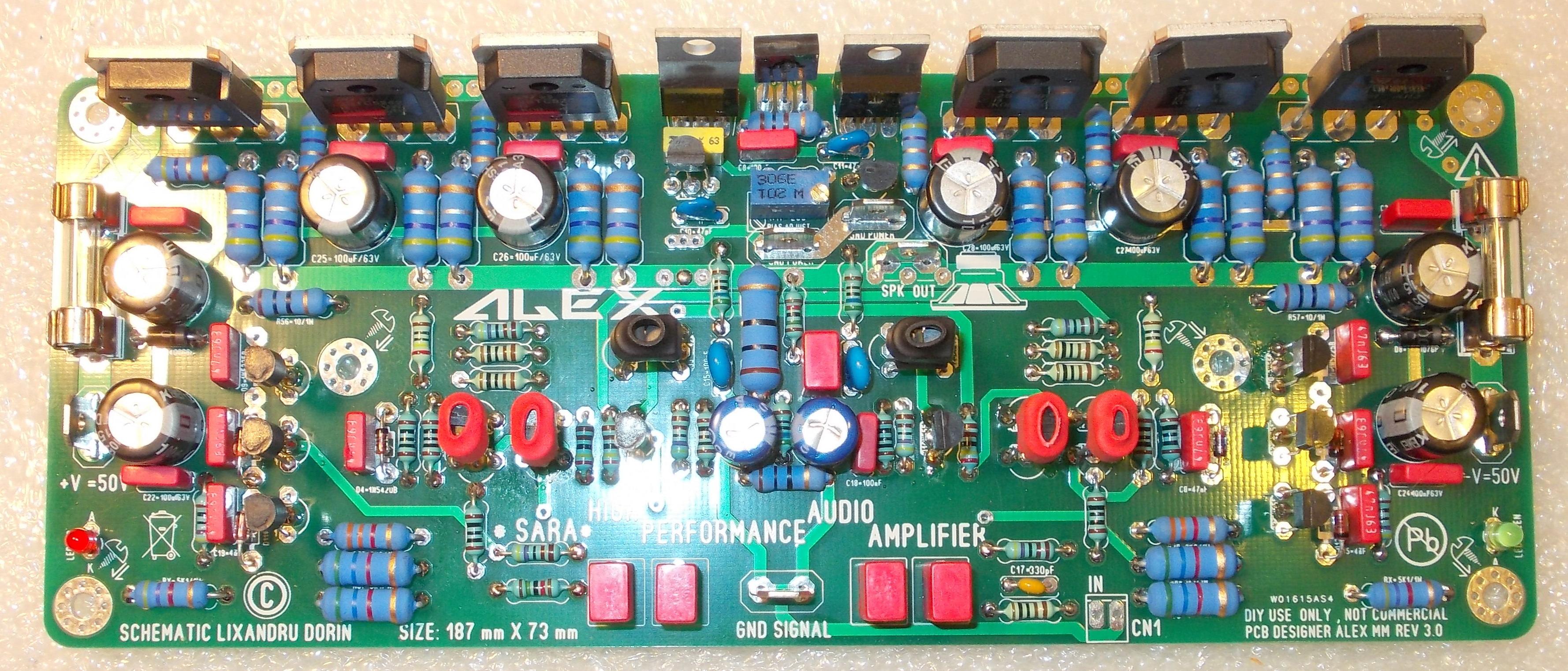

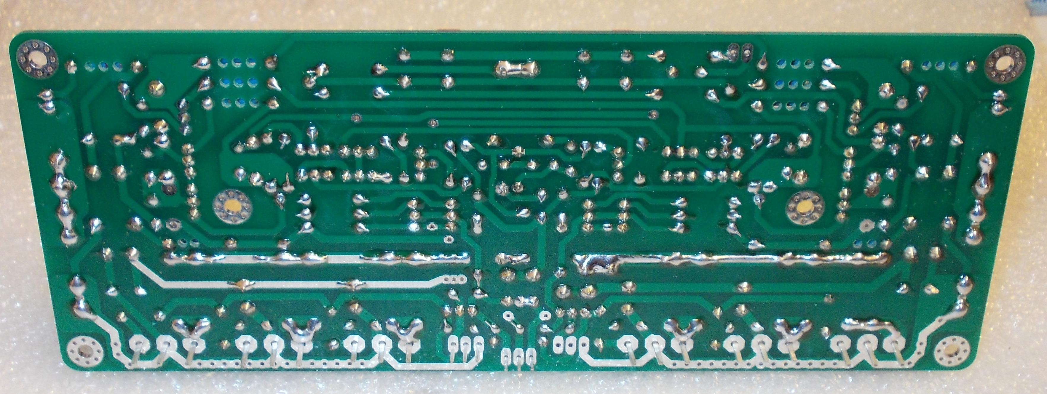

Just another amplifier also in progress ... 😀 same schematic but dual layer PCB
