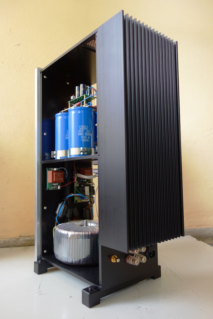

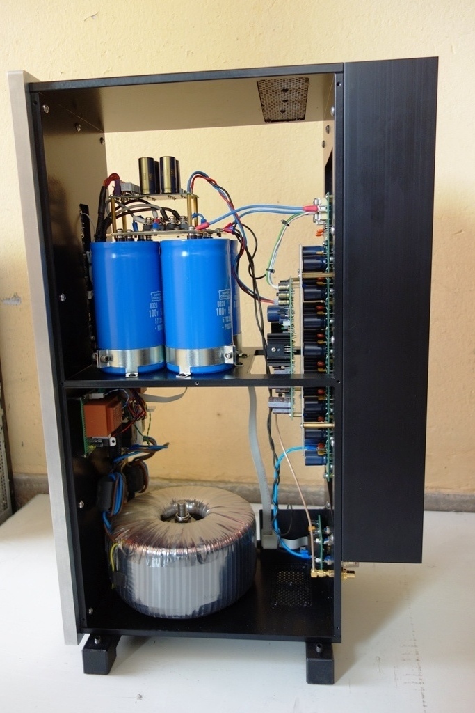

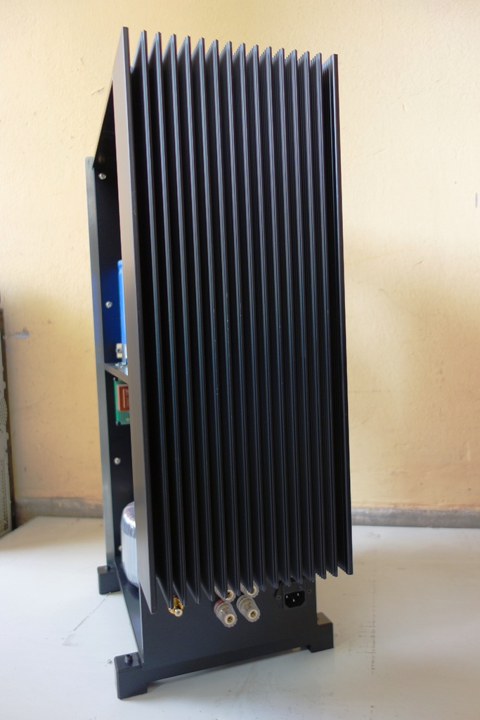

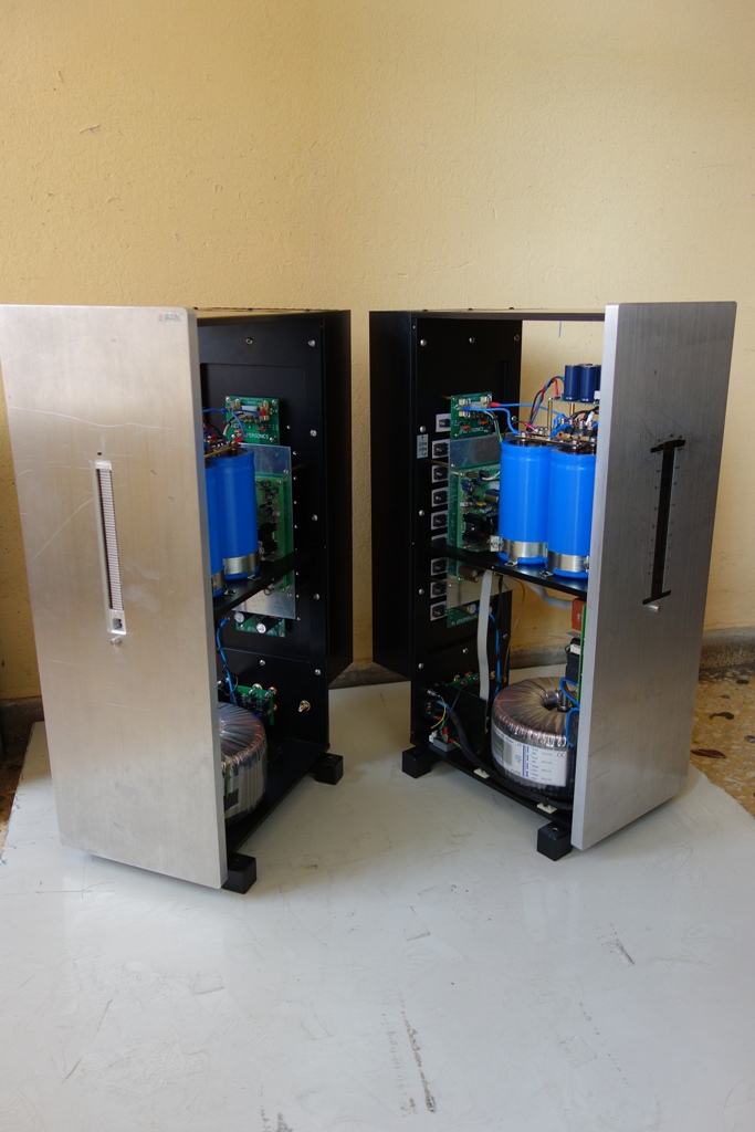

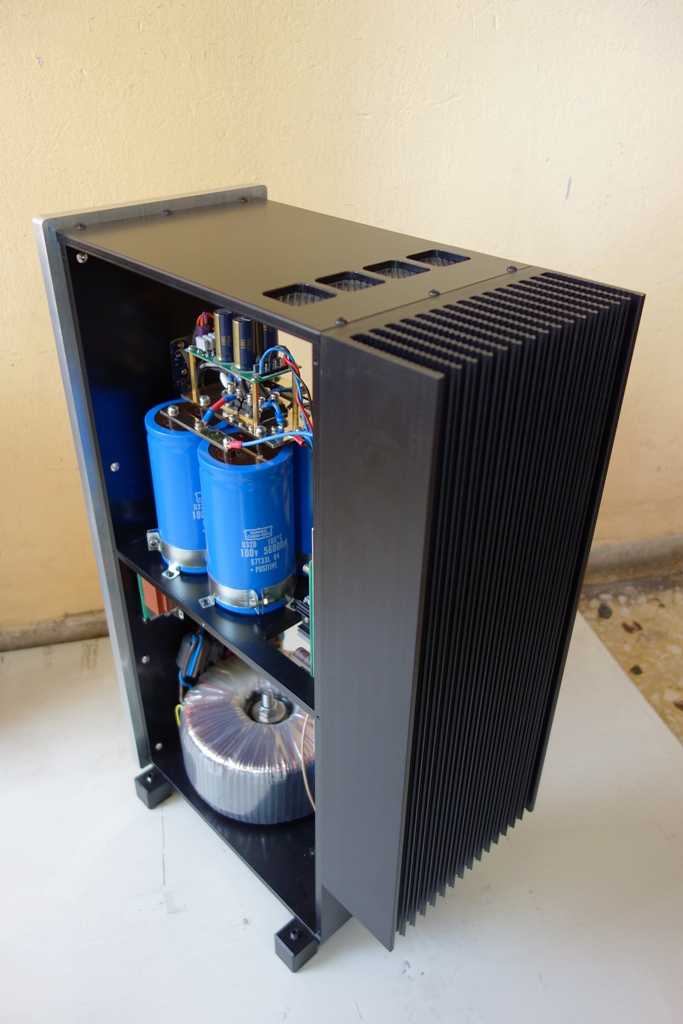

Yes it's SARA . And new pictures .... 🙂

Yes, there is no problems with 4ohm loads and it can drive and 2ohm loads for a resonably time.Hi Alex,
Is it based on your own design? I searched the web for Sara amplifier and found some posts for 2014 but at the time, the amplifier was able to drive 8 ohms load and down to 6 ohms but can it now support 4 ohms load and maybe a little lower?
Do
it can drive 2ohm loads for a reasonable time.
(one look at the output device package type tells me that isn't true)
Better looking on the motherboard . You will see the recomended transistors. The power supply voltage is +50v/-50v. "Resonably time" mean that time when the amplifier have a real loudspeakers at the binding post with 2ohm impedance in the narrow band on the real music.
For 8ohm and 4ohm can be a resistive load on a sinusoidal signal test.
What I see is TO-3P output devices.
3 pairs of those are of significance for 8 and 4 ohm loads.
For 2 ohm, they're not even the equivalent of 2 pairs of TO-264's
(maybe your definition of the narrow band on real music is limited to tweeters)
No. You see only what you want to see. If u are looking at the empty board, without final transistors , you will see the recomended transistors. There are MJL4281 and MJL4302. That It is clearly visible.
Alexmm put the STA1962 instead of MJL4302 because his speakers there ar not representing a heavy load and the Ccbo of the final transistor it is much smaller.
Narrow band of the impedance of the loadspeaker versus frequency. I did not see speakers with 2ohm on a wide band of frequency. The same thing for a combination of a resistive and phase component which equates a pure resistive 2ohm load current.

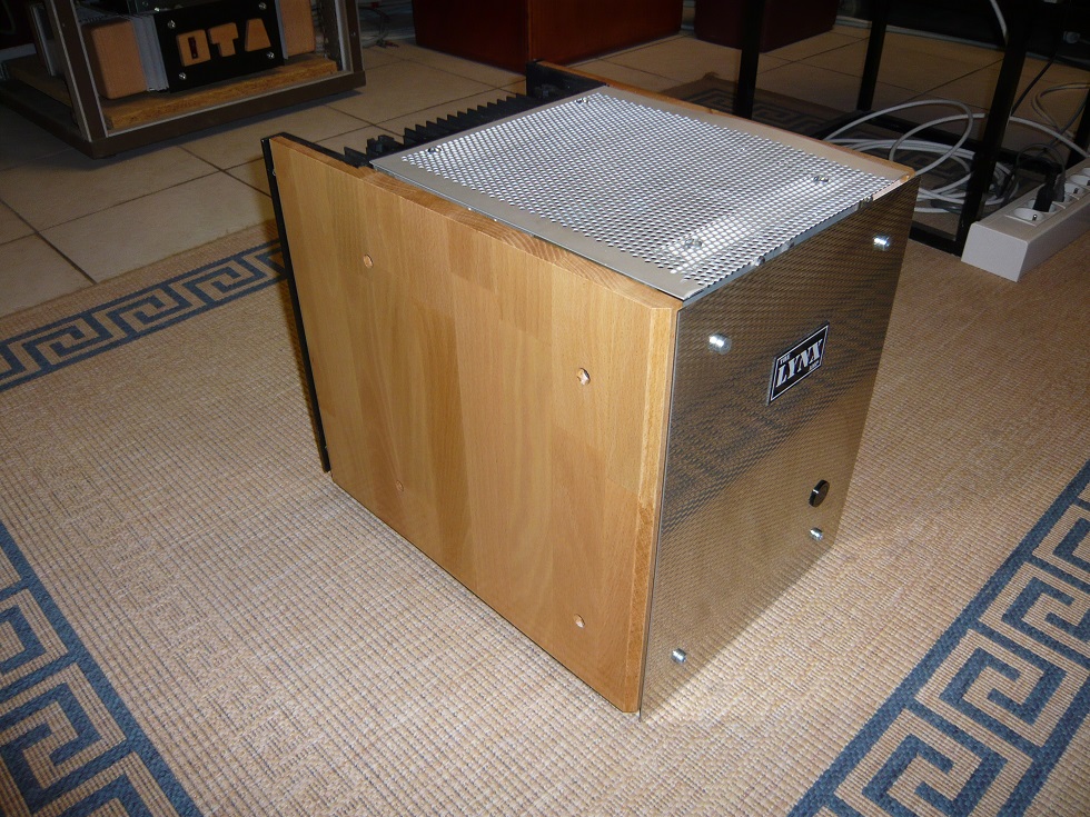

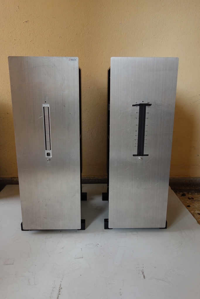

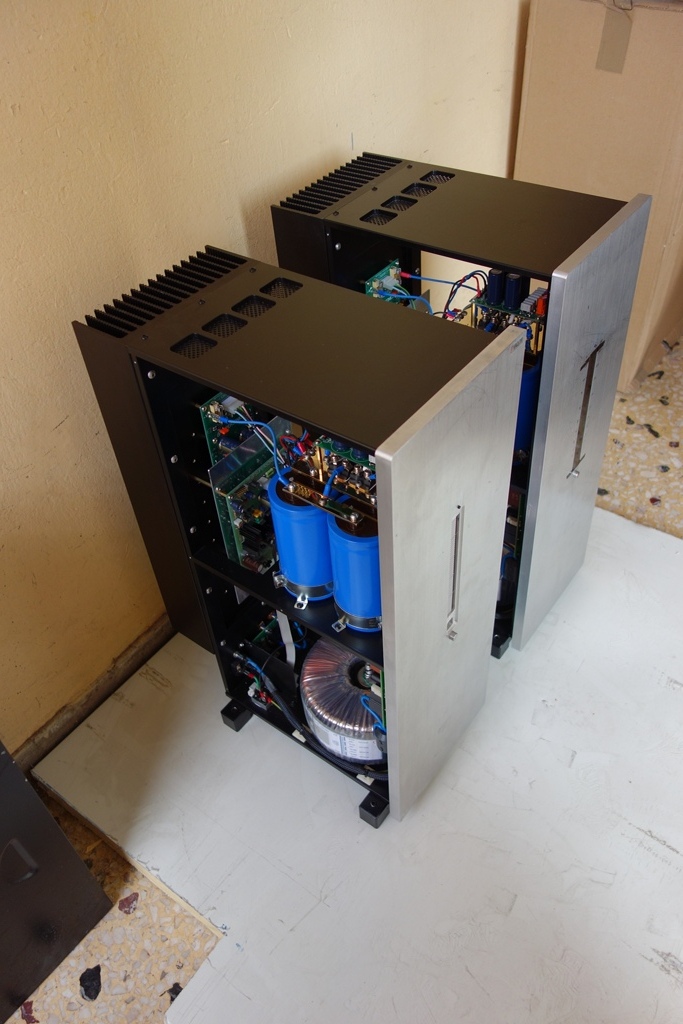

Pictures of my Lynx amp
Here are some pictures of my Lynx amps
...not ready yet....
8 month working(designing constructing and relaxing!)
