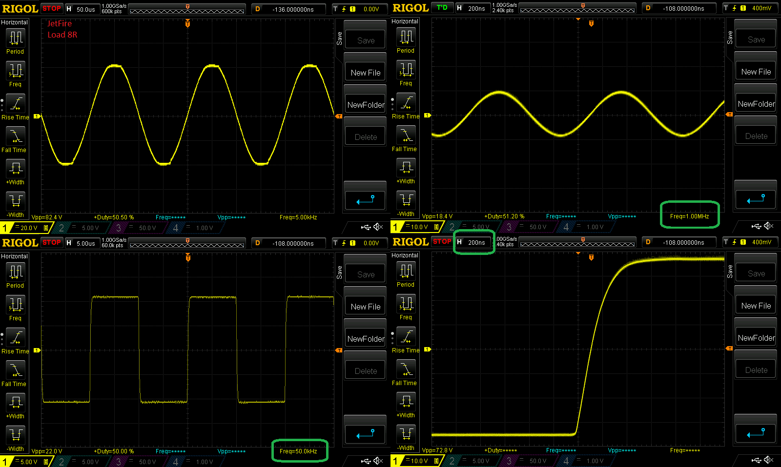

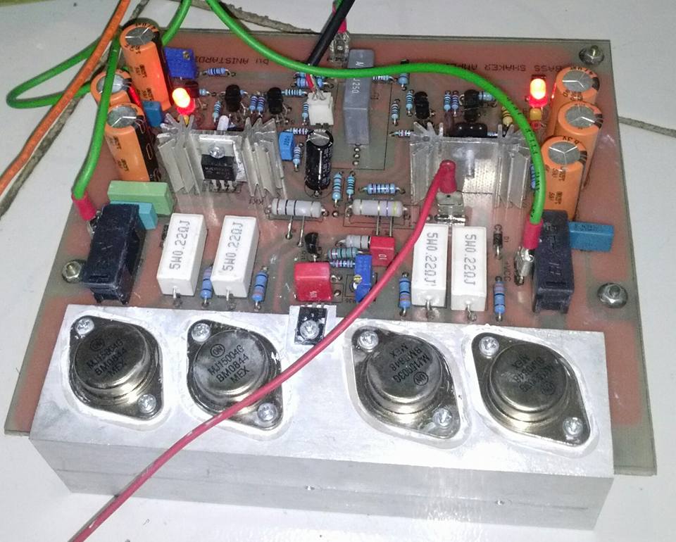

I use MJ15003 and MJ15004 that have low fT. So, I made slew rate not to high. But 46V/uS still make me worry. Luckyly, it did not blow 😀
Very good bass, "airy" at high frequency but not as good as my previous amplifier.
I surprised with this result.
Which is .......?
Blameless 100, a commercial kit amplifier.
http://anistardi.wordpress.com/2015/07/24/blameless-100/

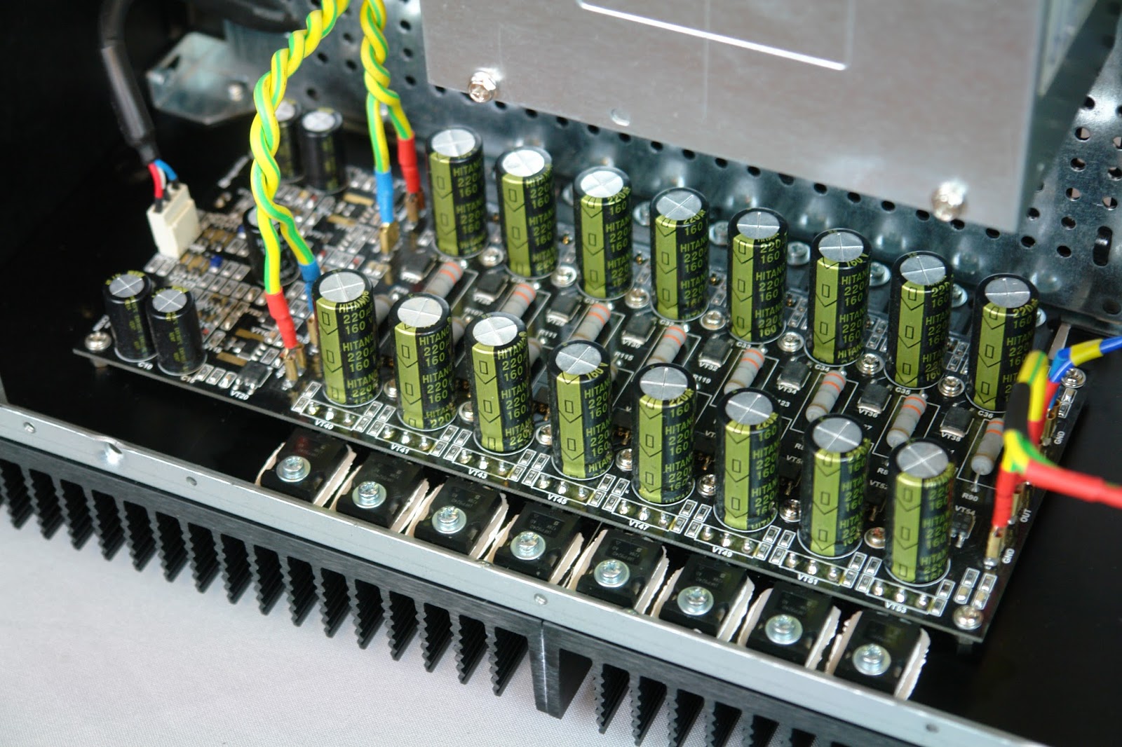

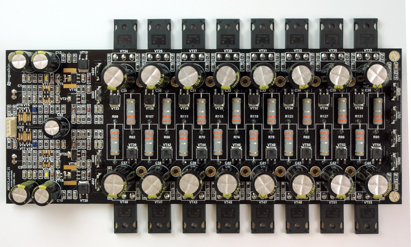

This is our new fully own developed, fundamentally new approach solid state amplifier - "NEOCLASSIC21". 4 layers board, separate individual class-A powerful SMD drivers for each output power MOS-FET. Thanks to it we have totally no "shelf distotion" without dissipation of kilowatts of heat and no "parasite capacitance accumulation effect". Inner ground and shield layers also acts as a planar radiator for all onboard SMD transistors. Amp is fully symmetrical and true balanced. Optimum intercascade dynamic ranges match without application of zener diodes, dividers and level shift cascades. So amp is very quiet and have precise dynamics. Very linear on all output levels. Near 100 amps of peak output current.

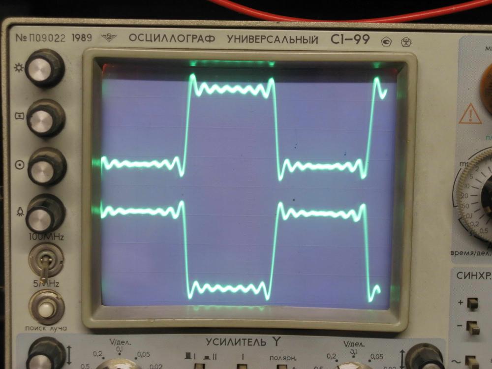

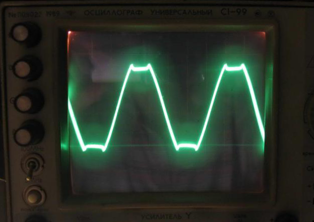

Screenshots from 100MHz professional analog oscilloscope shows:
1. An 140V 1kHz sine clipping. Amplifier loaded with real 8 ohm speaker with capacitive, inductive and reactive load. As seen, clip is fully symmetric. Also we have fully symmetrical cilp enter and out. It shows, that amp is very precise, balanced and self.
2. An wideband unfiltered and unsmoothed 1kHz meander signal transmission. Input (up) and output (bottom) waveforms showed. 30V output voltage. Input meander contains 1, 3, 5, 7, 9, 11, 13 and 15 harmonics. Amplifier loaded with real 8 ohm speaker with capacitive, inductive and reactive load. As seen, no any harmonics lost or added. No any transients or overtones added.

can you share with us the schematic(no components value if you prefer) to see your <<intercascade>> topology and how you manage <<full symmetry>> on positive and negative rails with 16x IRFP240s in the output stage?

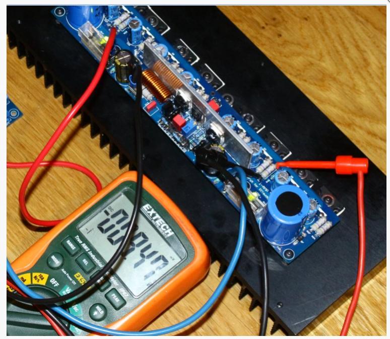

Bias current is slightly over compensated. When heatsink cold, bias current is 82mA, but when heatsink hot it become 77mA as predicted. Bias servo (VBE multiplier) use darlington which is new for me.

Great job!
It would be interesting to see the topology

Looks really nice! just the price of 1500$ USD per module and you need two of them to make a stereo amplifier, won't be easily accessible to DIY, I mean for the majority. Still it looks really good on paper for the specs.

It looks like a Federmann style post. Not DIY. My 2 cents.

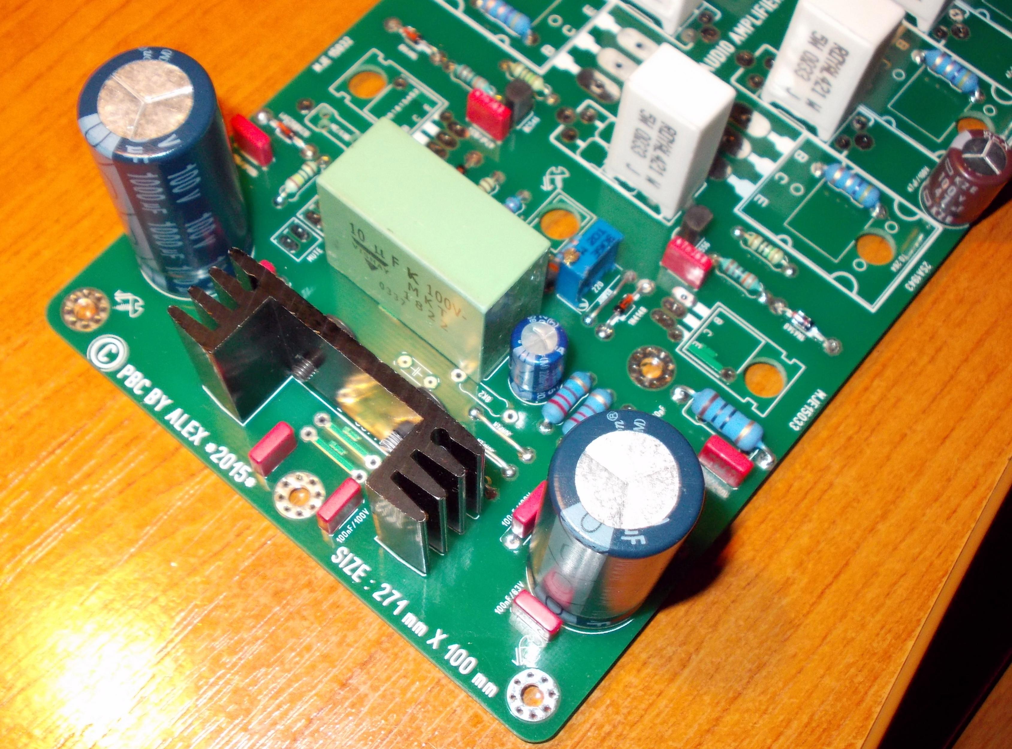

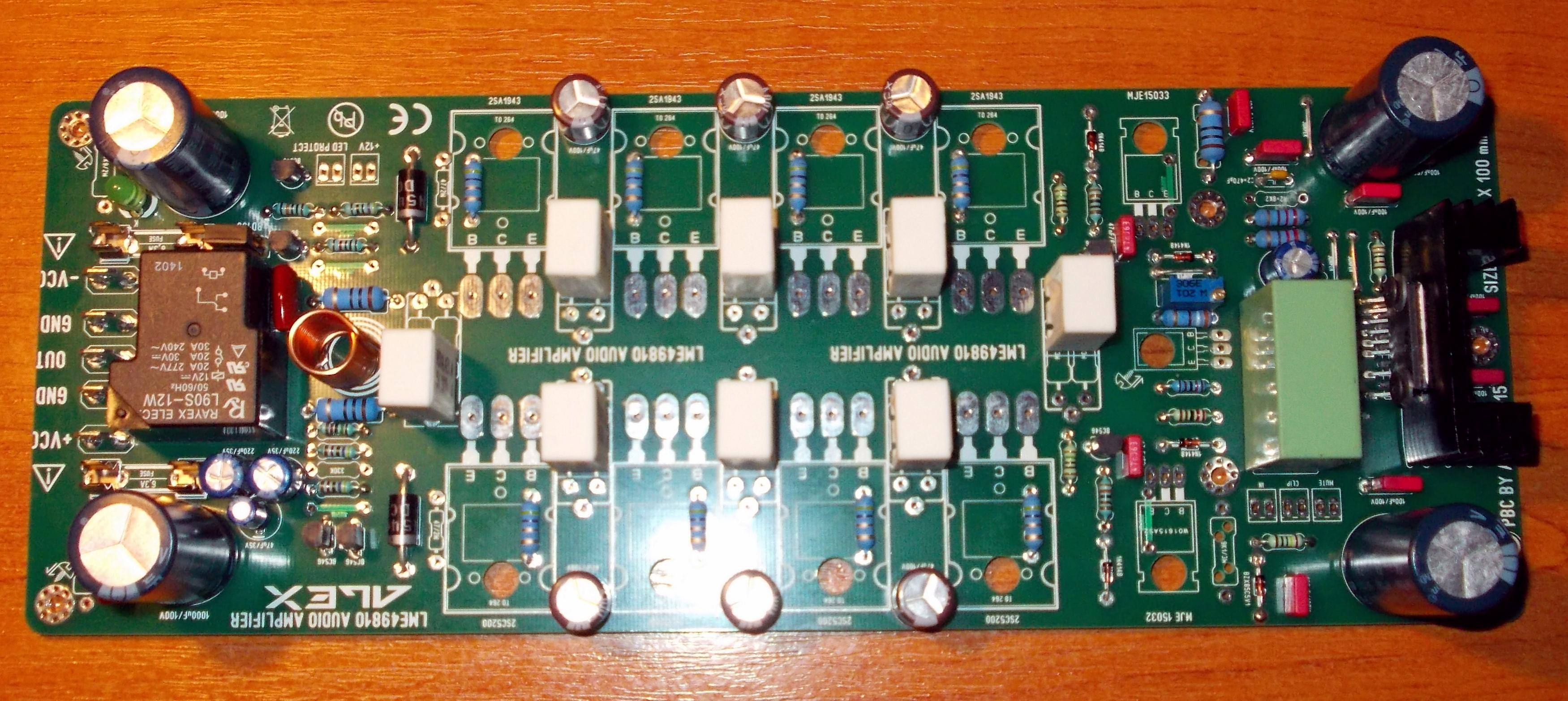

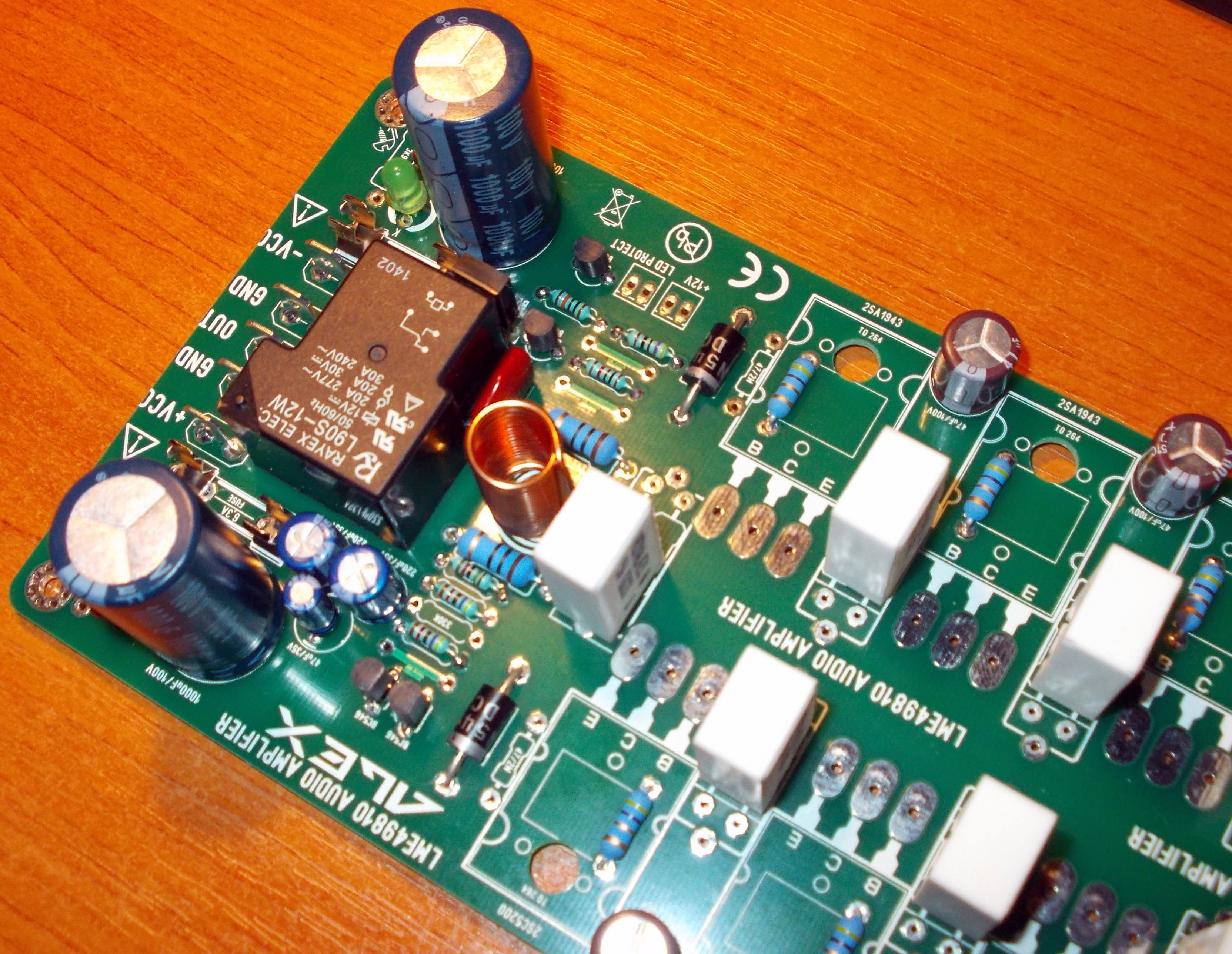

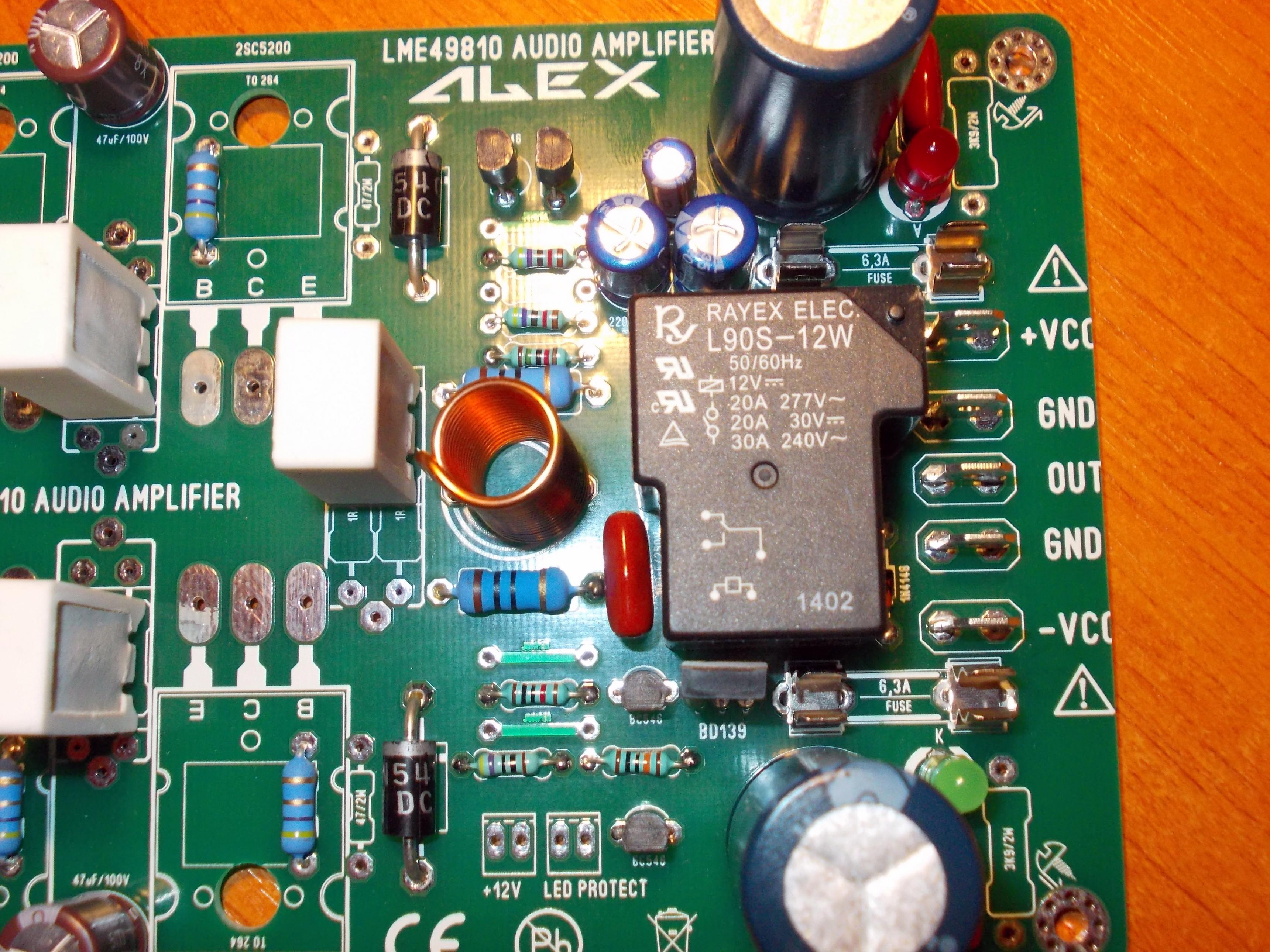

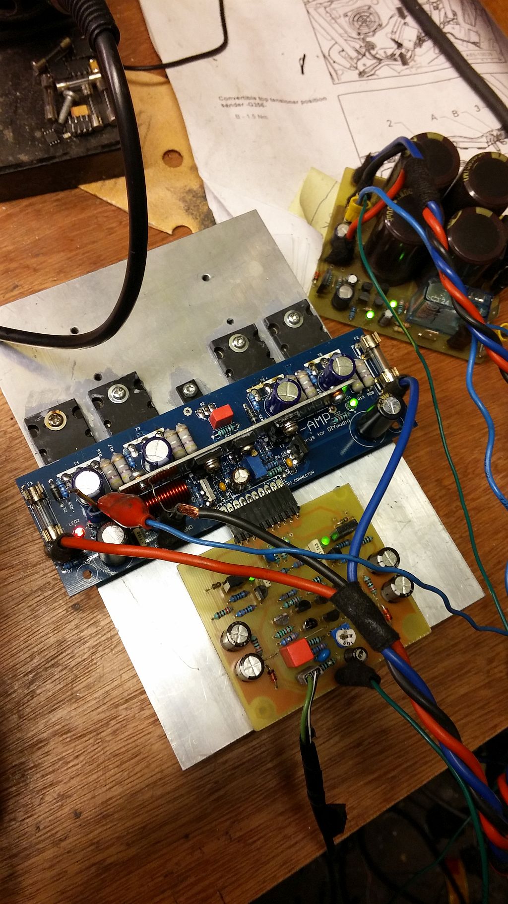

Work in progress ,not finished , still missing few parts .....
work in progress, ready for testing
I'm building this project:
Project 54 | BuildAudioAmps
Boards are ready for testing.
