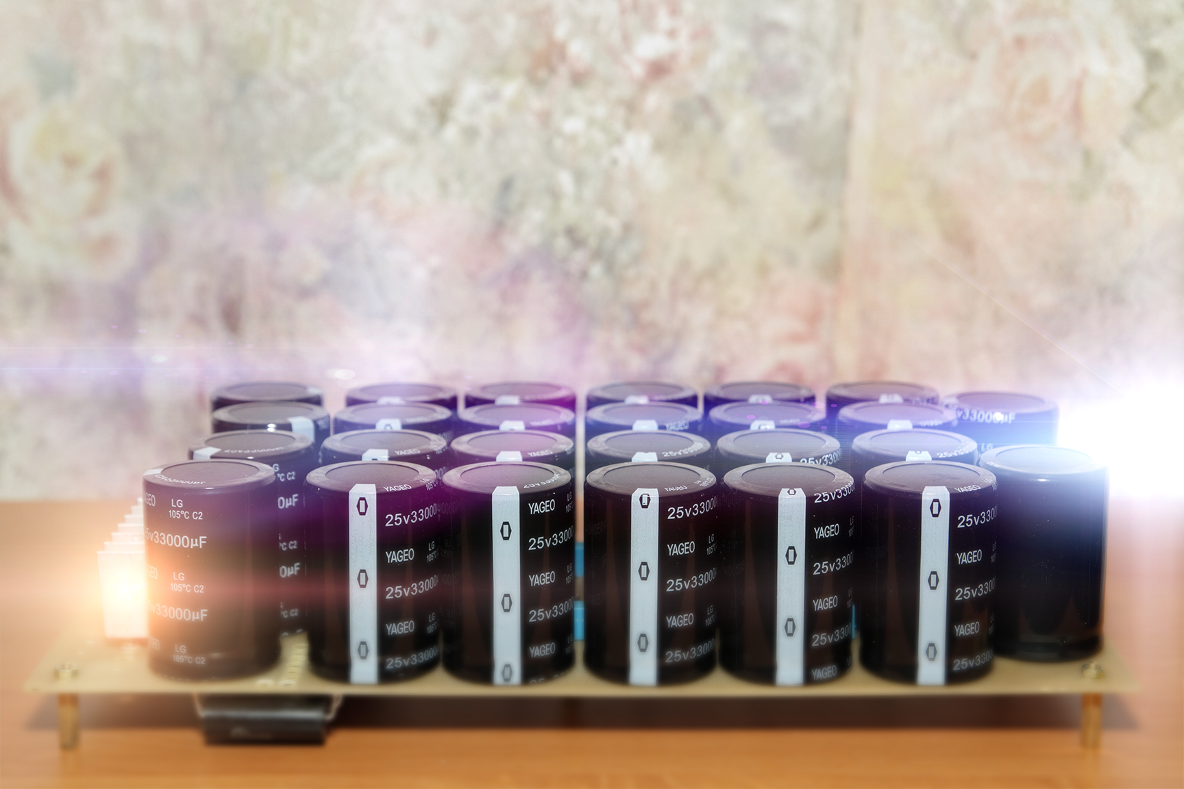

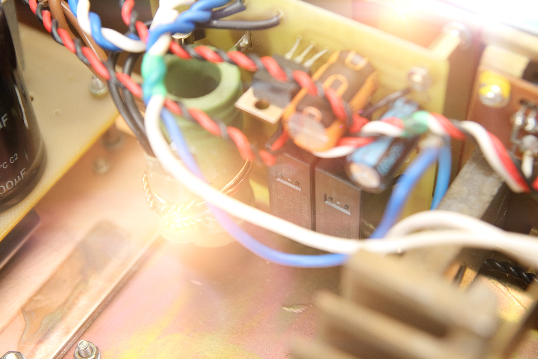

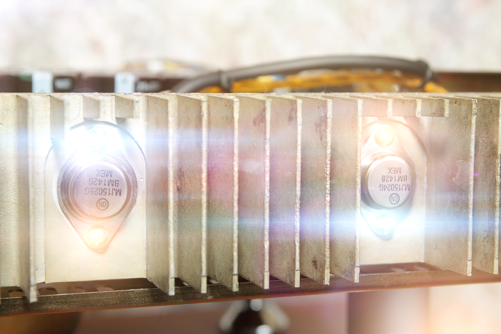

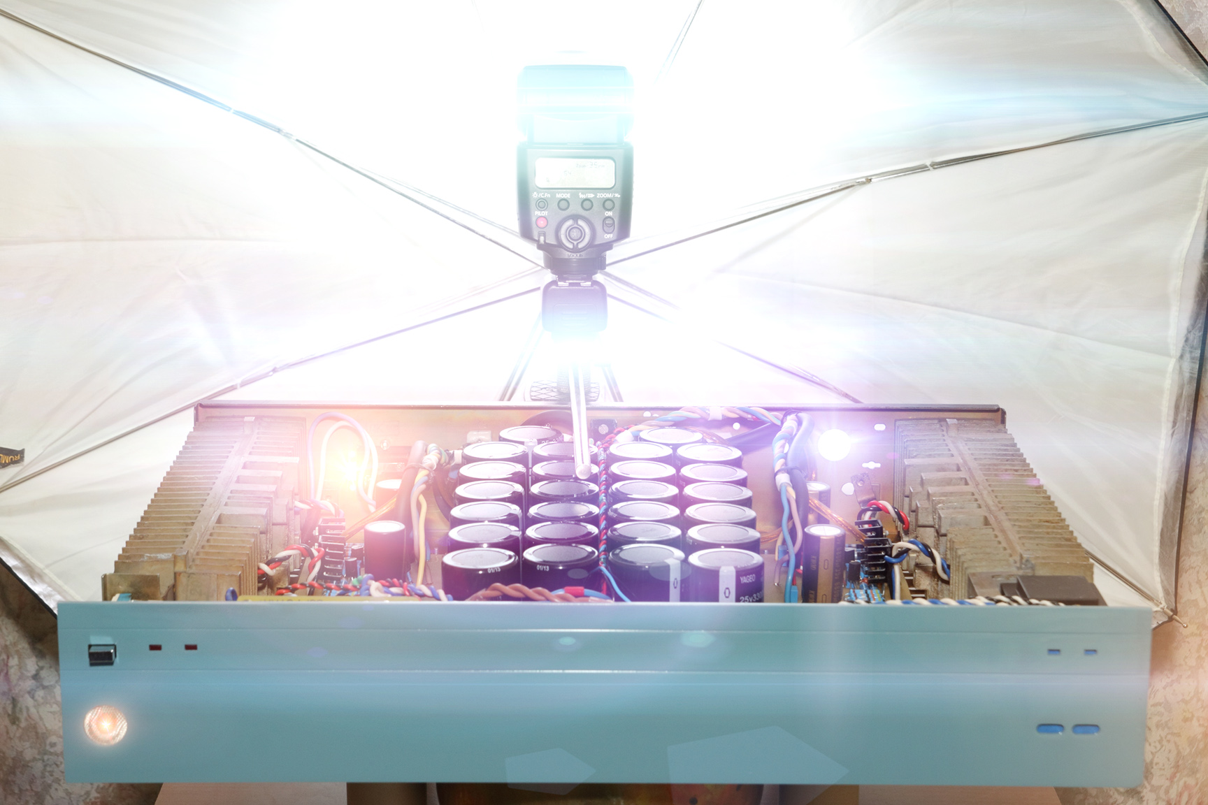

apexaudio
Yes it is my PSU. It is made in 70-80% from the scrap. On the board is :
-standby 15V
-temperature protection
-over load protection/ short circuit protection
-+/-15V for preamp
-another 15V AUX supply
-speakers delayed ON
-speakers fast switch OFF
-DC protection
-temperature protection for amplifier
-auxilary SMPS switch OFF trigger can be added
There is smaller version too with LLC capability.
The main board is universal, any smps driver can be adopted to run it - like in slewmaster 🙂
slewSMPS 🙂
Regards

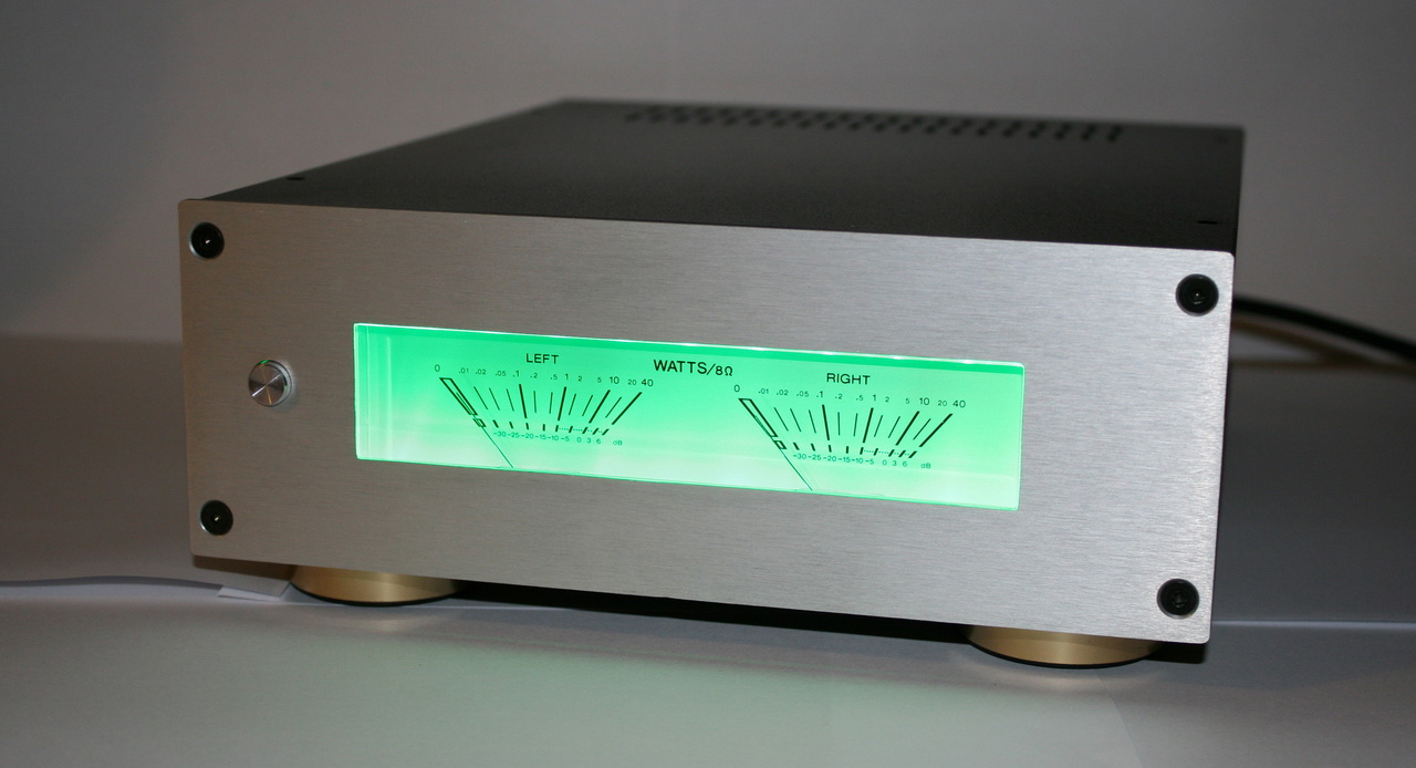

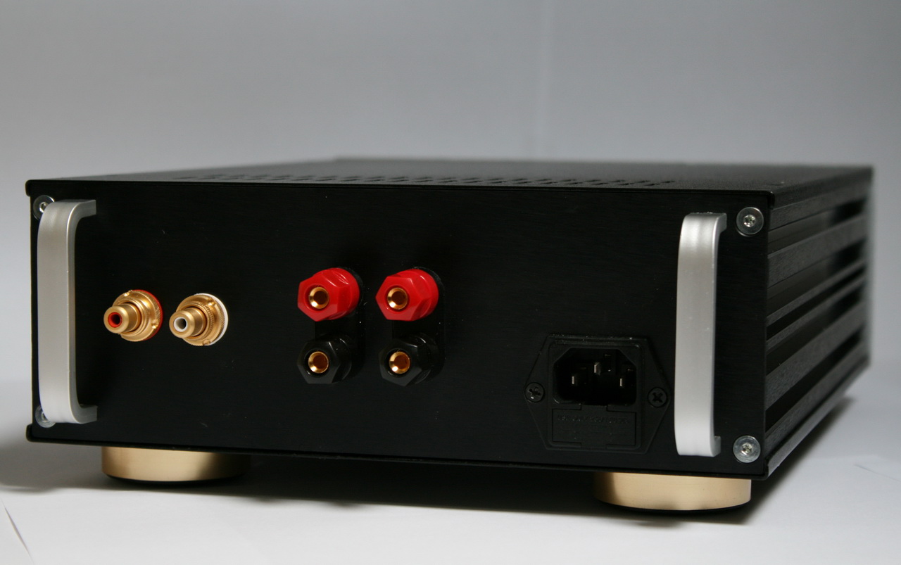

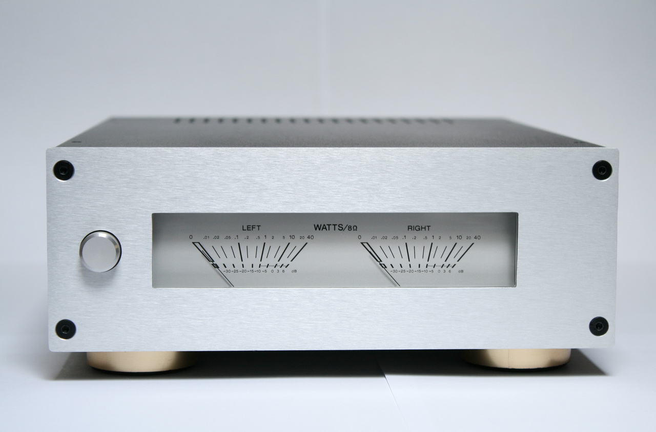

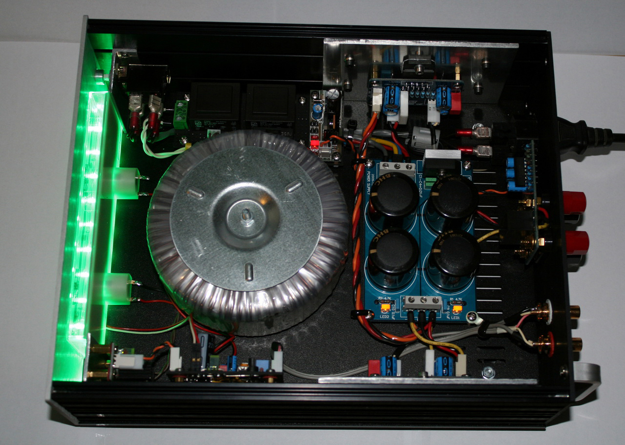

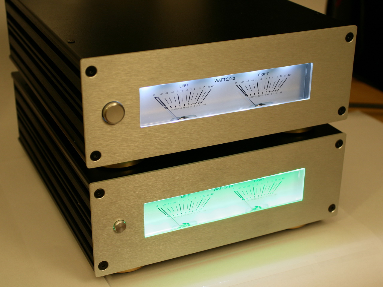

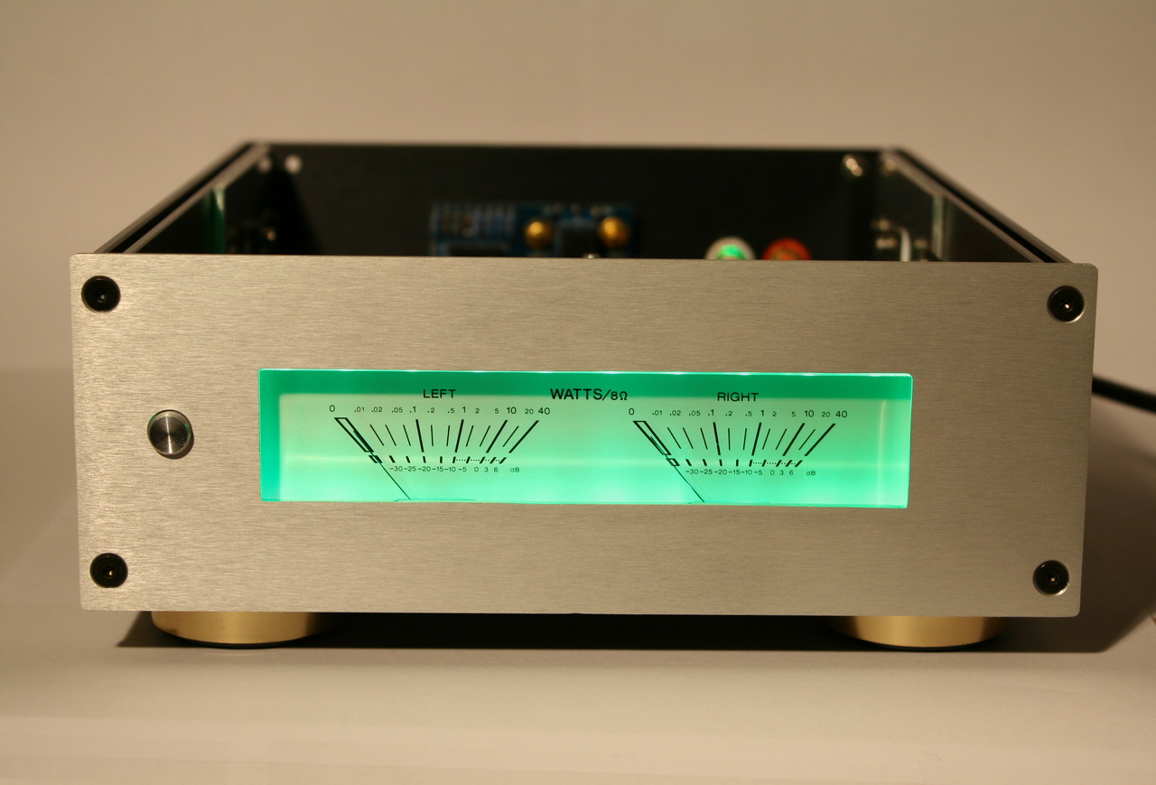

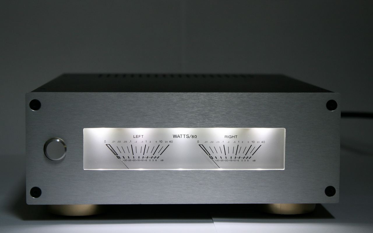

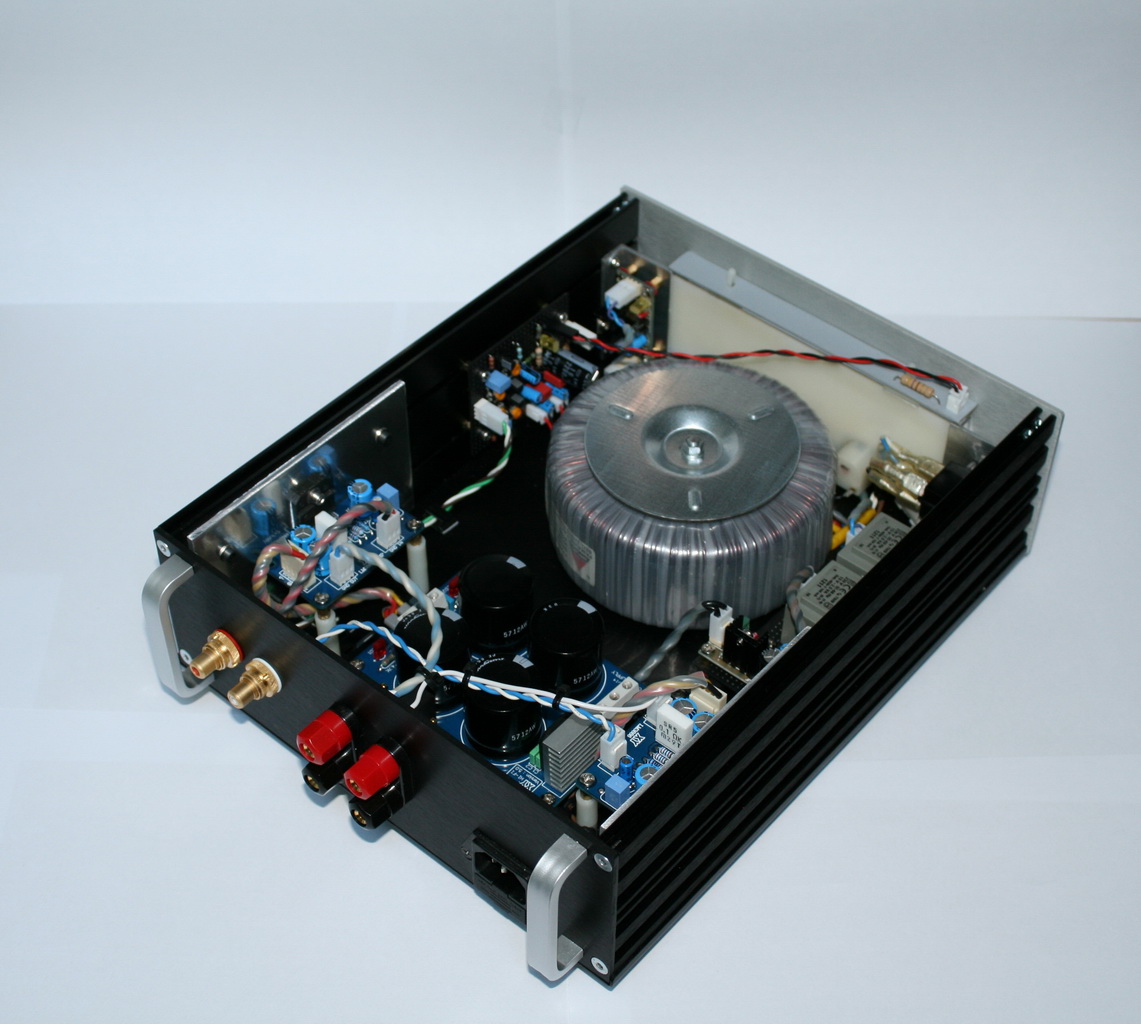

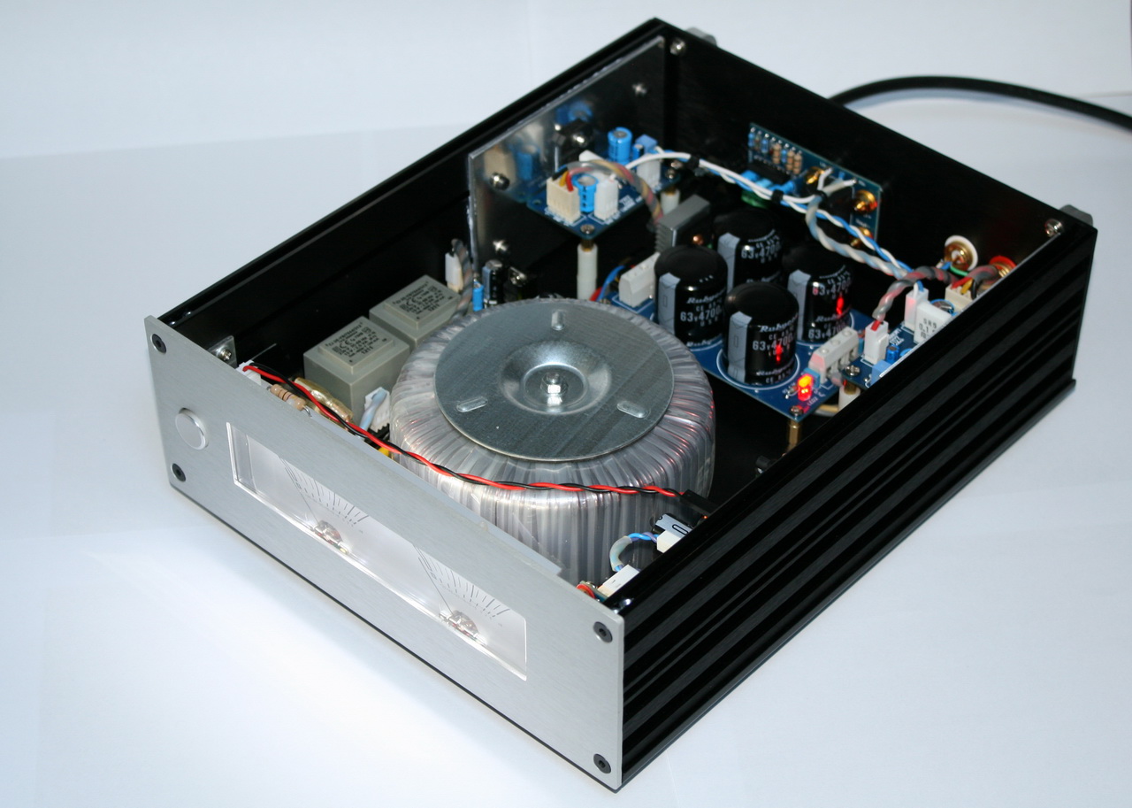

LM3886 XY amplifier
Hi Friends,
At first I want to wish you all all the best for 2016 😀. Thank you all for the kind words about the LM1875 amplifier. Maybe it is nice to post some pictures of another project as well. I have just completed the last one of two LM3886 based stereo amplifiers... Well finished almost, the 'green' one is still missing one of the rack handles 😉. I expect to receive it soon. Both amplifiers perform sonically alike and look very similar, except from a few minor details. I have attached some pictures 🙂.
Michael van den Born (PA4MW)
Hi Friends,
Wow - fabulous build Michael!
BTWcwhere did you get your meters?
Best wishes for 2016!
Thank you 🙂! Both meters are salvaged from two Sony TA-212 amplifiers. The VU driver circuit is made by myself on some vero board:
This board also contains a latching circuit. Via this circuit the LEDs slowly fade in (about 1.5 sec) when the amplifier is turned on.
Off topic:
I just recognised that you have designed the Ovation boards Andrew! What a coincidence: I have bought the 100Wx2 Ovation nx PCB's from Jims Audio a few days ago 😀! It is a project for the long term, but at time I will post some updates in the Ovation thread 🙂
/ Off topic

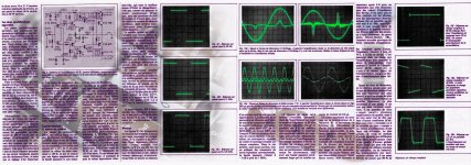

Jean Hiraga's Class A 20W Amplifier (L'Audiophile. April, 1980).

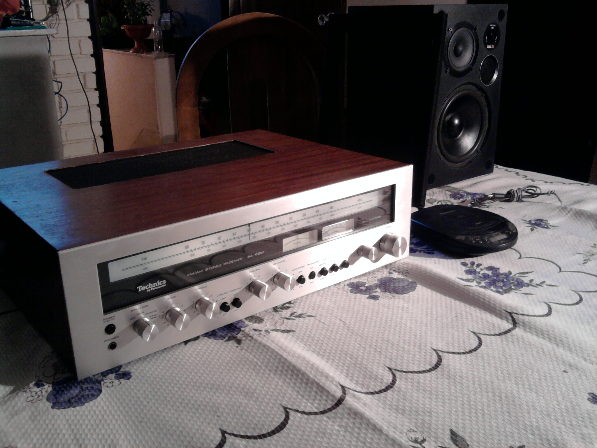

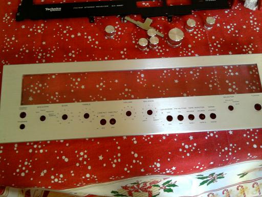

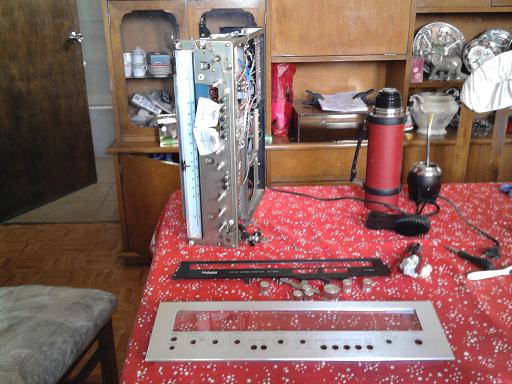

Hi. I recently saw this thread.
I have made many DIY but I'd like to show it where I used a Technics SA 5551 chassis 1976 vintage which was in the electronics in very poor condition and have replaced LM3886 amplifier; copy line Rod Elliot preamp; phono preamp copy of Rod elliot; Phillips tuner tuner board; all controlled by relay inputs; controlled relay loudness; Speaker protective and delay; LED lighting; AIWA toriodal transformer 280 watts. Regards.
Missed photo inside
Wow, such a variety of nice project over here! Hereby some pictures of my humble and recently completed LM1875 gainclone 🙂. A blast from the past with those VU-meters that have been salvaged from an ancient Akai M01 cassette deck. The amplifier is quite compact and about 12 cm by 8 cm by 16 cm in size. I was quite surprised; although it 'only' delivers approximately 20W in an 8 ohm dummy, it is still able to produce a lot of 'slam'. I actually like those LM1875's A LOT! The PCB harbours a speaker protection circuit and a buffer circuit with an OPA2604. The aluminum profile to which the LM's are attached is in turn attached to the cabinet. Therewith heat can easily radiate away. I use the amplifier in a HT set-up in which it drives my center speaker.
Stunning work! Another fan of the little LM1875 here, lovely to work with and its small size allows creative compact designs such as yours. The sound is really high end and surprisingly energetic.
My little desktop build has an external power supply (+/-17V DC, XLR umbilical, 1000uF per rail inside amp) but I think yours is built in? Any issues with PSU noise getting onto the outputs with everything being so intimate in there?
Thank you 😀! As PSU I use a toroidal 2x 18 VAC transformer together with 2x2200uF filter caps (with 100nF in parallel for decoupling). I was expecting at least a little bit of hum because the amplifier is indeed very compact, having a gap between the transformer and PCB (the transformer is located just below the pcb) of about 1.5 cm. However, it actually does not conduct any audible hum 🙂. I have salvaged the transformer from a piece of old lab equipment (applied laser tech) that was about to be thrown away. The transformer is internally shielded quite alright, so I think that already removes a lot of noise. And of course twisting all the AC wires contributed as well 😉
