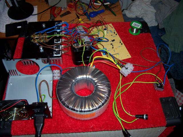

Latest amp by me.
Around 500 watts RMS.
IRFP240 and IRFP9240 on output.
