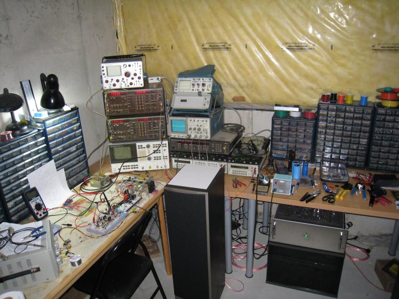

syn08 said:The PGP amp is singing from under the table, new generation amp is in works...
Stay tuned!

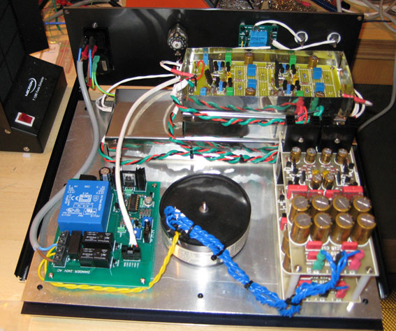

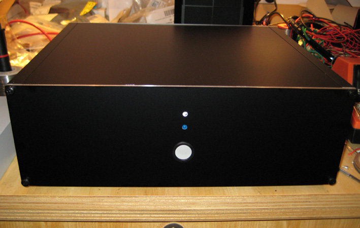

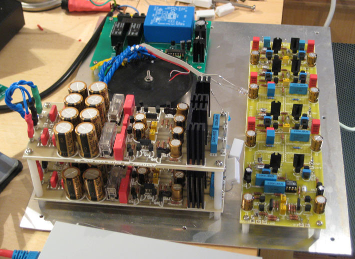

Here is my latest addition - a Borbely all-FET subwoofer crossover. Crossover freq 100Hz, 24dB/oct, separate hp filter boards and summing lp filter board. Borbely low noise FET power supplies used for each channel & lp filter.
This picture is the finished unit enclosed in a custom case made by Front Panel Express
smithy666 said:And the completed project ready for the covers to go on. I enclosed each filter in its own metal enclosure.
Now to build the matching subwoofer amp using an Aussie Amplifiers' module.....
Wow, looks very professional.
Much better than my veroboard lash ups !
This looks really nice! You must have given it quite some thought how to shape this project.
I would be interested to hear how your filter performs.

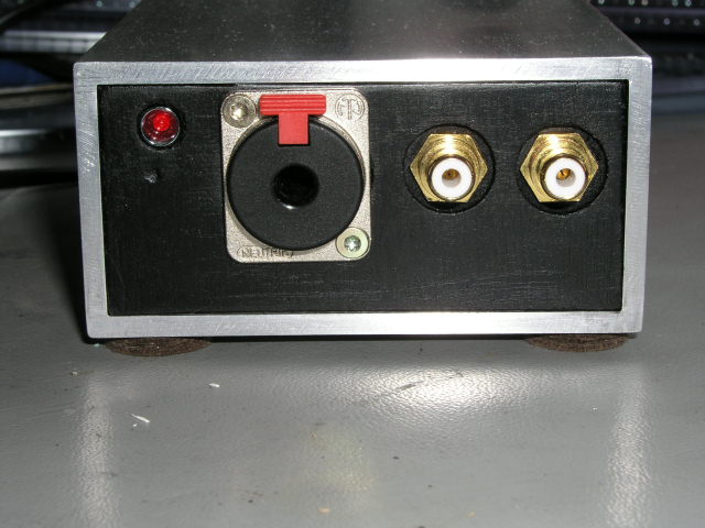

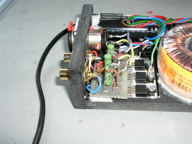

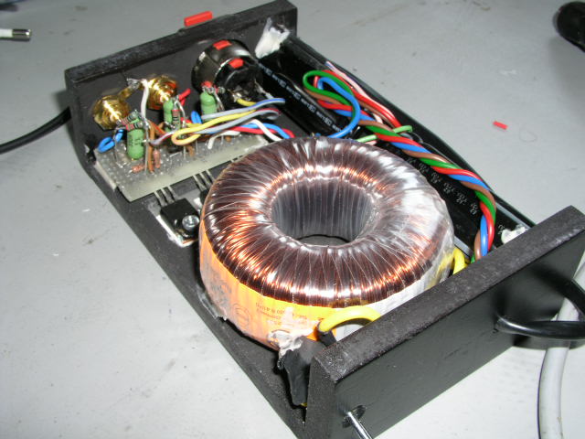

Szekeres VE as published by RJM

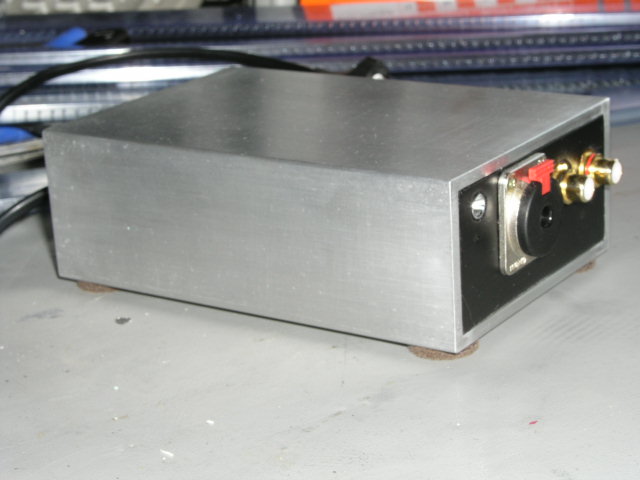

This is my version of the Szekeres VE as described by RJM. This buffer performs extremely well. As there are no signal caps anywhere, the fet selection and mounting will influence the DC at the output.
I managed to have 500uV as a maximum DC level at the output.
