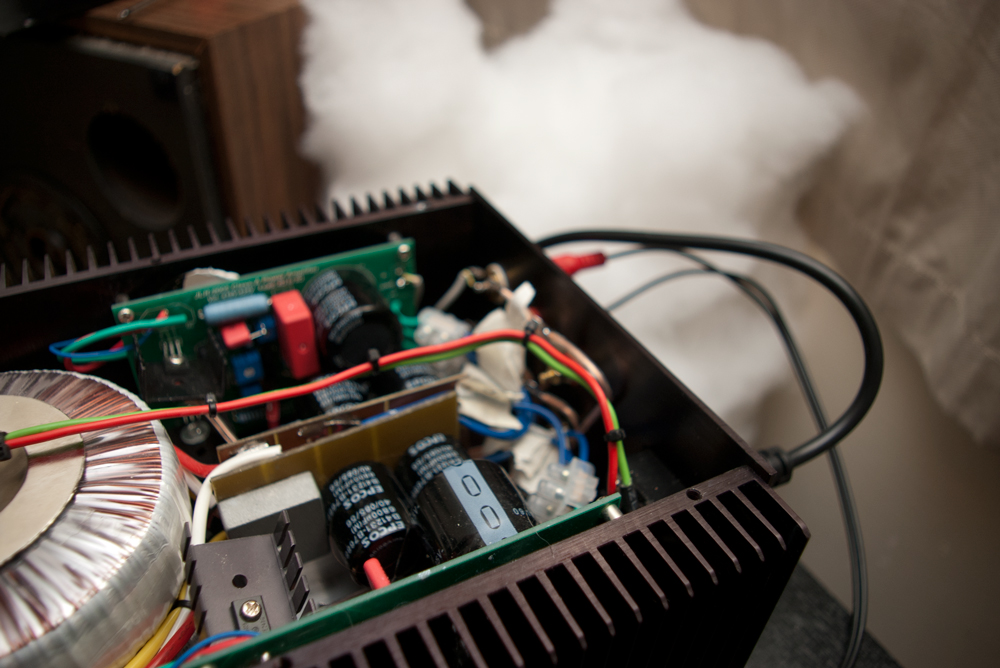

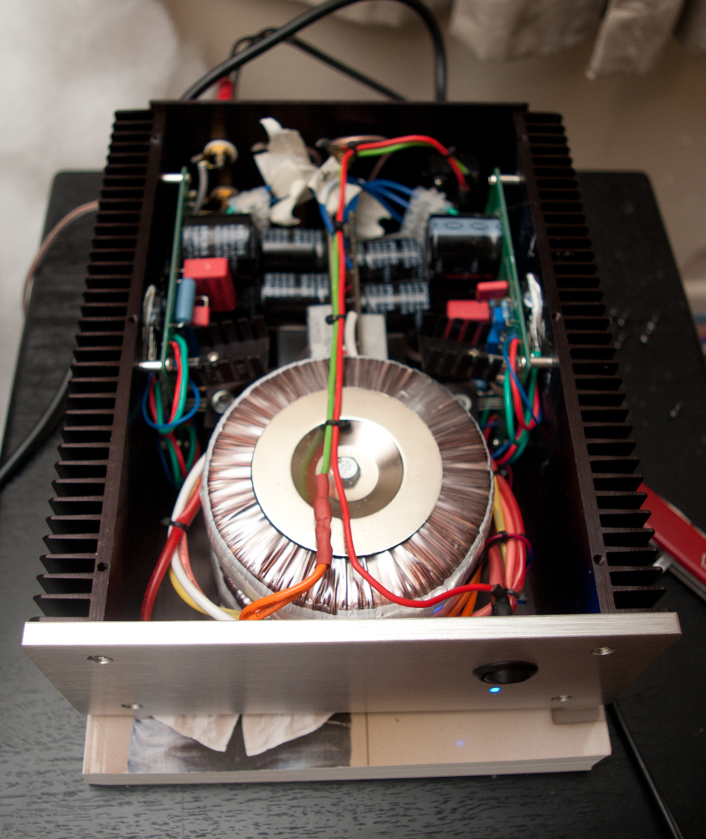

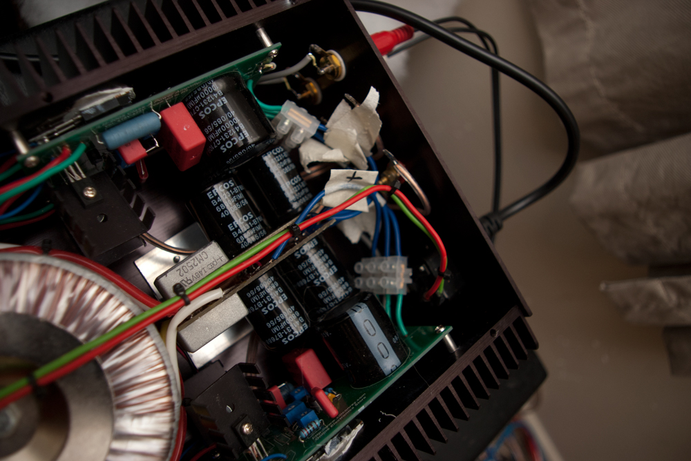

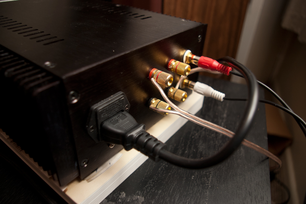

My 5 channel amp.
Still neatening up some wiring. haven't connected to a speaker yet, but tested each channel with a dummy 8ohm load and some sine waves.
After these pictures added extra wire between the ground terminals on the two power supply caps.
Things are tight in the enclosure.
In short 2 x 500VA toroidals (each for a single voltage rail) delivering +-42V rails using a board that is very close to the ncc200 design.
50ohm slow start for 150ms on each Toroidal. DC protection on each output using upc1237 circuits

T7.5A is no protection at all.
That should start a 500VA without a soft start (500VA / 230Vac * 3 ~= 7.5A)
Soft start allows the 3 factor to be reduced to ~1
I would expect a 500VA to soft start on a T2A fuse and you may find that you can start and operate your amplifier with a T1.2A or T1.6A. That's why my first and third questions look similar but are actually asking for different information.
