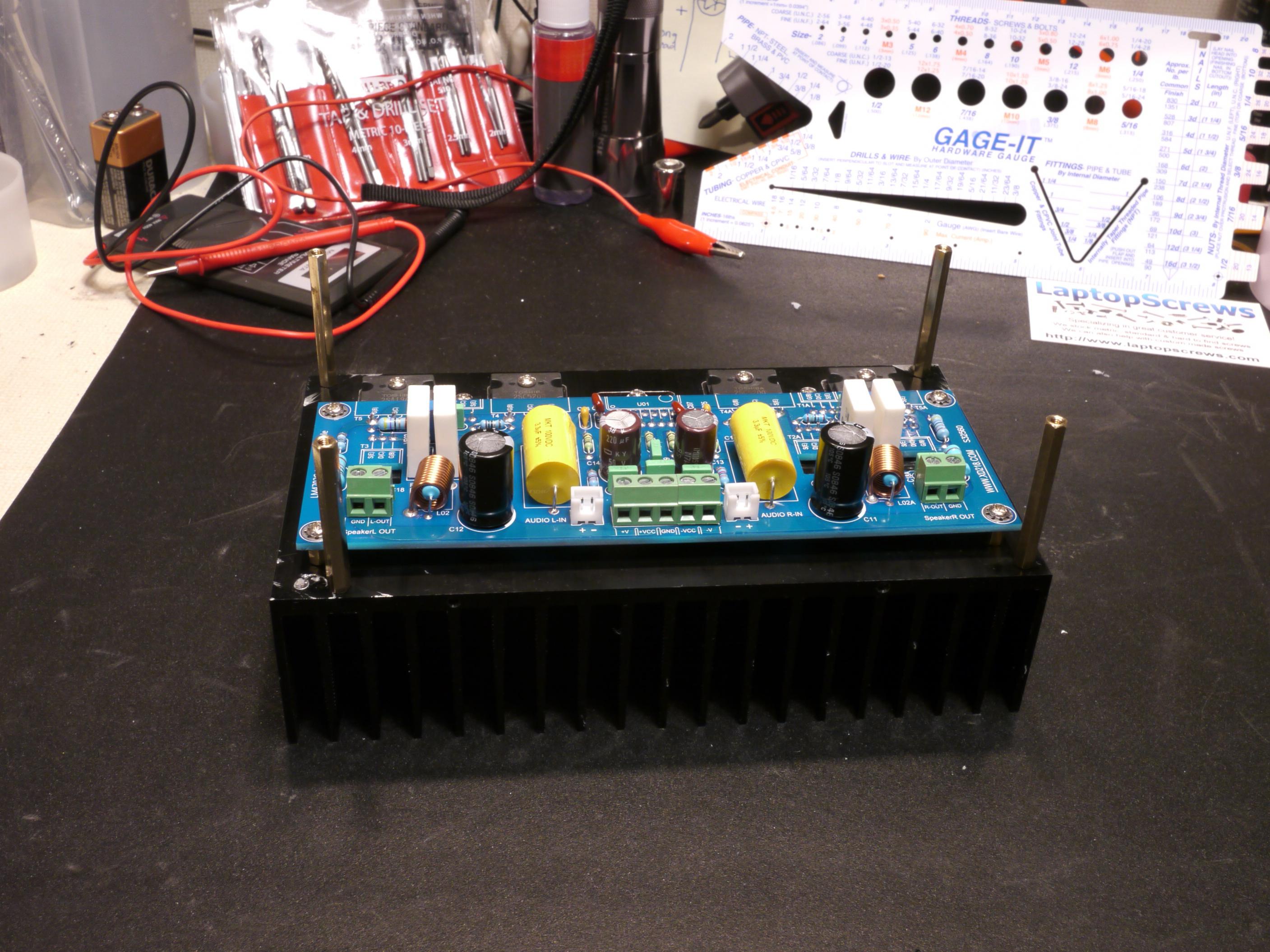

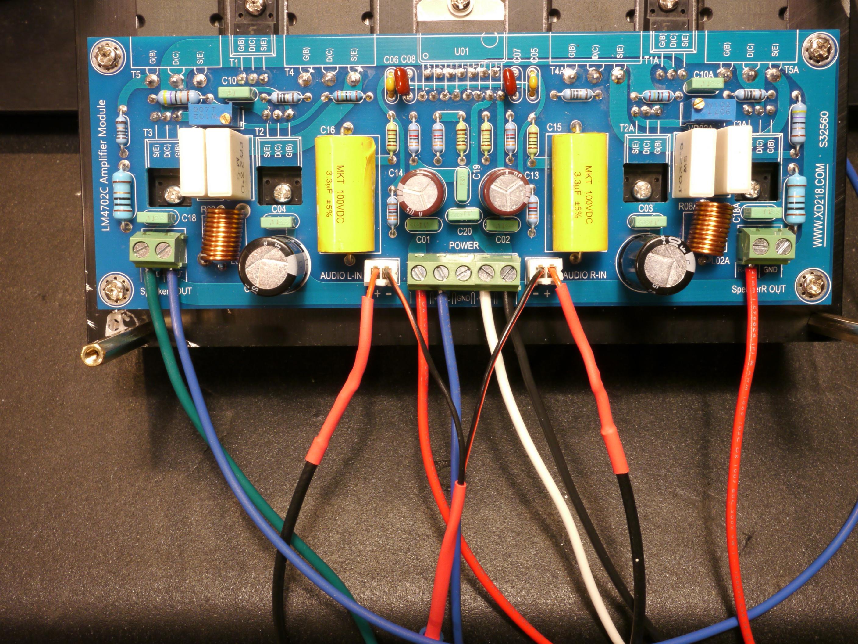

My new LM4702 Build
Progress pics of my newly completed LM4702 build...

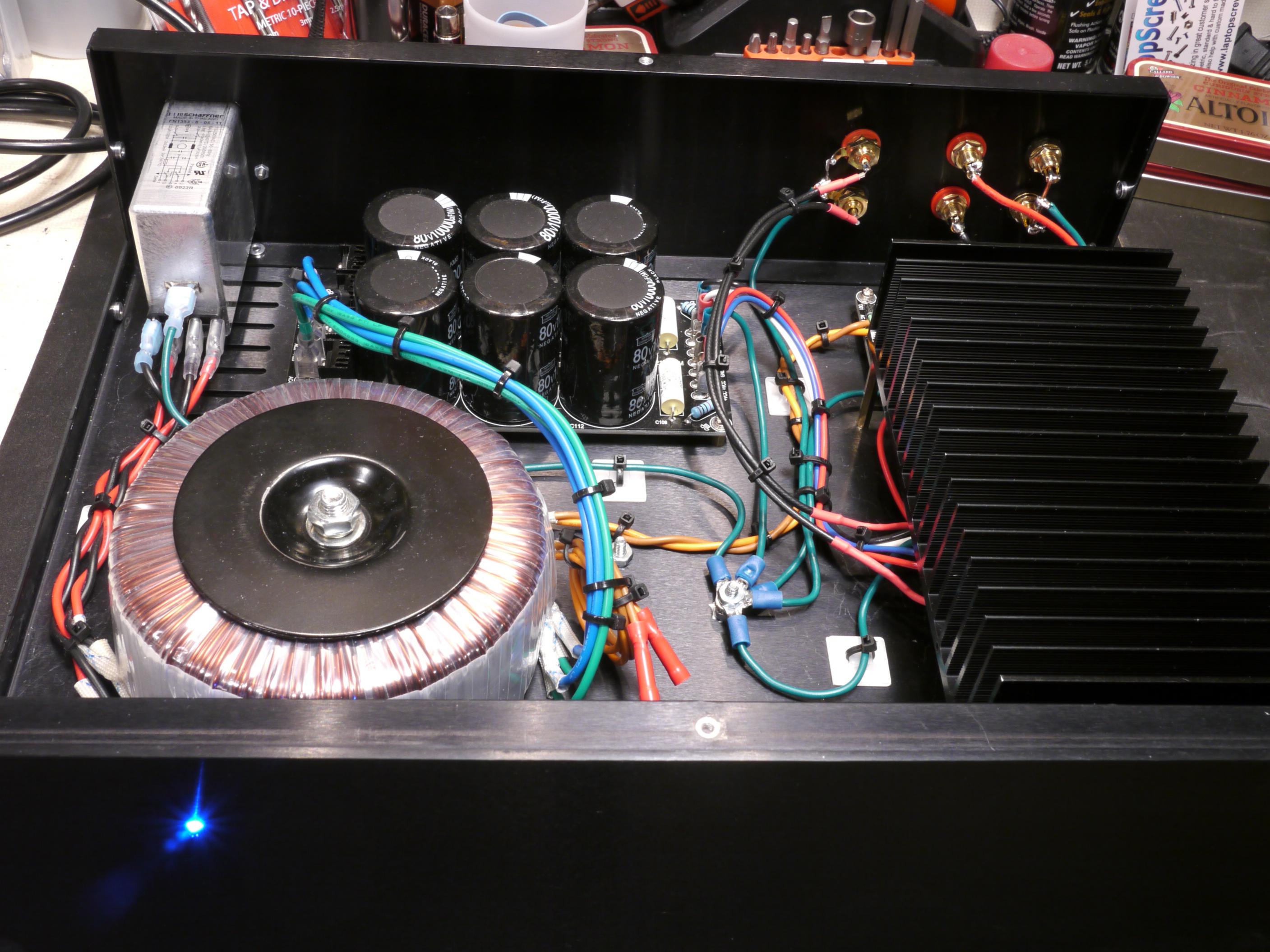

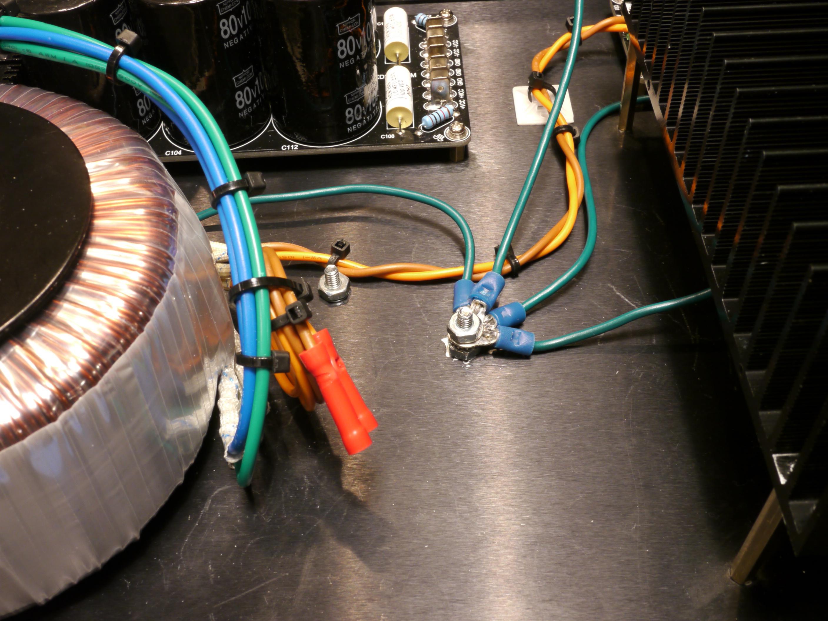

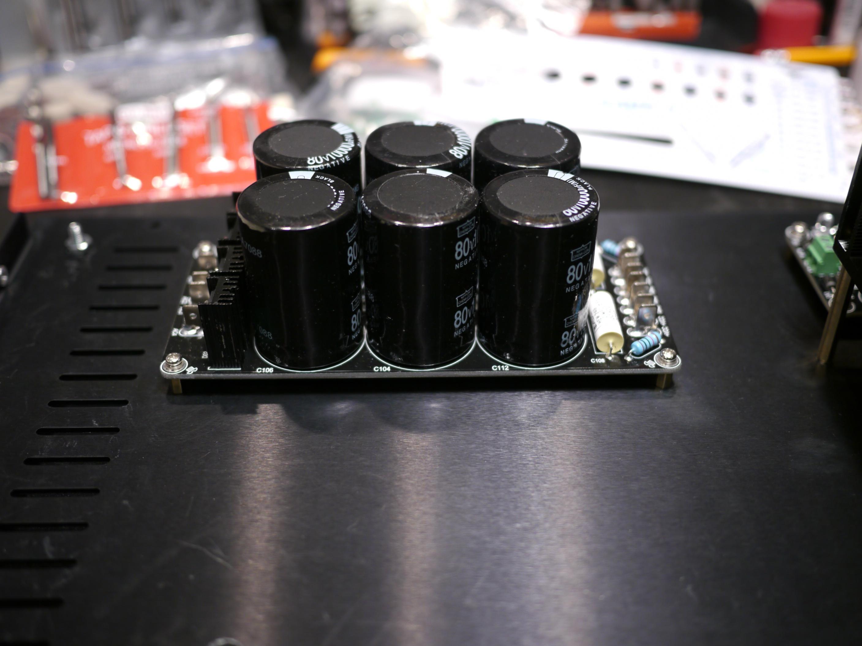

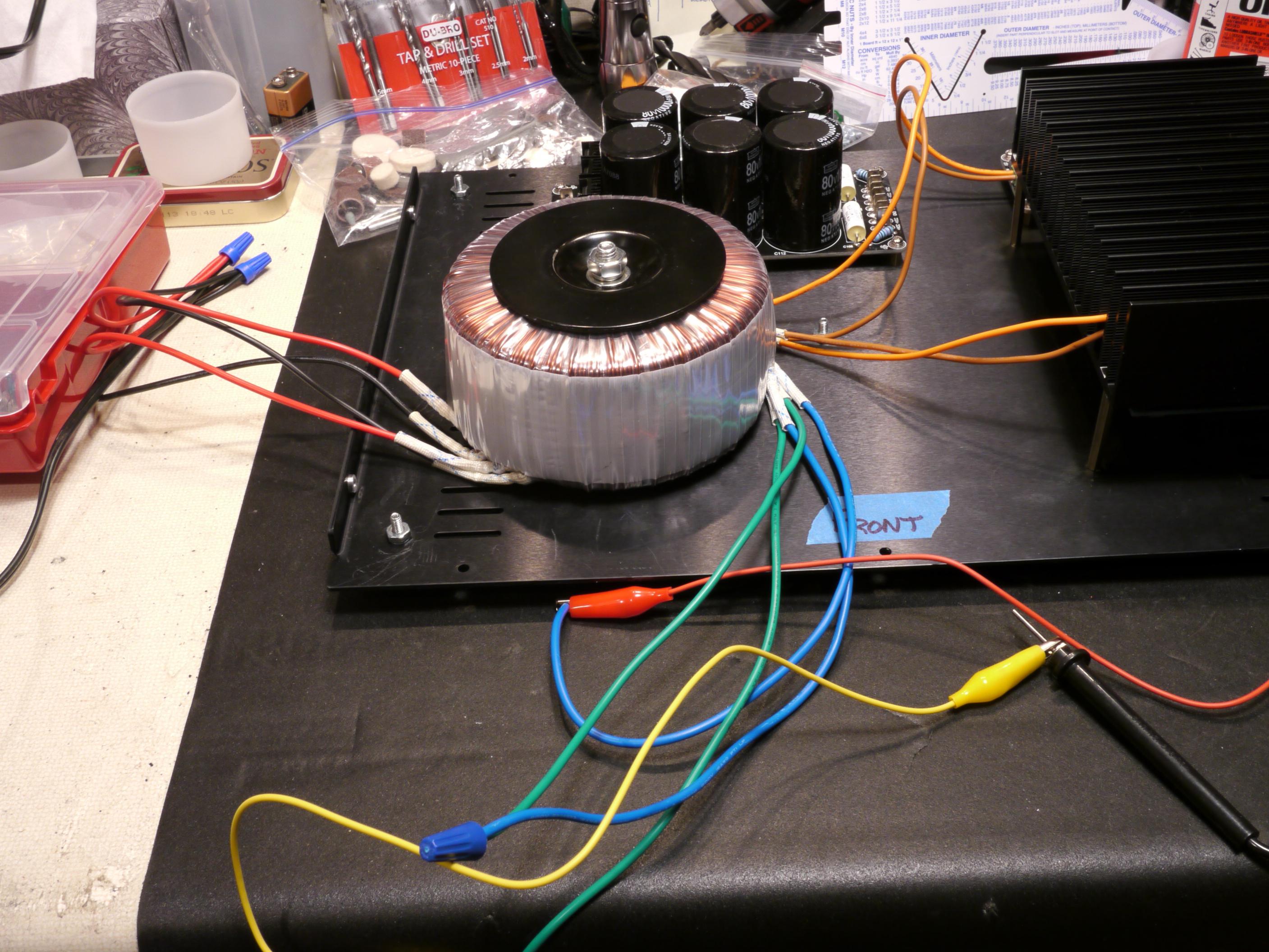

Redjr,
One of the green wire connections to the Main Audio Ground mounted to the chassis floor looks to me to be a link to the Mains PE.
That is wrong.
Change it.

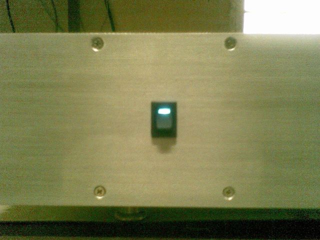

I could not decide if I would use white or blue. Next best thing? why not try something unique?
I was able to scavenge this LED from a scrap board. It's more like white with a baby blue-like tinge to it. Maybe similar but a little lighter than the Mcintosh blue meter displays. I hope I make sense. 😀
Sorry for the picture quality since I used my phone cam. The digital cam gets confused and shows it only as white.
Black/dark knob and switch on silvery background doesn't look good. You need to use knob of similar color. Then white or blue led doesn't matter much but I think blue is slightly better because it sets the "boundary" more clearly than white.
If you paint the faceplate (to black), I prefer red or blue led. Red on black is commonly perceived as luxurious.

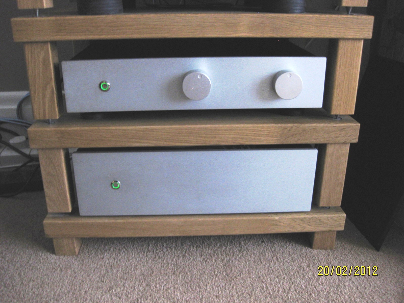

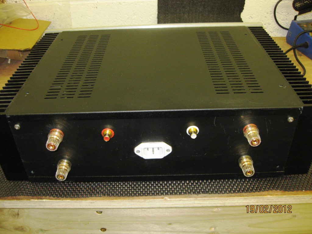

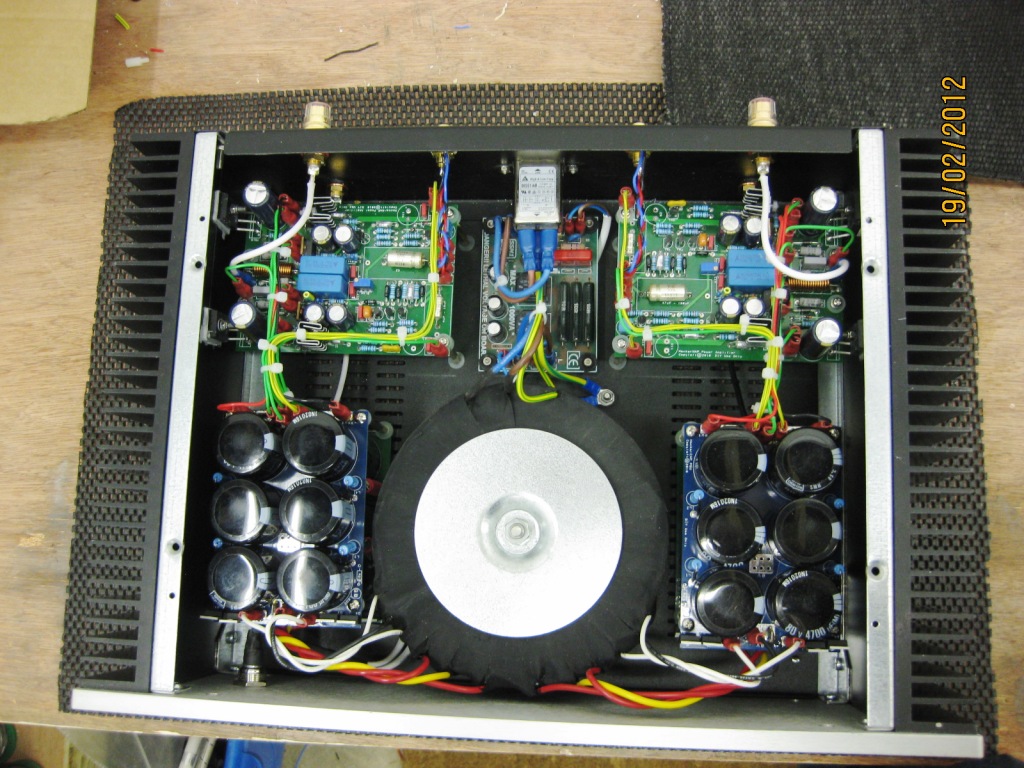

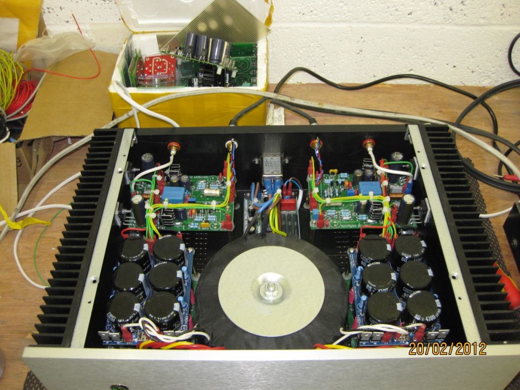

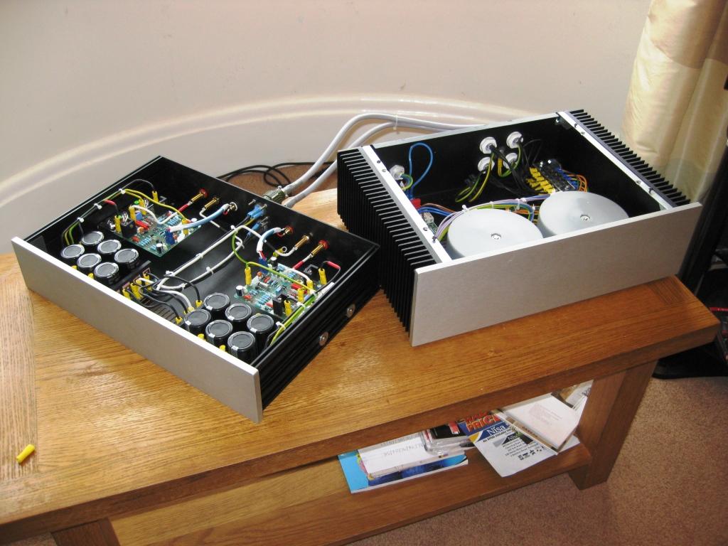

This is my Hackernap Amp in a Modushop case 😉

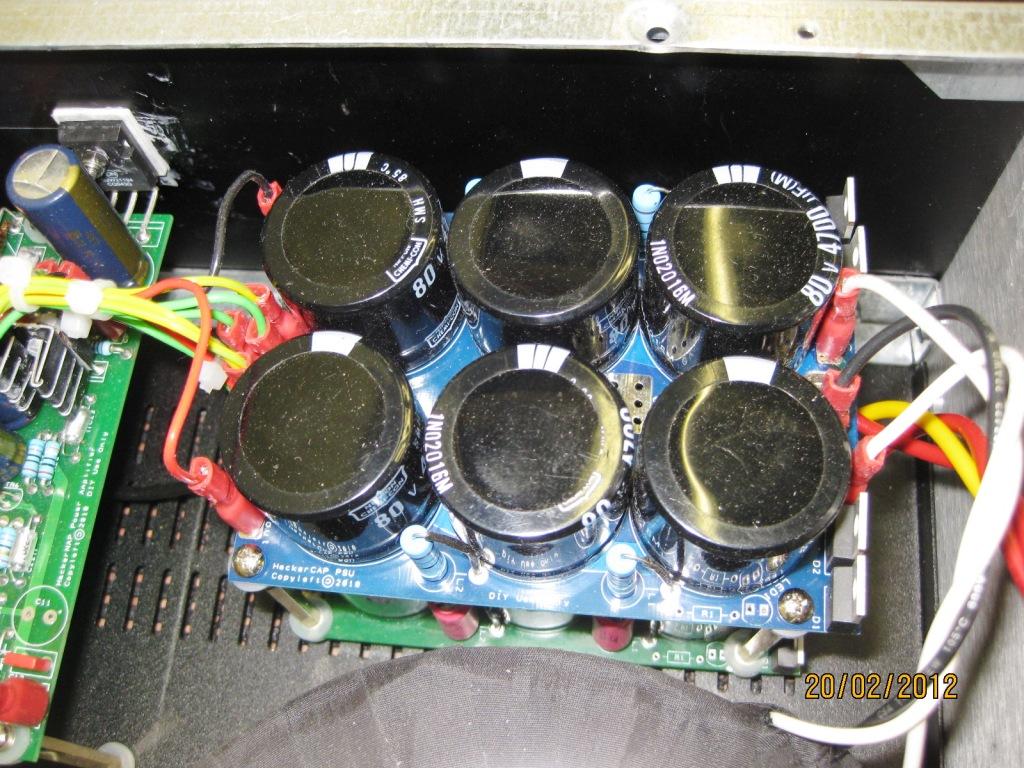

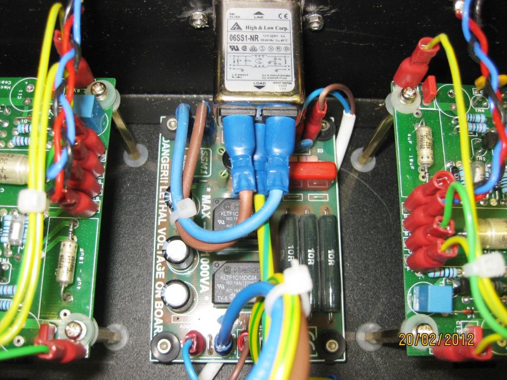

Great looking amp 337. You did a superb job on the layout. Looks meticulously done. I love that! Looks great on display too. I'll bet it sounds maaaa..velous. How many wpc on the guy?

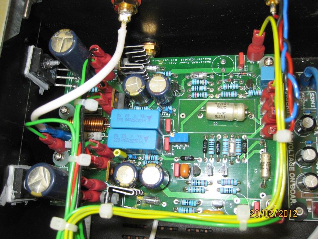

Very nice done 337! is C2 the input cap? since you have space there, Have you try different cap there?
Thanks guys it does sound bloody marvellous 😎
C1 in the input cap and C2 is the feedback cap they are both mil spec wet tants at the moment which I like as the sound is very clean, fast dynamic with good bass.
Many of the other guys at PFM also use big AVX films in there and I heard a pair of monoblocks with them and they sound also excellent and a little smoother probably sweeter. some brave guys use no input cap at all.
I do intend to build another one of these and use the films, ill compare them then Bi amp with them probably put the films on the tweeters😉

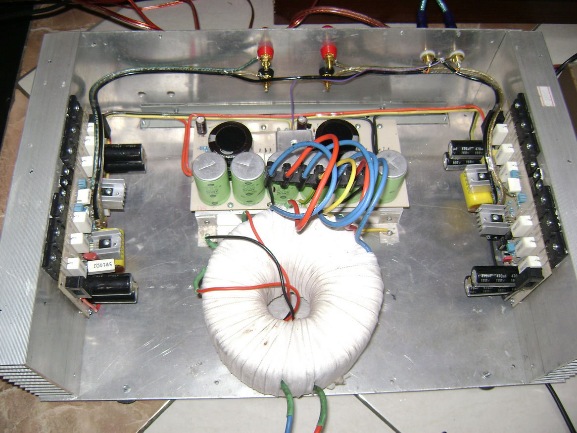

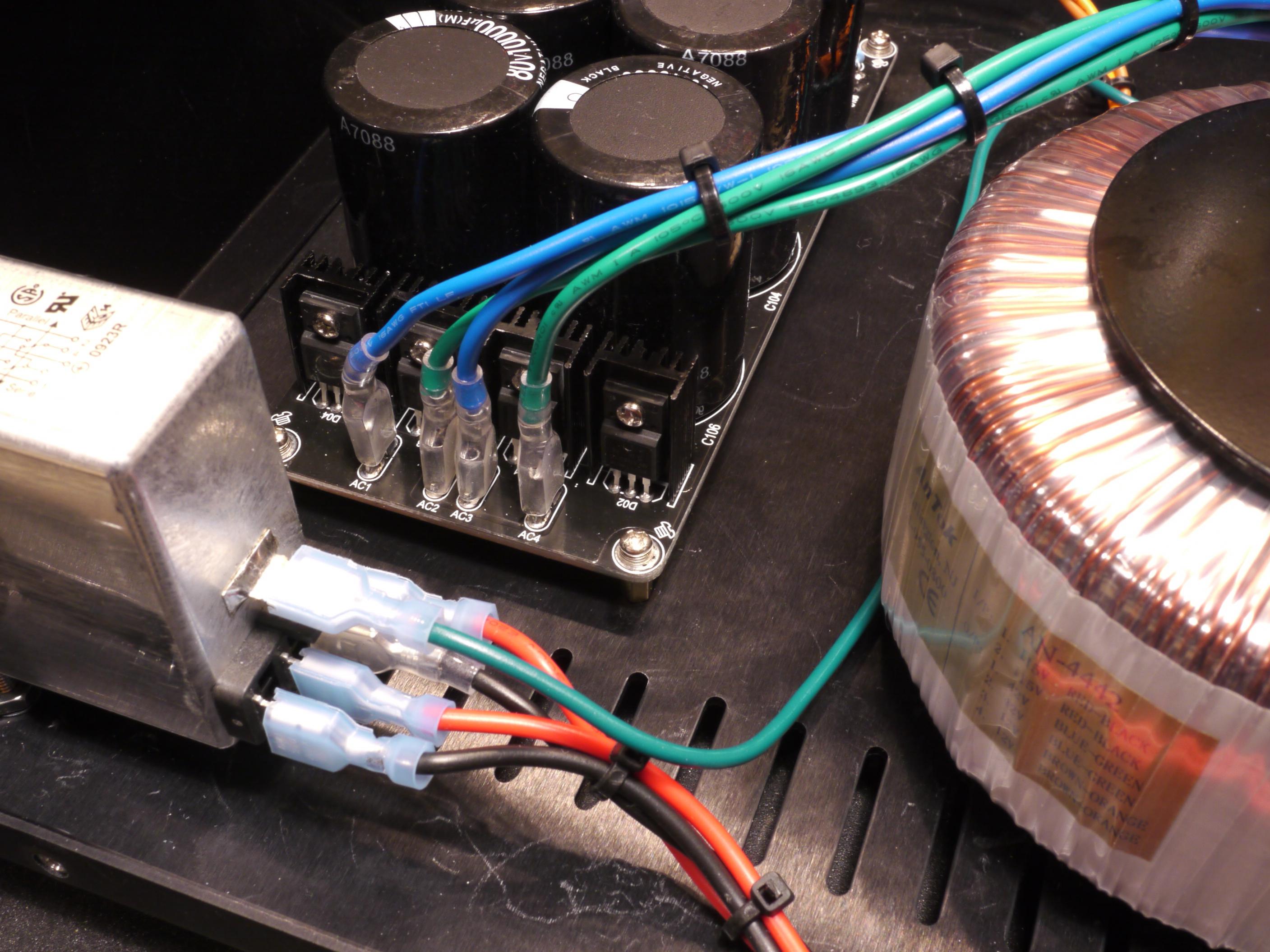

fit 4 fuses............can any one share short circuit protection schematic for it supply 80 volts dc +/-.......
on the mains feed to the primary. Close rate this.
on each PSU supply rail after the main smoothing. Rate this to suit the maximum current into the rated load.
on the speaker feed. Rate this to suit maximum current into the rated load.
These might not save the amplifier from damage, but should save the transformer & PSU and speaker.

Are those things NP electrolytics in the signal path? The C2s?
Oops, somebody else posted something similar.
Good point tho; I'd get some ClarityCap 250v jobbies in there.
Hi I did try some in another amp a while ago on the input cap but they softened everything went beck to the wet tant in the end ?
A big film on the feedback is a good option if you can get on 68uf

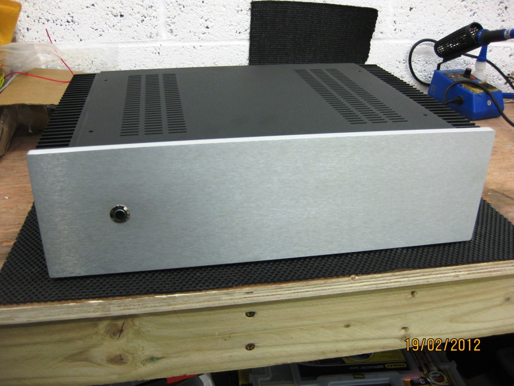

337 - May I ask where you sourced those enclosures shown immediately ^^ above?Hi I did try some in another amp a while ago on the input cap but they softened everything went beck to the wet tant in the end ?
Alan

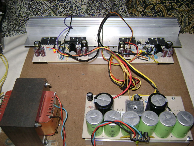

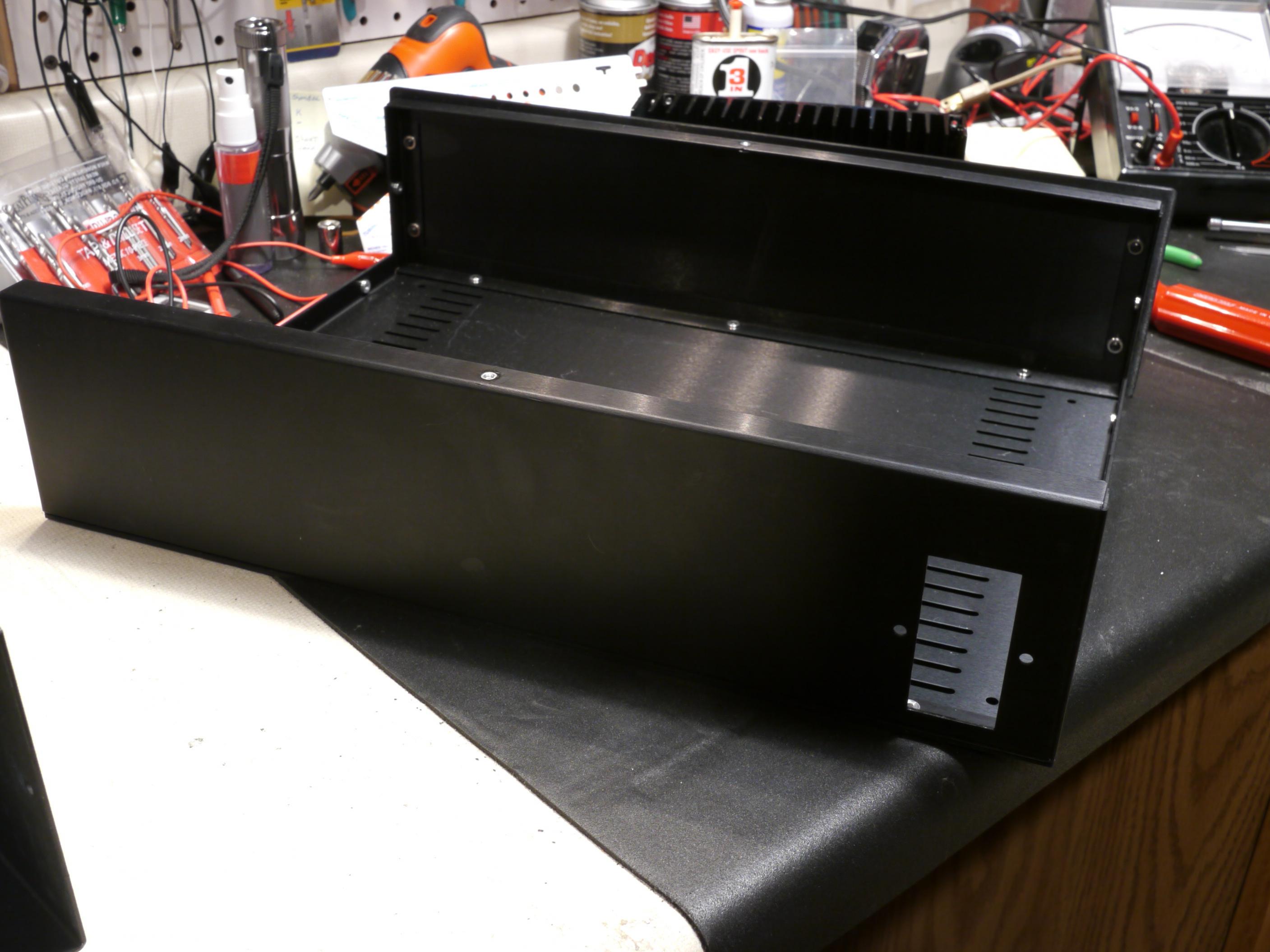

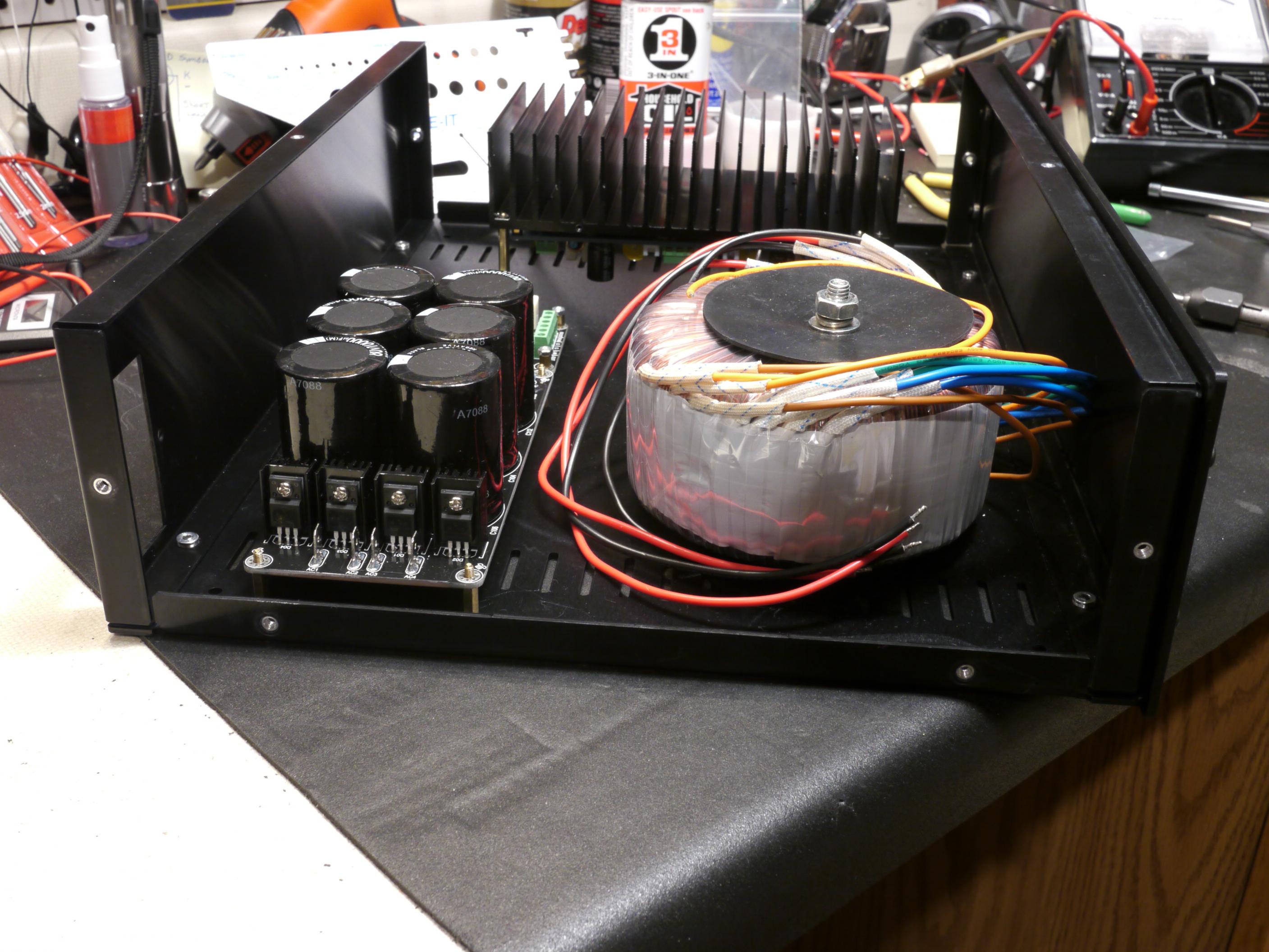

Nice execution on the amp build. I like the idea of separating a power supply from main amp. But the heatsinks were with the power supply??? And the bridge were with the module??? More detail, please.
They are from modushop.biz I think this site has a deal with them, they are nice quality cases
Alan
Yeah that was bad planning im afraid bough the cases before the other bits oppsZ
Dont have that amp now but it was a good one
Incidently the avondale NCC200 amp boards dont realy get hot so they run happily in the 2U case with small heat sinks pesanti
Alan
