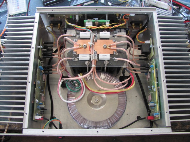

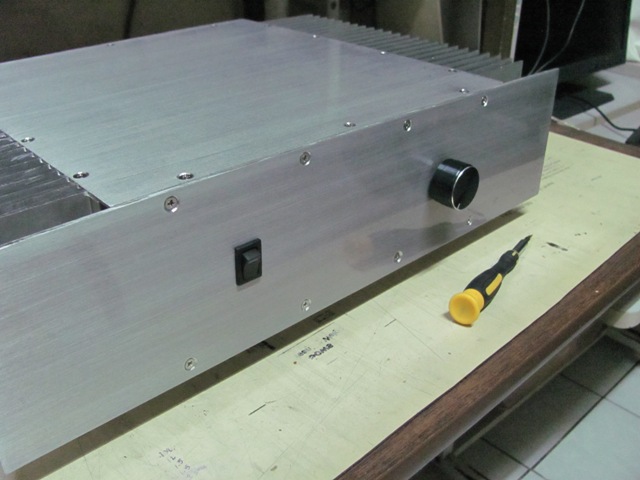

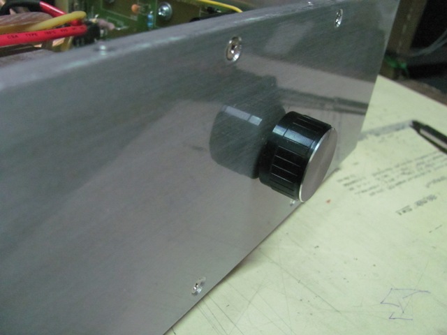

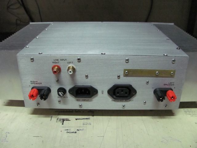

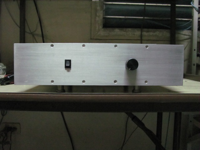

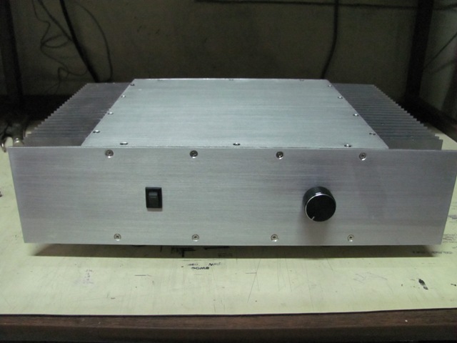

Here's what I've been working on. A P101 high power version stereo amp.
attachment.php

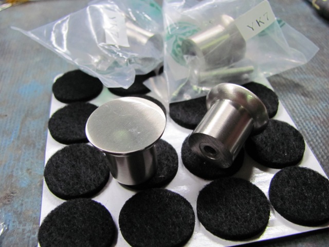

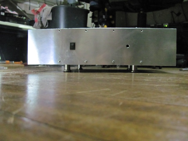

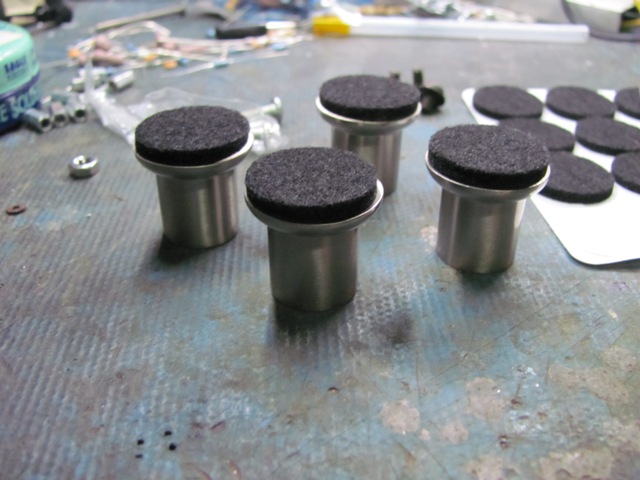

Looking for suitable amp feet, I stumbled in the cabinet supplies in the hardware store. Add some felt discs and viola!

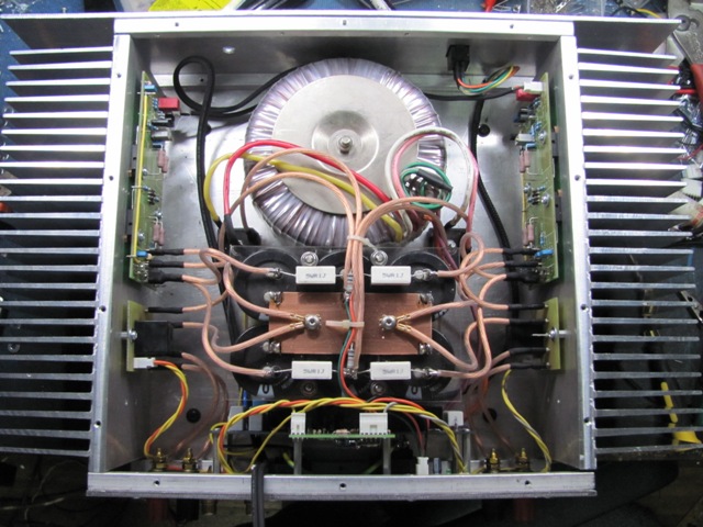

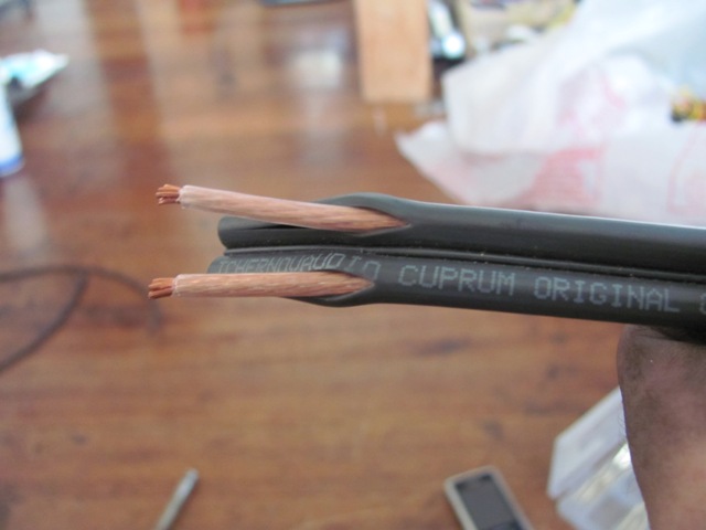

Used Russian Tchernov Audio cables for the internal wiring. Stripped the outer jacket off since it is too thick

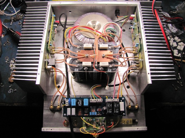

I attached the last pic I took with everything completed inside. It actually sounds pretty good even with jellybean parts used. When the higher quality parts arrive from digikey, I'll take the boards out again and replace them.

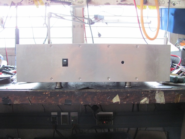

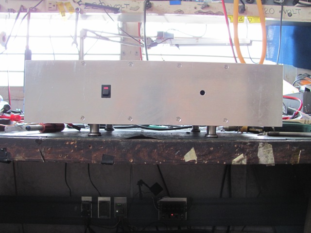

I'm actually torn on the power switch LED color. I can't decide to retain the red or change it to white. I also attached pics on how they look with red and white.

DjQuan, what did you use for clear coat? It looks great
we posted on the same time lol
I used ordinary clear coat from spray can. I think it was acrylic

Red for on seems wrong.
Red for danger, maybe.
Red for something gone wrong seems unambiguous.
Grn for OK, or ON seems far better.
Well, the red looks ok to me on contrast with the brushed aluminum and black switch. I no longer like blue because everything seems to use blue led nowadays. 😛 I haven't tried green though. If I'd go green, I'd use the true green ones not the yellow green. I'll give them a try next weekend.

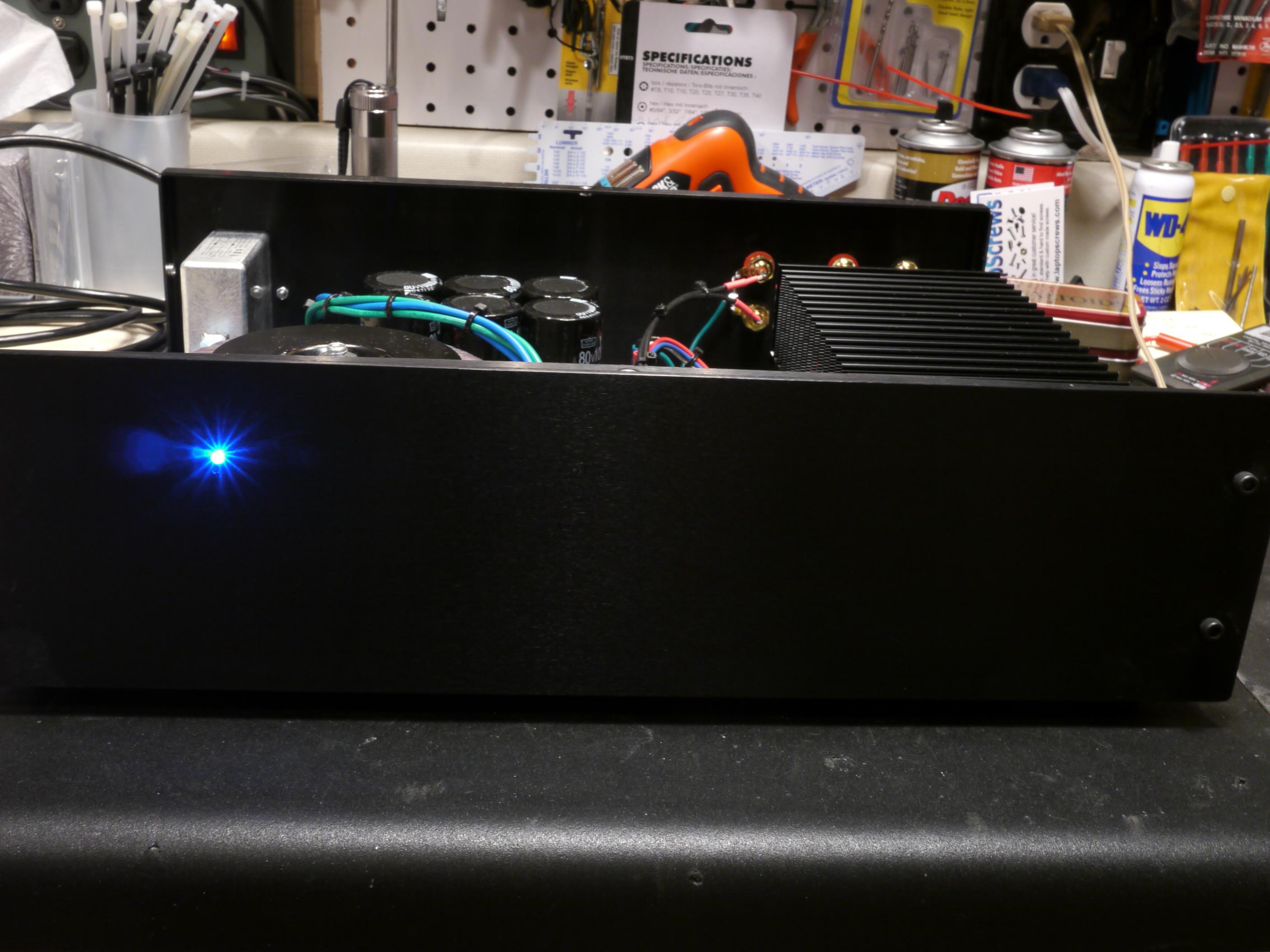

That's a sweet looking layout. Either LED color looks fine. I guess it's just a personal thing. 🙂 You could always go blue as I did (below). It looks much brighter and has that star-burst appearance because of my camera. I went with blue simply because I had built a couple other pieces that used blue so I continued to follow that theme. I could lower the brightness by adding a resistor thus lowering the voltage, but right now it doesn't bug me. 😀

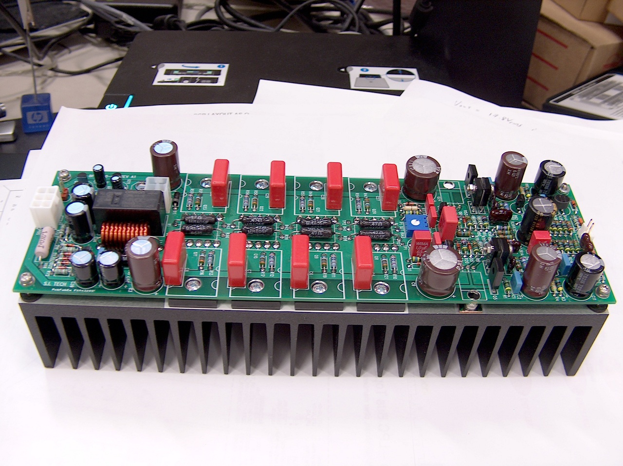

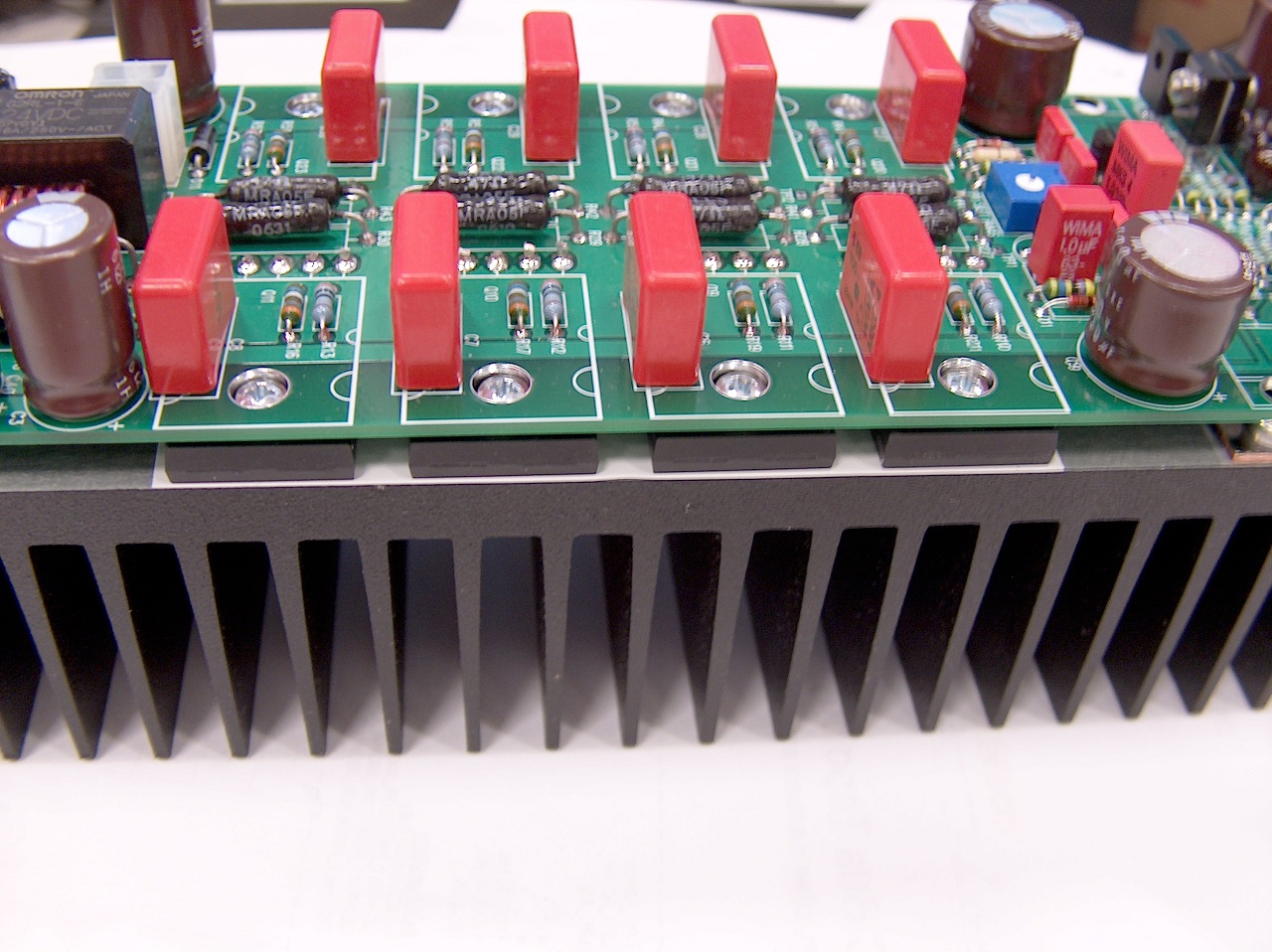

Here's mine. Version 2 of my Class AB ThermalTrak power amp module. Version 1 was posted sometime in 2005 (too many projects, haha).
PCB is 250mm X 75 mm.
Nothing exotic but decent parts used throughout....
4 output pairs for up to 200W/8R output (100W as shown)
100V 105C high temp low esr electrolytics
Silver mica caps for the high freq caps
Wima film caps for decoupling
Mills MRA05 low inductance emitter resistors
Onboard output delay, dc sensing and thermal shutdown
Keratherm White 86 thermal tape
Power and Output connectors are locking Molex Minifit Jr types. Screw/spade terminals are a big no-no here at work. LED color is not mentioned, heh.
Pictures:
1) Overall picture of board

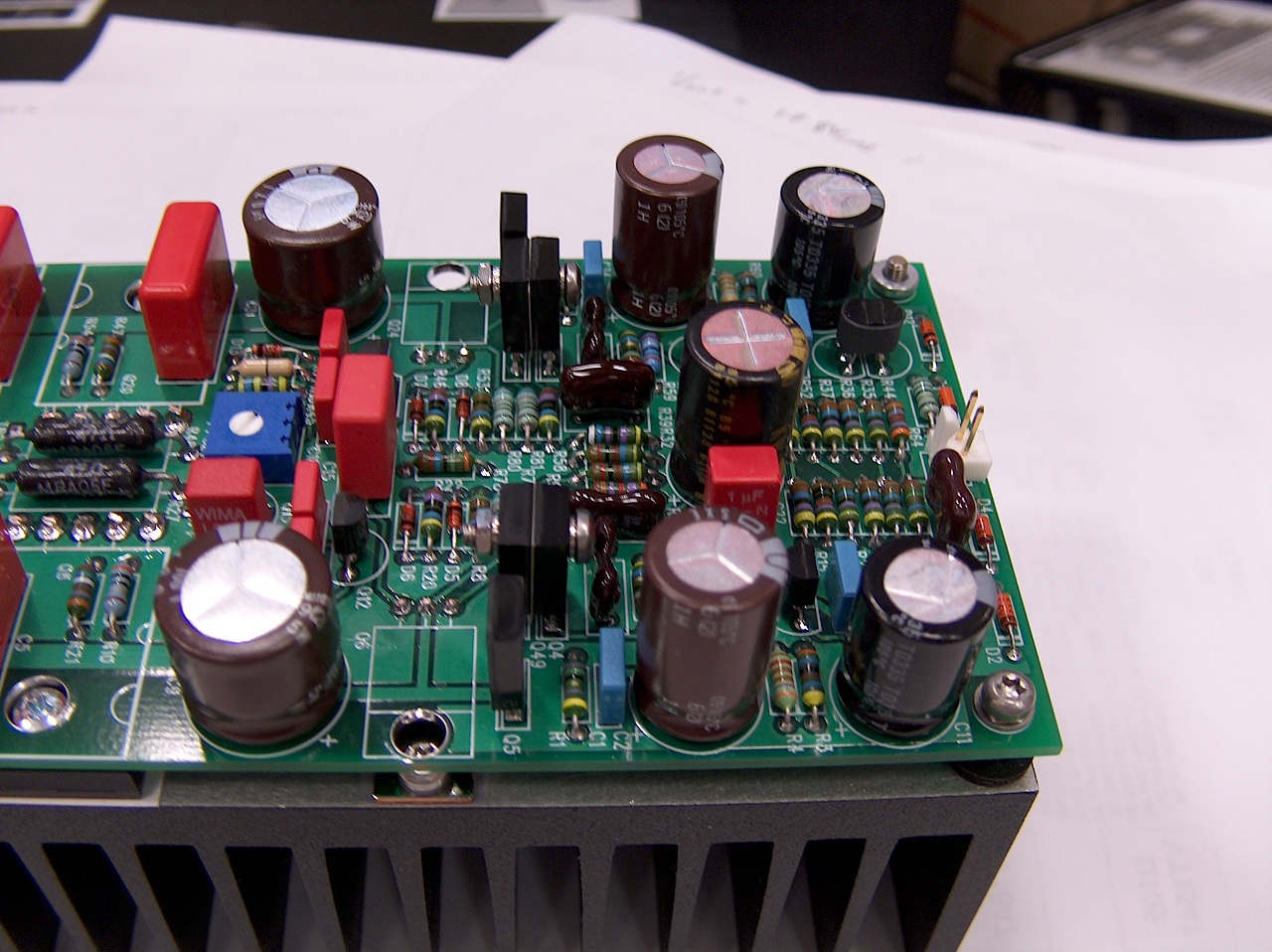

2) Input/VAS detail showing how input TO92 pairs and VAS cascode pairs are thermally connected
3) Output stage showing individual base resistors and Wima 0.68uF MKC decoupling cap
