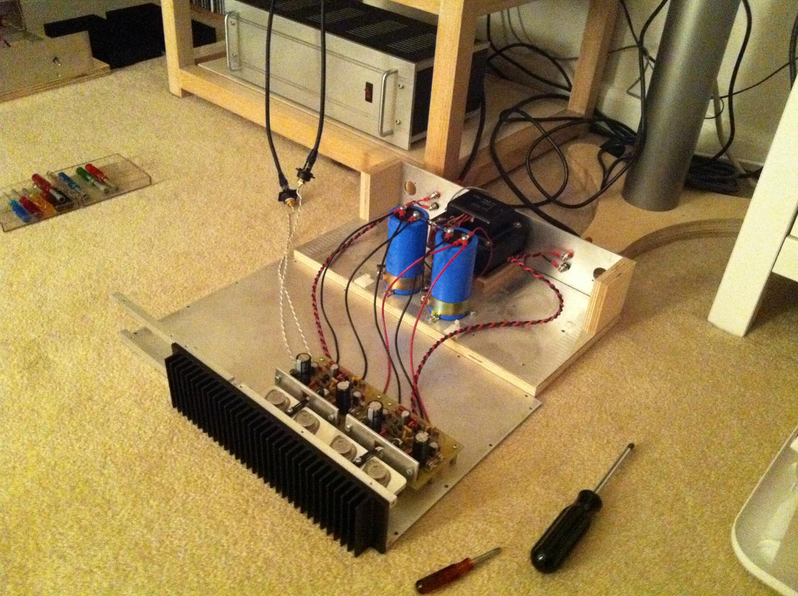

I understand your confusion! No, as I said, it's a work in progress. Lots of wires still waiting to be connected, plus the rectifier/capacitor board.
Here's a picture of the test setup I used to verify the performance with the ST transistors.
-Henry

the test assembly shows your PSU connections.
You have at least two tappings from the PSU Zero Volts.
One on the left cap to the left channel and one on the right cap to the right channel. This is wrong.
The three wires from the PSU to each amplifier, zero volts +ve -ve, should be twisted as a triplet and taken to the amplifier as that triplet. At the amplifiers (since it's two channel) the triplet is Y split to form two sets of triplets. One set to each amplifier. Keep these final triplets as short as possible and use low resistance wire in the Zero volts between the two amp boards.

Thank you for your very correct observation. If you were to zoom in on a high-resolution version of the photo, you would see the stubs of black wires adjacent to the transformer center tap connection on the bus wire between the capacitors. This is where the circuit board power grounds were originally connected. For a test lash-up, I was not concerned about punctillious grounding.
FWIW, the chassis with the power supply was a breadboard that I used for testing the complete amplifier before I eventually built this:
[wiki=http://www.diyaudio.com/forums/solid-state/96192-post-your-solid-state-pics-here-226.html#post2907972]%[/wiki]
The final version of my latest amplifier will have a dual-mono power supply with correct grounding and modern filter capacitors. (Those Sprague blue cans are 30 years old!)
-Henry
HP,
triplets ? i don't think so Andrew always ground is supposed to be out of the "twisting" twist rails together yes but ground never with them .

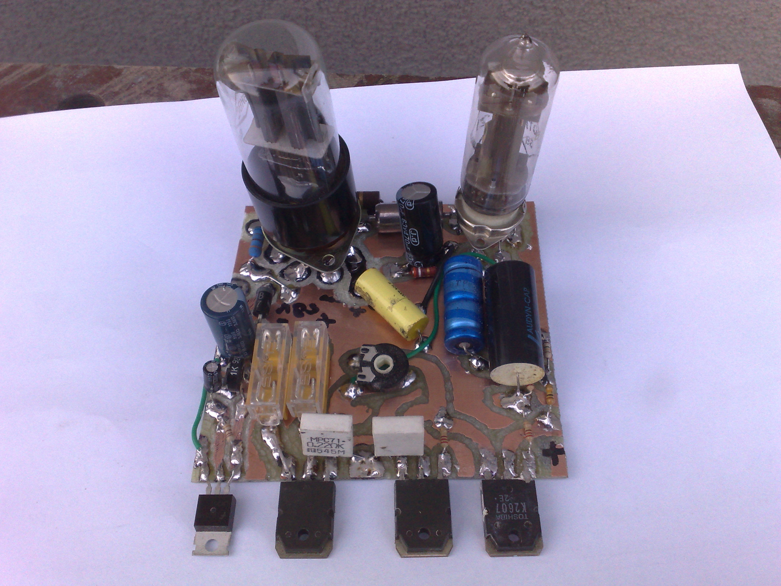

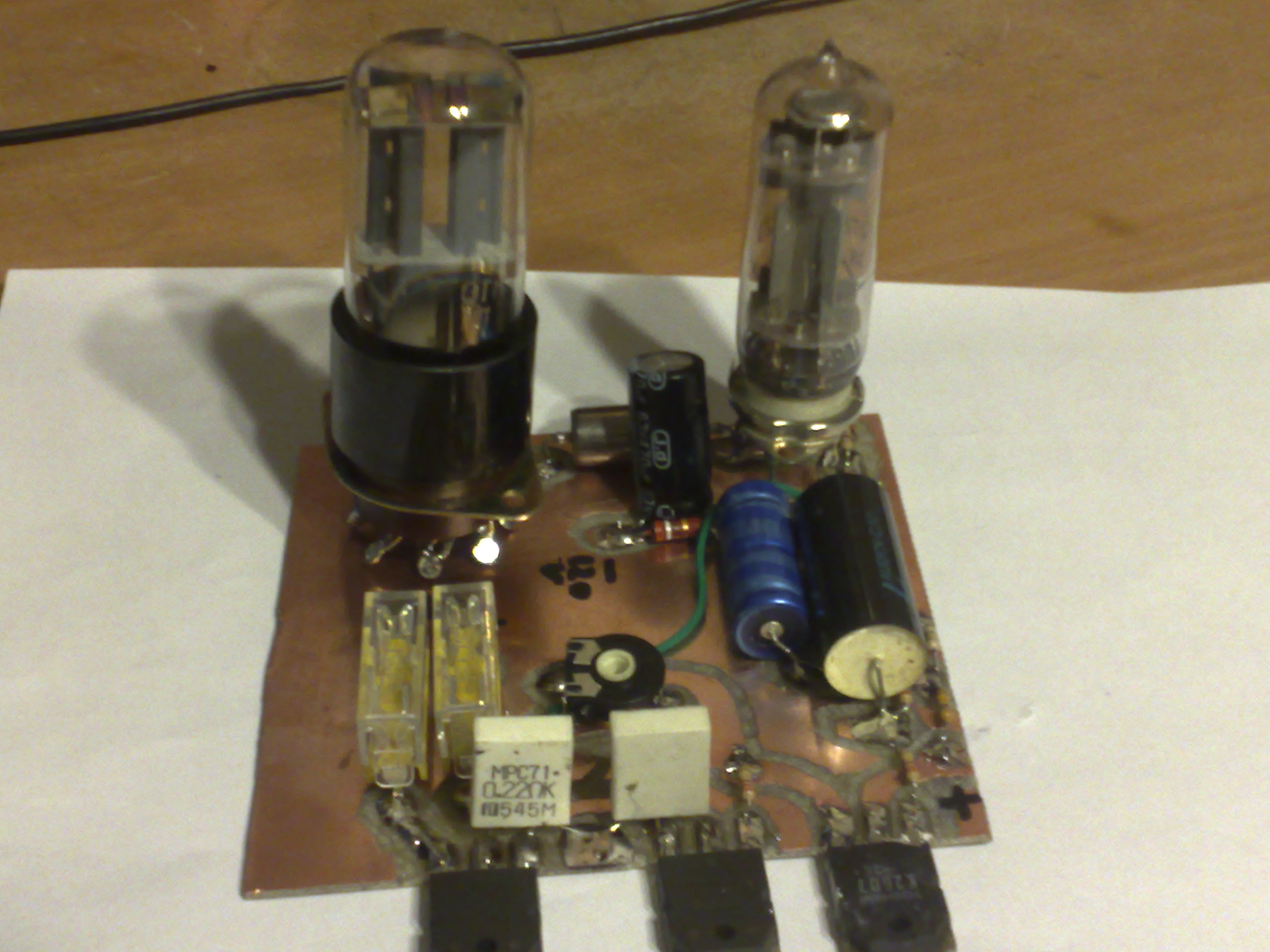

some little test with a hybride, mosfet dc driven by a 6C19 and a srpp 6N8, the 6C19 is not a cathodefollower but a plate follower driving the mosfets, I did need a high current low mu tube because of the mosfet capacity and to not to use feedback.
The printed circuit is made with a dremel, because it is just a tryout how a hybride without a cathodefollower sounds, this one has none, the 6n8 is not yet soldered that happens today.
Wow, far out. I'm a great believer in hybrid amps. I'm guessing it should sound smooth.

I have now everything soldered, how it sound I do not now yet, a version of it with cathode follower works here for already 4 years, still with wires and no pcb.
this has a p follower to test, it is a pcb made with dremel, and some old parts for testing it, It is ready for the big test after cooling is ready, LM350 is also on board now with supply.
Do it work nicely I make a board for it.
