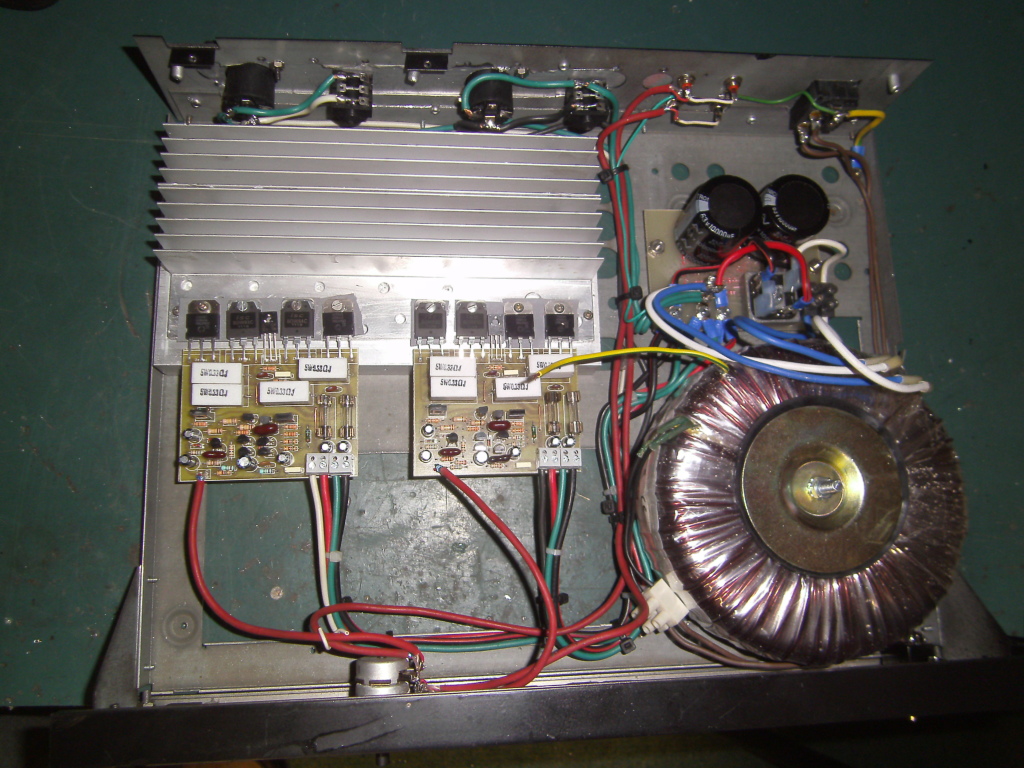

Hi there all
Theres some fantastic looking amps in this thread, my next project after ive finished my DAC will be a big amp. (im only a newbie)
This was my first project i ever did, a half assembled Velleman K4020 kit i had given a month back.

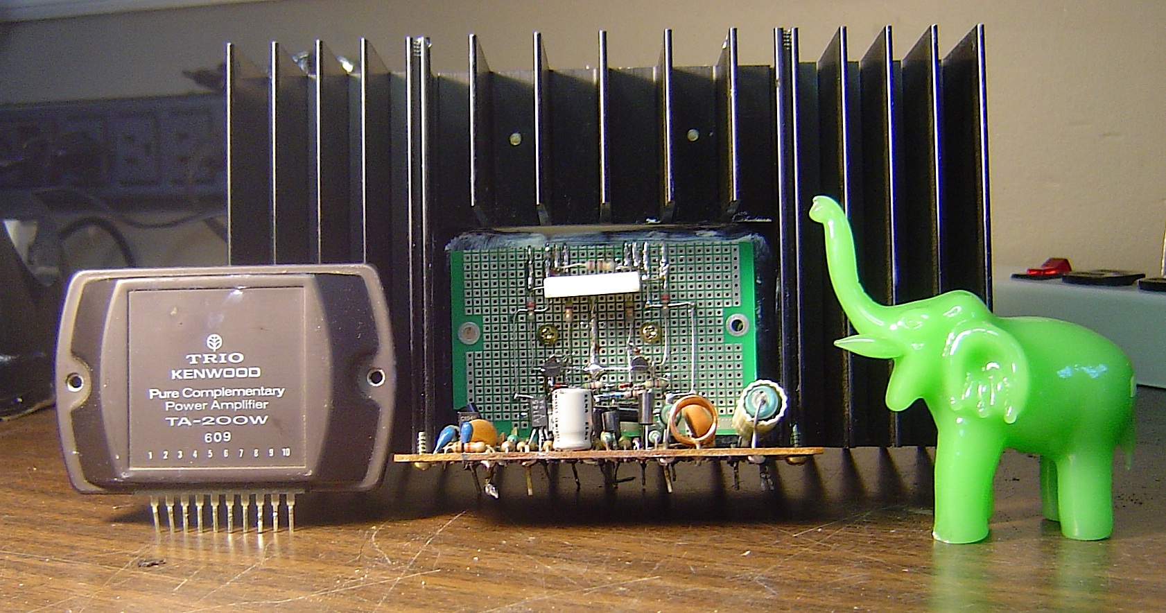

TO-3 SymAsym
I had an extra set of SymAsym boards and I decided to use them to rebuild an old amplifier. The layout is a bit unfortunate, but workable. Since the heatsink assembly was made for TO-3 transistors, I chose to use a set of 2ST2121/5949 outputs. The amplifier is unconditionally stable and has a 450kHz bandwidth.
Here we are, work in progress.
