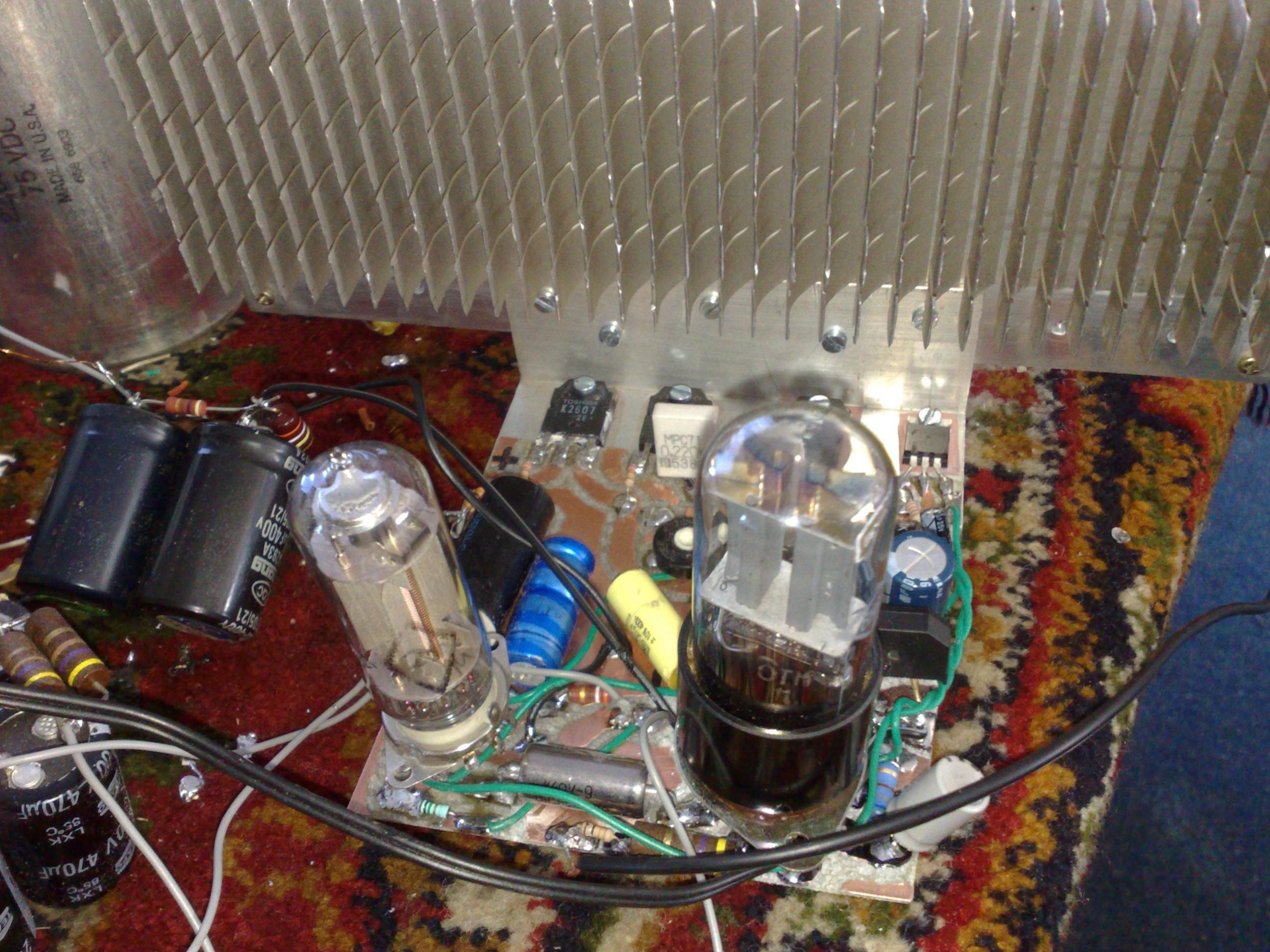

not so difficult with a right tool. it is done outside with a protection afcourse.
if it works then I make a board with ultiboard, or better with eagle.
it works faster then with bread board spcial if it is simple.
I am busy (2 year already) with a pcb mill construction, but I am not further then parts, it is expensive.
Hihi I do not such thing, but as economics colaps it is maybe needed.
But if i have everything then I build a pc mill machine, I have no 70 procent of the needed parts, it is expensive so I take time for it.

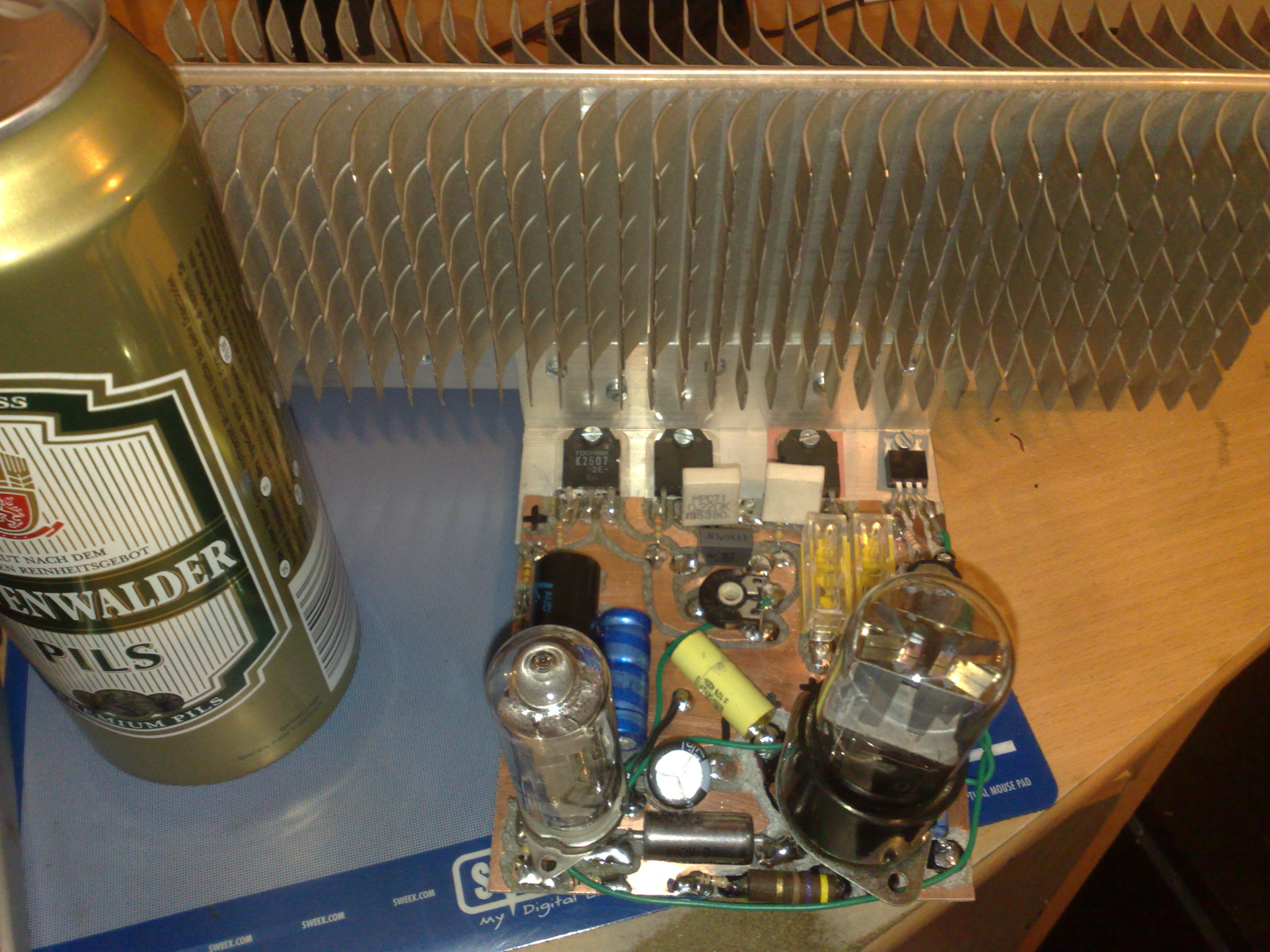

Here the amp is ready for his voltages. 2x 58 volts, 2 x 120 volts, and one 350 volts, so if the dog of my mother comes tomorrow I let him sniff on it.
The bottle of beer is for get some extra balls for the big bang.

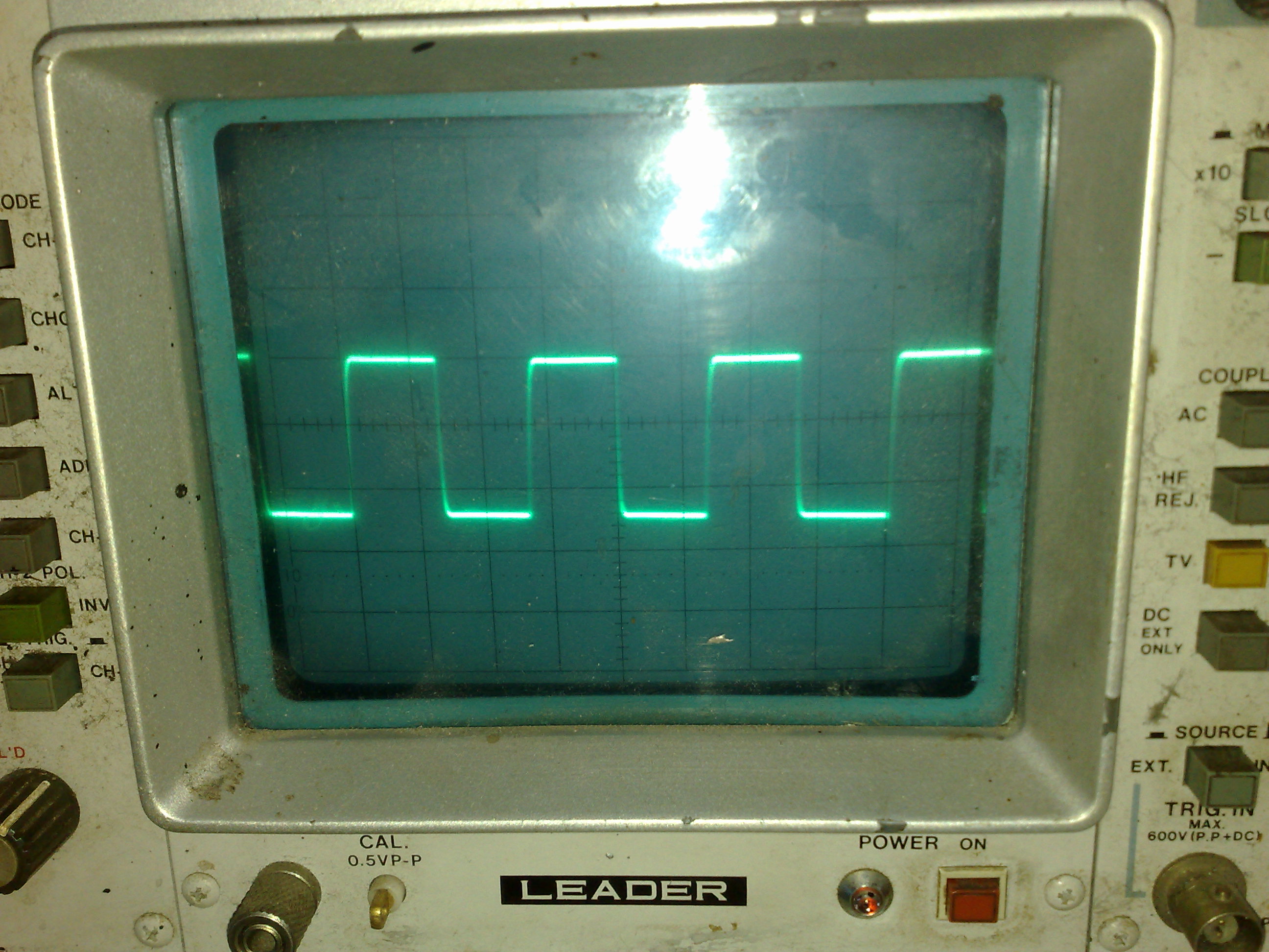

First tests square wave 20 Khz on driver mosfets 2sk1058 and 2sj162 as you see no overshoot, without compensation.
idle current for mustage who drive the power mosfets is 60 mA, and go as high as 100 mA, so I have a lot of drive, witch make speed happy for transients , amp has no feedback and no cathode follower anymore, it was close to simulation, the only thing I did change was the grid resistor for 6C19P 100k was to low, loose of low frequenties.
used tubes 6C19P and 6H8C.

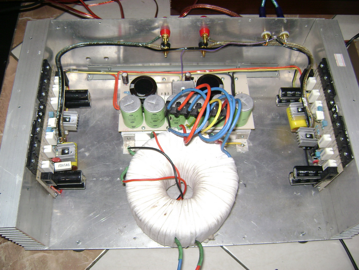

An amplifier of beauty
Dear Mr. Federman, that is amplifier is a work of a art! Congratulations on such fine work.
Very nice amp Federmann! is that a class A amp? How much capacitance do you have in the power supply?
My HQQF pleasure (a few shots and measurements): perys | perys - hqqf_2012 ? rajce.net
it sounds great, very very close to eg. (tube!) Jadis DA-30, and much better than many other amps I could tested and listen during my hifi-voice.com reviews...
2 x (5+5+9) * 3,3mF
2 x 62,7mF/63V
