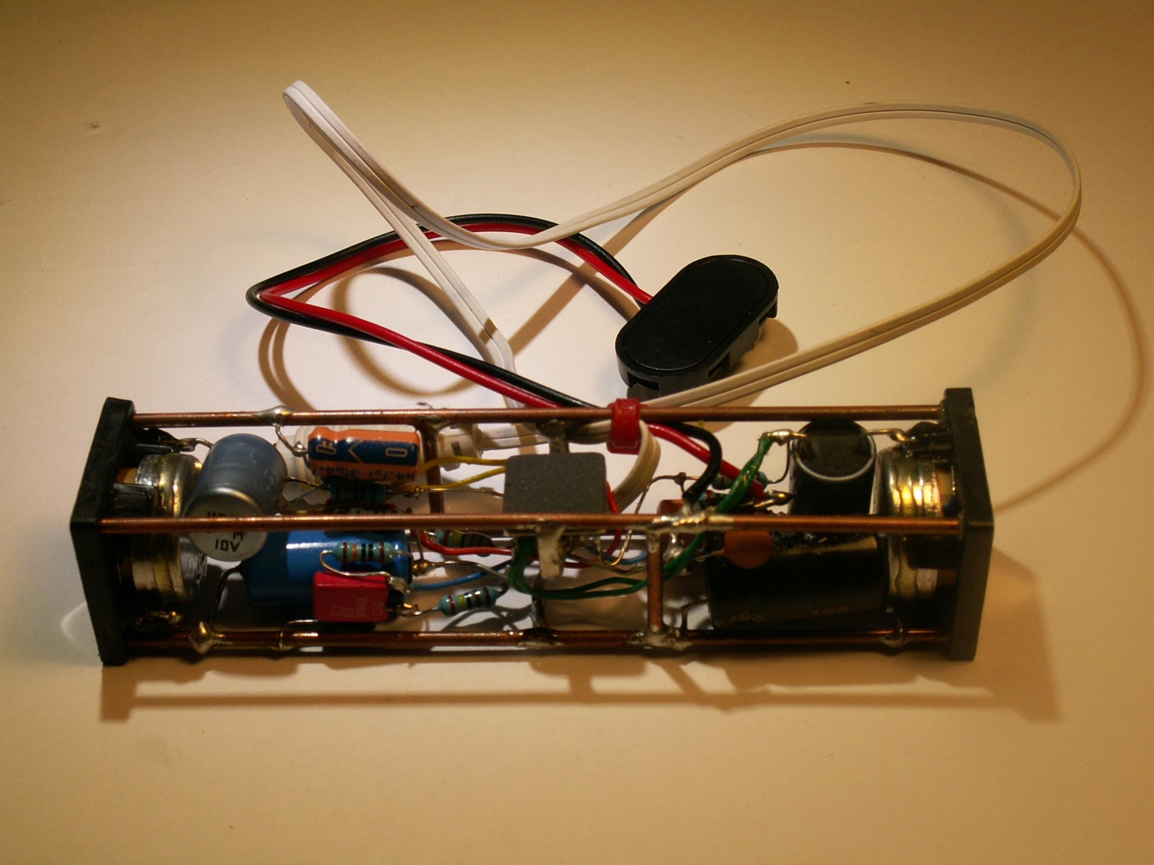

I like it 🙂
Super job on the amp by the way, puts many a commercial jobby to shame.
I agree! and the best of all.... it is a diy amp!!!😉
This is great. I love it's uniqueneness. Only one in the world.

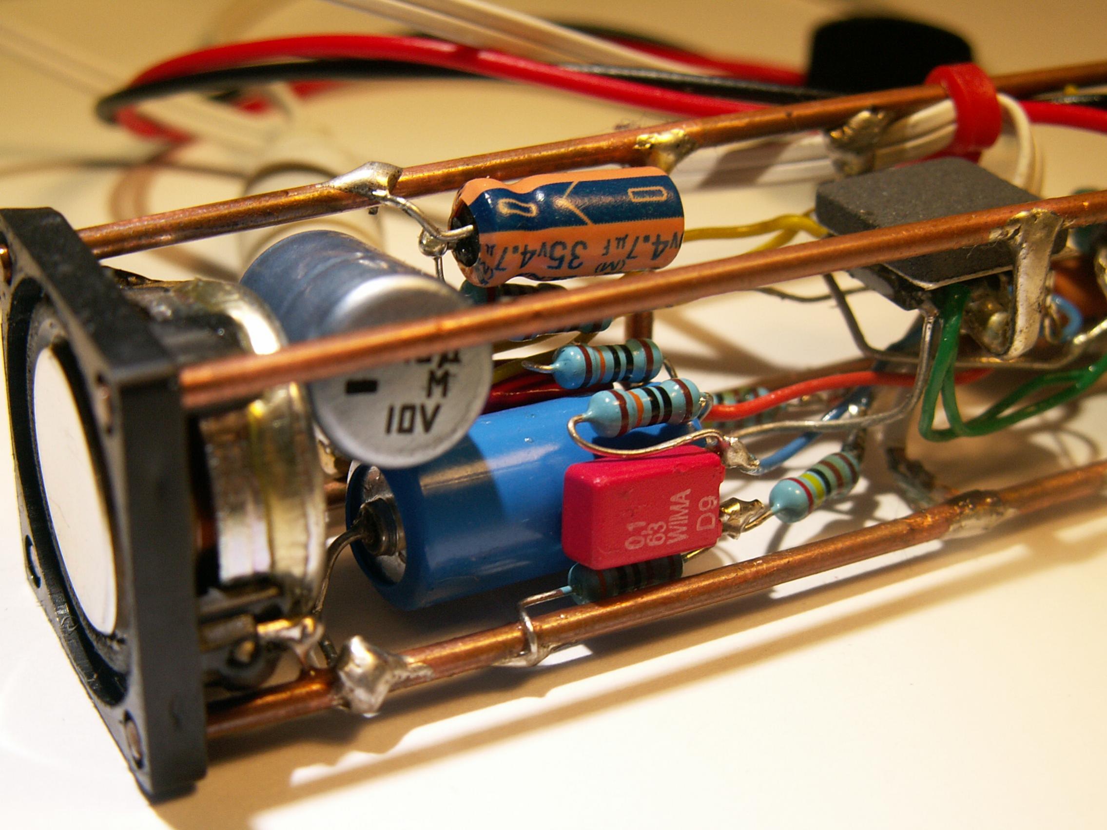

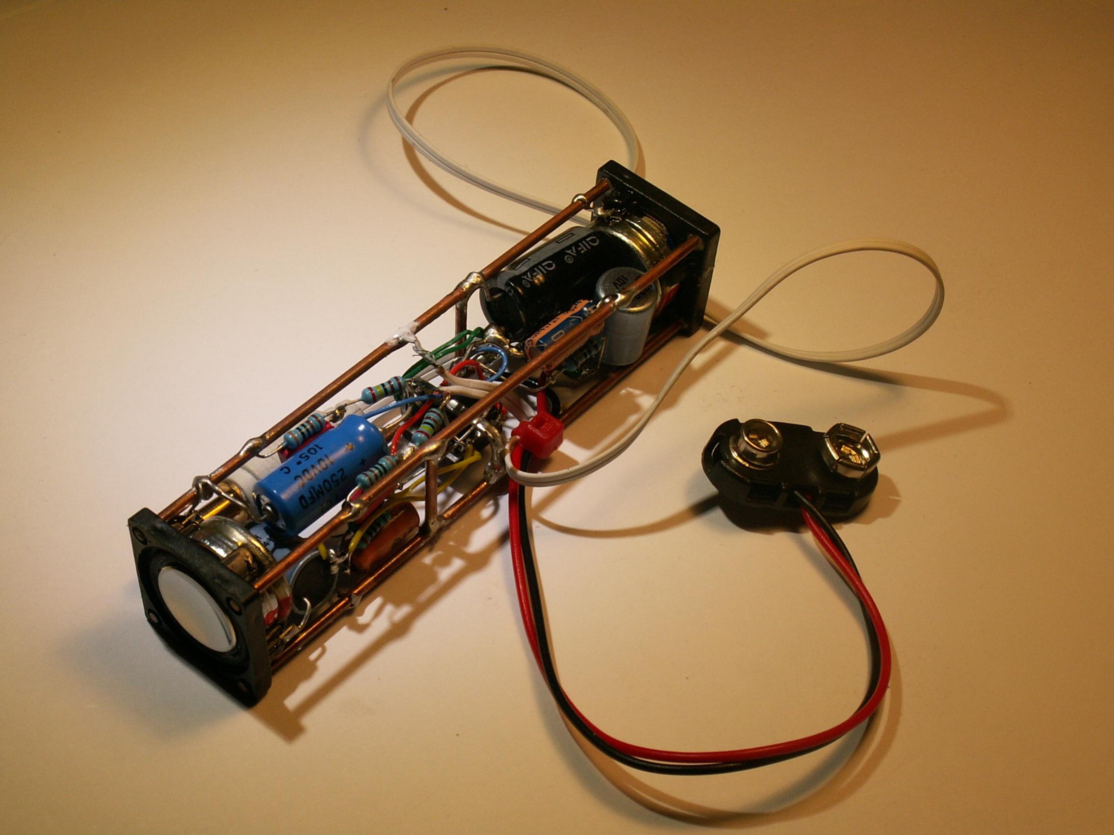

Solid state 2x2W with wirewound resistors and hifi caps. This and similar amps I make are assembled without PCB. It provides advantage in component contact and conductivity. Amazing treble!
Only one? 😀
Folks, do you ever assemble your amps w/o PCB? It can be messy to make an entire unit because some components end up being loose and need additional support to be kept in place. Units I make now use LM1877 that require a number of external components. I was able to make sturdy design with that circuit. Next challenge is a transistor amp. I use heat shrink tubing to make cases and copper rods for frames.

Using LM1877, 2x2W with 20mm speakers
That is a very nice and unique amp!. Nice job!😉
