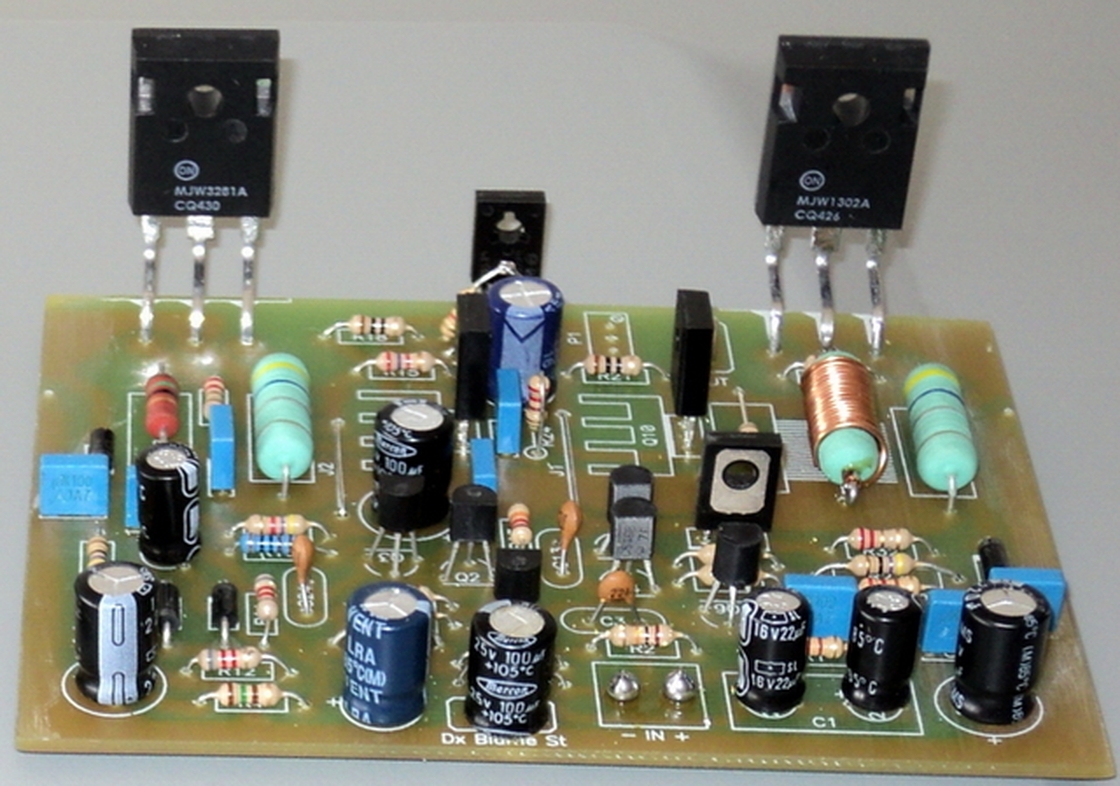

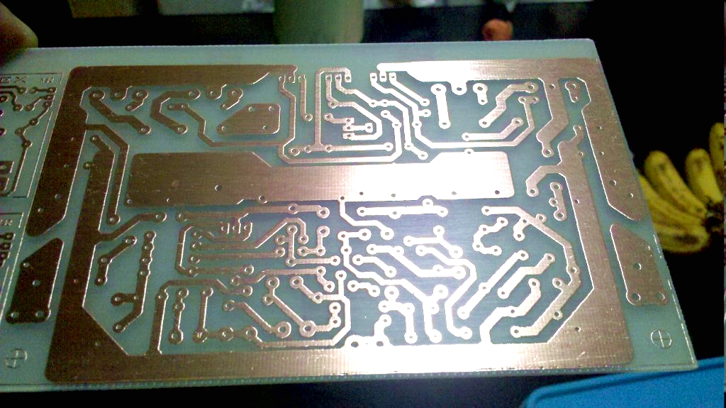

some pictures folks.... a DIY pcboard, etched at home

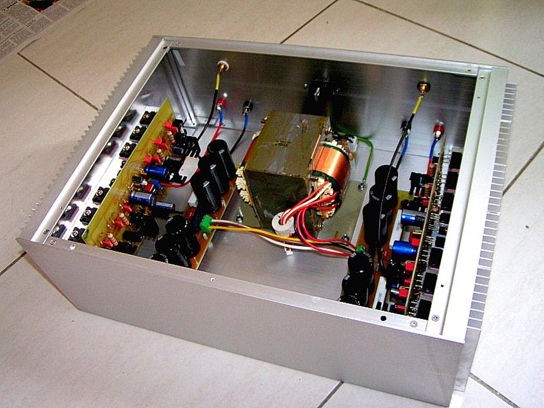

A Dx Blame ST amplifier that was object of a Brazilian group buy and a nice amplifier built by Junie (Precision 1).

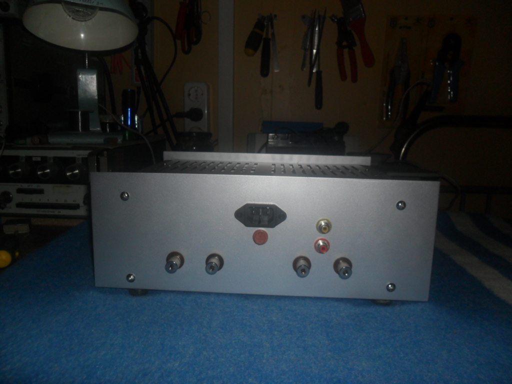

its been bugging me for some time to play with a couple of things ... one to try a P3A modified for higher input impedance... aim was something like 100K but finally i started with 47K
Target was to make he amp more friendly to a preamplifier which i am very happy with the DOZ i am listening the past one year but if dynamics are better with the 47K at low levels i might as well go back to a passive thingy .
Then since the specific amp will work for my bench the load is Z=8 R and that will be a fact that will not change and also the actual required power will be less than 20W for every day casual listening i though about boosting the rails to 50+50 volts to gain room for dynamic peaks ...
first listening impressions are more or less spectacular sound is more analytic bass is very tight ( middle got a bit better than previous setups ) high is plenty and crisp while everything is crystal clear ....
with bias of 70 ma for starts all seem to be fine i might as well stay there but next week i am going to see what happens with higher ...
Other than that all the rest is pretty much standard ...here is a description of the setup
----2*35 volt trafo rated at 1kva
---120.000 mfd of total capacitance
---220mfd +2.2 mks decoupling on board
---MJE 150xx Vas with 100pf miller
---my favorite drivers Bd 829-830
--- Drivers on a common heat sink with the VBE attached to it
---closely matched LTP with thermal junction
---and of course legendary original 2SA1302 2SC 3281 pair for the output
enjoy some foto and i am willing to post also measured scope readings after playing with bias and miller caps
kind regards and a very happy new P3A to everyone..... oooops i mend new year !!!

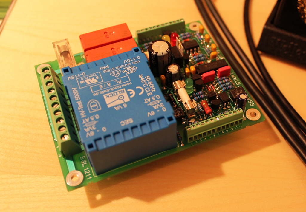

This is my new soft start module, suits any amp's utility needs.
I wish you guys happy and prosperous DIY year.

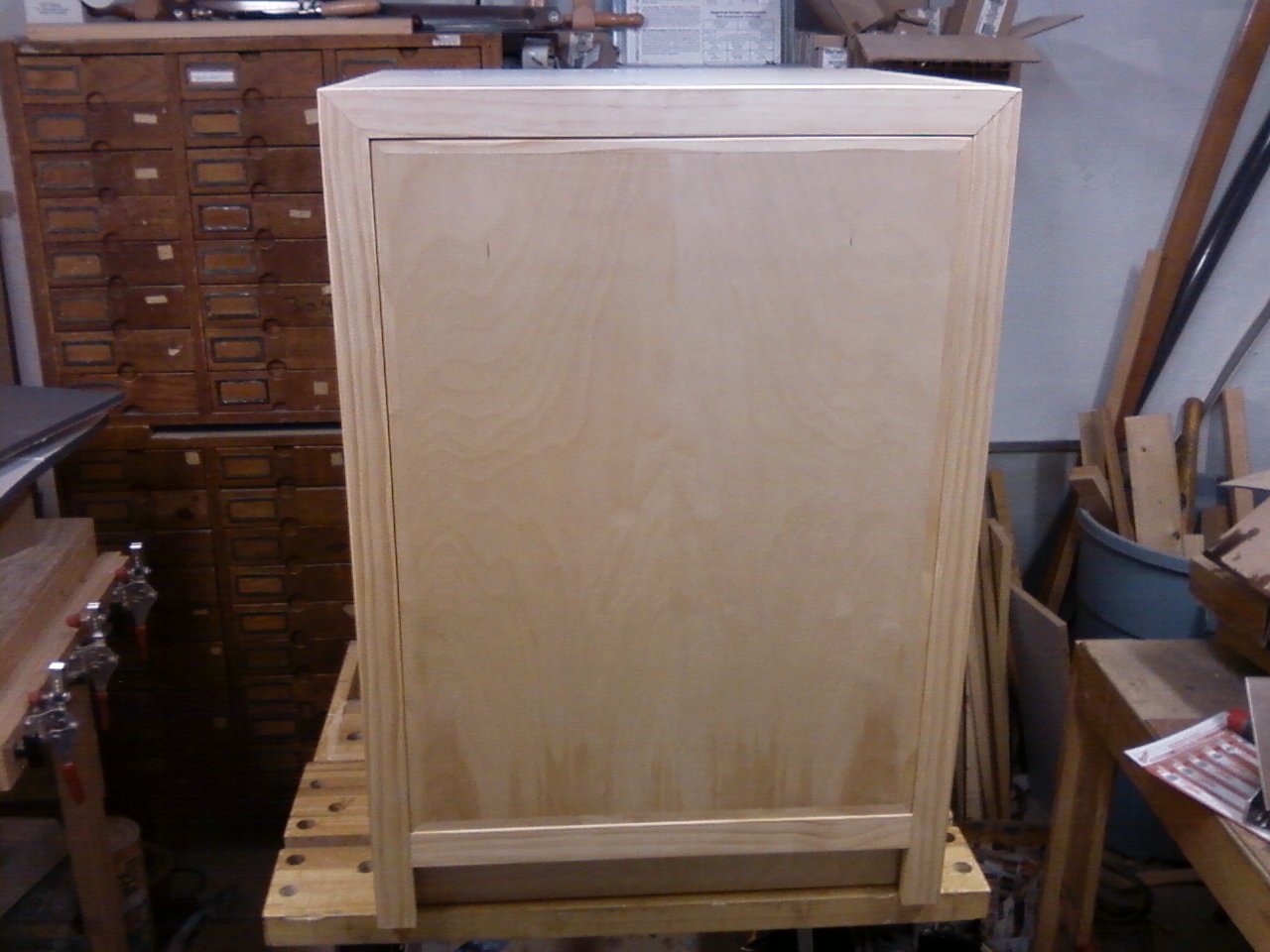

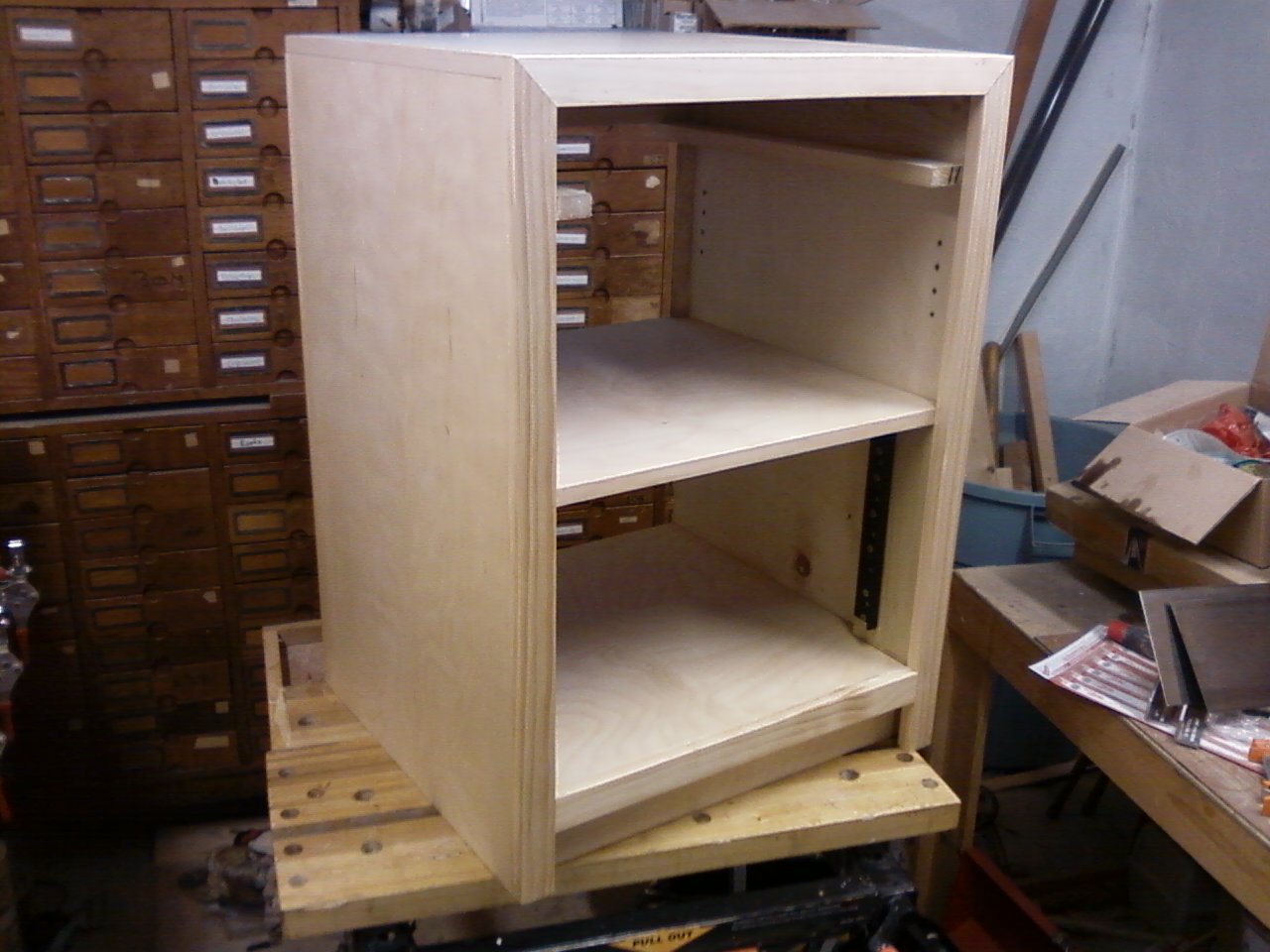

Progress on the hifi cabinet. The face frame is on, I made the door, and the first coat of finish has been applied. I have to trim the door some more for the hinges. The wood is birch and pine. The rack mount below is for solid state amps and a crossover.

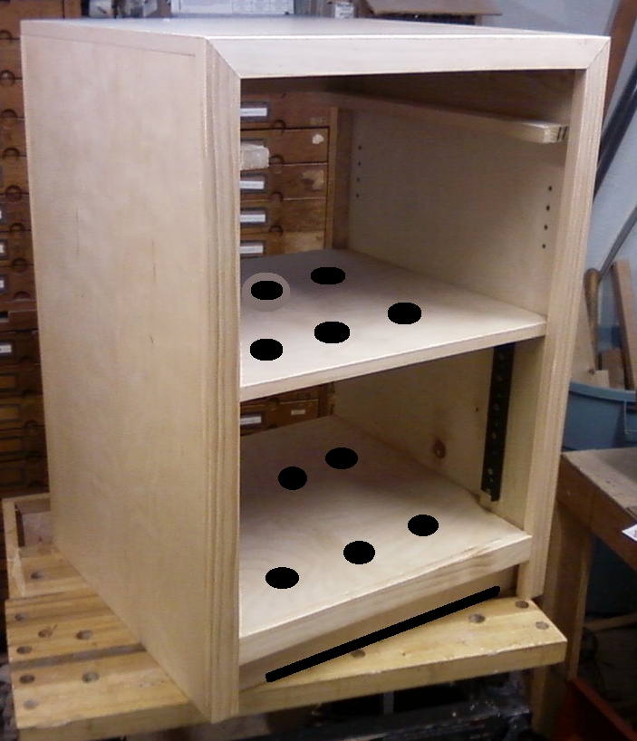

Do not forget you should prepare holes for cooling
Openings for air flow in the back of the cabinet is not enough, unless you will have a very small power devices inside or they can cool themselves using fan blowers internally to their metallic enclosures.
hot air goes up as you know, and this sucks fresh air from below the equipment... to allow low resistance to convection cooling, you should have openings up and down the enclosure...or at least, holes below.
That small clearance we have below our equipment case is not enough...unless your unitary consumption is lower than 20 watts

Thanks for your concern. I doubt it's going to be a problem. I just have low power amps in there. They barely get warm.
