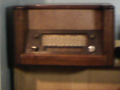

Excuse the blurrity of the photos. New camera, not nearly as good as the old one.

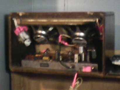

A 1948 Philco AM/FM/SW table top radio.
Gutted, and guts replaced with a '67 or '68 Silvertone organ amp, gained up as much as reasonable. Two TA Weber 8" ceramic Signature Series wedged up inside behind the grill on a slightly horn like baffle.
My best (meaning well intentioned but woefully inadequate) Les Paul imitations look great coming from this. Switch over to some enhanced Frippish sounding stuff, and I can imagine it being time-machined back to the 50's and causing the McCarthyism scare to include a call for government backed exorcisms. I just lurvs brain whiplashing contrast.

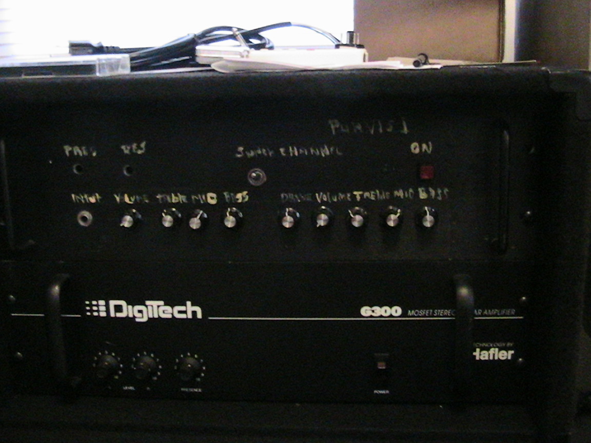

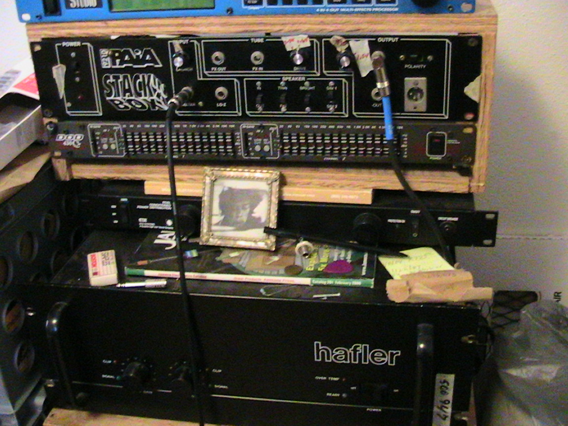

diy all-tube guitar preamp
this is a diy tube preamp, i used Kevin O'Connor circuit design,now i have to convert it to being foot switchable it's a 2 channel preamp,also need to make decent control labels,the rack is my old standby Siab/Paia

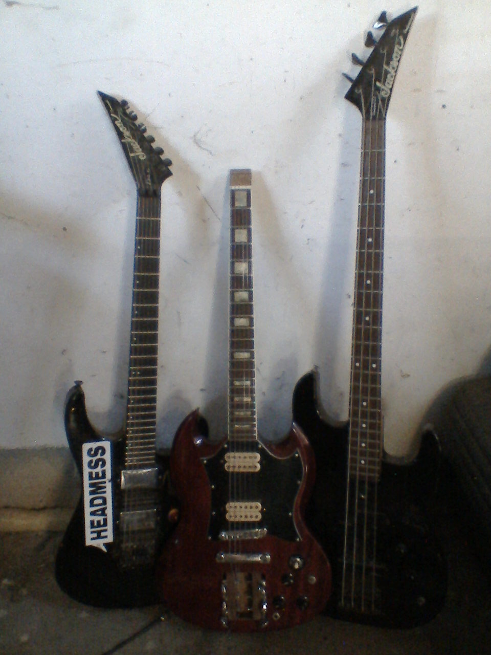

heres my SG...one of a kind 🙂
jackson concept 6 stringer with whatever pickups i ripped out of the epiphone LP. and i think its a schaeller? humbucking single coil in the middle.
jackson concert bass...see how nicely they match? 🙂
and of course,the SG, my junkyard rescue, had a broken head....glued and pinned it, only to drop it a week later. no idea what brand.
this way it looks heaps better 🙂 genuine vintage dimarzios...if 70's or so is vintage?
dont have a pic of my electroharmonix lap steel with three "necks"... and not in the mood to take one 🙁

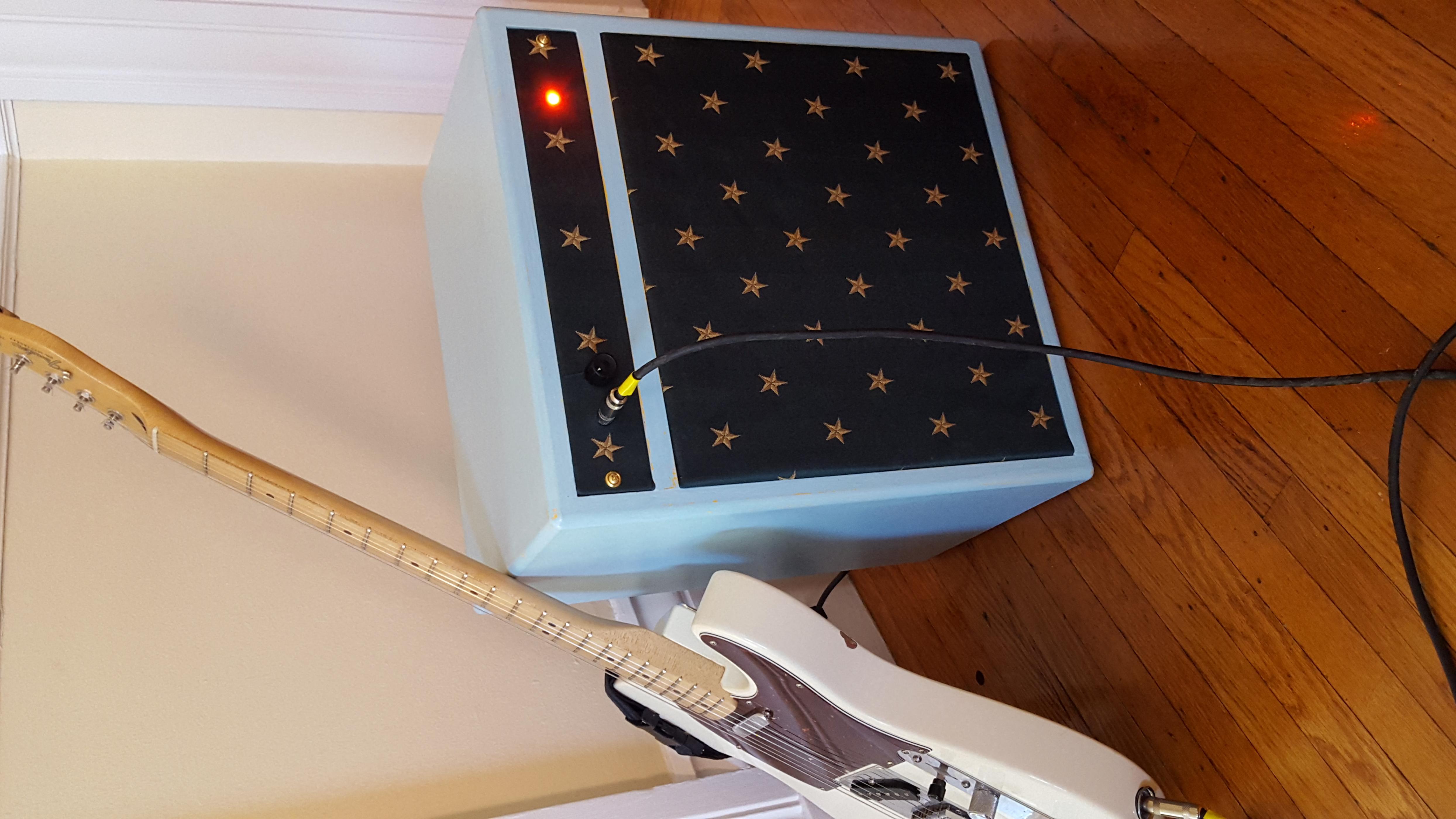

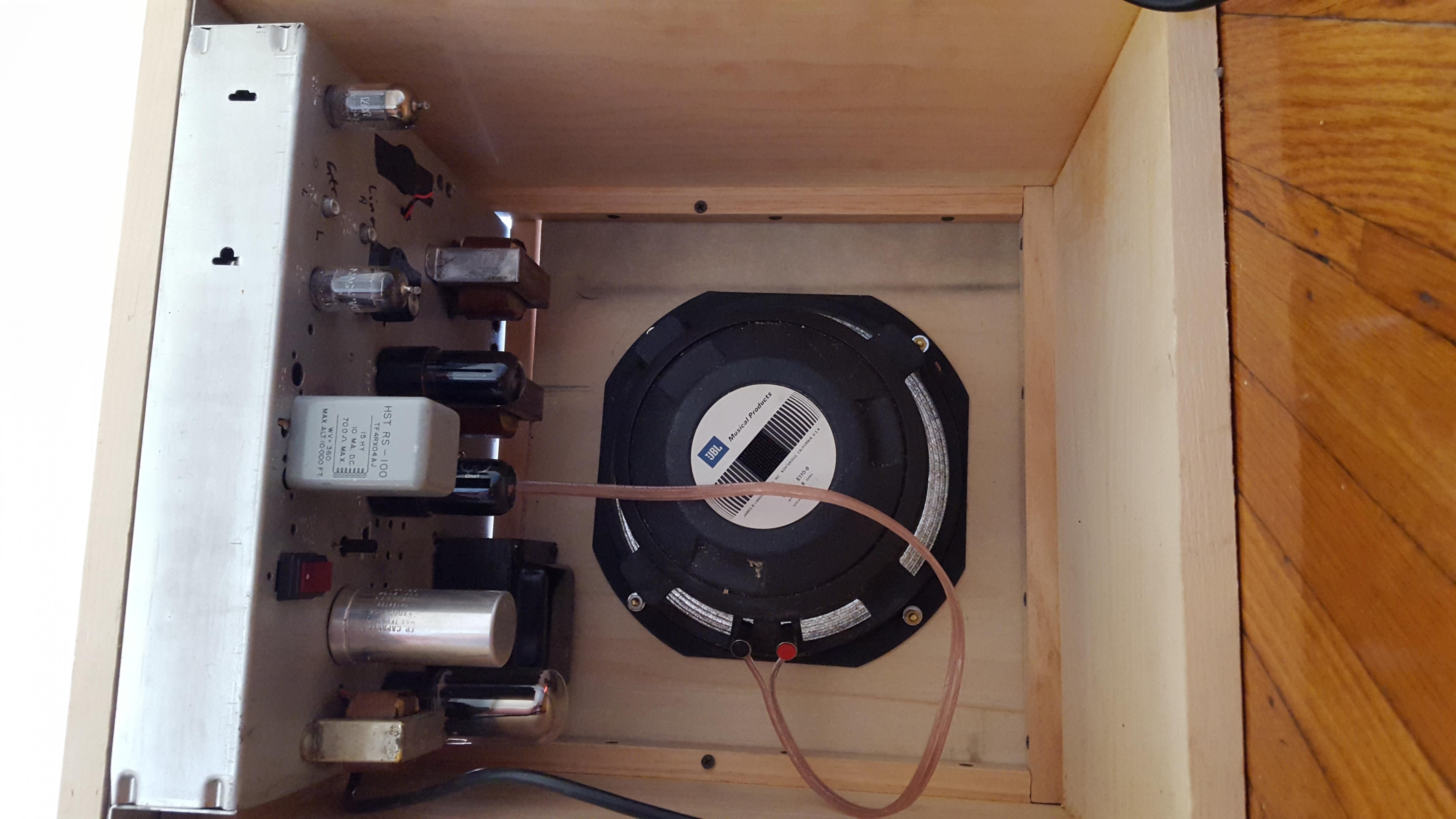

My just-finished build: one channel from an old Magnavox 175/67, with an added 12AU7 front-end stage (choke loaded, just because), wrapped up in a box for guitar. The speaker is a JBL E110.
The sound is very clean and punchy, and gets some quite nice crunch if you push it hard. Plenty loud.
Bonus feature: dual-color power LED. Green powered from the heater, which comes on right away. Red in the cathode bias circuit, which lights up as the tubes warm up. I'm really pleased with the result 🙂

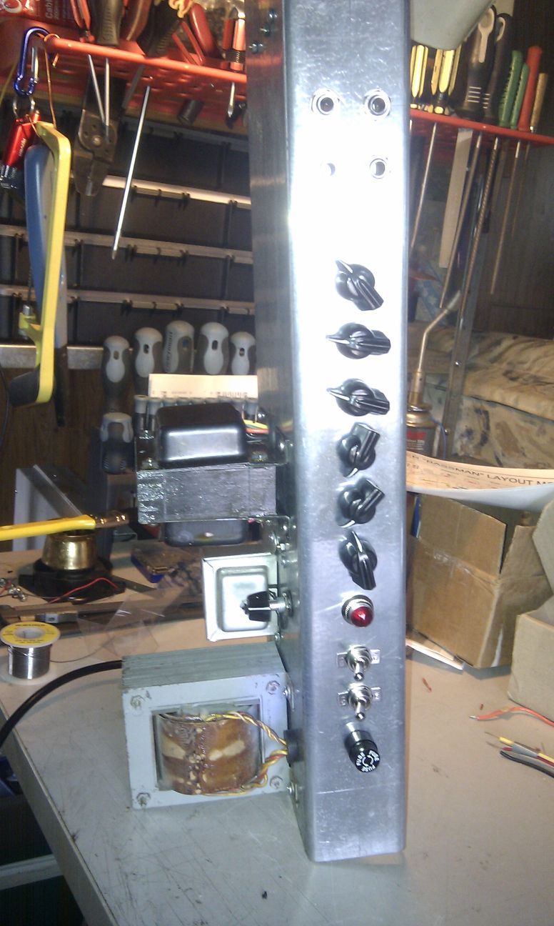

Hi inguz -
Thanks - there is plenty of room in my home made chassis - if no one has guessed, it is a section of galvanised steel building shed purlin (frame). Gauranteed not to rust but a bit hard to cut the holes in ... it will not flex like aluminium, that much I do know as there is a lot of weight in those transformers ...

That's cool. That must make the SG easier to handle. I always found the SG way too head heavy.
most everyone agrees on this topic...
much more balanced feel, with that sound only mahogany can make.
slightly confusing when you look down at it though.
shame it no longer hangs in the hooks.
