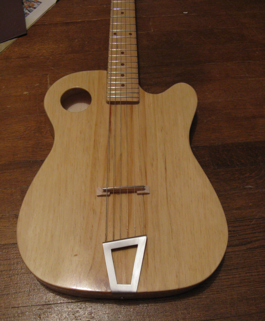

It is almost like I gave up amp building, pretty much did while learning how to make this thing. Far from perfect but good enough for a first try.
Reactions: JMFahey
Well because it was an experiment I did not go all out on it. I glued together some 1" x 2" poplar pieces to make the neck as I did not want to waste any better wood. The body was made out of six pieces of pine and the weather was changing so I glued them all up at the same time and I ended up with a glue line on the back. The neck feels great and I did a real good job on getting it smooth and straight, then screwed up the fret job by using wire that was 0.002" wider than the slot the fret saw cut. I never knew fret wire came in different sizes. Installing them distorted the metal and I had to sand the frets down quite a bit to get them level. I was worried the string tension on the top and left the bracing a little heavier than needed. The finish is not factory perfect.
That being said unless you are really looking hard you would not notice the flaws. The bridge still needs to be experimented with and down the line I might even make one with a piezo in it and was thinking of a floating magnetic pickup at the neck. I have electric strings on it now and it does sound bright, not that there would be thunderous bass from a guitar with this thin a body. It is three inches thick, the reason I did this design is the smaller volume required a smaller sound hole and I thought a small hole in the traditional location would look bad. I want to try it with acoustic strings yet. It sounds fairly guitar like up to the 12th fret but above it does not ring out as much as it should, it seems to get dampened down quicker than it should. Also there is a bit of sympathetic ringing from the other strings that are not being played. I think a regular bridge may have worked better, maybe for the next one.
Oh yeah, maple fretboard, pine body that was routered out, pine top, red oak veneer on the headstock. A few other pictures.
NICE JOB!
Nice attention to wood finishing detail. Nice smooth fretting...mine is not that good (luckily I made my fretboard removable). I see you made the saddle out of what looks like fret wire. Interesting. I wouldn't expect it would have deep tone at just three inches deep, but it probably has good character. Your wood working skills are right up there I would say. Great pics! Thanks for sharing.

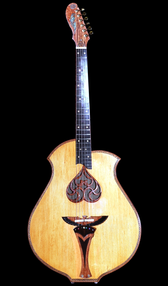

NOT MINE
Hey, Angelo
the Telecaster you refer to is not mine. My instrument is an acoustic prototype. I'm sending a pic so you can see its not the tele (which, is nicely done, and probably just varnished with a clear coat of some kind).
