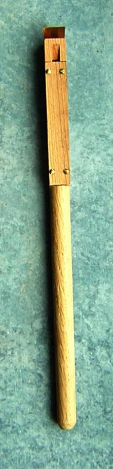

A-natural 4 octaves above middle C, cherry and walnut, copper tuning flap, resonator length 13mm, two inches of wind, open toed voicing. (DIY after Compenius)

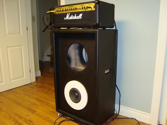

Here is my DIY Oversized 2x12 cabinet. 3/4" fur, all dado construction, polyurethane glue, closed bottom, open top, finished in box-liner spray. Testing with a little Altec Lansing subwoofer for a speaker. The holes are recessed for Celestions.

TechnoBeaver - that's a nice looking cab, and I really wish I had an amp like that one. How does the little sub sound? The photo of the guitar isn't showing too well - perhaps you have a better one? Still, from what I can make out, it looks pretty good.

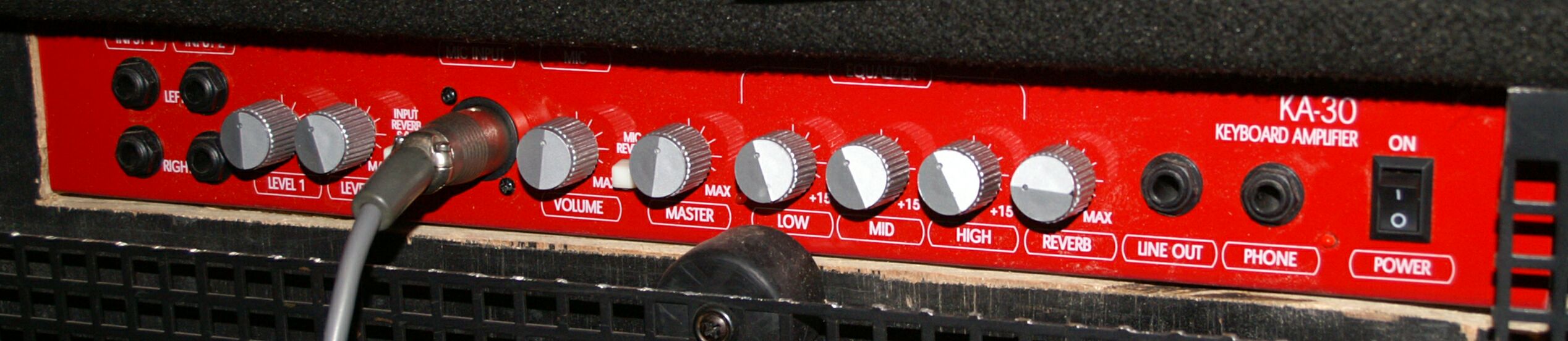

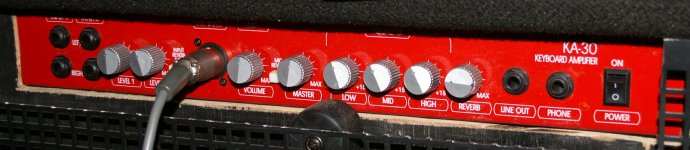

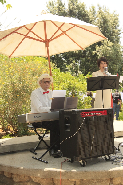

Here is me with my silly electronic piano and a home made amplifier for it. More pics to follow. My singer, Gigi is there too, prettier than I am for sure.

Chris, the box and woofer were one, called a bass speaker. I installed a tweeter from a keyboard amplifier, and the amplifier is 30 Watts, from the same keyboard amplifier.
Later I took the remains of that keyboard amplifier, installed an old Lafayette home stereo amplifier, modified with op amps to give me gain and inversion, and now have a great little 25 Watt guitar amplifier with the speaker bridged between the two 8 Watt channels.
Brilliant example of people using what they have to make something better. I admire that.

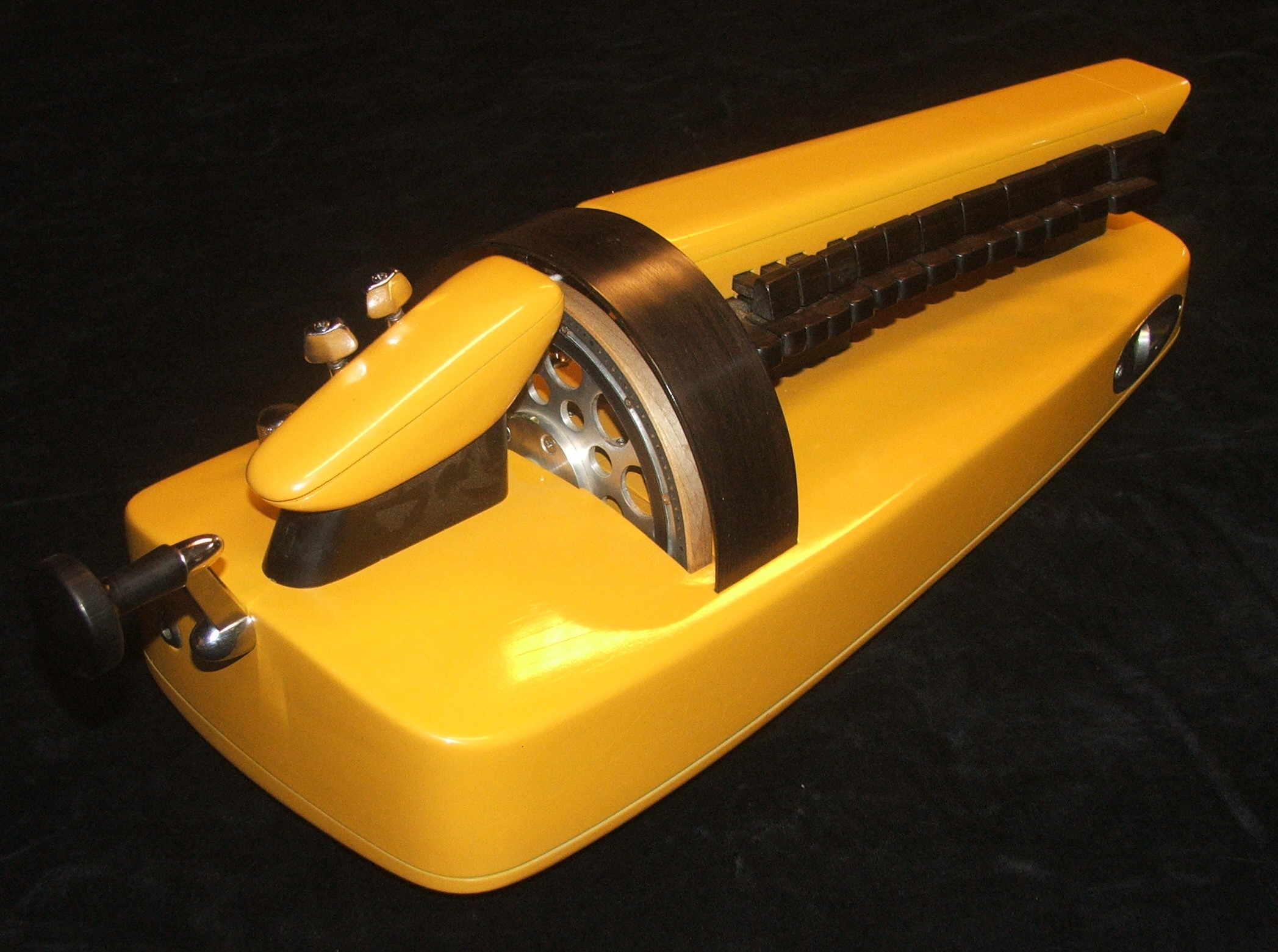

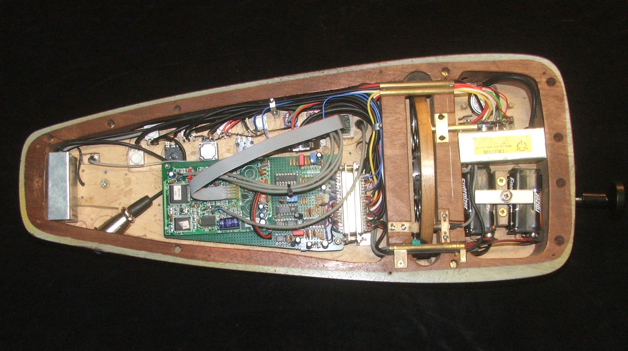

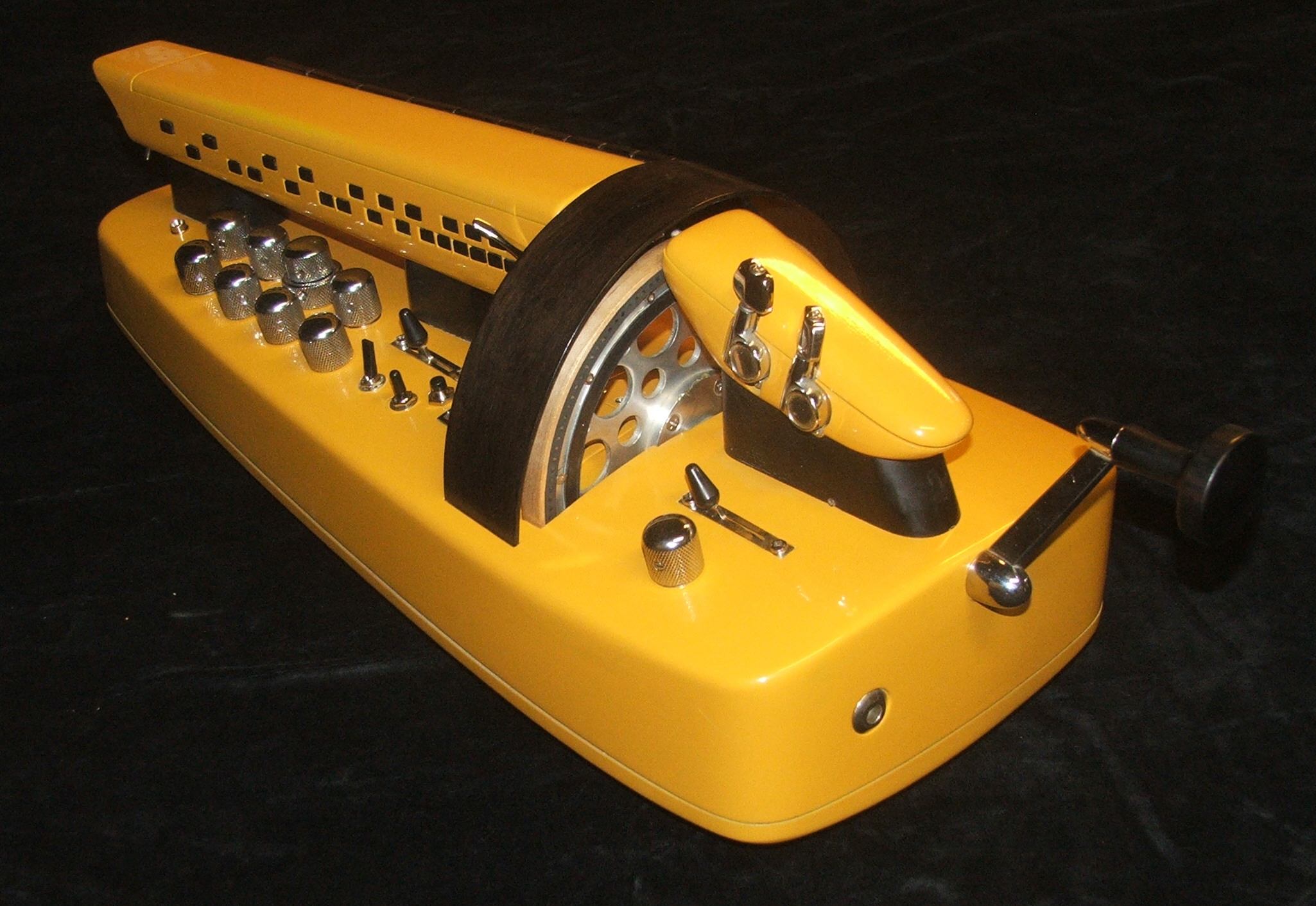

I have just finished building an electric vielle. The keyboard uses strings and a humbucker pick-up like an electric guitar but the rhythm is generated from an IR laser system that monitors the wheel speed. The drones come from a synthesizer module inside the instrument's body with the other electronics. All the sounds and effects can be regulated and mixed before output to a power amp. It works fine but I really need an ADSR envelope module to shape the rhythm pulses. Does anyone have knowledge of a simple circuit that works off a 9V supply that would do the trick? All I can find are schematics for synthesizers and they use +/- 18V which is OK if you have access to a transformer. My vielle is portable and uses batteries; consumation has to be at a minimum.
Thanks for any help.
