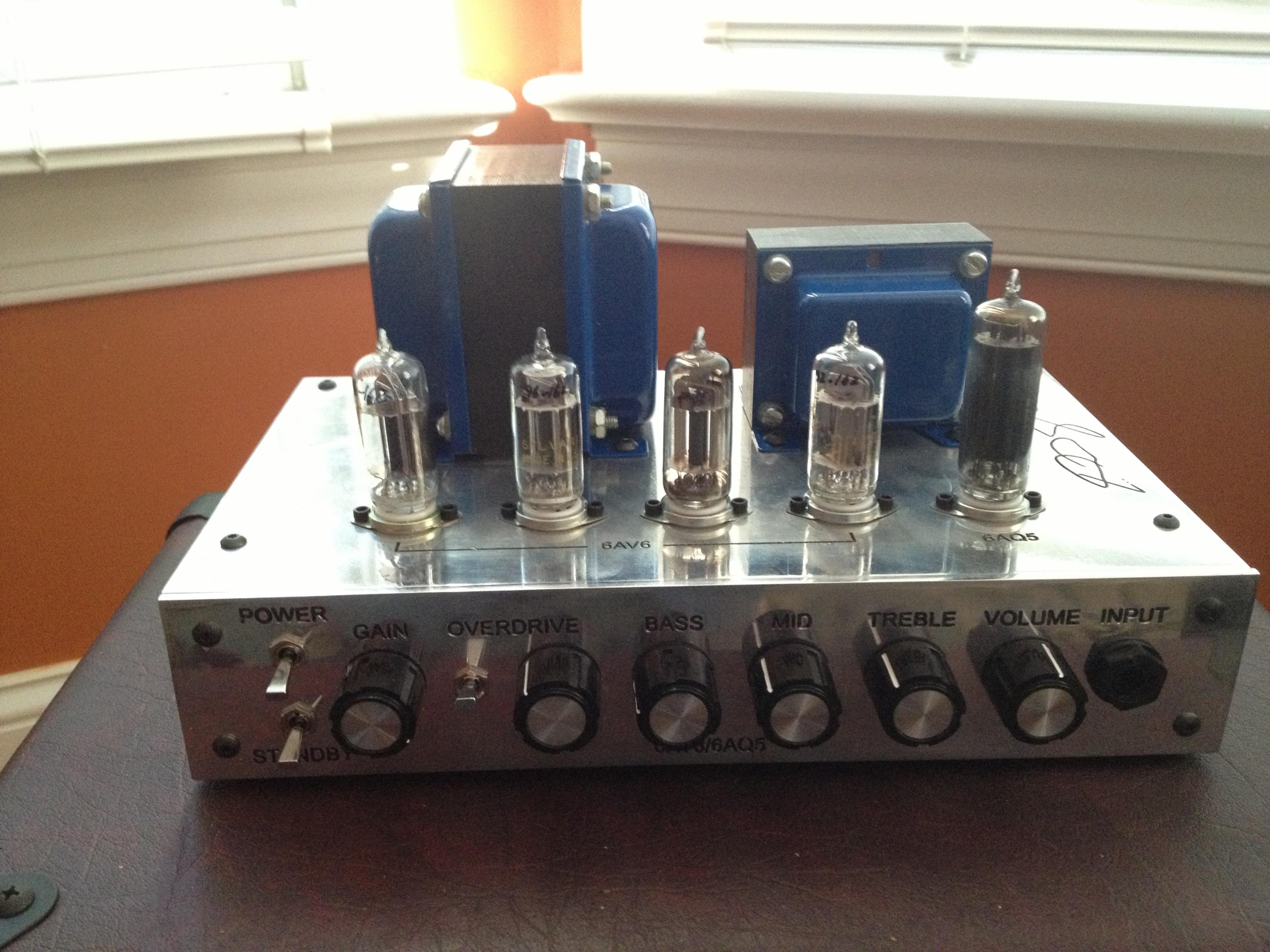

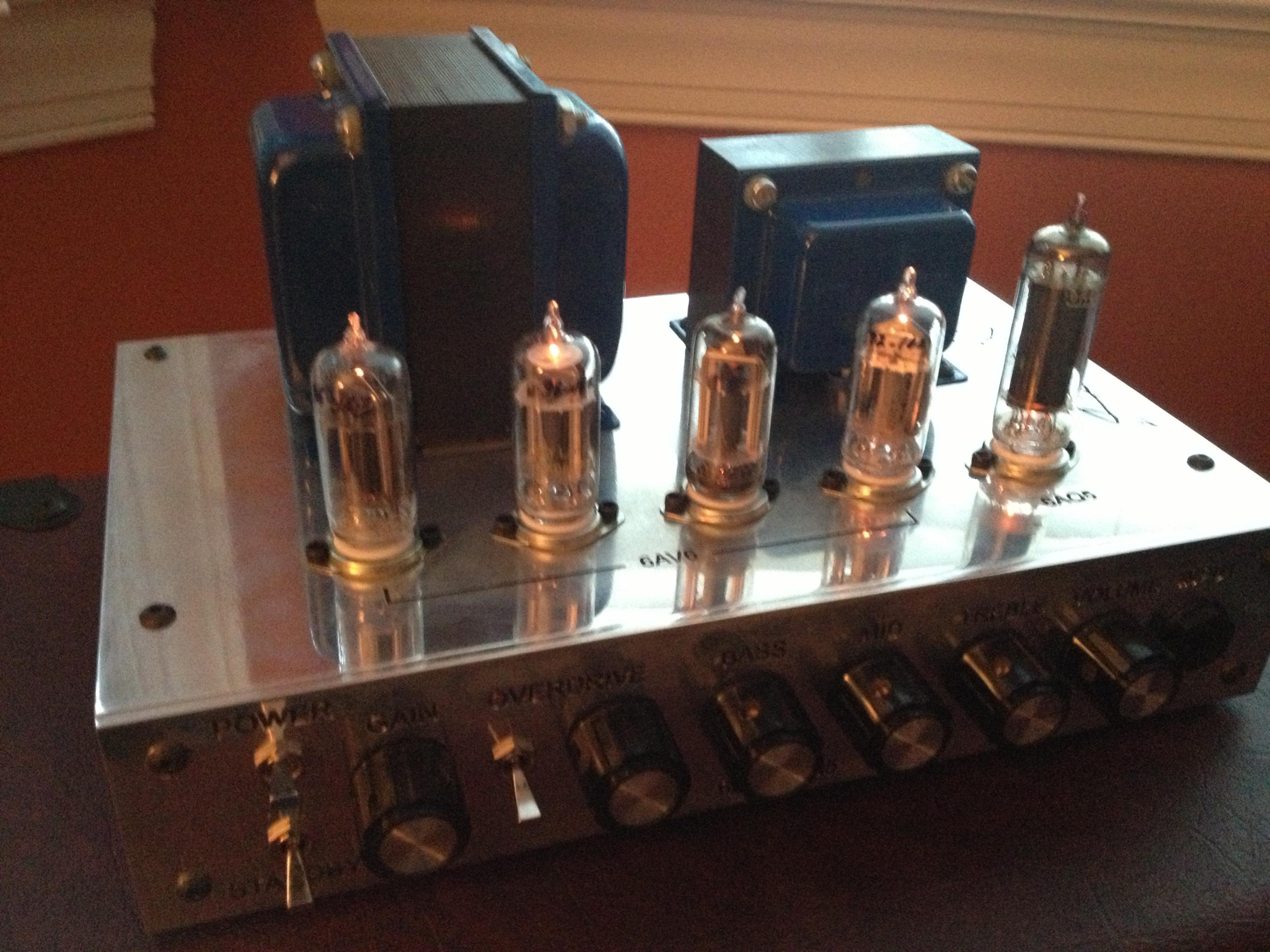

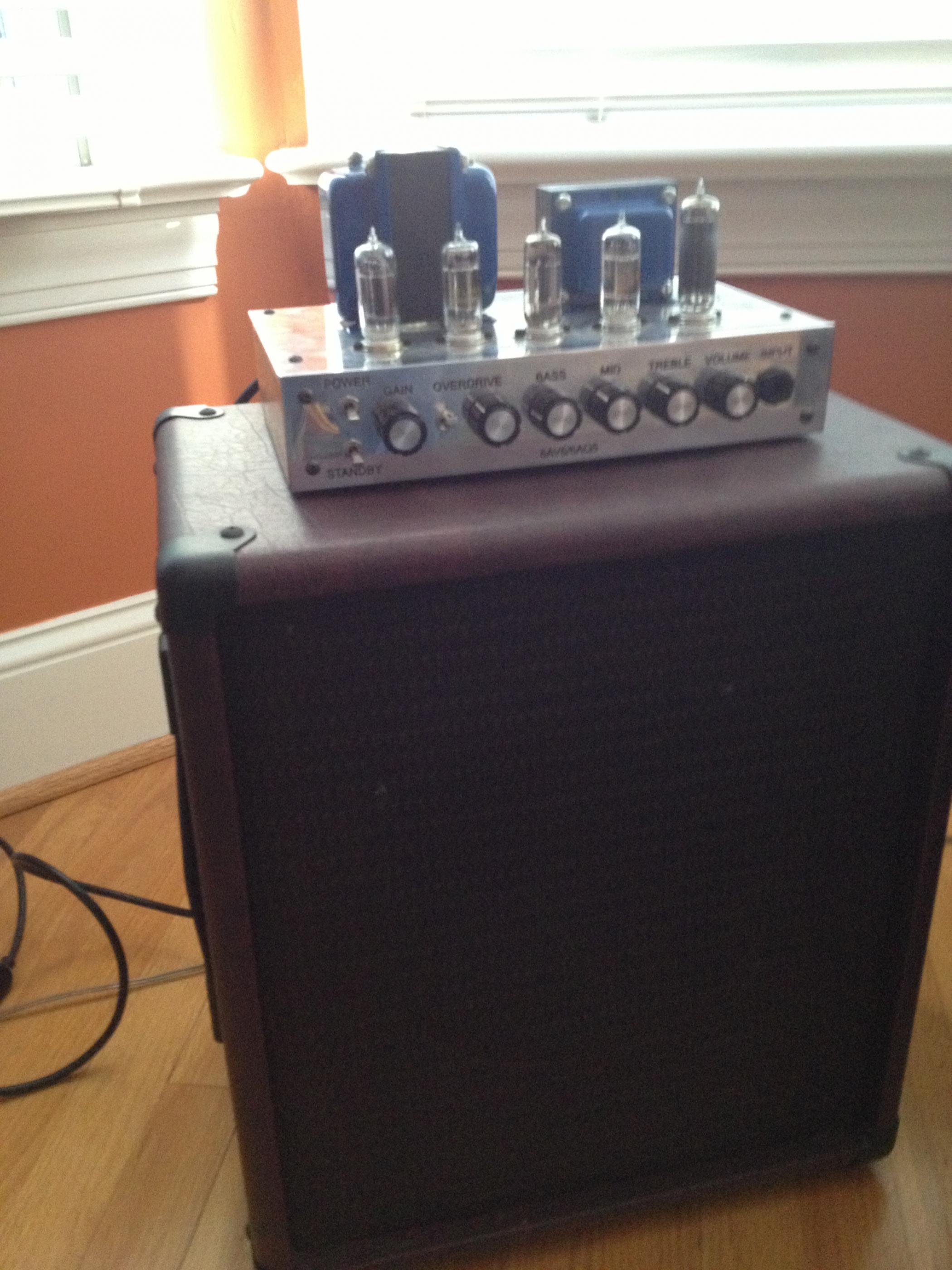

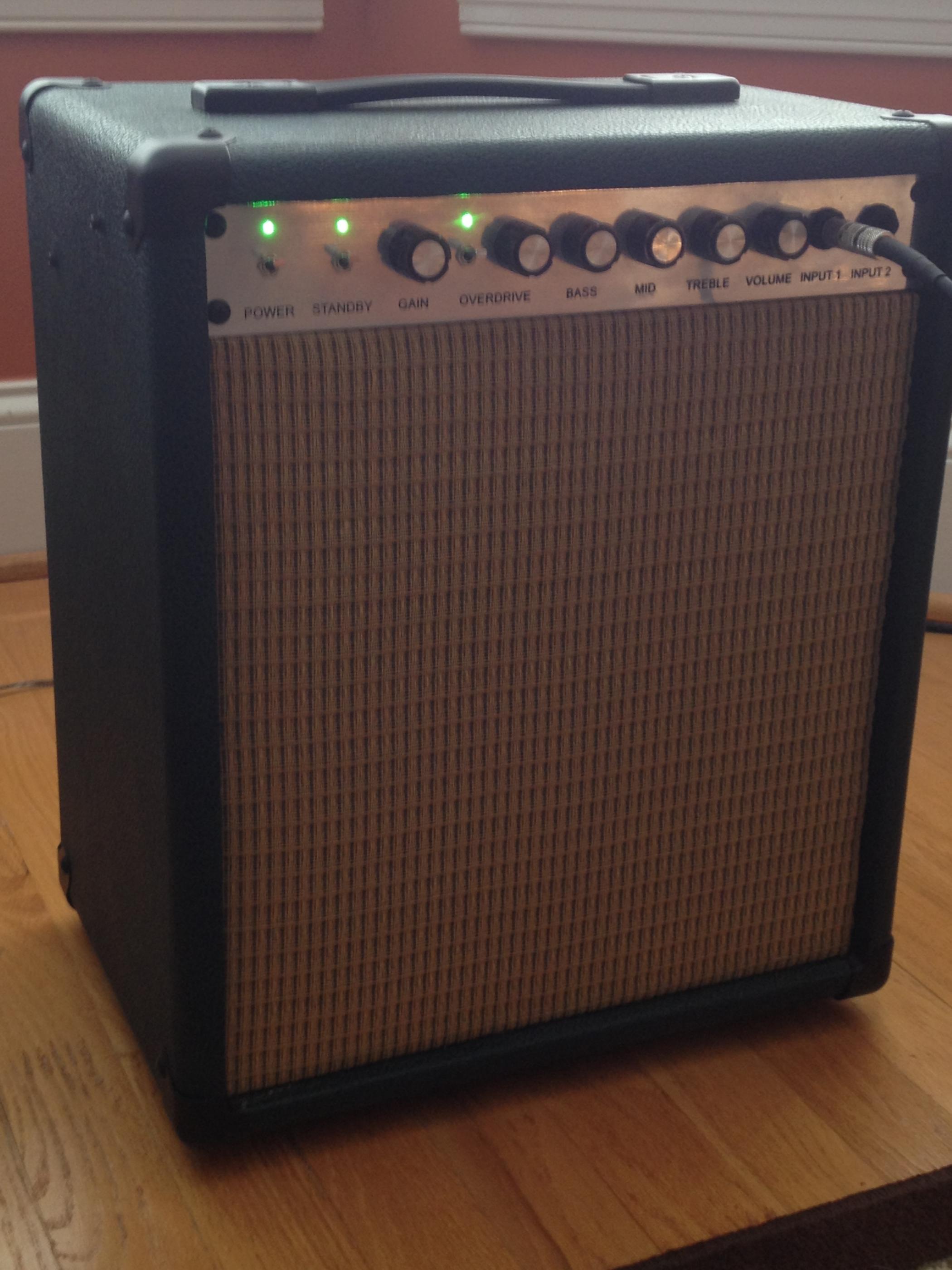

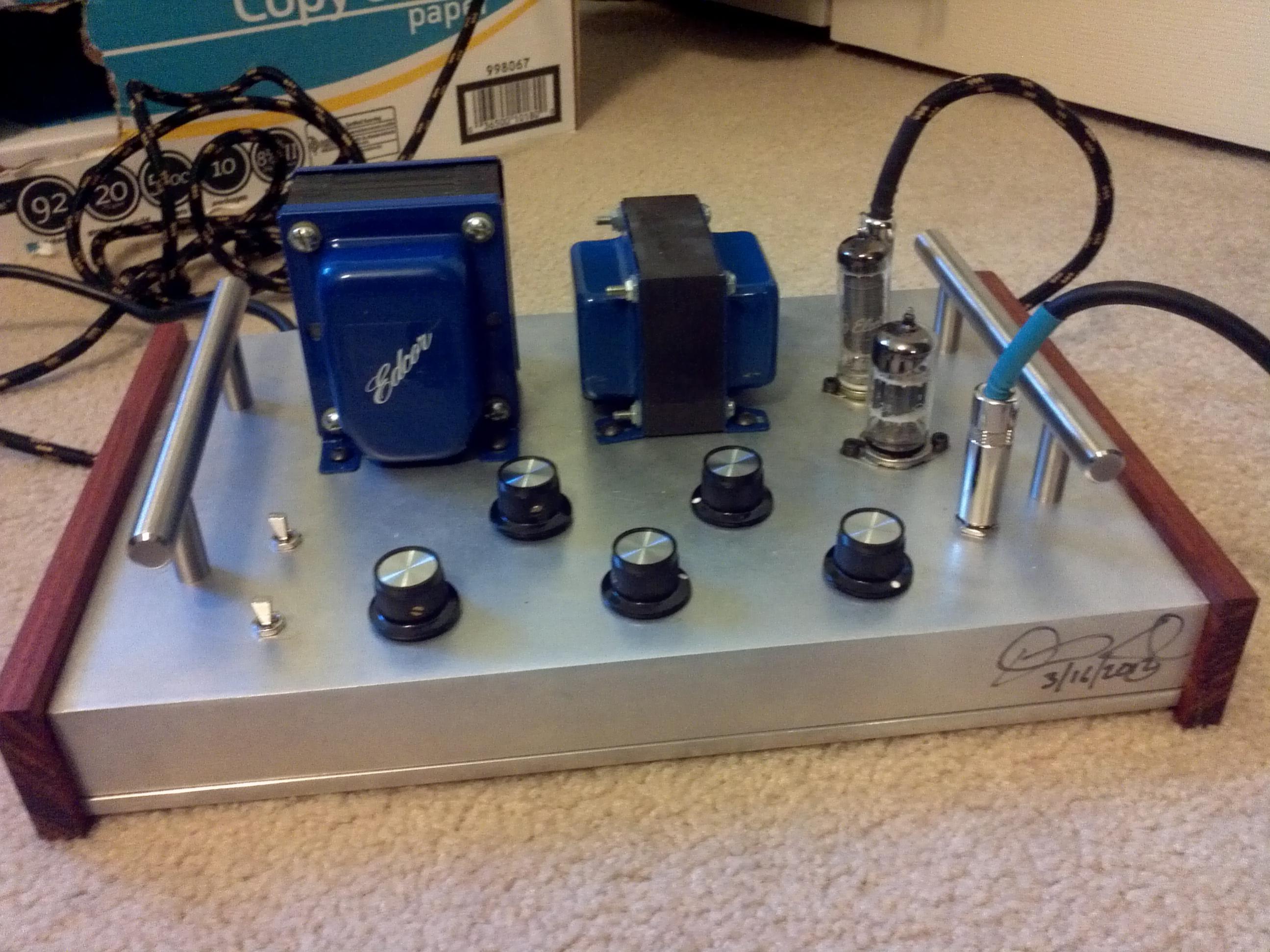

here's a junkbox guitar amp I built for my nephew a while back. two stages of 12ax7 and 6aq5 SE power stage. controls are gain, tone stack, and volume.

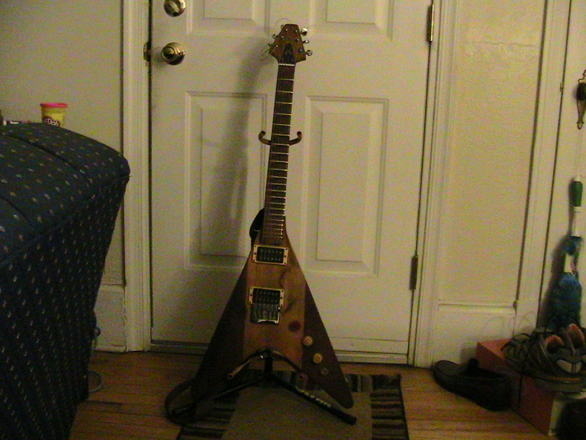

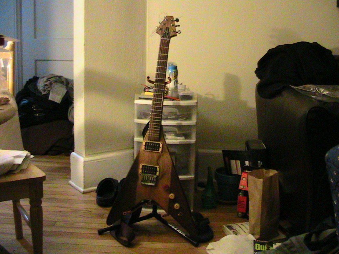

Did not have a picture of the back so I took these today, spring is here and have to make the most of the snow (no hard feelings when it is gone). A little too much glare off the snow on the body. The bridge is actually a little darker than the fretboard. Wish I would have used gloss not satin. Next one.
And the front for the heck of it.

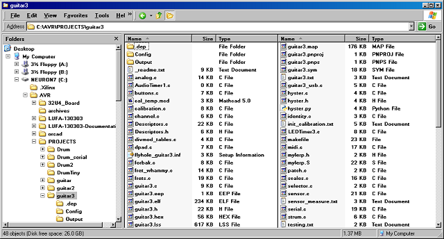

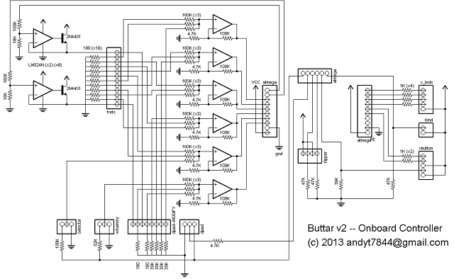

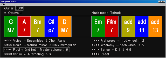

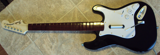

A DIY Midi Controller
Harmonix Rockband II game controller with new electronics and software.
It's not a guitar -- it's a bunch of buttons shaped like a guitar.
We call it the Buttar.
10 pressure sensitive frets.
Bidirectional flipper for strum and arpeggio.
Whammy bar in continuous or interval mode.
5 way selector switch effects the notes and chords.
Elaborate on-board chord and scale software.
USB interfaced and powered -- lowish latency.
Optional Windows PC control screen.
Works well with Reason + VSTSynthFont(w/FluidR3) + Amplitube + ASIO4ALL
