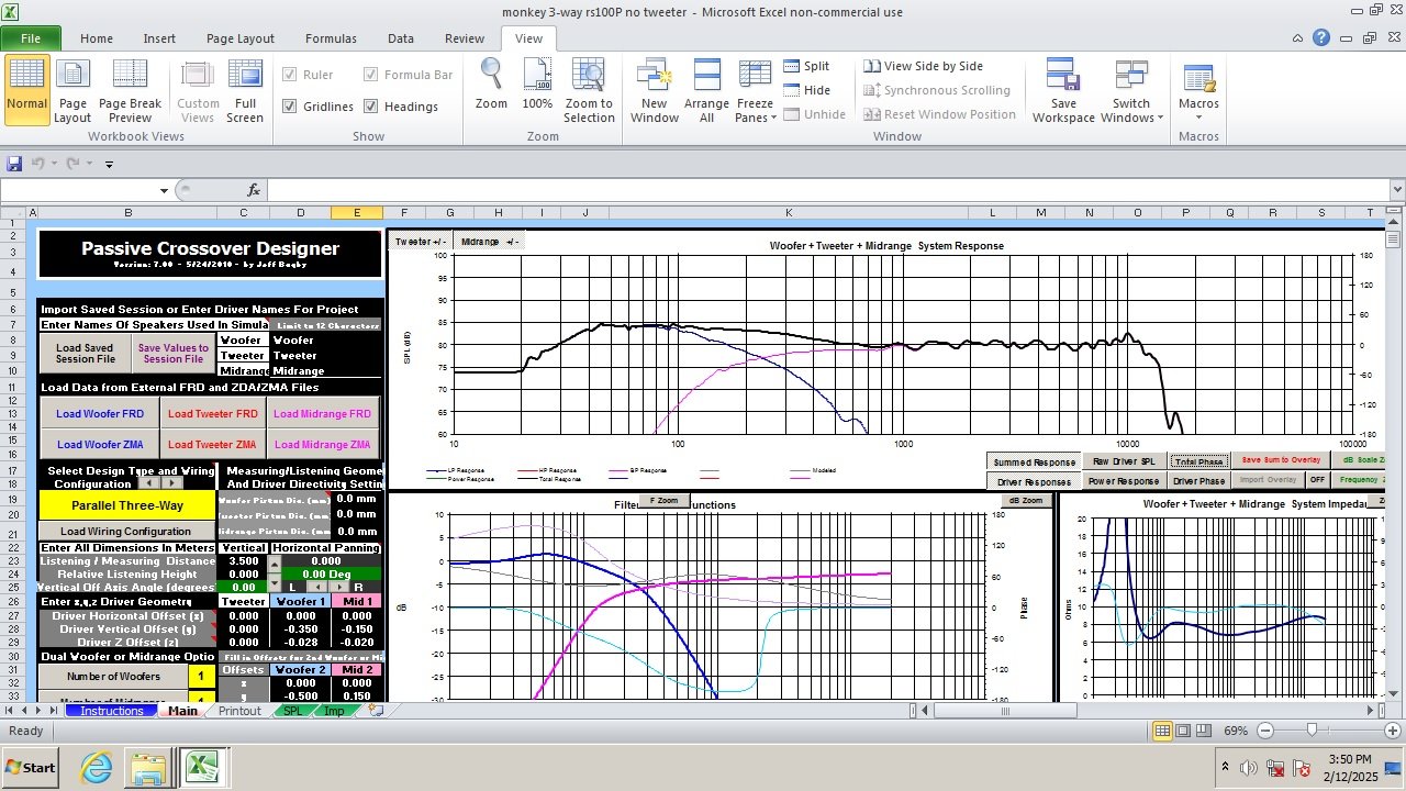

How much abuse would these speakers likely receive? I made a sim using an RS100p crossed at 250hz. I don't think excursion is an issue, but heat could be. As far as the sim, the woofer could cross much higher, but it's sold as a sub, so I don't know how it would sound crossed much higher. Obviously a tweeter could be added. I just wanted to see how high the response could go without one.
