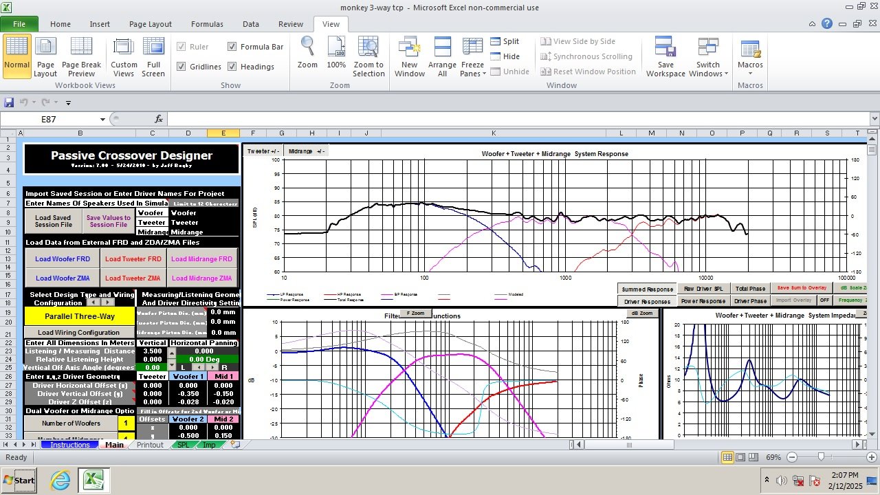

I came up with this this morning.
RSS265HF woofer, and Dayton mid, and tweeter. $500 in drivers, if I added it up right. Low sensitivity, but good extension sealed.. This is not an exact sim, but I needed a ballpark idea of how well the woofer might work. I won't go into details here. I might start a new thread. I did convince myself that a budget version was doable.
