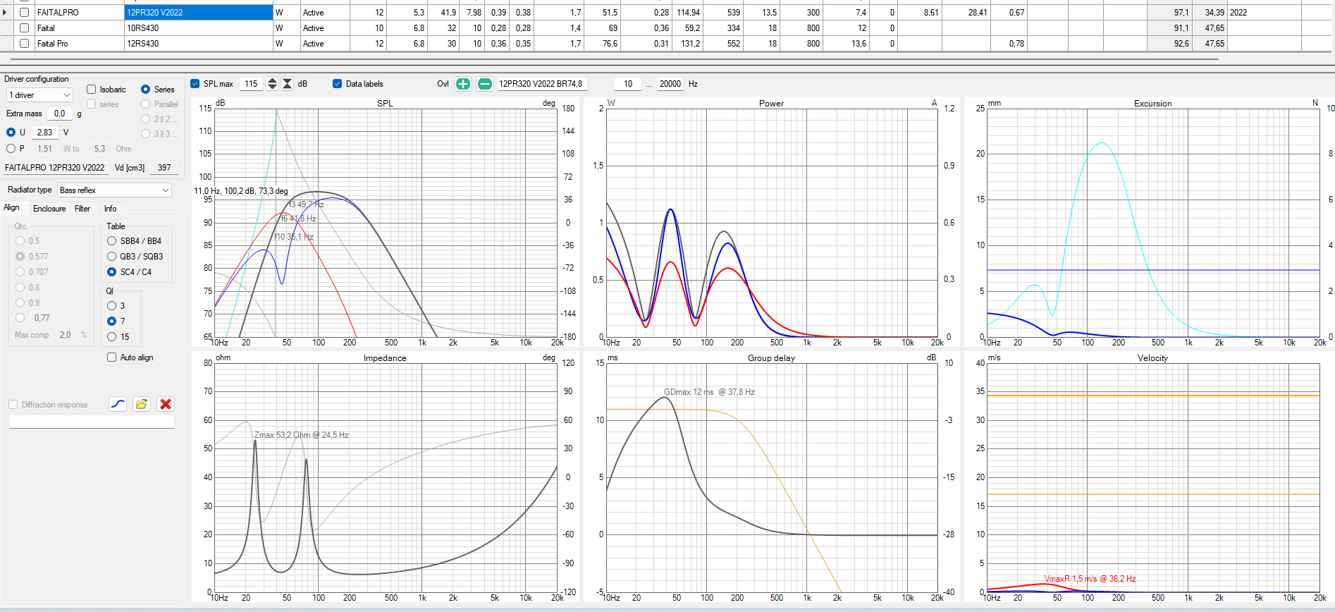

the spec of the data librairy of Vituixcad are not good, I rised the Vas to the new datasheet and remade a model for that driver. Of course it is indeed about the Q & loss. Here my sim. F3 is 50 hz with a 12 dB low pass at 200 Hz with Q 0.7. QA is setuped at 80 . Volume is 75 L netto. So 80L surely after the 2 L of the driver plus the rest : bracing, filter. Add the mid enclosure, volume is climbing... I stopped there after the sim.
F6 : 47 Hz. . The Xmax at 40 hz is 97 dB peak... But look at the average spl level at 2.83V ! It is more than 97 dB. We all know from real design : OSMC, T Gravsen, Humble home hifi (who tune quite low, I don't want to look at the group delay here) the efficienty is more between 91 to 93 dB according the load and designer measurements. Xmax peak is surely lower in real.... Definitly a midwoof. Or excelent PA midrange. Of course maybe good enough at average spl... But I find a little sad to have a so huge cabinet for that results.
10 FE and 12FE have not good low end if the low end target is F3 < 45 hz. (vented)

Maybe, I don't see your change making much difference, you said 58Hz before which did not make sense.the spec of the data librairy of Vituixcad are not good, I rised the Vas to the new datasheet. Of course it is indeed about the Q & loss. Here my sim. F3 is 50 hz with a 12 dB low pass at 200 Hz with Q 0.7. QA is setuped at 80 . Volume is 75 L netto. So 80L surely after the 2 L of the driver plus the rest : bracing, filter. Add the mid enclosure, volume is climbing... I stopped there after the sim.
You can tweak numbers in these sort of sims all day long and change the values completely. It does not tell you much unless you know by actual experience why you are aimimg for a specific response. I see a lot of people trying to force a flat line to the lowest frequency as if that is some kind of improvement because it goes lower for longer. Unless the speaker is going to be quite far away from boundaries this will result in boomy or bloated bass and dissappointent.
T/S parameters change considerably with temperature, take a look at the measurement debacle at ASR of the little Neumann speaker for an example.
My advice is to try the driver you already have in a box with a few different vent configurations in a room, then you will know what works for you. Then plug the ports to seal it and use EQ to change the rolloff behaviour and listen to the difference.10 FE and 12FE have not good low end if the low end target is F3 < 45 hz. (vented)
You might like something that rolls off higher and goes lower or not but at least you will know instead of guessing.
58 Hz was the F3 of the OSMC iirc or something close. It can sim like that according the vent slope and Q one choose. In my book if I tune like I prefer, i.e. few hz after the real driver Fs which is not 42 Hz anyway (more 47 Hz in real). And in reality Q is often < than 7, no ? More towards the 3 ?

Edit: Where did you get the Fs for 12pr320 to fall at 47Hz ?. In my book if I tune like I prefer, i.e. few hz after the real driver Fs which is not 42 Hz anyway (more 47 Hz in real)...
@mbrennwa measured his 12pr320 extensively and came to the conclusion that FaitalPro datasheet was spot on.
Not exactly if you read it well, they never fall on 42 Hz, always between 45 & 47 hz with the fellow from USA and his calculating tools. The numbers of Mbrewna didn't work in the box calculation tool which is know to be quite good. The only way for the numbers to match was to sim with a bigger Fs for the datas being exacts. Note it is not an exception to Faital, Many Scan Speak have often more Fs, many brands...
The sensivity is not exact too but if you accept there is 6 dB of baffle step loss at 100 hz. So not 97 dB where it maters for a bass or woofer, it is more in the midrange.

I don't know what you're talking about. The Faital datasheet is spot on and consistent with my measurements:The numbers of Mbrewna didn't work in the box calculation tool which is know to be quite good.
Sorry, took me a while to catch up. I wanted to understand what's going on with the Thiele Small parameters of the Faital driver and get things right, so I determined the Mms (cone mass incl. air load) using the "added mass" method. The results were 50.8 g (driver A) and 48.7 g (driver B), nicely consistent with the datasheet value of 51.4 g. This means the slightly high resonance frequencies I found earlier corresponded to a lower Cms value of about 0.23 mm/N instead of 0.28 mm/N in the datasheet. Was the break-in not enough to loosen all the mechanical parts? Ok, more break-in, and...
Fs at 42 hz?, Prove it ! How much do you add to the cone, in what temperature environment you did it 😉 All is written in the thread I don't invent.
Well 3 to 5 hz, not a war to beginn about, but for a bass driver it beginns to be important... There is no doubt nowadays for hifi and not triode SET lovers, the 12RS430 is a far better choice.
