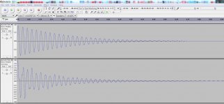

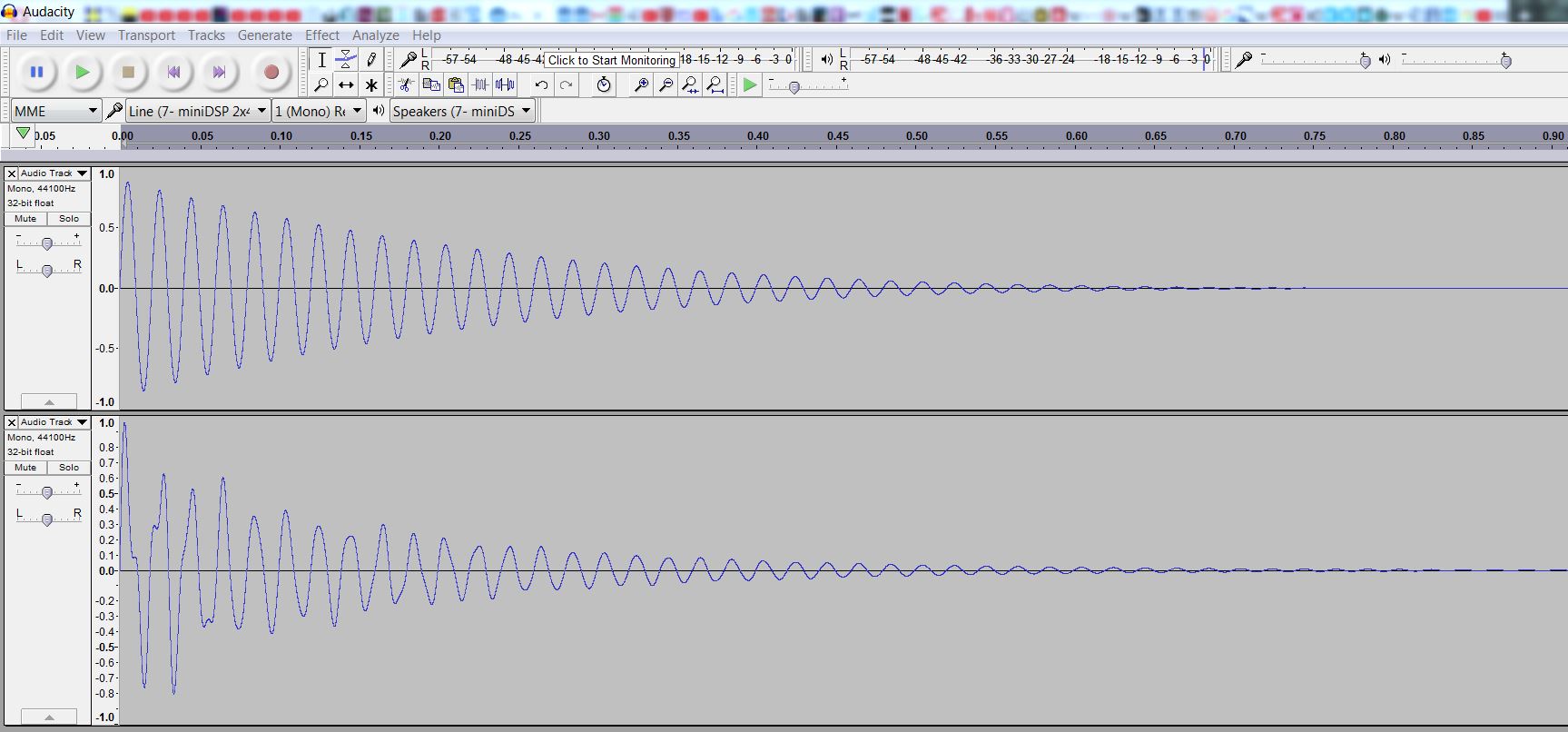

I was testing these two different tracks with different LP-filtering.
One is a 50 hertz decaying sinewave, the other is a Risset drum with a 50 Hz centered fundamental and a sharp steep transient start.
With a 60 Hz 48 dB/octave LP filtering I had a difficult time differentiating the two different tracks from each other.
But with a 80 Hz 48 dB/octave LP filtering the difference was quite easy to hear.
I did not use any top system. This was only my HROAR with a 10 inch car audio driver.
I must still maintain that a non-sinusoidal capable but low pass filtered bass box does reproduce the very important part of a transient - the physical and most tactile steep pressure wave. A BR box is not very good at reproducing a non-sinusoidal waveform within the passband (-10 dB) of the port, since the port contribution is very smoothened into something much more similar to a sine wave instead of a steep transient pressure wave.
You can hear the difference between these two tracks through a BR because the direct radiation from the driver, but the BR will not recreate the low frequency pressure of the transient. It will sound dull and lack the punch and tactile attack of a bass horn or other high order QW tuning.
When adding my Dayton Audio PS95-8 as a nice top-system, my HROAR still sounds much more physical punchy and tactile within its passband then a comparable BR.
Why is there no ramp up in case of Risset drum sample? It should have.
Isnt it true that all musicals instruments have 'attack', 'sustain' and 'delay'?
Yes, there would be build up time. Question is how much is this build up time as compared to the music it is reproducing, coz even the music has build up time?but also due to the resonance build up time, there should also be an amplitude ramp-up time
The steep initial transient created from the drumstick hitting the drum skin and displacing lots of air is only a few ms long as seen in the screenshot of Audacity.

Take a tweeter, put an electric low-pass on it, see how the transients become chewy like rubber 😉
The port will start instantaneously because there is no digital delay buffer.
All real world elements behave causal and excess-phase can only occur via (relevant) distance. Inertia is related to minphase.
Please stop making up "bouncing theories"
cheers
