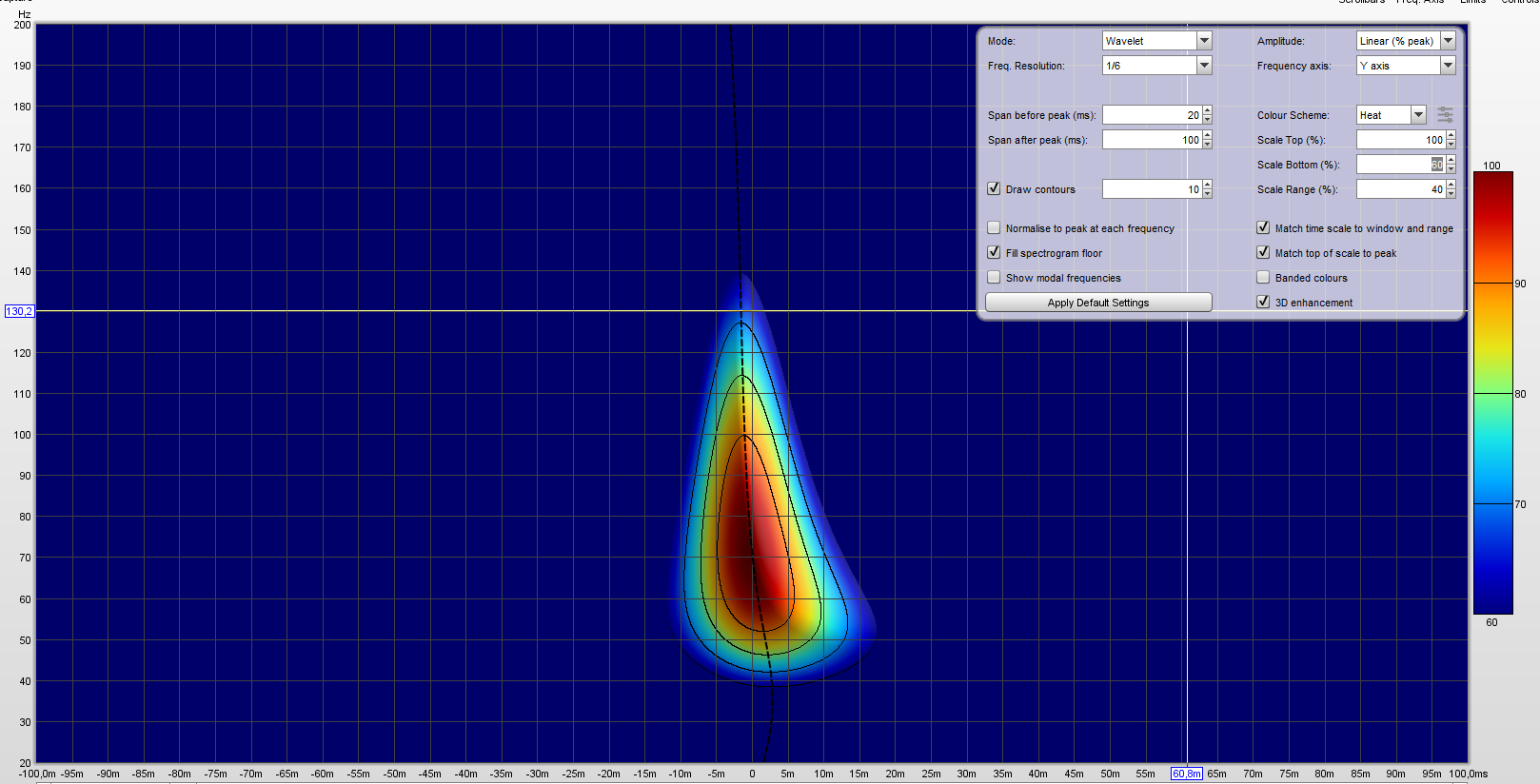

I'll export some hornresp impulse (neither closed or BR) to play this way too with REW.
Thanks for sharing this way of analysing, it is exactly what lacked in our exchange, and thanks for sharing REW wavelet parameters screen too.

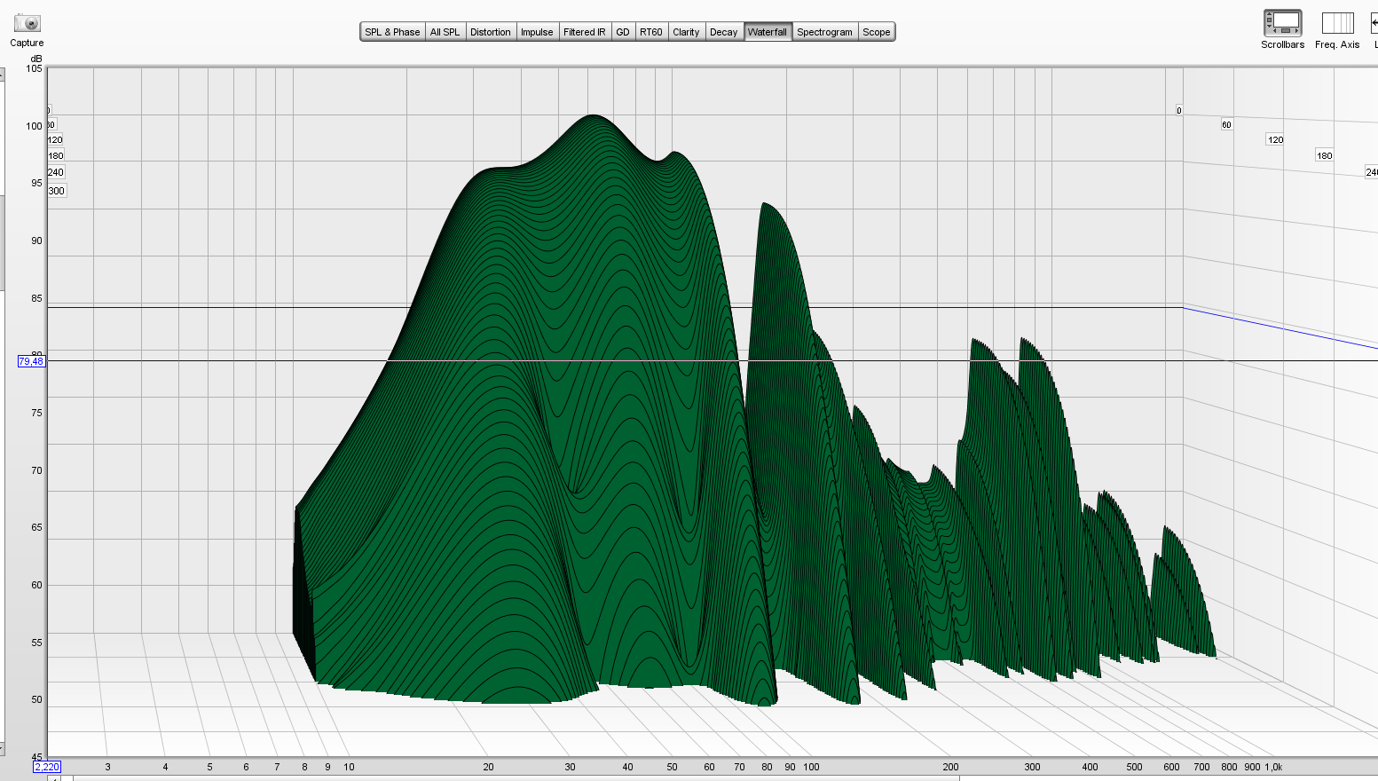

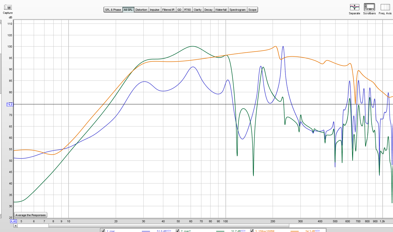

Just to add. Hornresp allow to simulate "perfect speaker" as constant velocity, to show only effect of enclosure. It's fun, i just start. But the more fun is to so feed this into REW !Hi, how does that work exactly? What all-pass filter (freq, and order) would you use in this example? thx

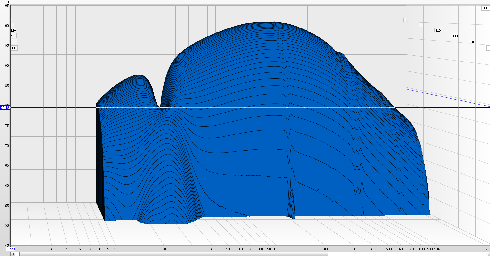

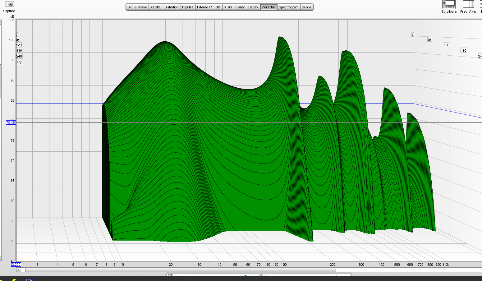

Just to play...In figure 1 : ROAR in green as it is simed. In purple, speaker as constant velocity to show drivers damping.

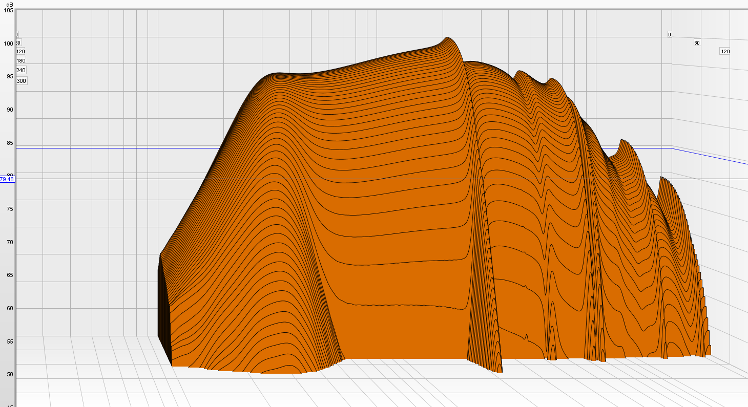

Figure 2: Roar waterfall

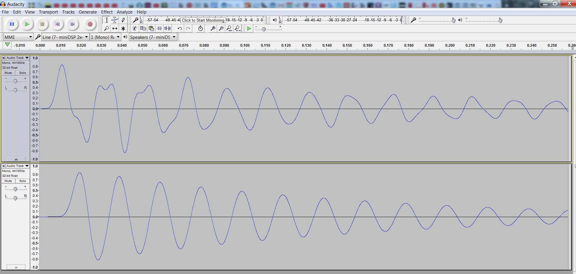

Figure 3 : a 15tbx100 Bass-reflex (port+driver)

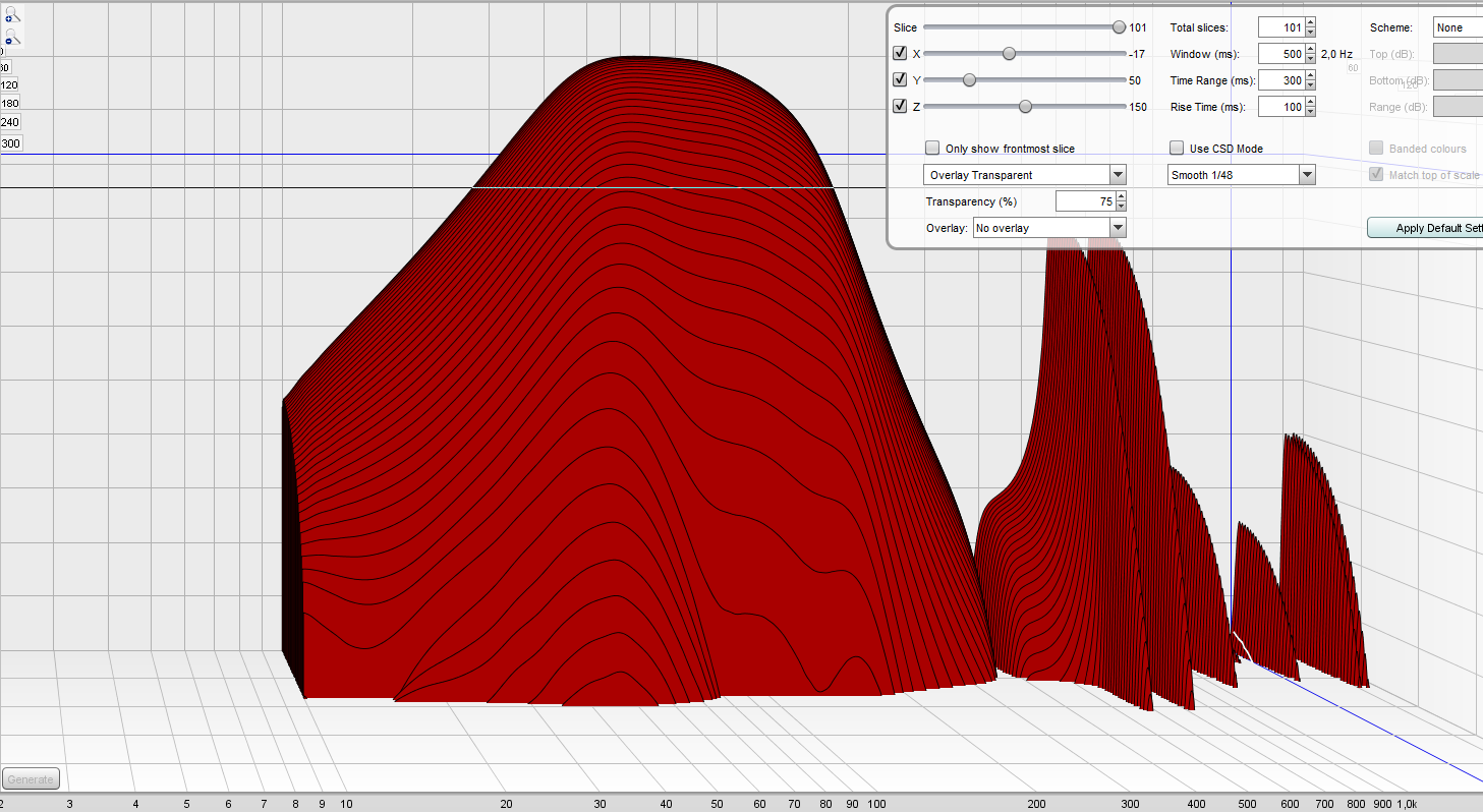

Figure 4 : port only
Figure 5 : direct radiator only
Look at figure 4/5 around 30hz. This is what we are talking when way talk about out of phase. No matter if it's out of phase if there's such a difference in level. Look then at the resultant in figure 3. Not that much a big deal. At least, not worst than Roar.
Of course, it all need filters/Eq... that was just a enthousiat pretext tp inject hornresp impulse in REW .
