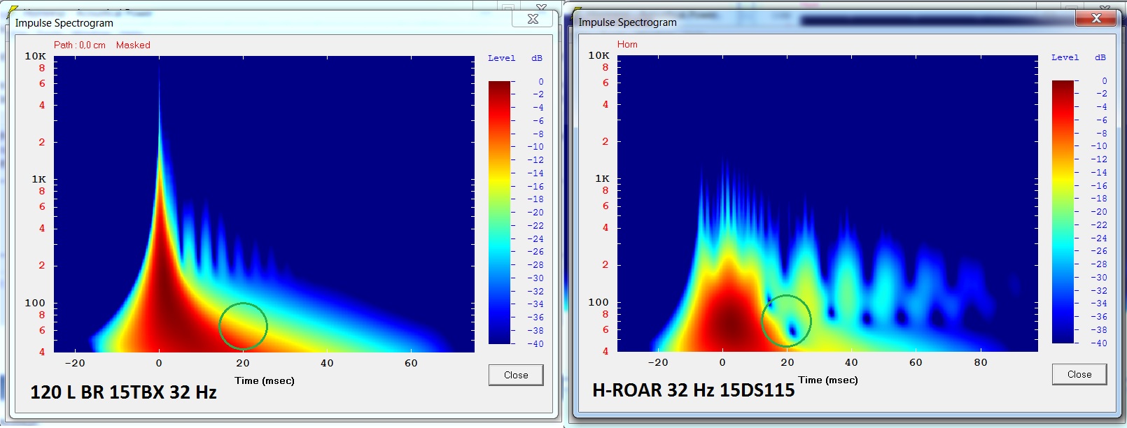

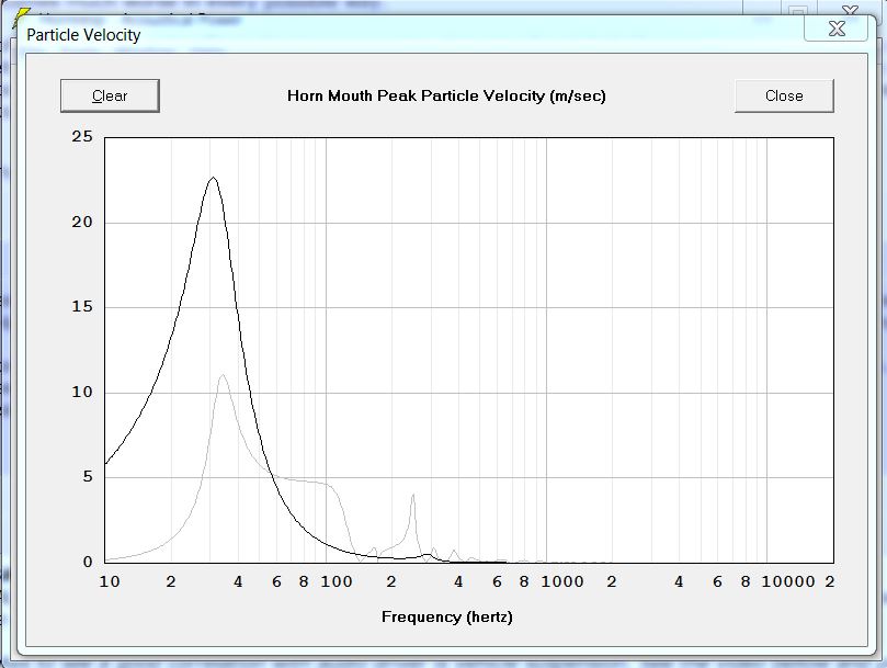

I compare a B&C 15TBX100 in a 120 liter BR with a 300 cm2 cross section area port 50 cm long. B&C recommends a 114 liter BR box tuned to 35 Hz for the 15TBX100 so its seems like a reasonable BR to me.
The 15TBX100 is to weak for the HROAR, and thats why I use the 15DS115 for my HROAR.

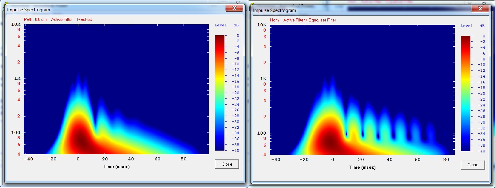

By EQuing the same, you just provided the same damping factors. In the case of Roar, it is segment that provide acoustic resistance, whereas for bass reflex, it is more electrical damping.View attachment 755614
None of this shows the wave form reproduced when the driver is fed a bandwidth limited transient or other nonlinear non-sinuoidal signal...
You prefer probably instinctivly acoustic damping than electrical, but yet amplifiers are full of electrical damping which you yet trust in inside your amplifiers.

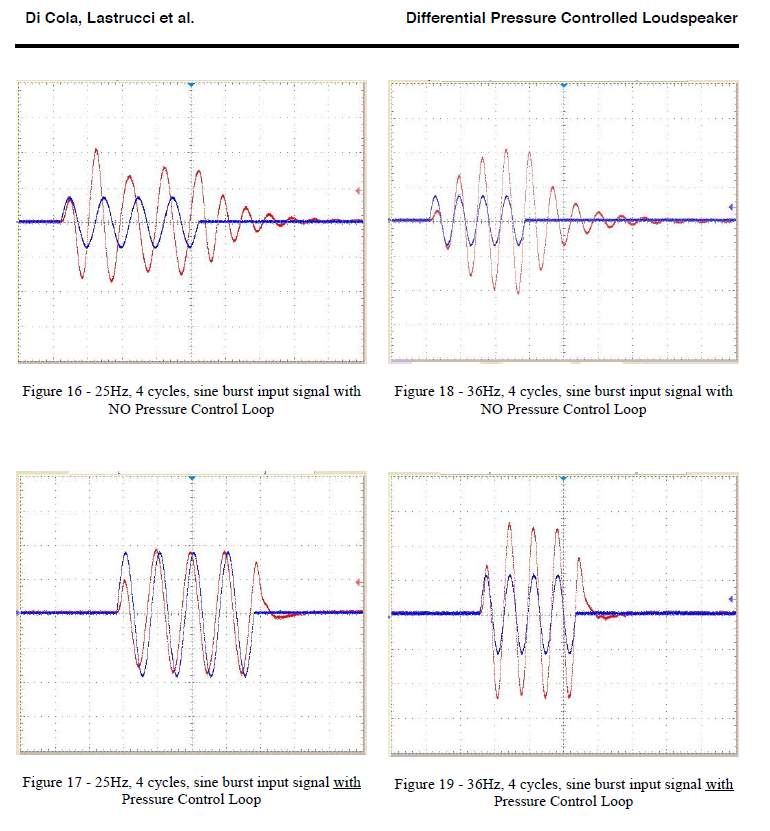

None of them (acoustic/electrical damping) provide instantaneous stop without motional feedback. But it is still a good start to give curves with good damping factor. I showed that unEQed, Roar is a pretty bad damped design.
See Ipal pressure sensor patent for figures examples.

UnEQed the BR fared worse then the HROAR with lots of low frequency rumble up to about 36 ms whereas the HROAR was basically silent except some 100 - 200 hz echoes at -20 to -24 dB after 20 ms.
See my unEQed sims a few post back.
And then it is this:
Both at 125 dB output. And the BR has a generous 300 cm2 port area.

Did you see this response ?...delay...BR is overall "printed/centered" spectrogram with more time delay by hornresp. It's overall more on the right.
The red 0db energy is centered on the right of the 0ms mark for the bass reflex, but to the left for roar. It's just a 5ms artifact delay... look closer.

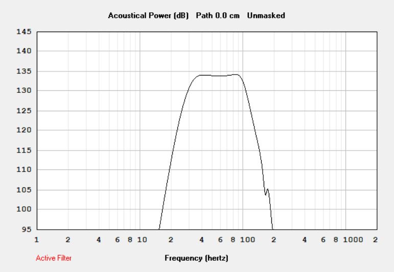

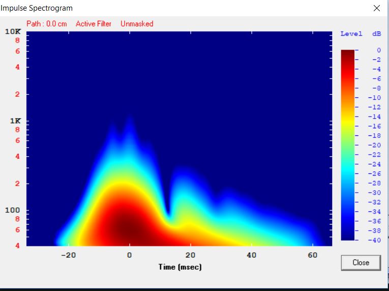

Hey guys, don't mean to crash into this thread inappropriately.
But I have insufficient experience with hornresp to know how to fairly interpret its spectrograms.
So I've attached a hornresp spectro from the BR sub I posted about in post #22 this thread. (the sub is actually a dual 18" slot loaded BR)
So hopefully, since it's essentially a BR, it fits this thread well.
What is the secondary peak at 20ms? thx!
(Filters are BW3 @ 24hp, and BW8 @100 LP)

Nulling, not spike. Make eq so curve shape is round and no more that flat it will disappear, "damping" curve corners. And that fast slopes explain curves low on right side, it is group delay.
Aah, I see, thank you !
Not used to dealing with minimum-phase crossovers...it's nice not to have to fool with that..
The control system from IPAL is really nice and to align with shared picture I'd like to reinforce, active system with closed loop is the best way to improve/change system dynamic for almost any type of system.

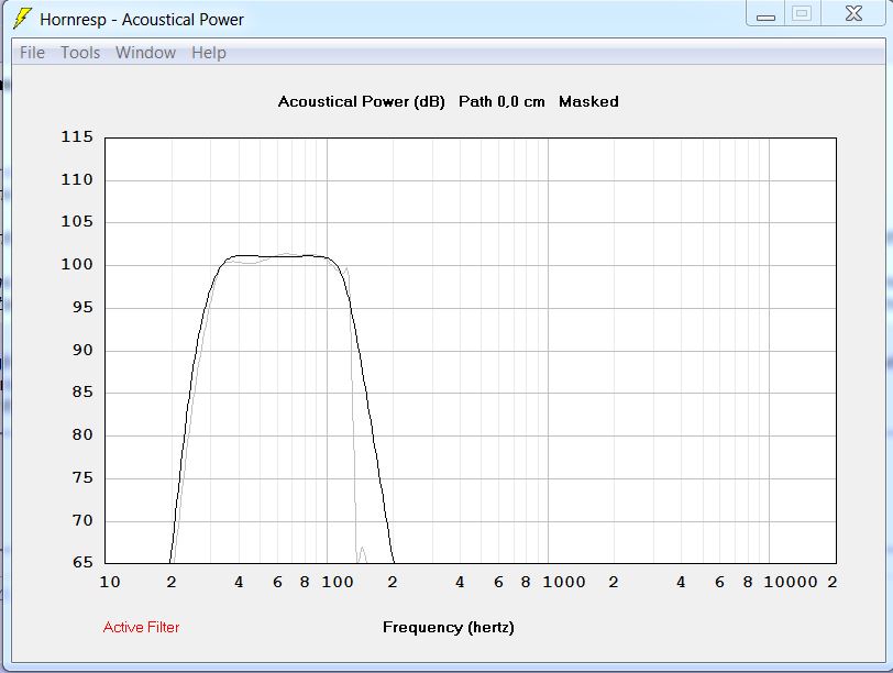

Without EQ or crossover the HROAR comes out on top, while they become quite equal with heavy electronic EQ and bandpass limiting.
All this is at low level where nonlinear acoustic effects is a non-issue.
Already att 100 watts the BR becomes much worse in every possible way.
A BR has all the disadvantages of nonlinear acoustic effects (port compression, detuning the Helmholtz resonance, creating lots of out of band noise, uneven port turbulence skewing the working point of the driver etc etc...) while a ROAR or horn will benefit to some extent from the nonlinear acoustic effects. With a careful design it will counteract the thermal compression of the driver. The port compression of a BR will only reinforce and exaggerate the thermal compression of the driver in detuning the Helmholtz and compressing the sound output, diminishing the dynamics.

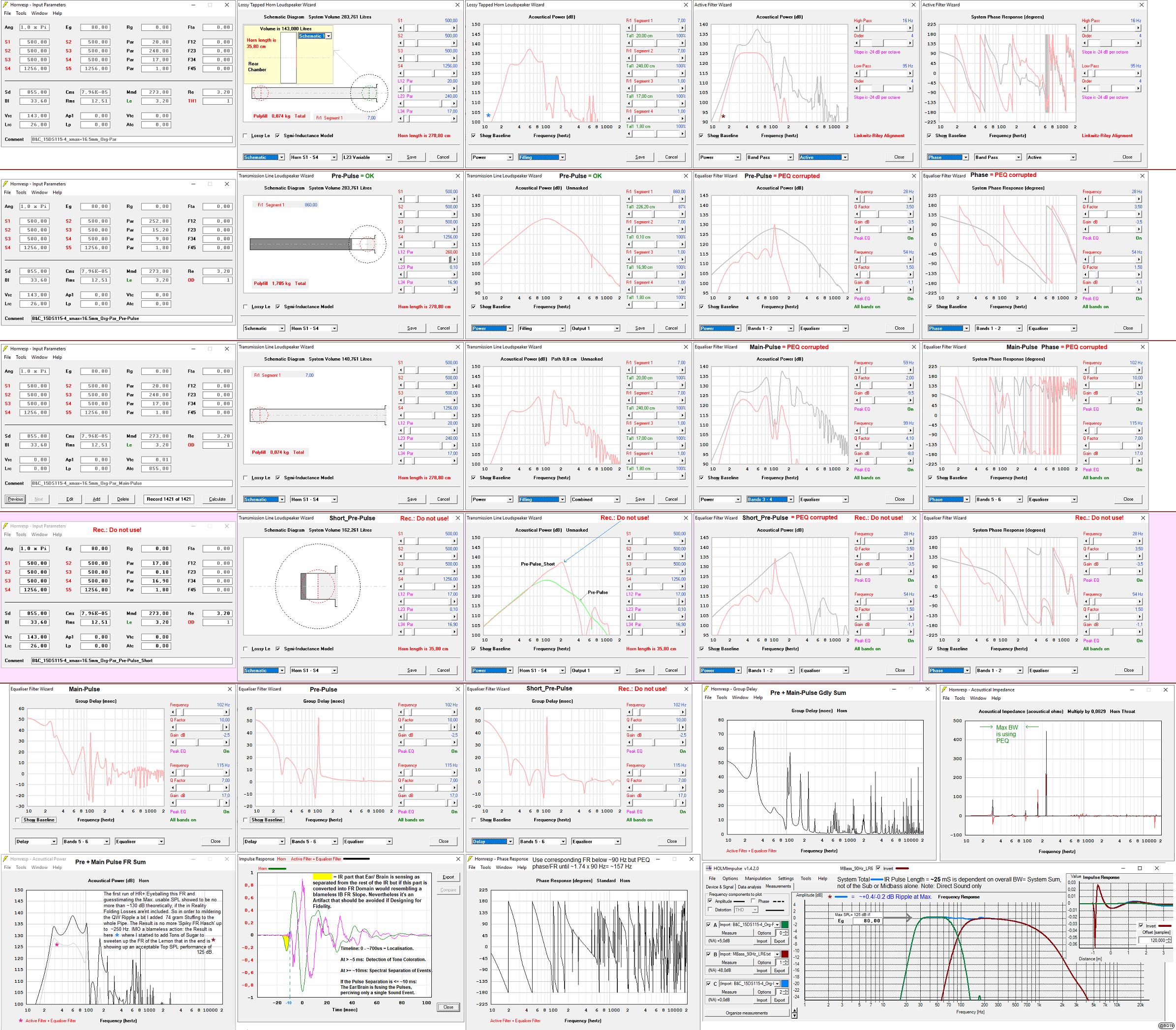

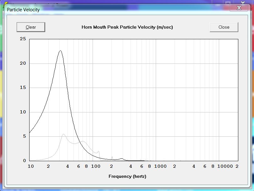

I simulated the first tapped pipe section of the ROAR and compared it to the 120 liter BR at approximately the same power level.
I use the ROAR and HROAR as examples not because I want to tout my own designs, but because I know them well and use them daily. I don´t want to only use theoretical models that I have no first hand experience from.
I am resting my feet in the mouth of my first HROAR prototype while i´m typing this, and using a familiar design makes it much easier to take measurements and do real world tests of them. I don´t want to write about things I am not very familiar with.
I have pushed my first ROAR12 prototype to a very sharp sizzeling and grating noise. It was a really ugly hard chuffing and I believe there was a local turbulent supersonic airflow round some hard and sharp edge near the TP outflow into the front resonator.

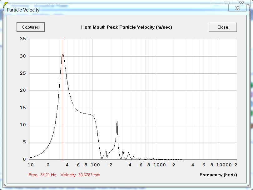

a 500 cm2, 240 cm long tapped pipe with a B&C 15DS115 at 2 kilowatt to illustrate high flow rates at the tapped pipe mouth at high power levels.
30 m/s is far from supersonic, but 30 m/s blown over a sharp plywood edge can create local supersonic turbulent airflow (a local turbulent edge vortice with at least 12 times increase in air flow speed).
I have never managed to create this effect in TP, TPCH, ROAR and HROAR designs where I have rounded all the edges inside the pipes with a router, despite using 5 kilowatt class D car amplifiers and extremely powerful high xmax, high Bl spl-competition drivers.
I was driving my ROAR12 with a Powersoft K20 close to clipping with no high pass filtering and +3 dB EQ at 35 Hz. The cone moved near xmax (12 - 16 mm). The ROAR design really keeps the cone well controlled, as I have never managed to drive any driver beyond xmax despite using more then ten times the rated power of the driver. The voice coil gets very hot very fast though. I would not keep up these power levels more then a few seconds at a time or it would fry the voice coil for sure. (it was a deliberate try at destructive testing where I wanted to see if I could break the driver through excessive cone amplitude or pressure against the cone)
The big difference is how the different designs use the nonlinear acoustic effects. The large straight quarter wave "planar" front resonator counteracts the thermal effects of the driver and damps the exit flow of the tapped pipe section.
