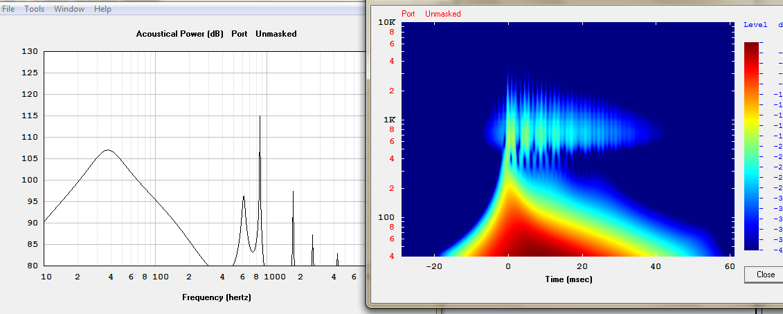

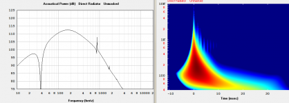

Hornresp is your friend :

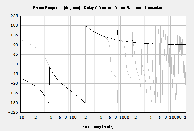

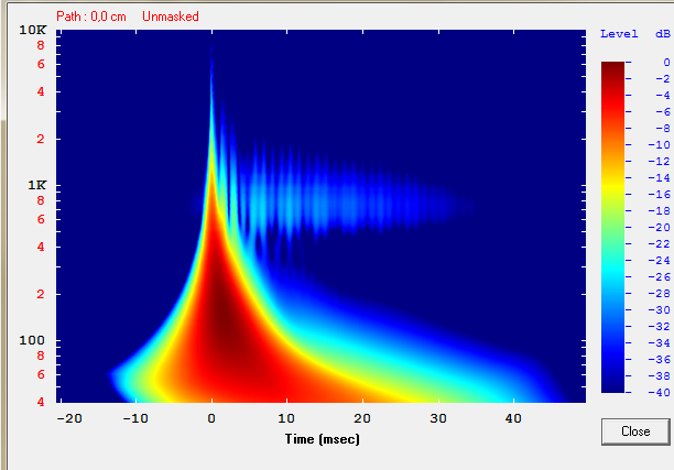

pic 1 : a simple not optimised bassreflex response sim...
pic 2 : port vs direct response...
pic 3 : phases (centered at 0ms delay) good tracking on useful bandwith

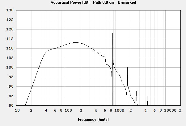

pic 4 : port spectrogram pretty nice

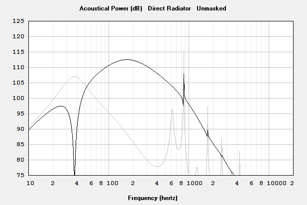

pic 5 : direct spectrogram

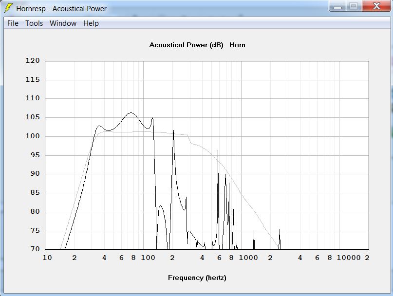

pic 6 : total spectrogram
We're talking about some complex stuff, and anything can be tell wrong if without precision. I know it because i'm somewhat someone really approxmiative
For example, reading "a acoustic sinewave resonator that lags at least one wavelength behind the driver" is scary :
What bandwith are we talking about ? What frequency ? Is there any mean to fight this ?
=> just a good practice for bass reflex : tune lower than needed bandwith.
The bad stuff about reflex are port compression, chuffing (need big port for higher power), resonnances (stub can be used to fight this), as for all sub high pass slope needs to be well damped, and as said before, tuning lower is better. Oh, and i forgot, since there's no back chamber to help voicecoil of non symetrical motor keeping in place, it's better using speaker with stiff suspension, or it will give offset at high volume so distortion and compression (that someone else said, is often considered as loudness ^^)
EDIT : I've already shown that "lagging" port, is just a question of damping/slope tuning => something traditionnally called alignement, very well know stuff, lol.
And front chamber/port is just for TH (and road/6th/8th) where front and back wave blend, so that if they're not in phase, you cannot mesure it, lol. (In akabak it can be simmed of course)
Whereas for bass-reflex, both wave (more pressure than wave in lower range) blend in room. I see no problem.
Front loaded just add low pass effect really useful for filtering higher order harmonics.
Correct me if i'm wrong, thanks !

Wonderfulaudio: i have asked you how the delay connects to the graph. Since you do not reply, explain, but give again empty misleading statement i suppose you may not have understood it yourself?
Pre filtered and post filtered, both are in phase, the graph is not showing the delay that much is clear.
I dont see GD (or can explain) because I see phase instead. If phase changes and is reversed by a filter etc then the signal is considered preserved.
The phase inversion of 180 degrees of bass reflex alignment can easily be reversed by an all-pass filter of matching Q and F.

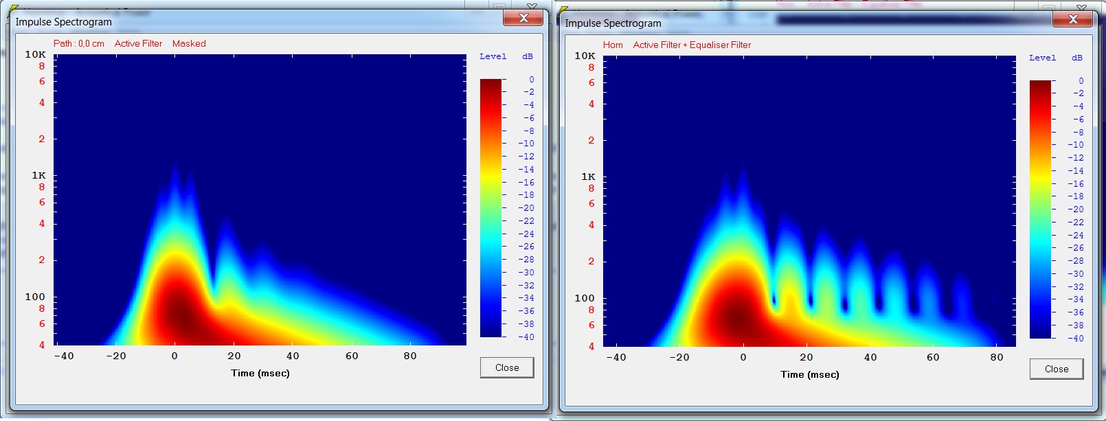

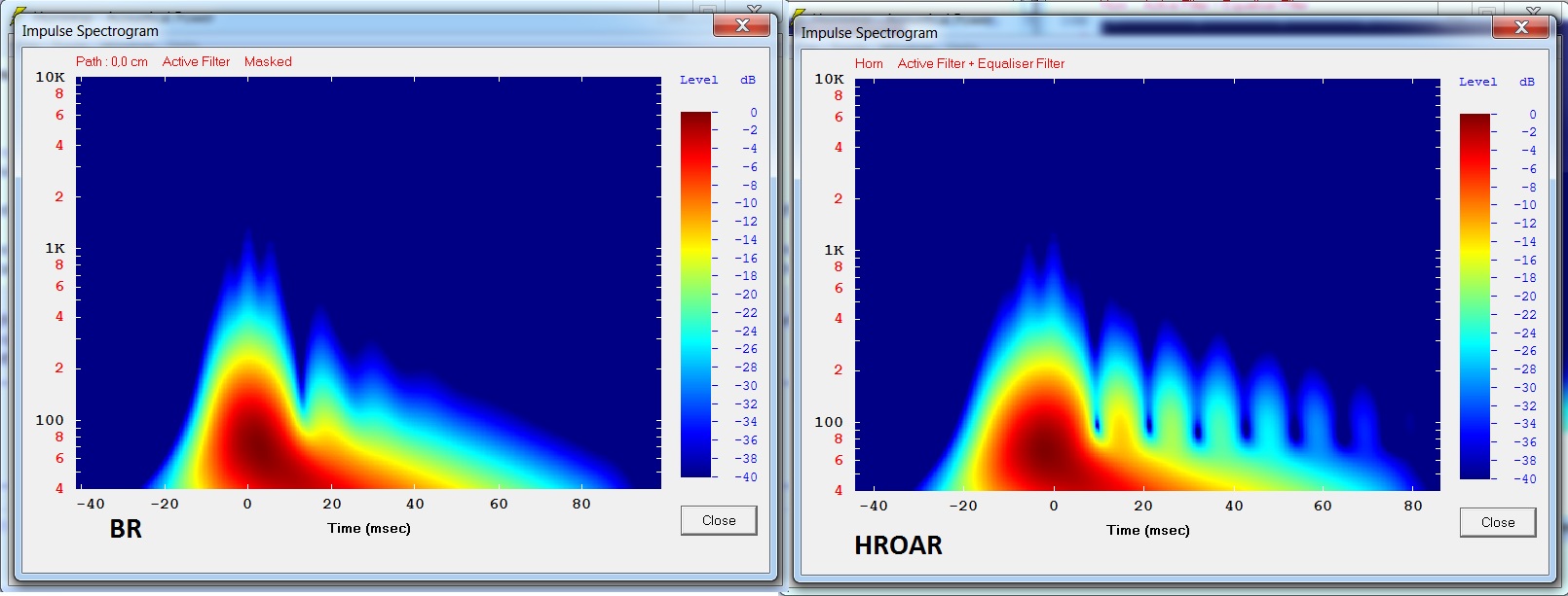

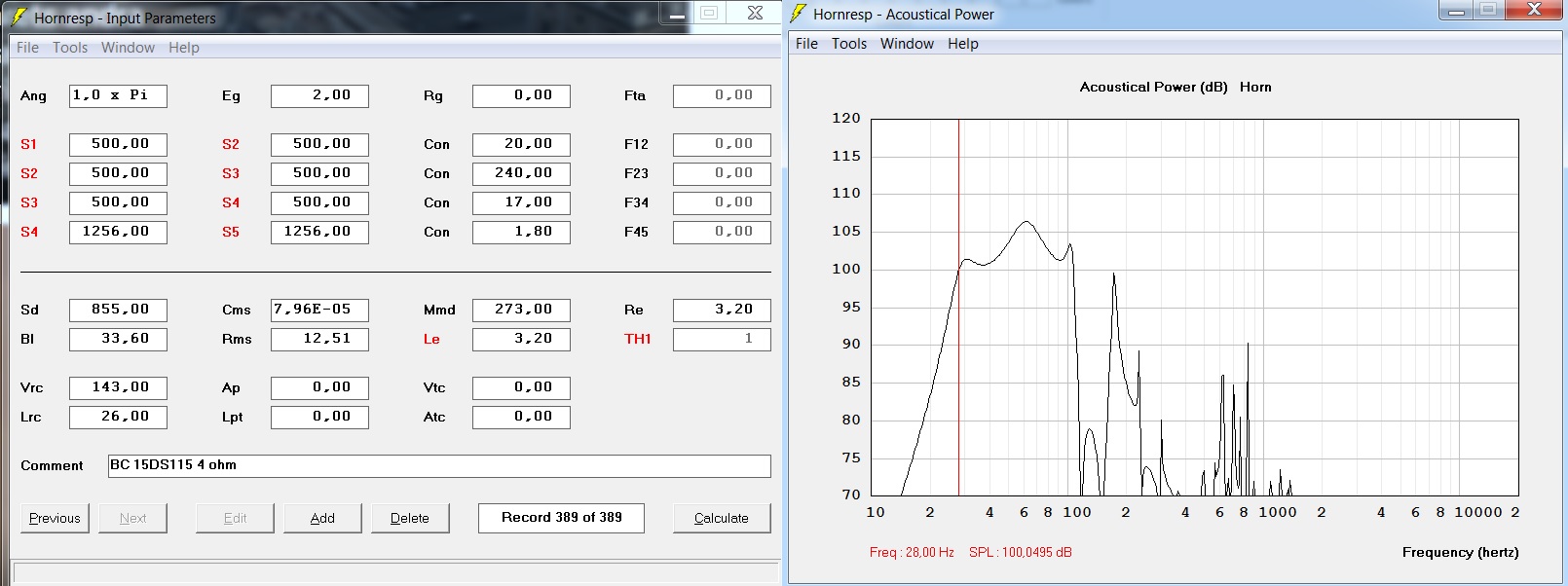

Here you're own definition of tightness. Lot of character of course. Like a guitar speaker. Should be pleasant, it must have something to do with low order harmonics. Powerful, of course. Dynamic, hell yes. Neutral, no way. It's heavily resonnant.View attachment 755182
Simulation.

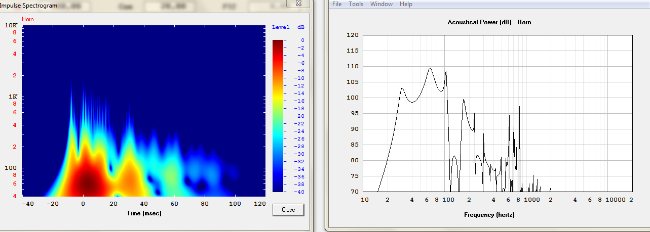

ROAR with Helmholtz front resonator
Layout, prototype of something similar but with another driver and passband, and measurements of the prototype.
With a pronounced peak centered around the midbass you get a very tight punchy and tactile character. Very usable for both music and HT.
Bass reflex has its limitations in "tightness" and punch suitable for HT. A driver suitable for BR has to much moving mass and to little Bl for a good mid bass punch and perceived tightness. The port in a BR takes several wavelengths to reach peak amplitude - which is pretty much the opposite of "tightness".
EDIT : for this, i didn't bother with semi-inductance, here is the small difference in our sims.
When adjusting the HROAR to have the same 32 Hz tuning as the BR I think my HROAR comes out on top again.
The wider area of red is indicative of a bandpass design and its slightly resonant series tuning. But the orange to yellow area circled in green (-8 to -16 dB) decays much faster in my HROAR then the BR. The BR has a lot of energy slowly decaying up to about 36 ms. The HROAR is essentially quiet after 20 ms, with only some lingering echoes in the front Helmholtz resonator chamber.
The first spike in the BR graph is the direct radiation from the driver.
The long and slowly decaying low frequency rumble (-8 to -16 dB) is the port in the BR.
The long and slowly decaying echoes from the Helmholtz front chamber of my HROAR is high frequency echoes at -20 to -22 dB @ 35 ms.
I prefer -20 dB @ 200 Hz to -10 dB @ 50 Hz after 35 ms.

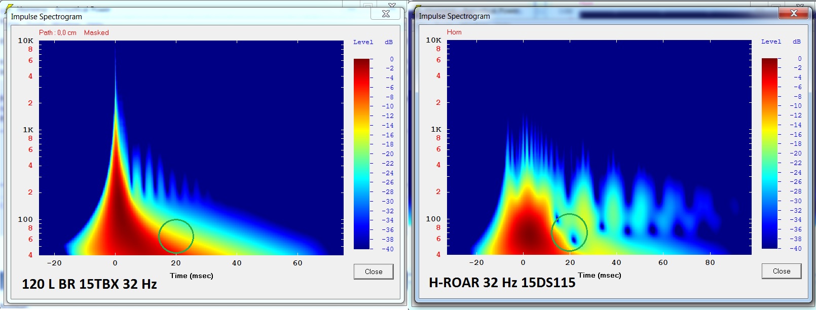

Please ! You didn't even filtered the BR !
And eq equal !...reference level 0db in red for Roar sim is @80hz @ +6db... so it gives the impression everything else is at lower level !
And what you circled in Roar sim is nulling effect from resonnance !!!!
You'll see that if you EQ equal, you'll get exactly the same spectrogram ! What i mean is that ROAR problem is a response curve problem. And if you cure it, ROAR will probably no more have what you find so awesome in it...
And the effect seeing low range going to the right, it is not at all resonnance, it is just the group delay, and is expected !! It's not on your eyes symetric because it's not a visually linear phenomena, that's all....
You mis-analyse everything ! (and i'm a expert ^^)
EDIT : you compared to a 120 liters BR !? are you serious ! 15DS115 is not at all suitable for a bass reflex with a 0,17 qts !
Close enough for government work.
I still see my HROAR coming out on top.

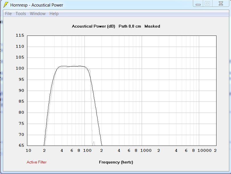

48 dB/octave @ 25 Hz and 120 Hz.
I EQed away the midbass peak of my HROAR.
The HROAR still have more and longer decay -20 dB 100 - 200 Hz content but the BR have a longer -10 dB low frequency decay (port resonance).
None of this shows the wave form reproduced when the driver is fed a bandwidth limited transient or other nonlinear non-sinuoidal signal...
...delay...BR is overall "printed/centered" spectrogram with more time delay by hornresp. It's overall more on the right.
The red 0db energy is centered on the right of the 0ms mark for the bass reflex, but to the left for roar. It's just a 5ms artifact delay... look closer.
