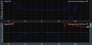

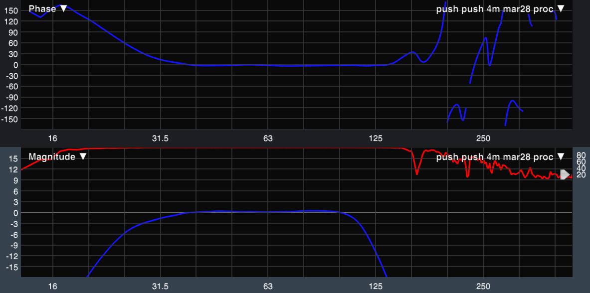

Here's a dual 18 BR" with FIR processing.
Measurements were taken outdoors, 1/6 oct smoothing.
First one is group delay; second is phase to support the group delay trace.
If you can go the FIR route, group delay is pretty easily tamed imo.

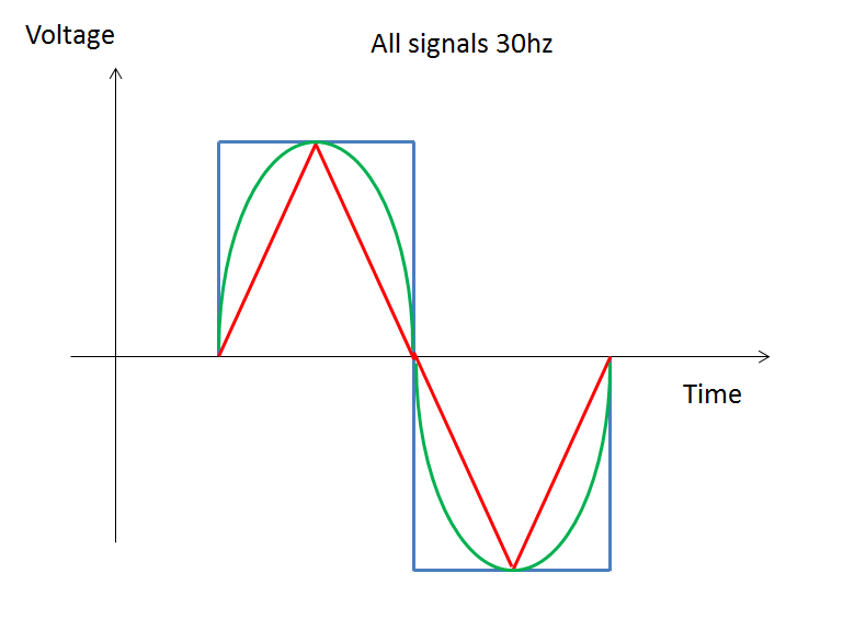

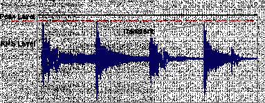

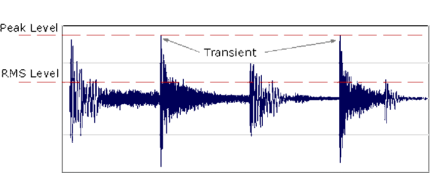

To make things visible (attachment #2):
30Hz is low tune right? so a square wave of 30Hz produces high tune? it instantly rise in voltage. 30Hz of triangular wave will require less acceleration because compared to square it rise the voltage smoother, simple example with the same base frequency requiring different dynamics.
Look for PID controller then you will find some answers about change system dynamics making it faster, mainly if work on the derivative part, the side effect might be overshot, someone need to make his own trade-off.
Transient means things that happen in a very shot time, so they use to be fast, what happen in a long time is a "steady state". If a drum skin is hitted, it will first produce a transient and after a "steady state" that you can recognize the tone and harmonics. (attachment #1)
If the voltage changes rapidly, its causing a high tone.
I can't totally agree with that, you can say that high tone for sure will be there but not only, it may have a lot of waves summed even lower tunes.

Thank you LORDSANSUI for posting this picture!
It is a great example of nonlinear signals (not made up of any numbers of sine waves )
Music is mainly nonlinear and percussive instruments like drums are maybe the best example of this nonlinearity. The transient response discussed in this thread is mainly the bass loudspeakers ability to reproduce nonlinear signals (not made up of sine waves) and the transient initial displacement peak of a percussive instrument or a plucked bass guitar string is very far from a linear sine wave based signal. A bass reflex box will through its steep high Q low pass filter function of the port try to "sinewaveify" everything fed through it. It is a sine wave oscillator lagging at least one wavelength behind the main signal at steady state signals and with a several wavelengths long build-up time to reach full amplitude.

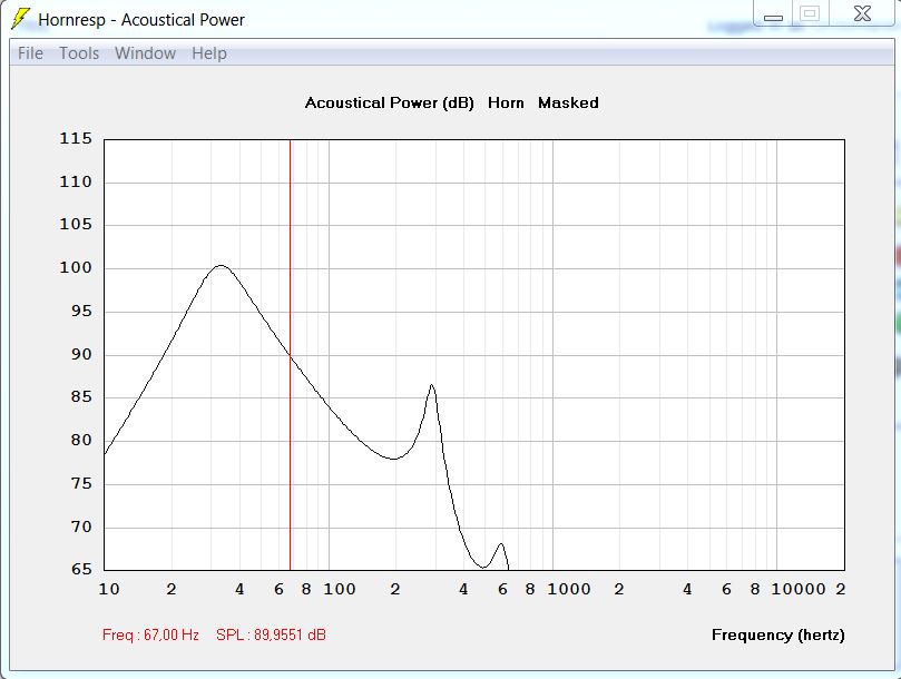

This is the port response of a B&C 15TBX100 in a 32 Hz tuned 120 liter BR.
It is 10 dB down at approximately 19 Hz and 66 Hz.. Almost two full octaves within 10 dB.
This strongly indicates that the high Q sine wave producing port will effect every signal between 19 and 66 Hz. A BR port is unable to reproduce nonlinear non-sinusoidal waveforms and will effect the perceived transient and dynamic character of drums, plucked bass guitar strings etc...
It will turn it into a droning resonant sine wave noise detached from the original signal in both reproduced wave shape and in the time-domain.
A horn, tapped horn or high order quarter wave based bandpass will reproduce nonlinear non-sinusoidal much better then any Helmholtz-based enclosure. It is quite common knowledge that Helmholtz-based bandpass enclosures lacks the transient abilities of a front-loaded horn. A bass reflex box is partly "saved" by the direct radiation from the driver. At least compared to a true Helmholtz-based bandpass box.

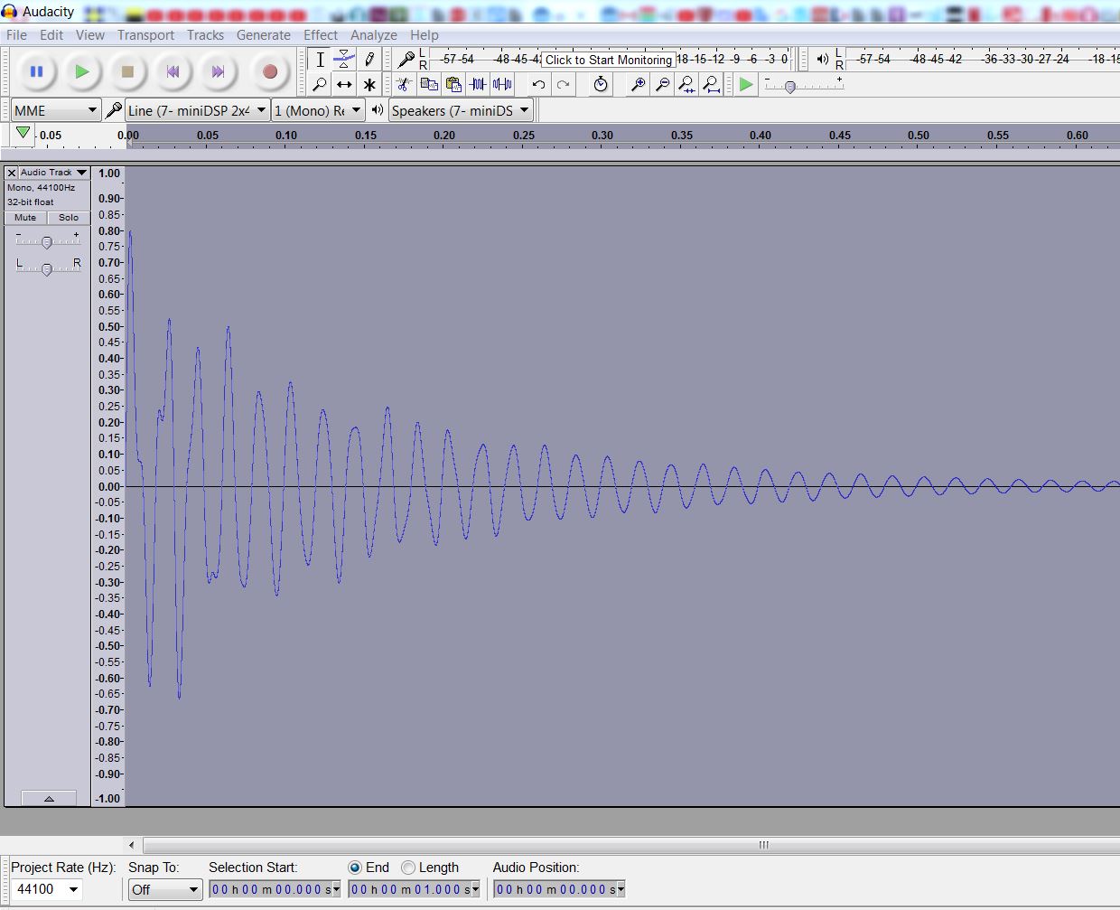

When playing this 50 Hz centered Risset drum generated with Audacity through my H-ROAR crossed over LP @ 120 Hz 48 dB/octave I can clearly hear a sharp but somewhat muffled transient. A 50 Hz sine wave started suddenly (no gradual buildup) sounds totally different.
There is a very obvious difference between a sharp transient reproduced by a steep LP filtered bandwidth limited H-ROAR and the same played though a bass reflex box. Through the BR it easy to hear the resonant decay from the port superimposed on the decaying signal fed to the driver. And the initial transient is more muffled and dull through the bass reflex.

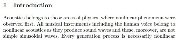

Musical acoustics
The physical behavior of musical acoustics is mainly nonlinear. Many attempts are made to model their sound generation from physical modeling of emulating their sound from measurements of their non-linearity.[7]
Nonlinear acoustics (NLA) is a branch of physics and acoustics dealing with sound waves of sufficiently large amplitudes. Large amplitudes require using full systems of governing equations of fluid dynamics (for sound waves in liquids and gases) and elasticity (for sound waves in solids). These equations are generally nonlinear, and their traditional linearization is no longer possible.
Nonlinear acoustics - Wikipedia
Nonlinear Acoustics and Acoustic Chaos | SpringerLink
Why is not Fourier Transform Good for Non-linear Processes - Signal Processing Stack Exchange
FFT is not very useful on nonlinear signals such as music from real life instruments. Sure you can get an approximation of the harmonic content, but it is only a crude approximation.
Music is not composed of simple or complex sets of sine waves. IF you have an infinite bandwidth (few amps or speakers can even play a slow 100 megahertz signal) then you can compose a square wave from an infinite set of sine waves.

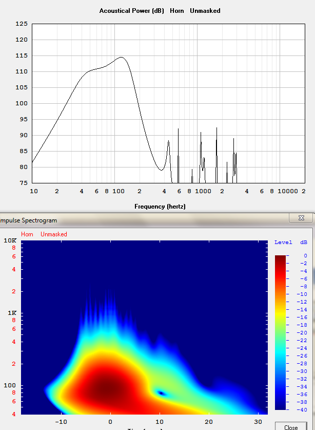

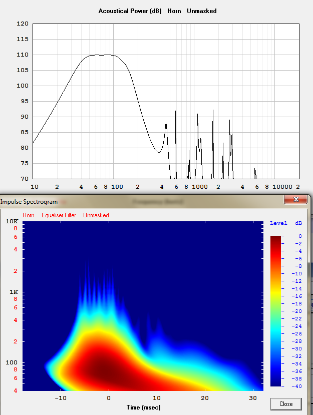

Can we not hear MP3 encoded drum?
Those resonnance / decay you talking about are nothing compared to real life natural in room resonnances.
And as you use hornresp, try spectrogram tool on your design...
Got a example on hand.
Here a bandpass spectrogram, for which hornresp calcul screen don't take account stuffing stuffing effect in picture 1 arround 150hz. But we can simply add a electric low pass, and see what happen in picture 2.
You can see, less "decay". Different filter slope (active/passive/acoustic filter...) lead to different damping.
Curve is not straight because of "group delay" but at frequency for which one cycle is long time, and so, ear needs not only one cycle to reconnize it, so overall, it just doesn't make real difference.
About reflex, you have to take whole system : Port + direct radiator, because they somewhat damp each others by nulling effects dues to phase.
