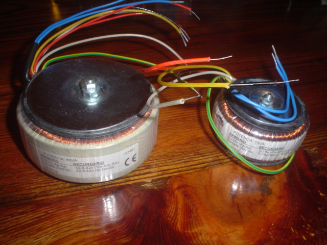

This are the Pumpkin and PSMLS transformers. 80VA and 15VA respectively.

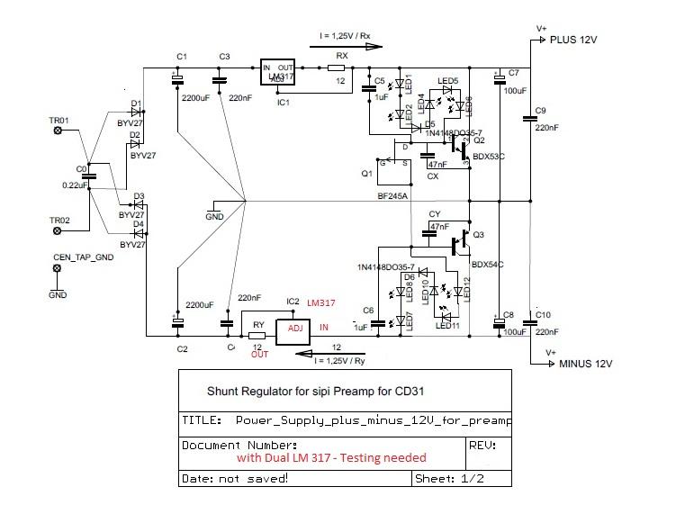

Sorry as I still have another doubt, the split power supply which use LM317 for +ve and LM337 for -ve rails constant current source has different current output, although I constructed them with 22Ohms current limit resistor, but I got ~ 46mA at +ve rail and ONLY ~ 16 mA at -ve rail. By calculation I shud get ~ 56mA from each rail.. why this happen ? :-( tot LM337 faulty, but still the same even replaced with new IC.. I measure the current by connecting 100 Ohms resistor ( serial to ammeter)
and shorted the output ( LM 337 / LM317 ) reference to ground.. thanks

Hi, PCB02 supply schematic is attached here. Current capability is defined by Vref/Rx or Vref/RY where Vref = 1,25V. Why You shorted Regulator ref to gnd?

trick with this PSU is floating CCS for zenner string
it will work as planned - with symmetrical load , what you'll have with implemented buffers
Slobo - I mean that wabun used 22 Ohms , but wrote 22Ohms
it goes well with mentioned 56mA
Ok, now I see - 22 Ohms. That should be OK. Reference of LM317/LM337 should not be connected to ground.
btw, we have played with this version provided below too, so with same PCB mounting modification/thinking it could be also very good (maybe even better) PSU solution 😉

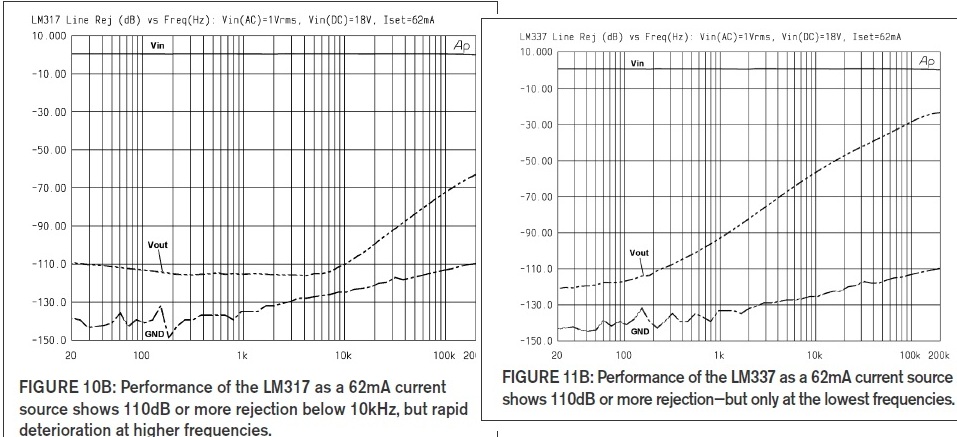

You are correct, I test the circuit with non sysmetrical load, that might be the reason why I have imbalance current flow for +ve and -ve trails.. I didnt shorted reference to ground, what I did is use 100 Ohms as dummy load and measure the current, and I got 46 mA and 16 mA respectively. but as Zen said, the circuit should works fine with symetrical load, I believe it might give balance current reading if I equal load both + ve and - ve rail at the same time.. 🙂
Sure, try with symetrical load - 100 Ohm between Plus and Gnd, and 100 Ohm between Gnd and Minus at the same time, and check voltages over both 100 Ohms 🙂
