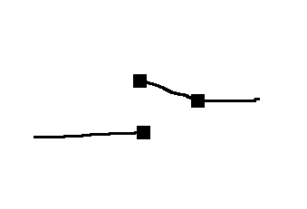

Bonny_kjs could you add a potmeter next to R9? That way we can add the noise reduction "tweak" as offered by member rdf.
And maybe a tp /pin next to R9 as well...as I drew on your pcb...this way the "noise bridge" can be shared between channels if people want to save a few pennies on a cap and resistors..or if they want to share it between their 2 mirrored pcb's so they can go balanced.

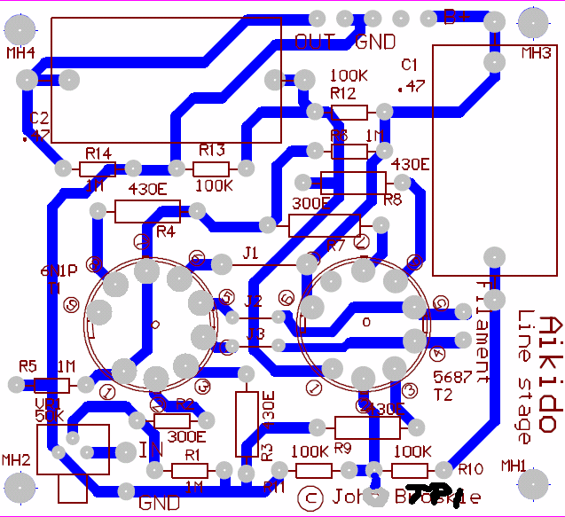

Hi
1. Capacitor size reduced.
2. Test point provided.
3. R2 and R9 tilted to bring them closer to tube pins.
4. most of connection brought to the back edge of PCB.
What are the tracks where potmeter connections will go?
The new pdf file show actual size of one channel of PCB. The size has become still smaller 95mm X88mm

Would it be too much trouble to make the tube socket layout so that one could use either the 5687/7119/E182CC or 6N1P/ECC99/6922/12xxx/6H30P pinout?
I think this could be done by placing a jumpered break just off of pins 6,8,9 so one could just jumper the pins for the tube used.

I have an idea. How about put the two tube sockets on a daughter board and connect to the main board with the rest of the components using either an edge connector or some kind of socket connectors.
This way, people can use different socket pinouts by swapping the daughter board.

Hi Dshortt9
I will look into the possibility of providing jumper for using
various tubes.
regards
various tubes.
regards

Looks Great! Very flexible. If you could add a tie point at pin 9 of the first tube it would serve for the filament CT depending on the tube used. Awesome! I would be ready to order.
