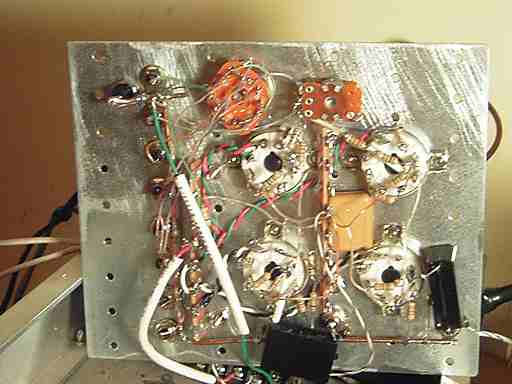

Bas - to me, that's what a layout SHOULD look like, it looks like you've built the whole thing with what, about 4 inches of hookup wire, in total? That's one thing I like about this circuit, it's all component leads for the most part.
I just popped the top of mine to snap a picture but now I can't find the digital camera - maybe my wife knows where it is . . . anyway it looks pretty much like yours except I used cheap 1/2 watt R's from radio shack and I have a couple of terminal strips, a selector switch, and a volume control in there.
-j

Hi J..to me that is what it should look like as well 🙂...these resistors were cheap as well. (Relatively speaking that is 25 € cents I think it was a piece)Bas - to me, that's what a layout SHOULD look like

Once you know that, designing a phono stage is not too big a deal. Here's what my build-up looks like.
The inp[uts are on the left, the selector at top left, the volume pot at top center, and the output jacks are bottom center & bottom right. The yellow rectangular cap is the power supply noise injection cap: that signal is shared between both channels.
