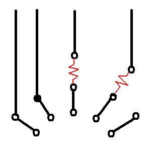

Bas Horneman said:You mean like this?
Yes, that is what I was thinking. I think people would be interested in that. Even if you don't like my strapped pentode idea, there are some good octal tubes for this, I think Broskie even mentions some, so maybe a PCB that takes both octal and nonal will be more popular. Another idea is that someone might want to make monoblocks and mirror which triode in the tube is used for swapping later. It's just my opinion, but since Broskie only presents the circuit and not the PS and heater supplies, people will want to fall back on their experience and comfort zone for these.
I just thought of another variation. Instead of actually leaving the PCB generic and forcing builders to put in jumpers to complete the circuit, it could be built specifically for the dual triode pinout, but with extra pads placed that would allow a builder to reconfigure by cutting traces. The extra pads could be drilled or left undrilled. Like so, on the left:

leadbelly said:I just thought of another variation. Instead of actually leaving the PCB generic and forcing builders to put in jumpers to complete the circuit, it could be built specifically for the dual triode pinout, but with extra pads placed that would allow a builder to reconfigure by cutting traces. The extra pads could be drilled or left undrilled. Like so, on the left:
I'd rather leave fiddle room by using jumpers than cutting traces. Only esthetics yes, but I like neat jobs when I can do them.
