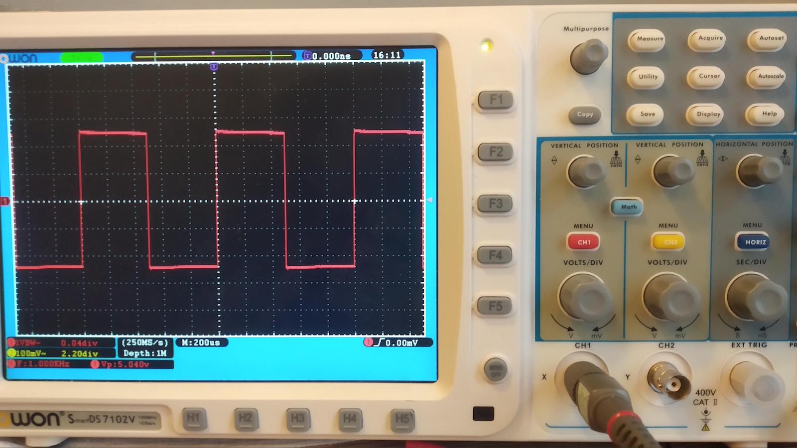

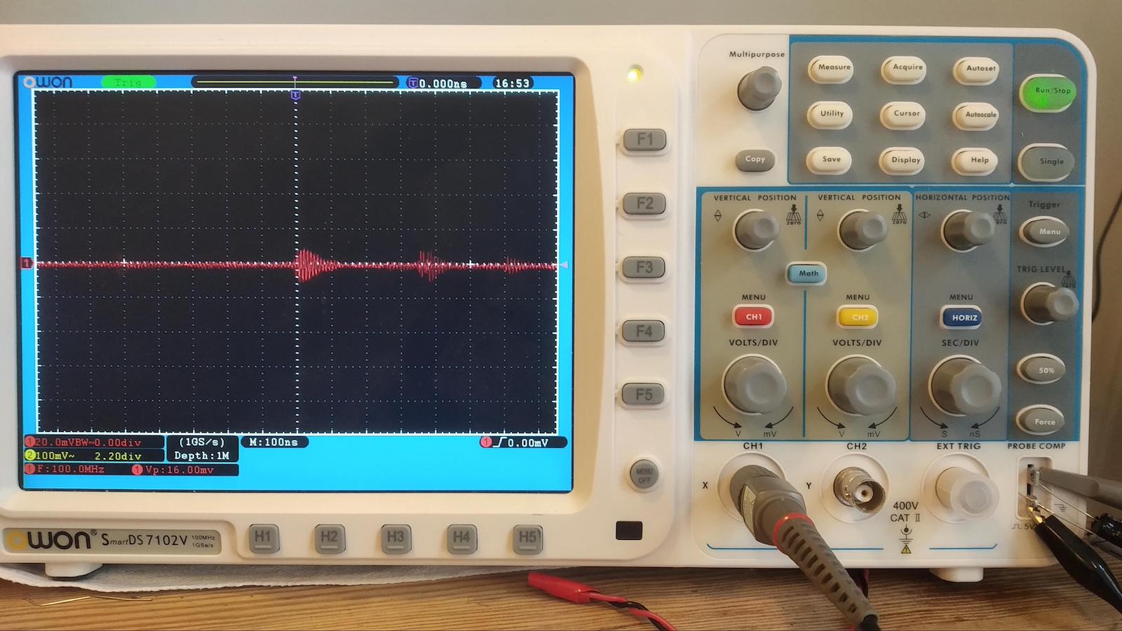

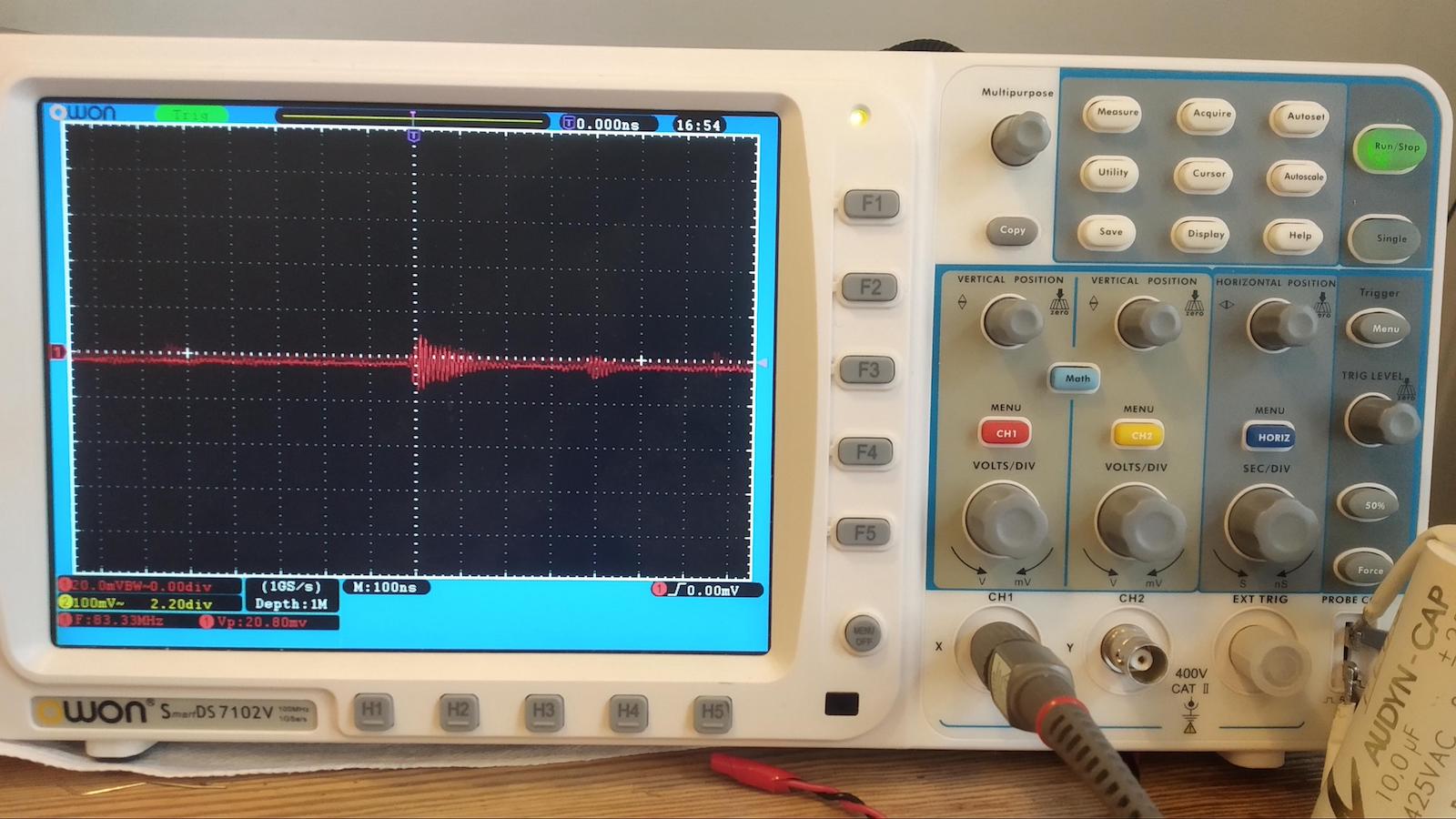

I used my 5v 1kHz square wave calibration output of my scope. Did a comparison of dropped voltage when cap shorted the output. At this low frequency, there was no difference to a high quality 10uF poly cap. Looking with the scope for HF residuals I see no difference except for the poly, I see some slow alternating wave going on which I assume is due to the higher xo for the smaller uF cap. What do you say - seems OK?

Studying several "do it yourself with gear you already own" websites and videos, I notice a common theme: they all tell you to use a function generator which makes known-to-be-excellent square waves, and they tell you to carefully measure its output impedance yourself.
The waveforms seen on these web pages and Youtube videos, do not look like the scope shots in post #142, making me suspect there could be one or more mistakes in your methodology. Check the sites below to see what they do and how they do it.
If you decide to pursue ESR-measurement-without-an-ESR-meter further, you do have one advantage which others don't: you've got a Mouser bag full of precision resistors whose value (0.04 ohms) is just exactly right for calibrating an ESR tester. Install the resistor where the capacitor-under-test would normally go, and measure its "ESR". If your measurement procedure says "ESR = 40 milliohms", congratulations, that's the right answer. If not, work on your calibration some more.

Note that the scope shots where on 100nS/div except of course the square wave.
This gave me the inspiration for my trials...

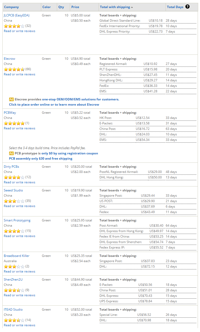

Here are today's price quotes, for quantity=10 PCBs, made on the super thin 0.6mm boards as shown in the photo. I got the quotes from pcbshopper dot com . Click on the image to remove distortion, and then click again on the white "X" at bottom left, to see it full size.
