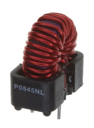

My nephew Hector is thinking about creating a custom SMPS filter for the Raspberry PI
He wants to know whether an aluminum box 80mm x 50mm x 40mm (3.15" x 1.97" x 1.57") is small enough to make Raspberry Pi users happy.
eBay Listing
I told him Yes. Does anyone have opinions about this?
eBay Listing
For a metal casing mounting holes in the PCB would be nice. So I would recommend a plastic case.
I imagine he'll use the standard 1.6mm board thickness from the two fabs he's tried before, PCBway and EasyEDA. And I imagine he'll design a rectangular board with M3 mounting holes at the four corners, as he did on other projects. Taking a wild guess, I surmise he has a few upright toroids in mind, thus requiring a rather tall (40mm!) box.

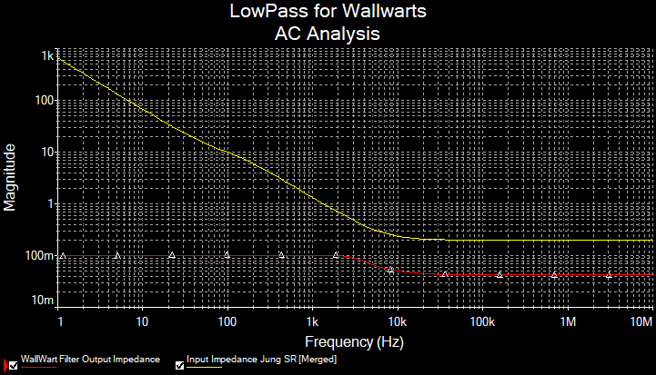

Getting back to that Middlebrook Stability Criteria -- becoming a big issue in DC power distribution because of photovoltaics, LED illumination. The filter does not adversely affect stability if the output impedance of the filter and input impedance of the load do not intersect. Here's a simulation with Mark's filter feeding the original (and somewhat twitchy) Jung Regulator, a la 1995's drawings:
Hector researched the maximum permissible load capacitance that typical 15 watt SMPS's allow, while guaranteeing stability. He and I looked over the data and concluded that PO89ZB probably does not exceed the max possible load, for typical (avg ± 1.5 standard deviations) SMPS's. So if you're feelin' lucky*, you could increase the value of the electrolytic capacitors and reduce the filter's output impedance yet further. Of course, while also meeting the constraints of using the same size capacitor package and maintaining or reducing ESR and ESL.
Lots and lots of SMPS vendors decline to state their max permissible load capacitance. Here's a homework problem: find that number for the official Raspberry Pi 3 SMPS (5.1V at 3.0A). Good luck.

I think it's worth reminding ourselves of something we already know: very, VERY few of the target devices mentioned in the title of this thread ("preamps, HPA, Korg NuTube, etc") feed the output of a regulated SMPS wall-wart, to the input of a linear regulator. The two largest elephants in the room, namely the Nelson Pass ACP+ and the Nelson Pass B1 Korg NuTube, certainly do not. They represent the vast majority of field deployments of PO89ZB. Instead, devices designed around a regulated SMPS like ACP+ and B1 Korg, tend to have a passive RCRCRC filter at the DC input, and no linear regulator at all.... Middlebrook Stability Criteria ... Here's a simulation with Mark's filter feeding the original (and somewhat twitchy) Jung Regulator, a la 1995's drawings:
With no downstream regulator, there's no possibility of regulator instability (oscillation), and the Middlebrook stability criterion simply doesn't apply.

If I may...
Read : the feed of the target devices (such as B1K) is the output of a regulated SMPS wall- wart (that goes at the device's level)) into the input of a linear regulator.
That regulator is a double PI filter in case of the B1K (the RCs at PS entry)

My primary application will be between a Mean Well RS-15-15
and a LT3045 based regulator. Shall I be vary of oscillations?
I am not an expert so will the expert reply to that.
I am not even sure one can reply 100% sure without knowing exactly all components and circuit... Based can mean so many things...
BUT IMHO... I don't think you should worry. The Mean Well is quite robust and possibly includes an unknown filter at its output already, you add quite a safe filter and I used LT3045 (God are these small to solder, that was my main worry TBH!) with various feeds and filters without worrying or noticing any problem re PS output. Seems quite robust as long as you don't put too much voltage in it.
But as said, not an expert, and an easy try anyway, not that things are likely to self destruct at turn in
