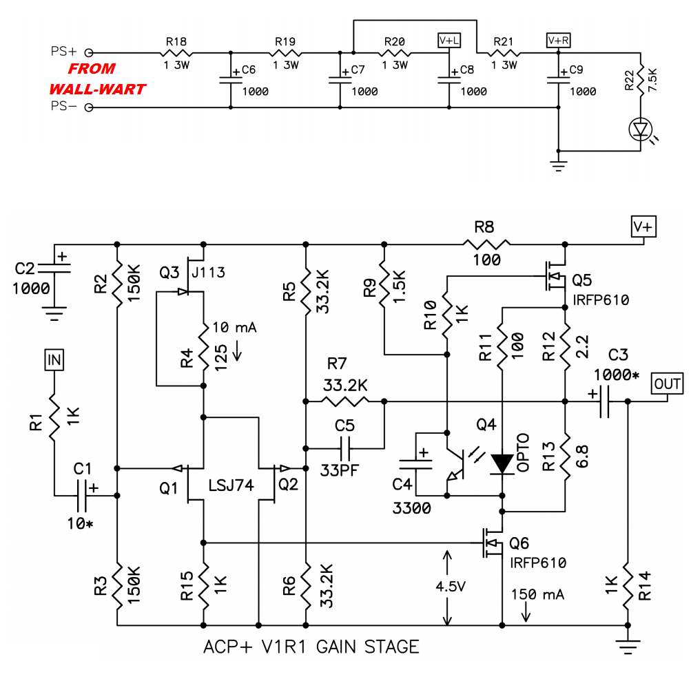

The other elephant in the room, with many hundreds of DIY units built and well-loved, is the Nelson Pass Amp Camp Preamp+ (written ACP+). LINK 1 ... LINK 2
The "+" Plus means, not only is it a preamp, it's also a headphone amplifier. Indeed it is a Class-A headphone amplifier with 0.15 amperes of bias current in its output stage.
Schematic is attached below.

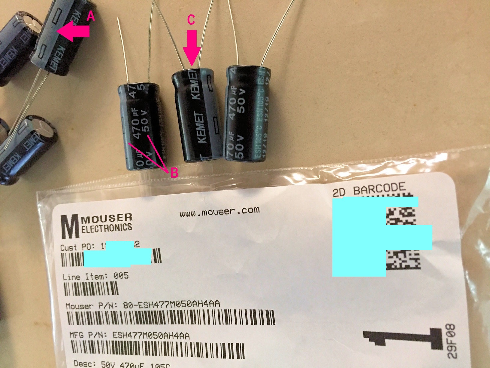

TNT, I think you'll probably get even better results if you use the Kemet electrolytic capacitors called for in the Parts List (post #1 of this thread). Your photo contains clues which suggest your capacitors are different:
I suggest you buy at least one of the Kemet capacitors, and then use your most sensitive test instrument to measure the ESR of the Kemet capacitor AND the ESR of your capacitor. I predict you'll find that the Kemet's ESR is significantly lower. Which means the Kemet will do a better job of shorting the (unwanted!!) high frequency noise, to ground. And that's the goal: to short high frequency noise to ground.
If the Kemet does measure significantly better than your alternative cap, then you can decide whether or not you want to retrofit Kemet capacitors into some or all of your existing PCBs. Or to inventory a bunch of Kemets in anticipation of future builds.
The instrument I happened to use for this project was an ET4510 LCR Meter, but if you've got an HP or other sensitive piece of gear, by all means use that.
Click on the image below to remove the foreshortening distortion, and click again, on the white "X" at lower left, to see the image at full size.
_
A. On your capacitors the white stripe indicating the negative terminal, has black chevron symbols ">". On the Kemet capacitors it is a solid white bar.
B. On your capacitors the text "50V" is next to the white stripe. On the Kemet capacitors the text "470 uF" is next to the white stripe.
C. Your capacitors don't appear to include the KEMET logo

Yes, I for some reason didn't get the caps in your BOM. Must have been out of stock or I did a dada. Whats the stated ESR on the Kemets?
Perhaps it is not just the stated ESR at a given frequency (with other fixed parameters), but an entire ESR enveloppe given multiple parameters (heat, voltage), or at least a given ESR curve vs frequency (at given constant parameters) that are relevant, who knows...

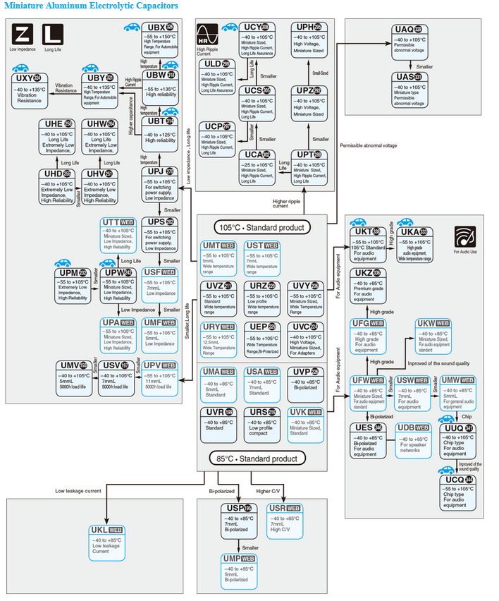

I'm not so sure there is a big difference between manufacturers these days. Maybe I build a new board with better spec'd and compare 🙂
Maybe there is no big difference between manufacturers (??) but the data suggests there certainly IS a big difference between the product lines sold by each individual manufacturer. Here is Nichicon, who serves as an example.
Those three-letter prefixes sure do seem to separate capacitors into different functional groups, including low-ESR versus high-ESR. But maybe I have gotten it wrong after studying the datasheets of 20 or 30 different Nichicon product families ...?
