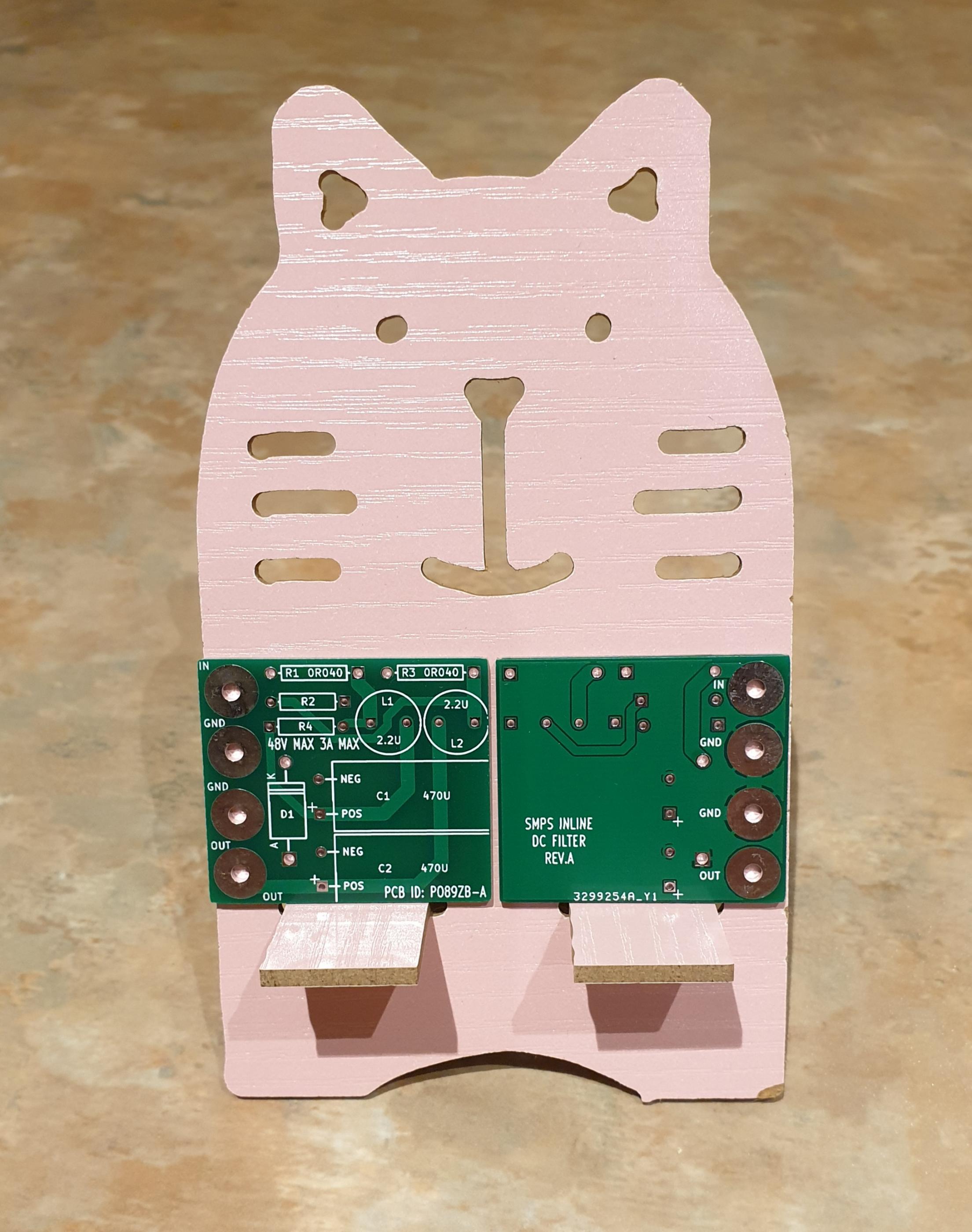

The boards arrived yesterday. It even came with a little holder to display them.
Anyone who has already reserved their boards, pm me with your addresses please. I still have eight to give away. I am only asking for people to cover the cost of postage.
If anyone has a child who might like the holder, I'll add that to their package. First come, first served.

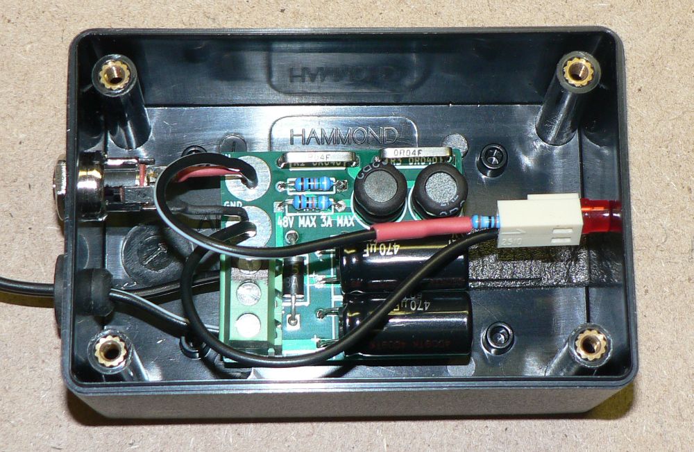

I just want to thank konst for the PCB.
Got around to building it and was going to use a Zippo box but chickened out and used a little Hammond box which is more suitable and robust for the application.

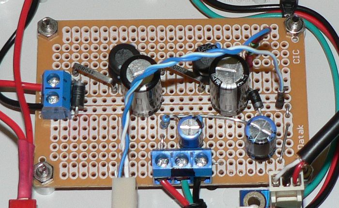

I did previously build one on a prototype board that included a split supply (after the filter) with a virtual ground. Compared it to a ESP P43 that was being used in a stereo to mono mixer/buffer and worked out to be a very quiet supply whereas the P43 had a little hum.

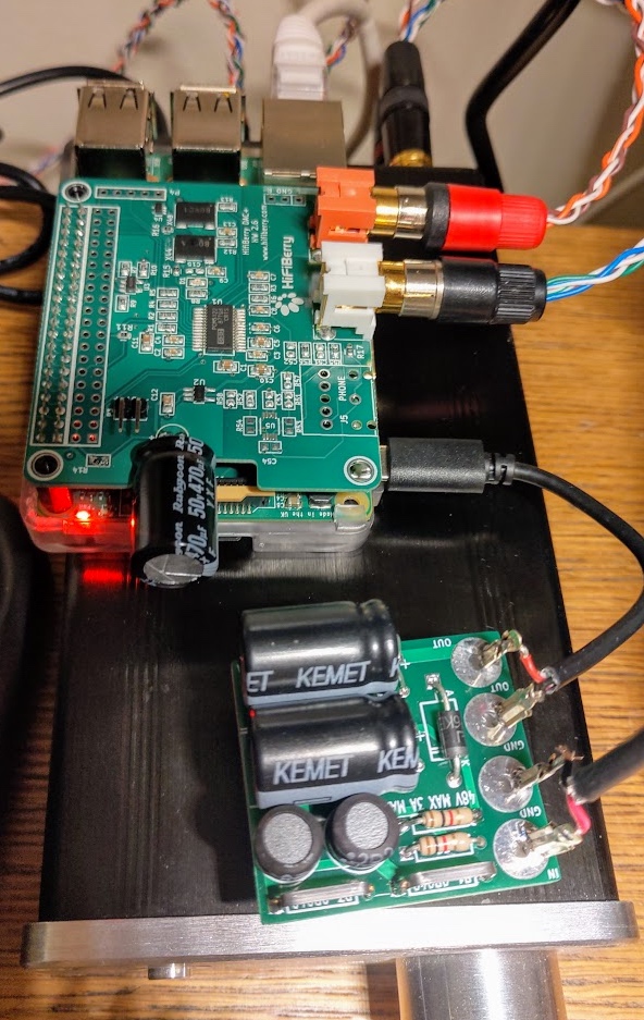

I got the ordered PCB:s today and the other components as well. First built filter was added to my RPi 2 Spotify music server.
It is powered from an ordinary USB adapter and there is quite a difference between the noise from the USB adapter and what is fed to the Pi.
There is only a 32 mV voltage drop over the filter when playing Whiskey in a Jar by Thin Lizzy, I guess other song will be about the same drop 😉
How does it sounds? Absolutely beautiful! But on the other hand, it did that even before i added the filter.
