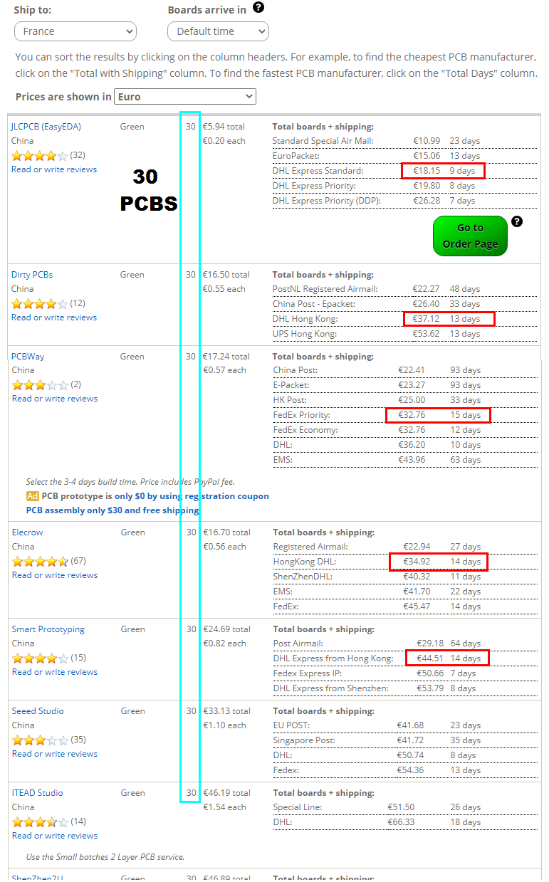

Gerber files for the rev-A PCB are attached to post #1 of this thread; anyone can send these files off to a PCB fab, and get as many boards built as they like, with my blessings and good wishes.
Here are today's price quotes, for quantity=30 PCBs, made on the super thin 0.6mm boards as shown in the photo. Shipping to France, price quoted in Euros. I got the quotes from the very handy website, pcbshopper dot com . Click on the image to remove distortion, and then click again on the white "X" at bottom left, to see it full size.
Total cost is about 1 Euro per board, including shipping. Use as many as you need, and then give away (or sell) the extras to other diyAudio members!
May I ask what service you use to get that quotation from multiple fabs?
