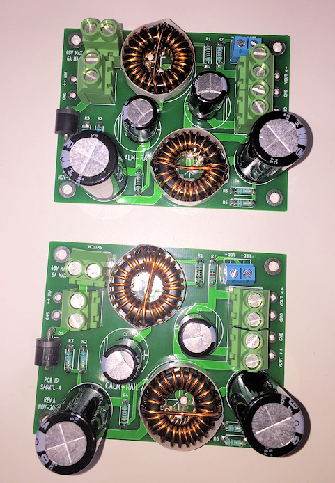

Working with a set of Beta Testers, we're trying the idea of using two commercial SMPS to power a First Watt Class A amplifier. Here are the filters we're using for the first experiment. They are rated 48 volts and 6 amperes. If you are dying of curiosity, I recommend you spend a few minutes doing the math. Calculate what RMS numbers a stereo Class A amp can drive into a pair of 8 ohm loads, when the supply current is 3 amps per channel. I'm sure someone will project these specs upon a Raspberry Pi application, too.
Different filter circuit topology for different max-current environment.
It might fail. That's what sometimes happens with experiments.

Hi Mark,
Very interesting project again.
I did a quick and dirty RLC filter for a friend's class D SMPS, worked OK. Was designed to withstand 35V / 6A, one filter per amp and bi-amping.
But you clearly went a step further with your filter. You seem to want 2x72W out of the Class A amp, means you design for at least 2x 150W at PS- you want your filter to cope with 300W. Plus you have 2 coils so I presume again a 'double stage' RLC filter... I went only single stage RLC. Clever bit, I don't see a large R to cope with lot of Watts, so my guess would be that role is taken care by the coil's "inherent parasitic DC resistance" while at it...
Please let us know how it works!
Take care
Claude
