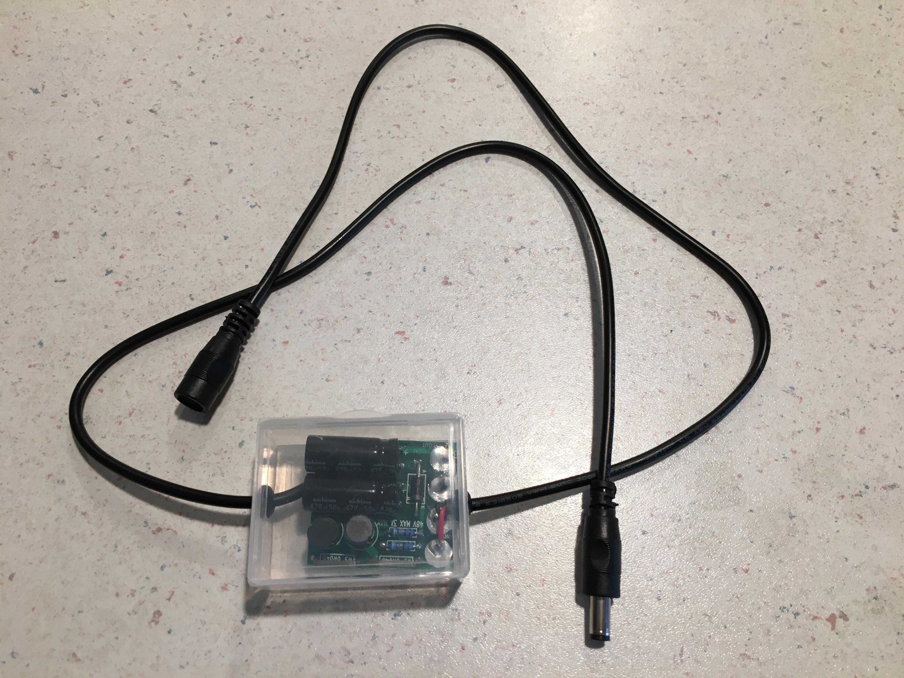

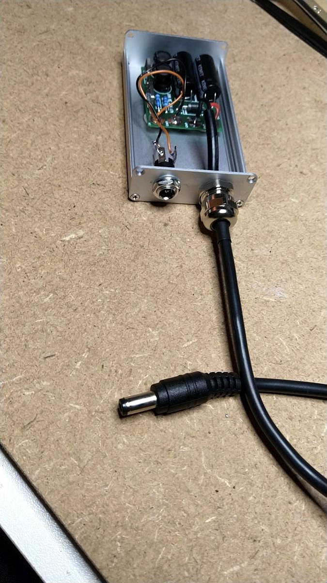

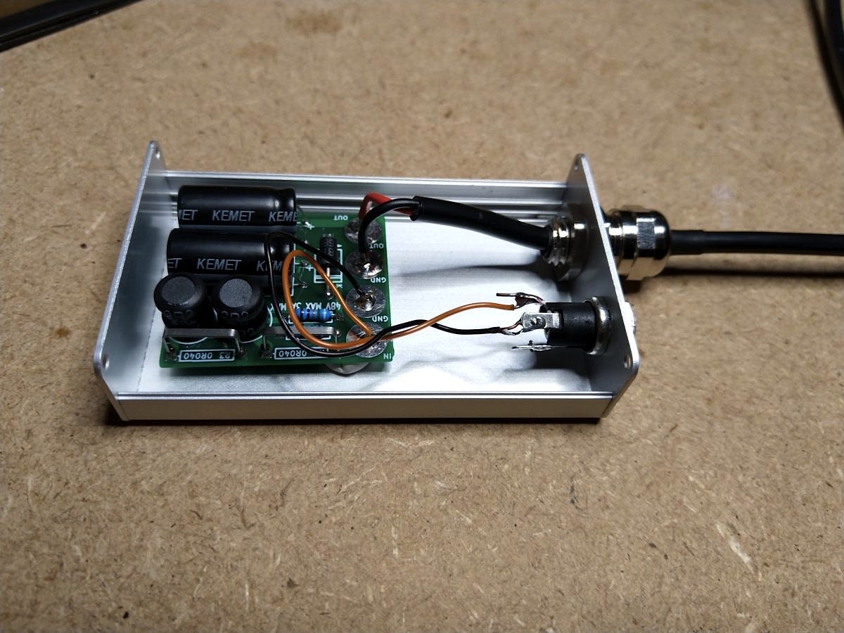

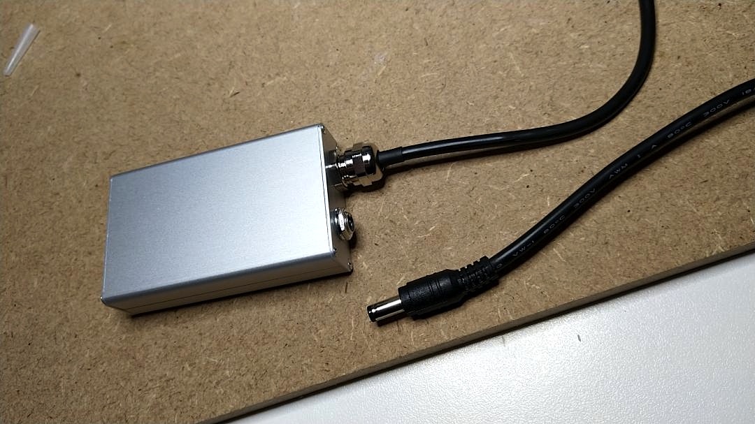

Some progress re casings for the 8 units to be build (as additon to 1 directly integrated in the B1 Korg and another already at a friend's).
Gilles did a splendid job finding nice sleek casings from China. Looks good to me, and do far more justice than my jerry-rigged handcraft 🙂
Same for cables, plug etc.
The device holding the cable to the casing is a tad bigger than anticipated, but still very nice IMHO. The box is very small, don't get fooled by the pix.
BTW, these is still the "old" filter, with original initial caps. I will keep it so for comparison purposes (vs all other filters with the latest upgraded caps), well noting I have the parts to upgrade it aswell later. So quite confident in the end result, although not really expecting anything mind blowing, it works already great...
Last step is experimenting on the best way to hold the board in the casing: blu-tack, double-sided adhesive tape, scratch... or in fact a combo of these to make it last and safe. Nearly settled by Gilles...

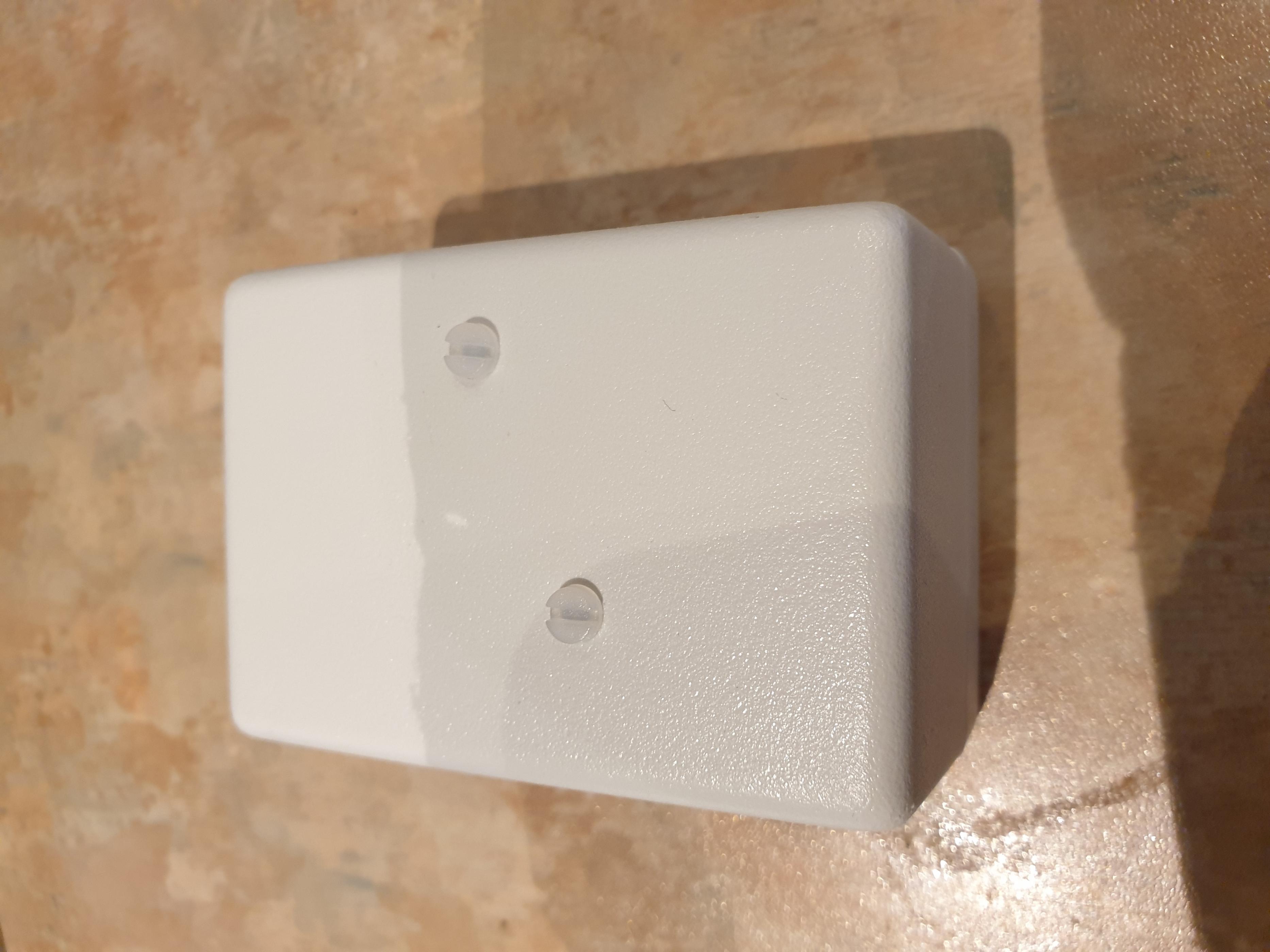

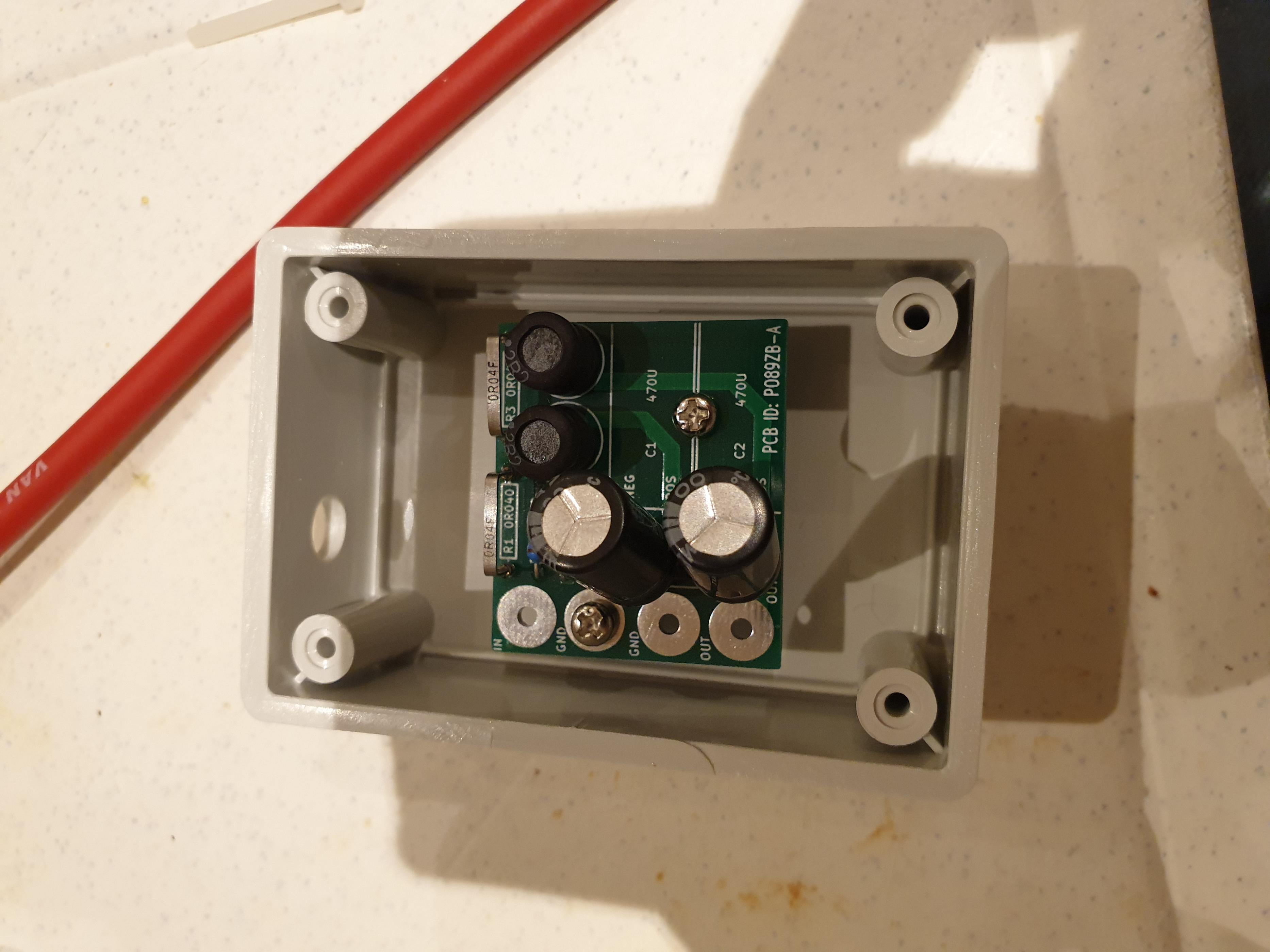

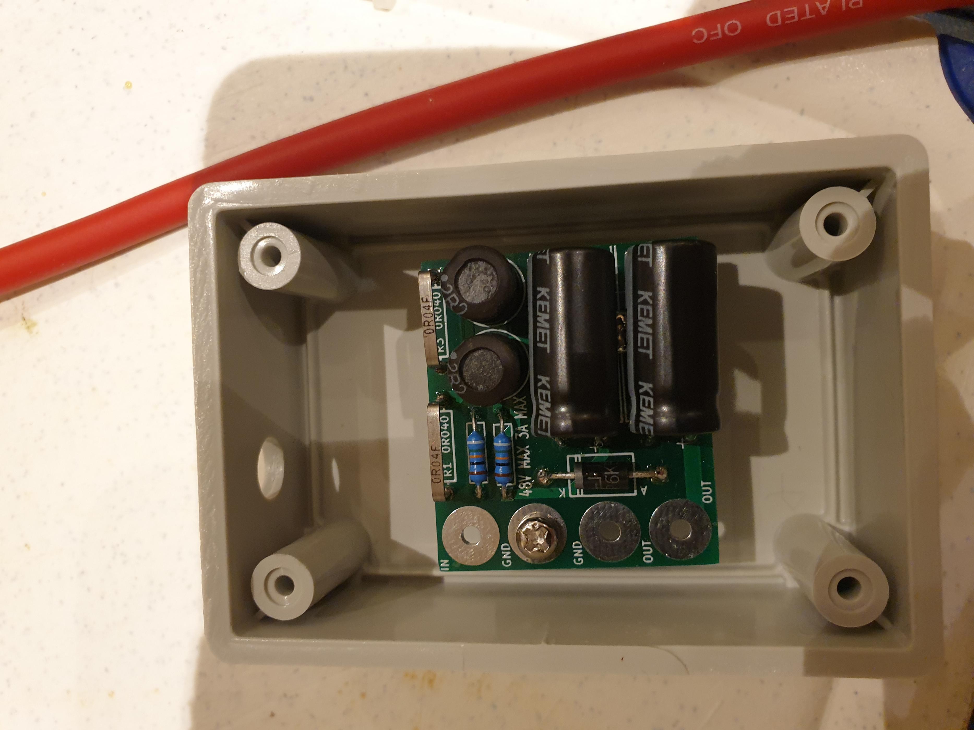

Zachik asked about a mounting solution for the boards made from Mark's original gerber files. My solution was to drill out one of the ground holes with 3mm bit and use some of the real estate under the capacitors. Just leave some spare length on the capacitor leads to allow for the screw head. For extra safety I used nylon screws to fix the spacers to the outside of the box.
They're not pretty boxes, they are primarily to check that I can hear what they do. If I like the results, I'm aiming to put the boards inside the cases of my preamp projects as permanent fixtures. I've also done another box with two boards in series as others have suggested.
Once the UK lockdown is over, I'll be able to try them on my friend's kit if they want.
