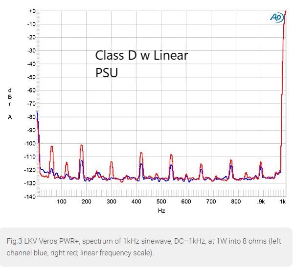

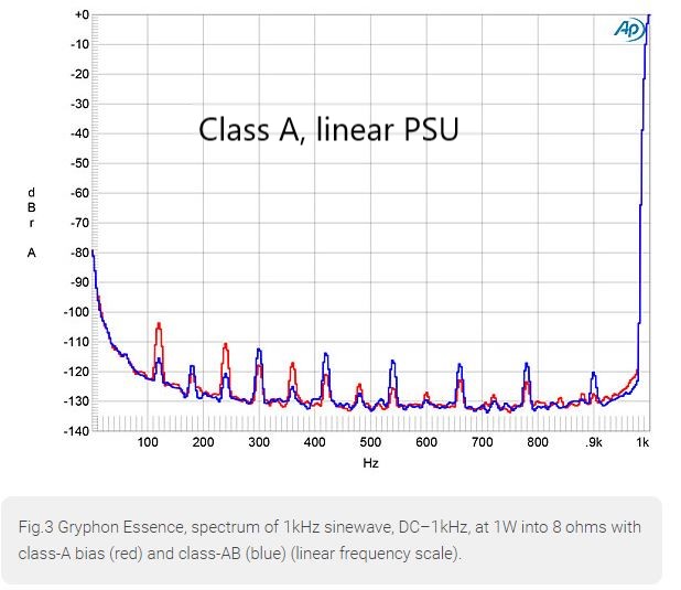

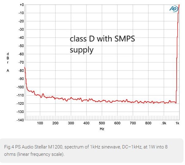

Fwiw, here are some interesting measurements from stereophile between amps using linear vs smps supplies for your enjoyment.
Not at all a scientific comparison, but it seems at least plausible that some of the differences are due to the use of switching supplies.

On another thread i also did measurements on some supplies and the effects of a SMPS filter..I didn't know at the time that there was already a project cooking on this else i'd have waited for an expert designed one! I'm really looking forward to trying out the design from Mark when its published!
post #41:
Mean well vs generic power adapter vs audio oriented smps

It is probably wise to also compare PS output impedance vs frequency and capacity to deliver amperes.
Claude
Great suggestion -,I’m sure I’ll get round to doing it at some point and I’ll,post that when I eventually do.
Based on your graph only, it appears that a linear PS could have bettered the SMPS on all accounts provided the main's frequency and its multiples would have been better filtered out?
Dunno but maybe avoiding ripple and harmonics in the audible spectrum isn’t such a bad idea either 😀
