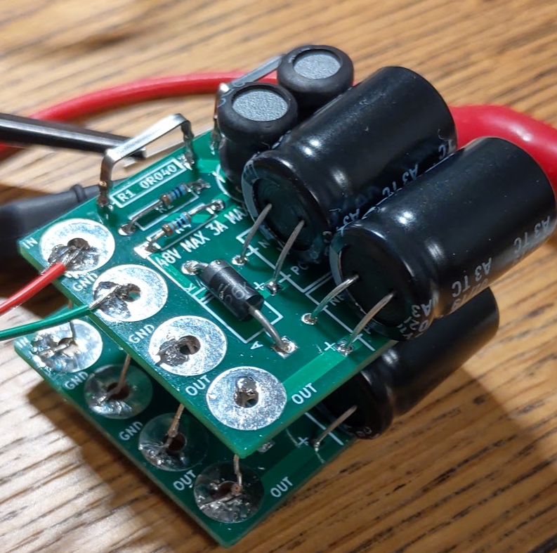

Lovely build, @Monk55! Wasn't expecting to see a 200 watt SMPS (140 watts without fan) in there.

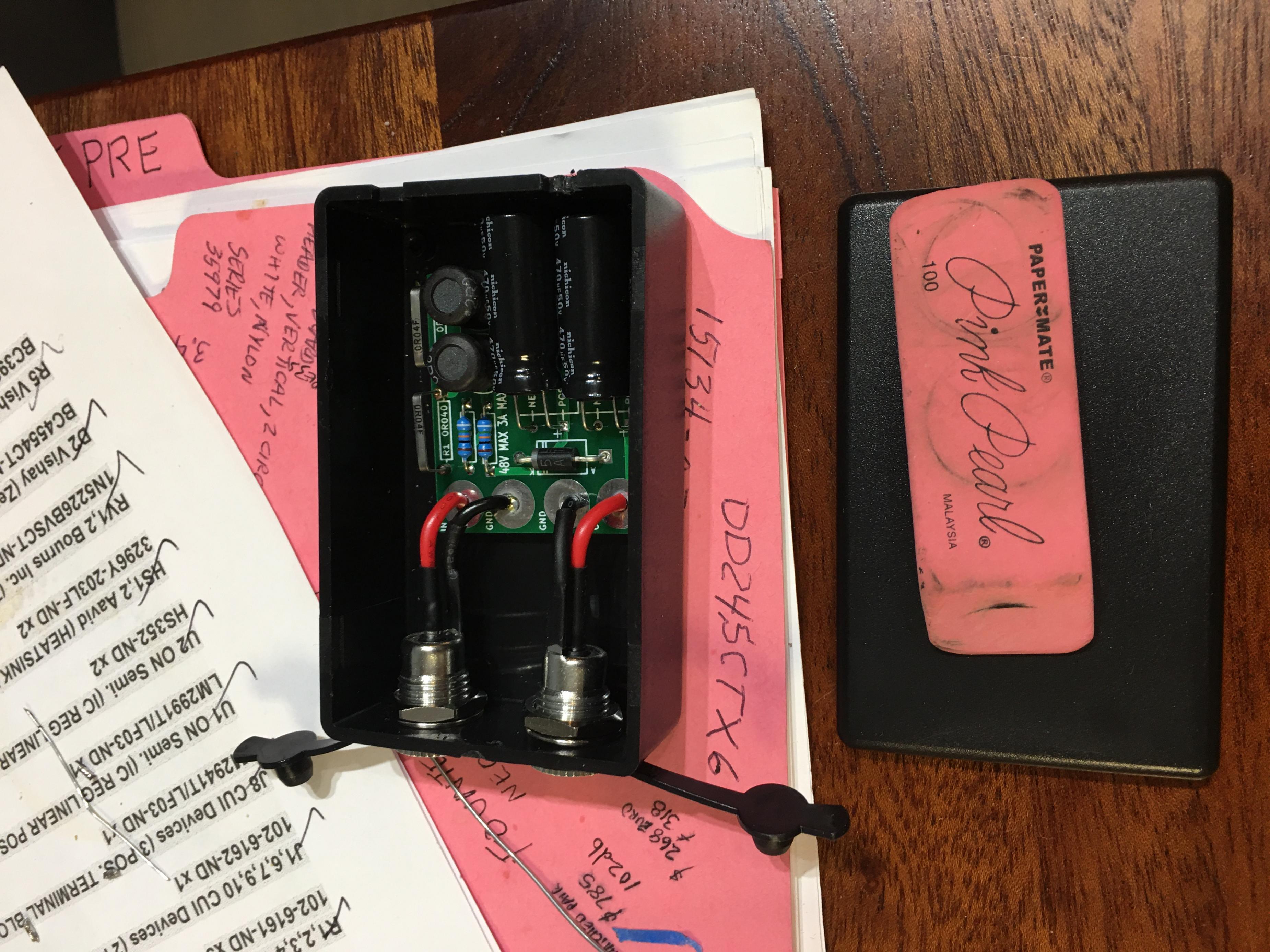

Since you asked 1883,
Not pretty, but easy enough to do.
It allows me to try it on any of my preamps.
Just about as small as can go...
Boxes:
LeMotech 5 Pieces Plastic Project Box es Junction Case for Electronic Project, Black 3.15 x 1.97 x 1.02 inch (80 x 50x 26 mm)
Jack’s:
5.5 x 2.1 MM 10A DC Power Jack Socket Dc099 30V Threaded Female Mount Connector Adapter with 3.94 Ich 18AWG Cable and DC Barrel Jack Plug Male Lsgoodcare
Siliconed board to box.

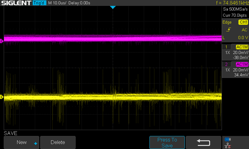

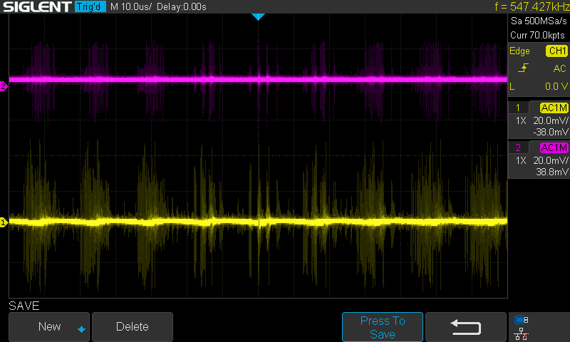

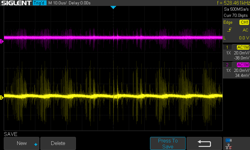

In the interest of science I had to try two filters in parallel. I also wanted to measure with and without load. The filter clearly performs much better with light load.
The power supply is the cheap brick that is delivered together with the Aiyima TPA3251.
First picture is one filter without load. Second one is two filters in parallel approx 1 A load and finally one filter and 1 A load.
You'll need to make sure the load current drawn from the SMPS is the same in all cases -- so the SMPS output noise is the same in all cases.
When you draw zero current from the filter (first picture) you need to draw 1A from the SMPS, by connecting your load resistor at the SMPS output, before the filter.

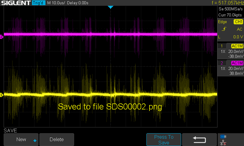

Mark, you are absolutely right about the same conditions should apply, but my interest is more of a "what if" nature.

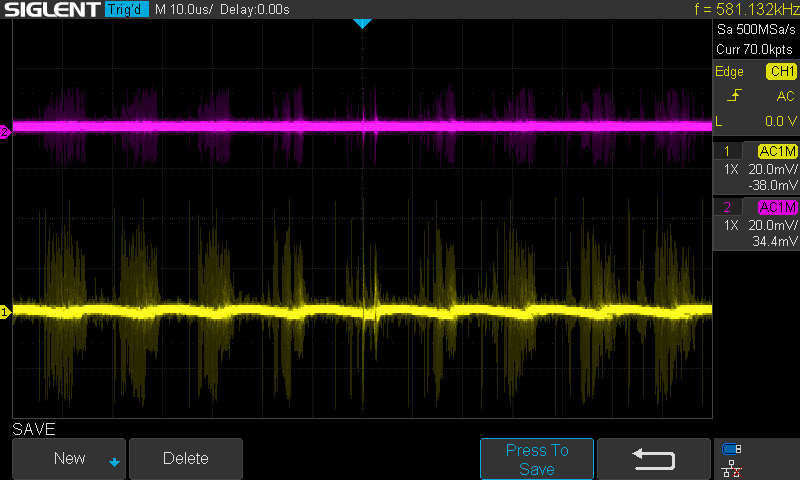

I have made new measurements. 1A load at the input of the filters and 50mA load at the output of the filters. Without any load besides the scope the damping is slightly better but not that much.
As far as I see, the filter works better (higher damping) the less load that is applied on it. Worst case scenario for the filter is a class A amplifier, but it might still of some use.
I really can't see that much difference with two filters in parallel so next step is to try it out on my TPA3255EVM.
First picture is one filter and the second picture is of two filters in parallel.
